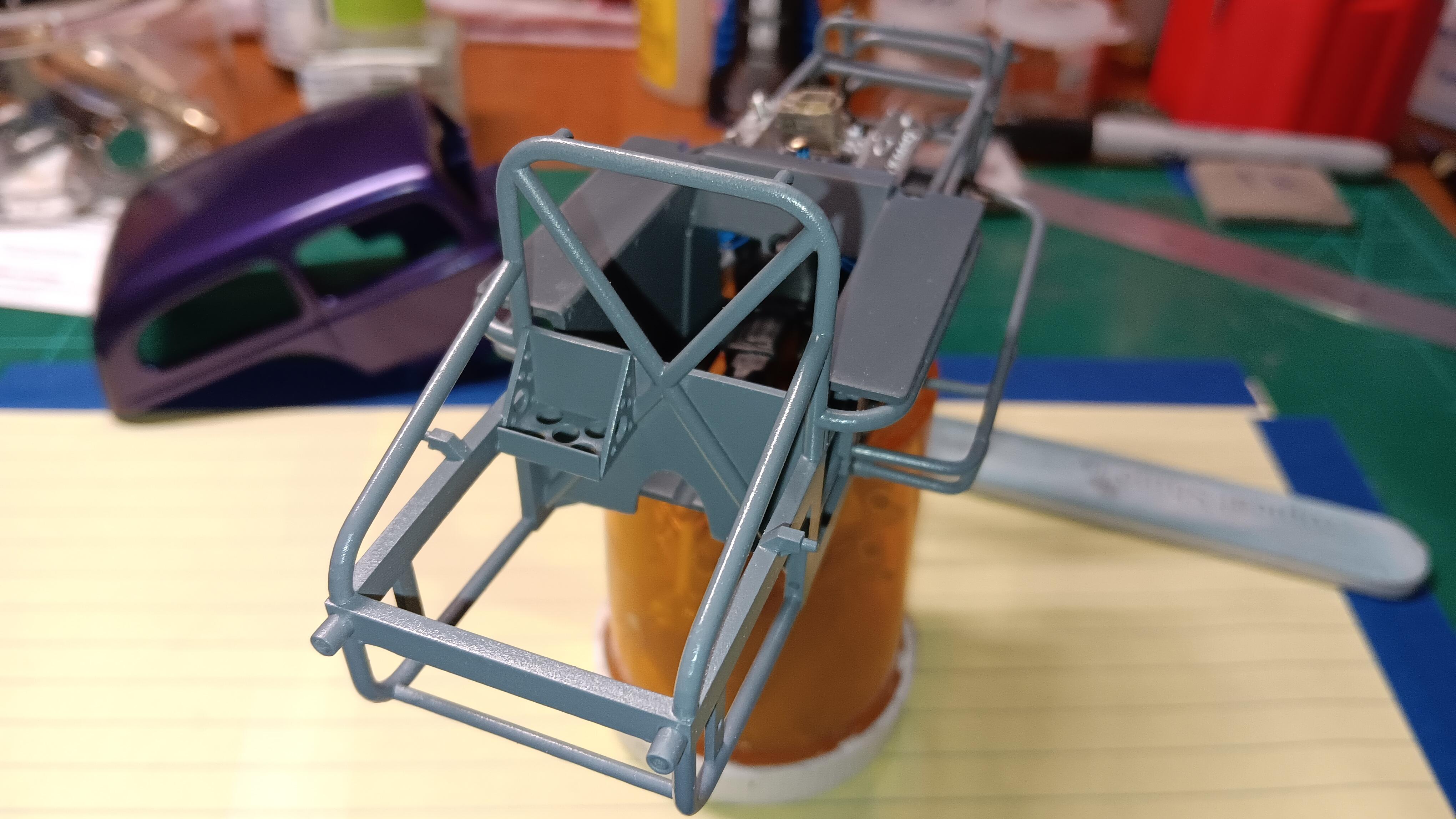

I had to trim the rear of the interior tub to fit it to the 3D printed chassis.

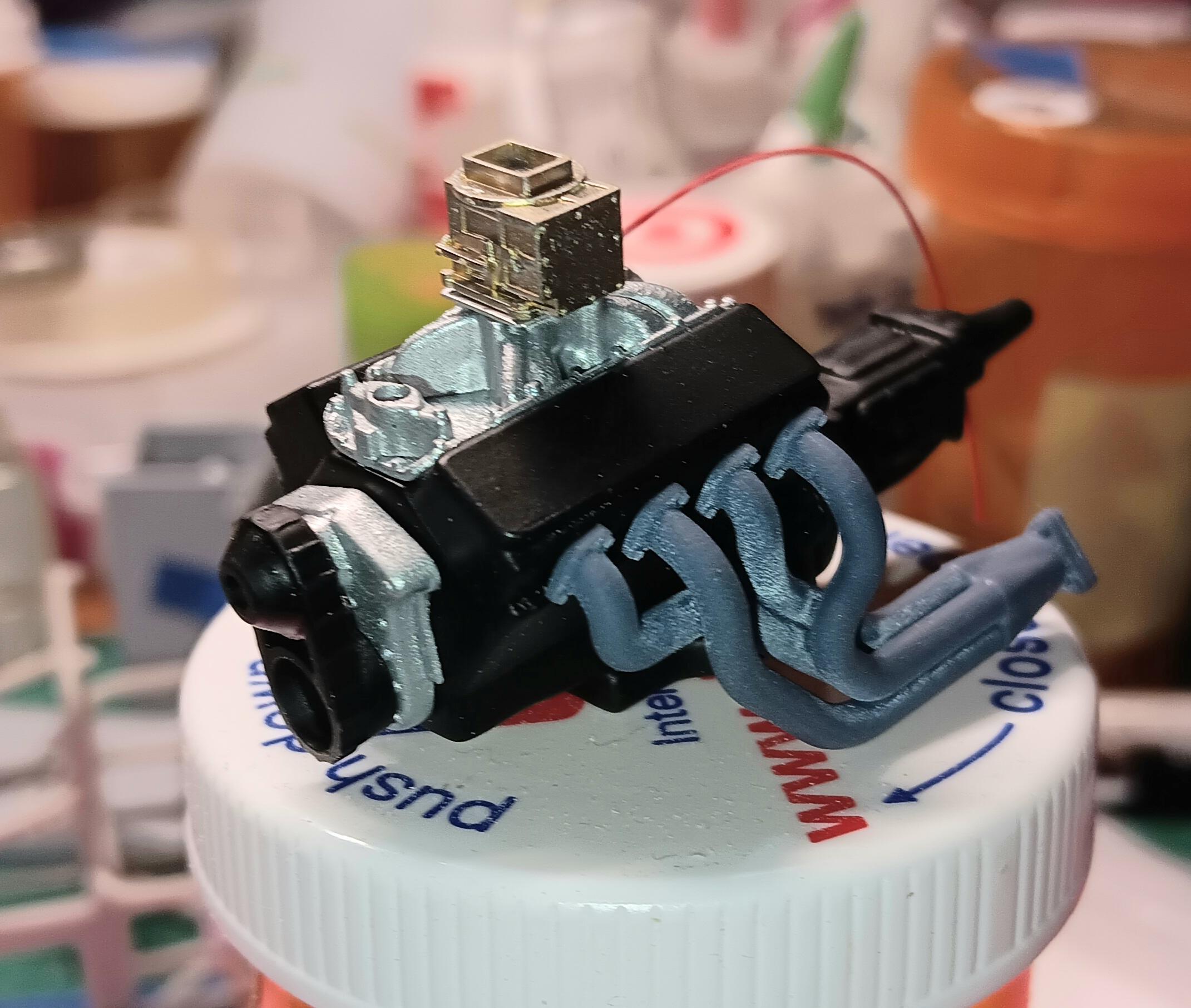

Most engine pieces are painted. I used a 3D radiator (RAD_5) from Ron Coon Resins.
The hood is out of a pavement modified kit. I put a pilot-hole in it until I finalize the .656" hole location. Deflector and air cleaner are Ron Coon items.
  • Like 2
Predator carb is on (CARB_6), from Ron Coon Resins.
Headers are from VCG Resins, pinned with 1/32" brass. These need to be painted and go on after the engine is installed, unless I find out otherwise.
  • Like 2
Magneto is in, plug wires and boots are done. I left the valve covers for last.
The Predator carb sits up quite high. I'll have to drop the engine in tomorrow and see if I have to come up with plan B...

I got the engine to sit right. I made up a tube to better locate the transmission tail shaft.
BUT... the resin headers are a no-go. And the heads are drilled for them.
I'll have to resort to using the kit pieces. I may have to give this one a time out.

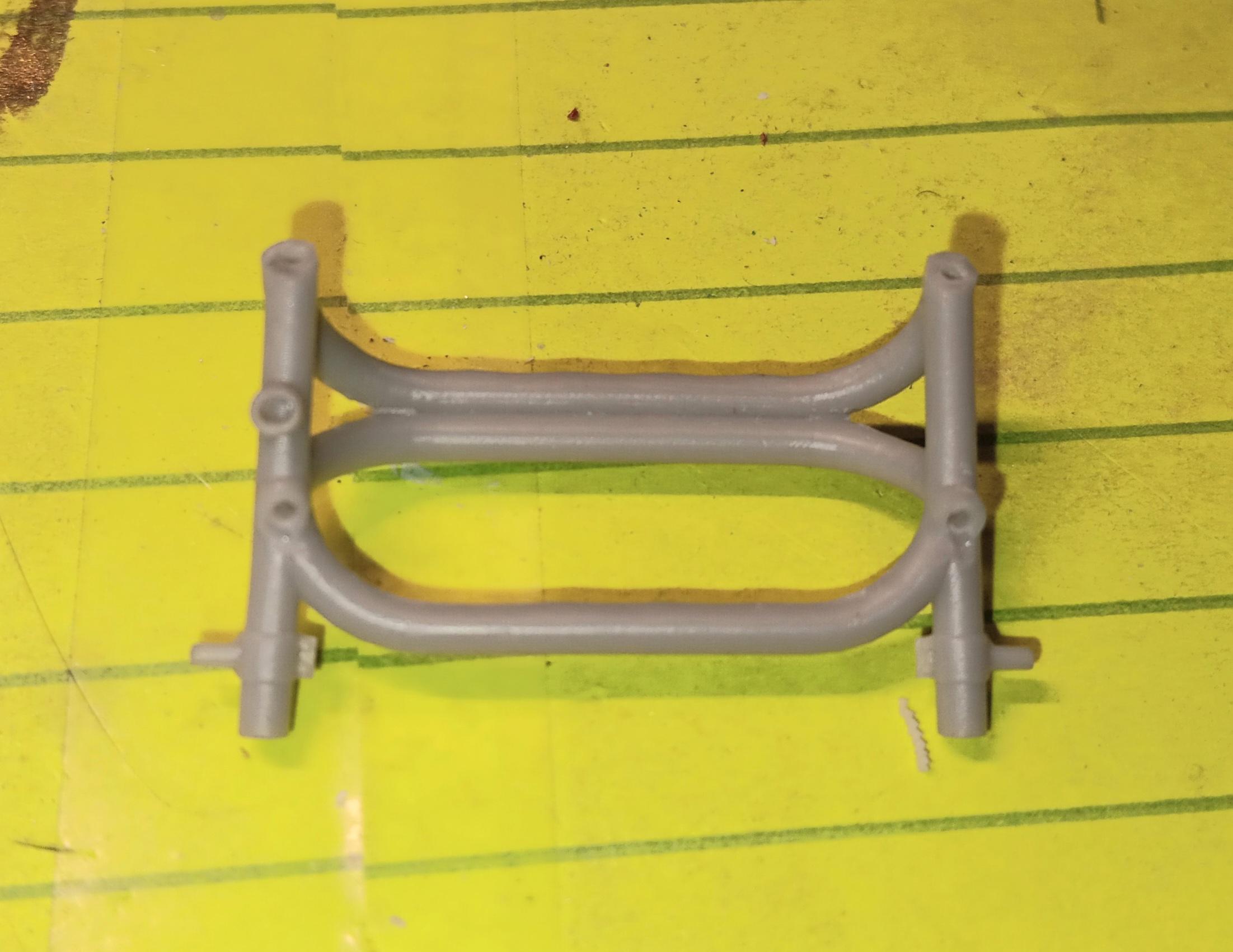

The VCG Resins headers AND the kit headers were not fitting, as is. There are some differences between the printed chassis and the kit chassis.. my bad for not finding this sooner.

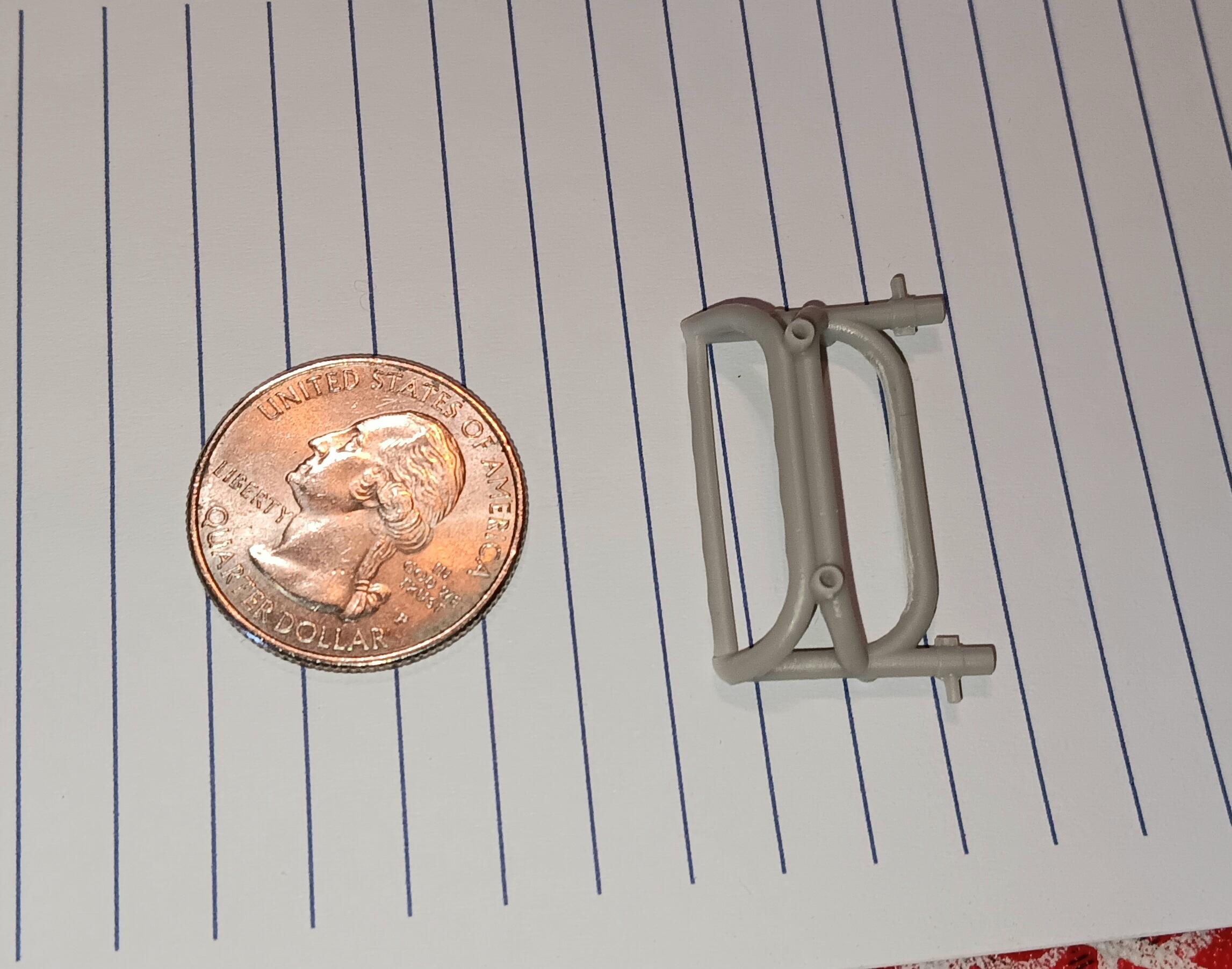

Then somehow I knocked a big piece off the front of the printed chassis, where the front crash bars mount up. I never dropped it or recall manhandling it.
I have yet to locate the missing section. I'll put the cat on it...

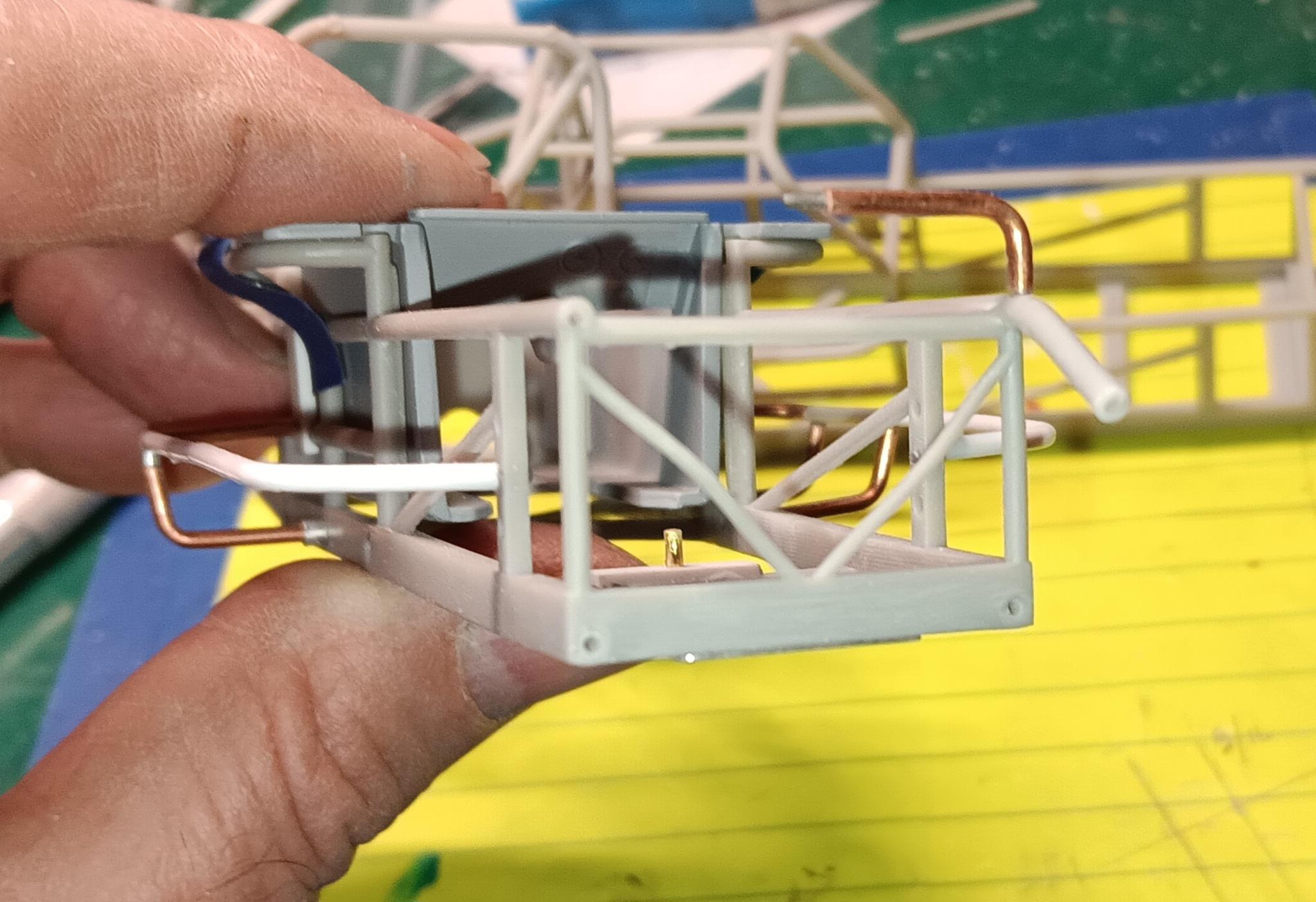

I do have a potential header fix. I took one repaired header from another BACK IN THE BOX!! special and sawed off the flanges.
Drilled some #65 holes in the tubes about 1/8" deep. I cut up and squared up some 3/32" aluminum tubing 7/32" long, sleeved the inside with 1/16" tubing. I did this on the outside tubes only and test fitted it. I think it may work.

Holy ship... I found it!
I 100% cleaned off my table today. Then I was looking for something else... on the floor... and it was staring back at me.

This is the chassis section that cleaved off and wound up 7 feet away.

The headers are in one piece and primered...I have some putty/blend work ahead of me.
I looked at the front chassis piece that broke off. Apparently when 3D resin breaks, it is not a clean break, it sort of shatters like glass.
So I'll have to reattach it and fill in the blanks. It did break off more cleanly towards the top of the chassis.ill pin it and use CA glue.
More broke off than I had thought. Again, I have no recollection of dropping it at any time.
All I can guess is that there might be locked-in stressed in 3D parts, and when they are released... watch out.
I'm lucky to have a spare chassis that I can refer to. Missing pieces I can make from styrene or dig through my box of roll cage parts.
I just got some 2 mm tubing I may try, although the wall thickness is about .025 mm. But 1/16" rod fits inside it

did you print it yourself? if so you can brush more resin on the back of some parts and cure it again. stick some tape on the back of any holes you need to fill and the same process works to fill them too
I bought it. The missing pieces that flew off are... missing.
I made new parts from .080" styrene rod and it looks good. I'll do some putty in a bit and squirter some primer on it.
Edit: Headers are good enough to paint
