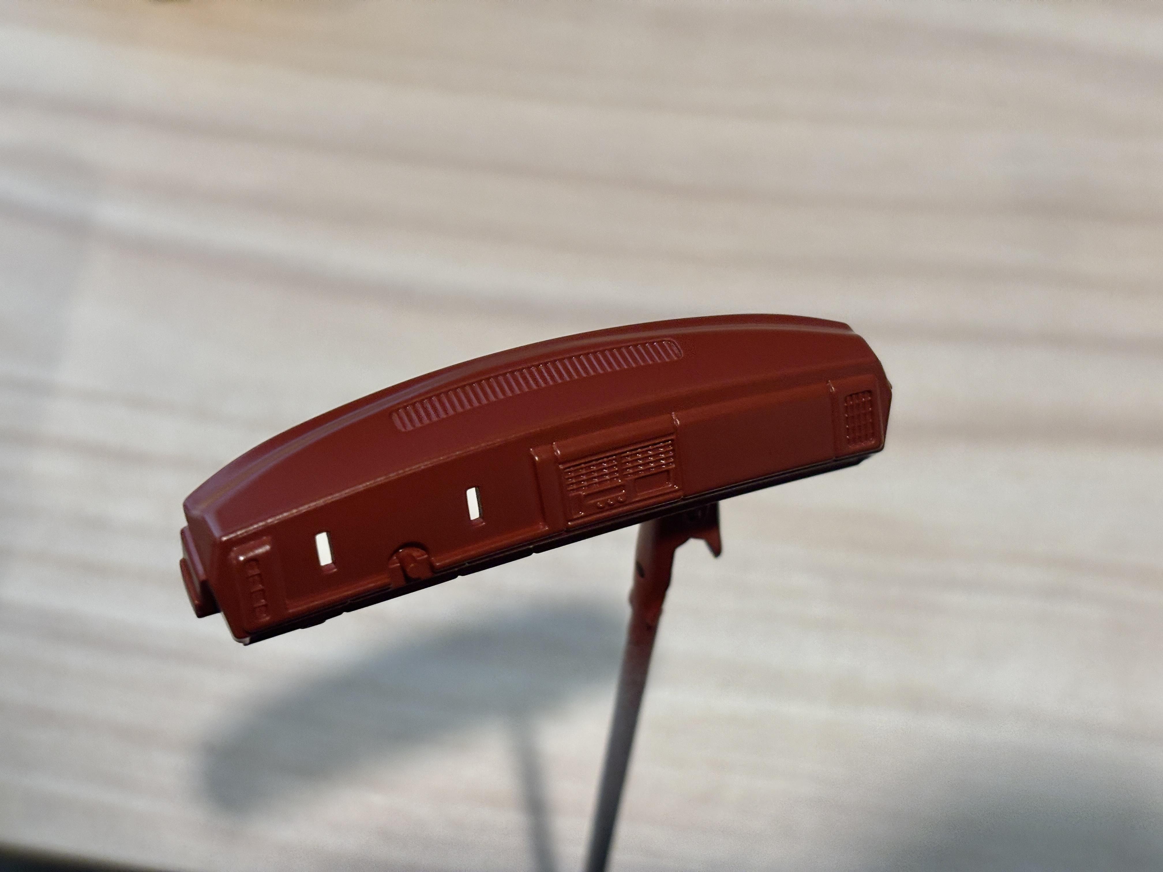

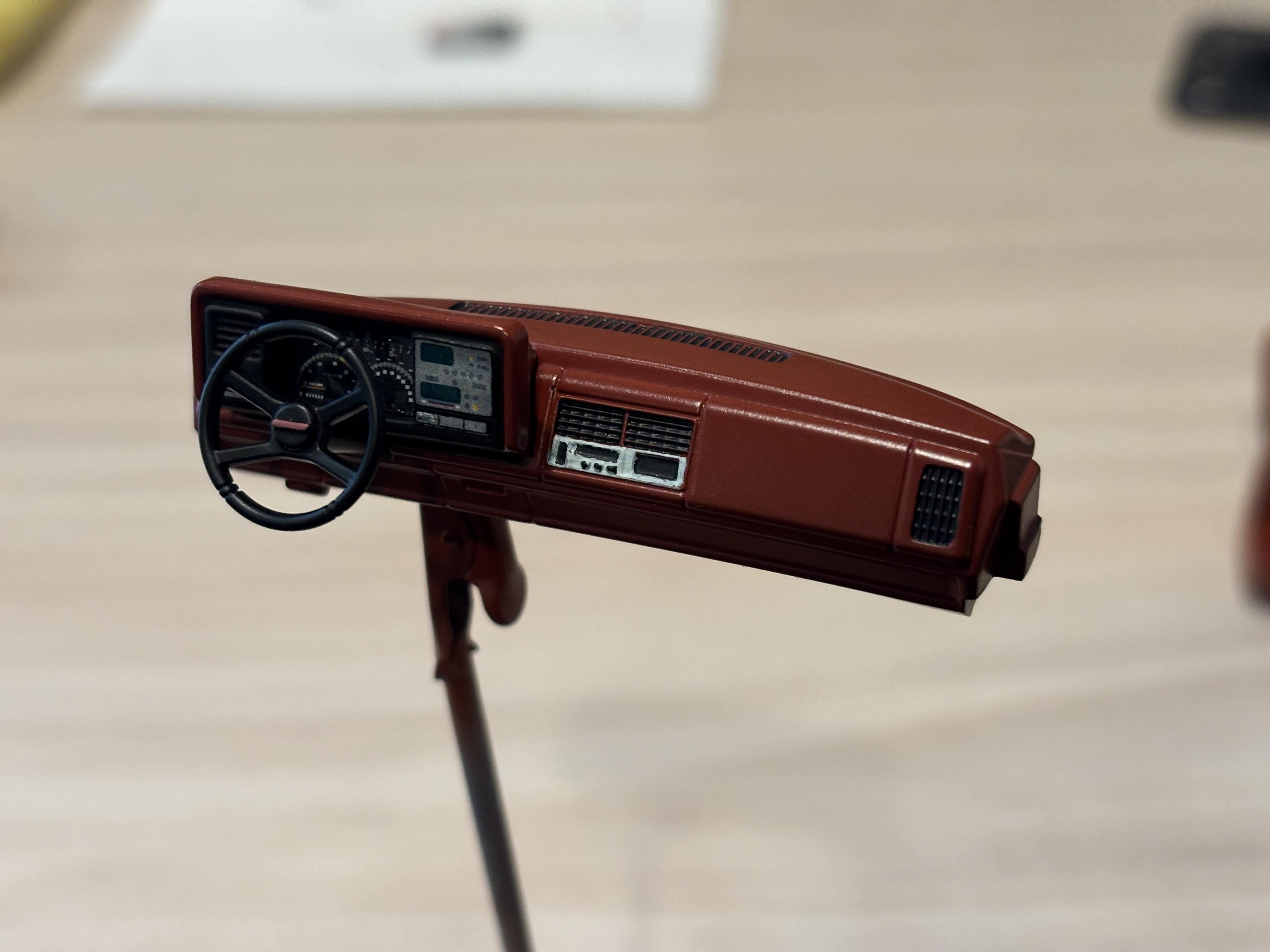

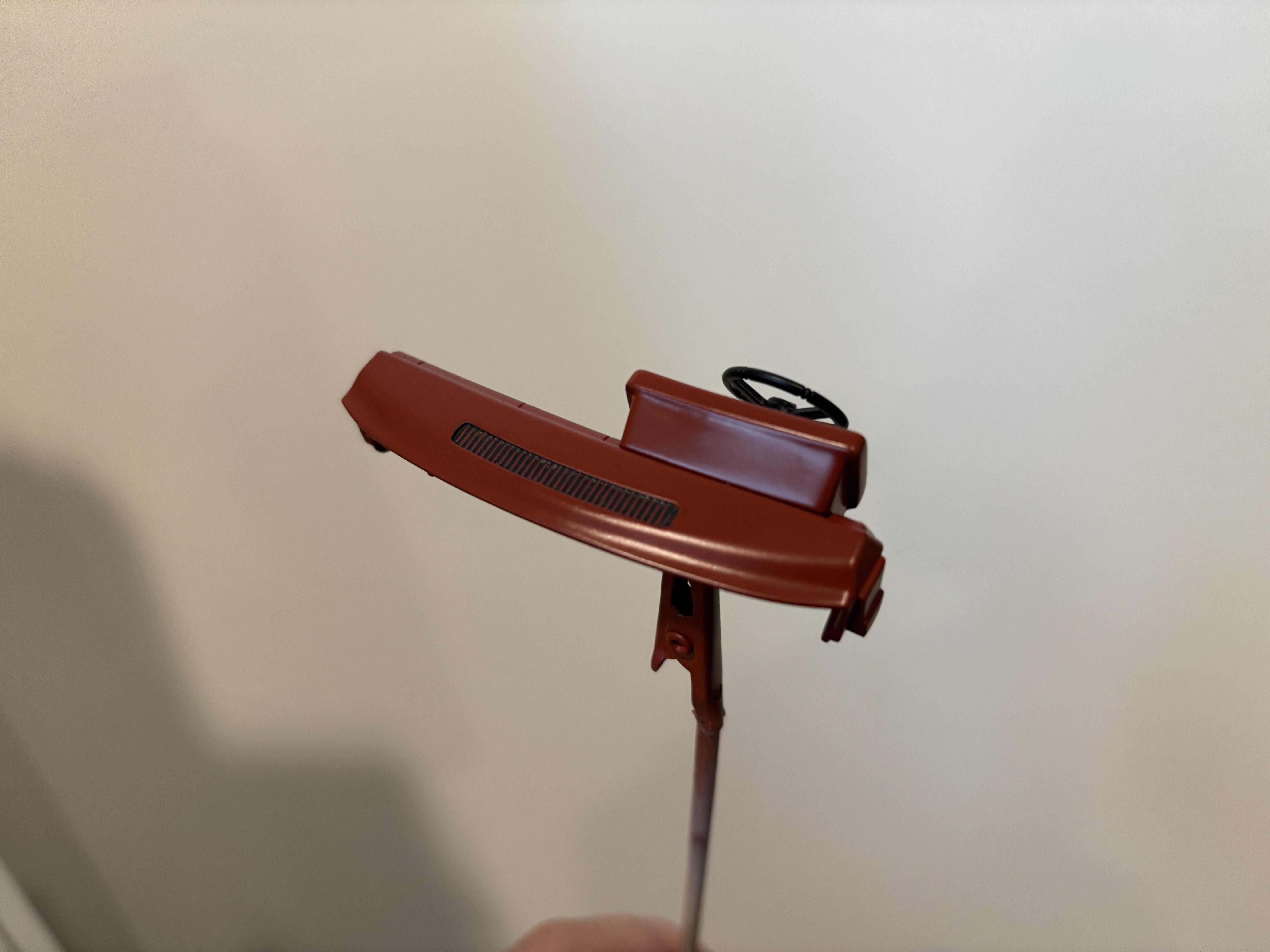

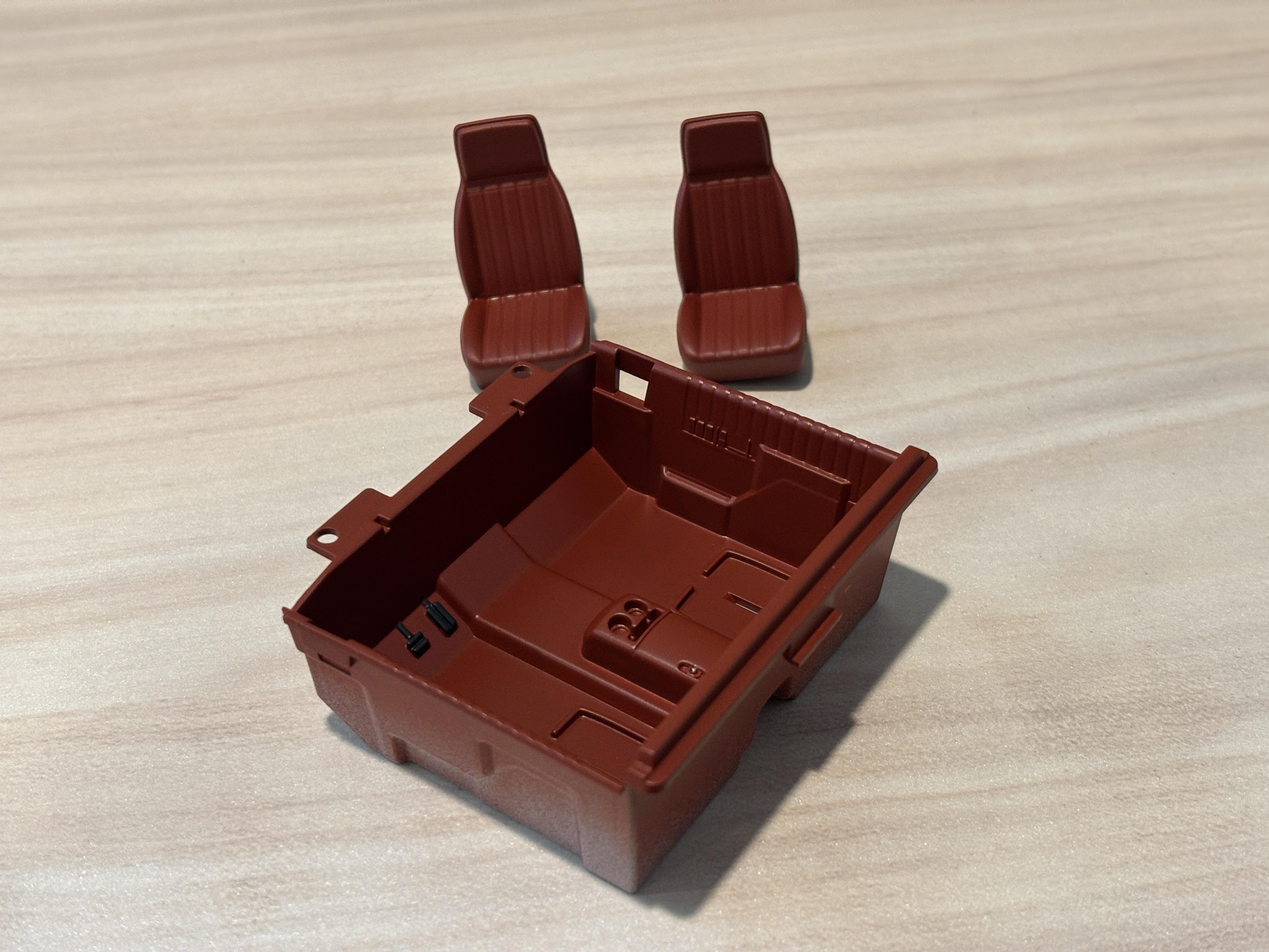

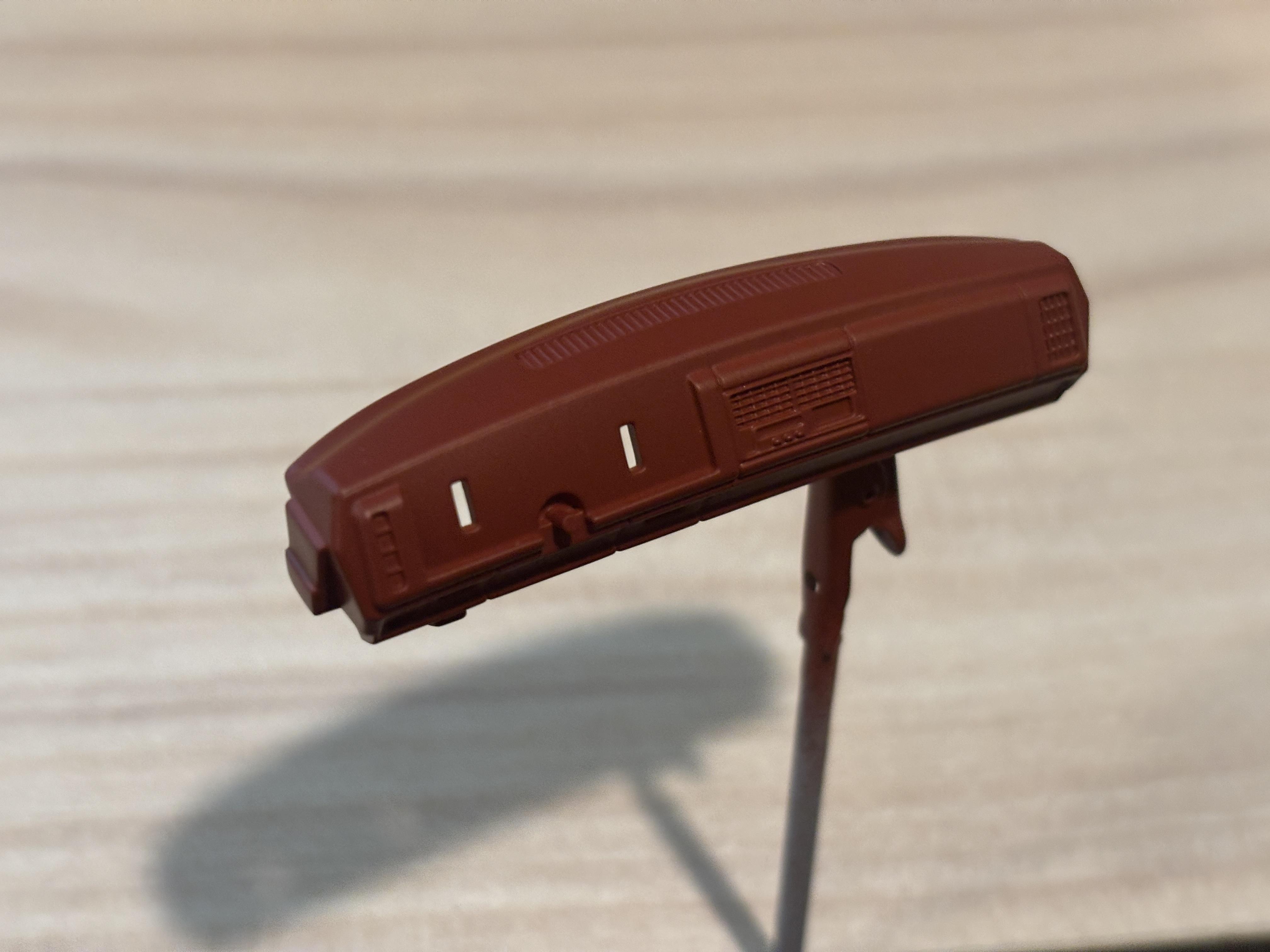

av405 Posted April 7 Author Posted April 7 (edited) I'm still looking at whether I will go for other wheels after this discussion. I'll advise if I change my mind. In the meantime, I did some work on the interior. I'm replicating the Garnet Red interior option, which will be a nice companion to the bright red exterior color. For this color, I went with Tamiya TS-33 Dull Red. The interior tub will get a flocking treatment to simulate carpet. I attempted to paint the door handles/buttons, but the detail is so faint that I'm choosing not to bother. As the paint's name suggests, the dull red is just a dark flat red color. It was a little too flat for the dash: I sprayed the dash components with Tamiya TS-79 semi gloss clear to give it more of the Armor All look that a plastic dash of this era would have: And here is the completed dash: The pinhole on the dash was filled in: For this release, the decal sheet includes decals for most of the dash (radio, instrument cluster, control gauges, etc. I just want to point out a few things: - The decals are too shiny. I suggest giving them a semi-gloss clear for a more realistic appearance. - Trim the outer edges of the decals for better fitment. Especially with the instrument cluster decal. - In my opinion, these decals will not good on an irregular surface. It is hard to get a good look when they are over already molded-in details on the dash. This is why I skipped using the radio decal (which is black instead of a more correct light grey) and a separate piece that goes on the left side of the steering wheel. My dash is a combination of kit-supplied decals and hand painted details. Edited April 7 by av405 3

espo Posted April 8 Posted April 8 Solvaset may help on the really small decals where the dash gauges have raised features on them.

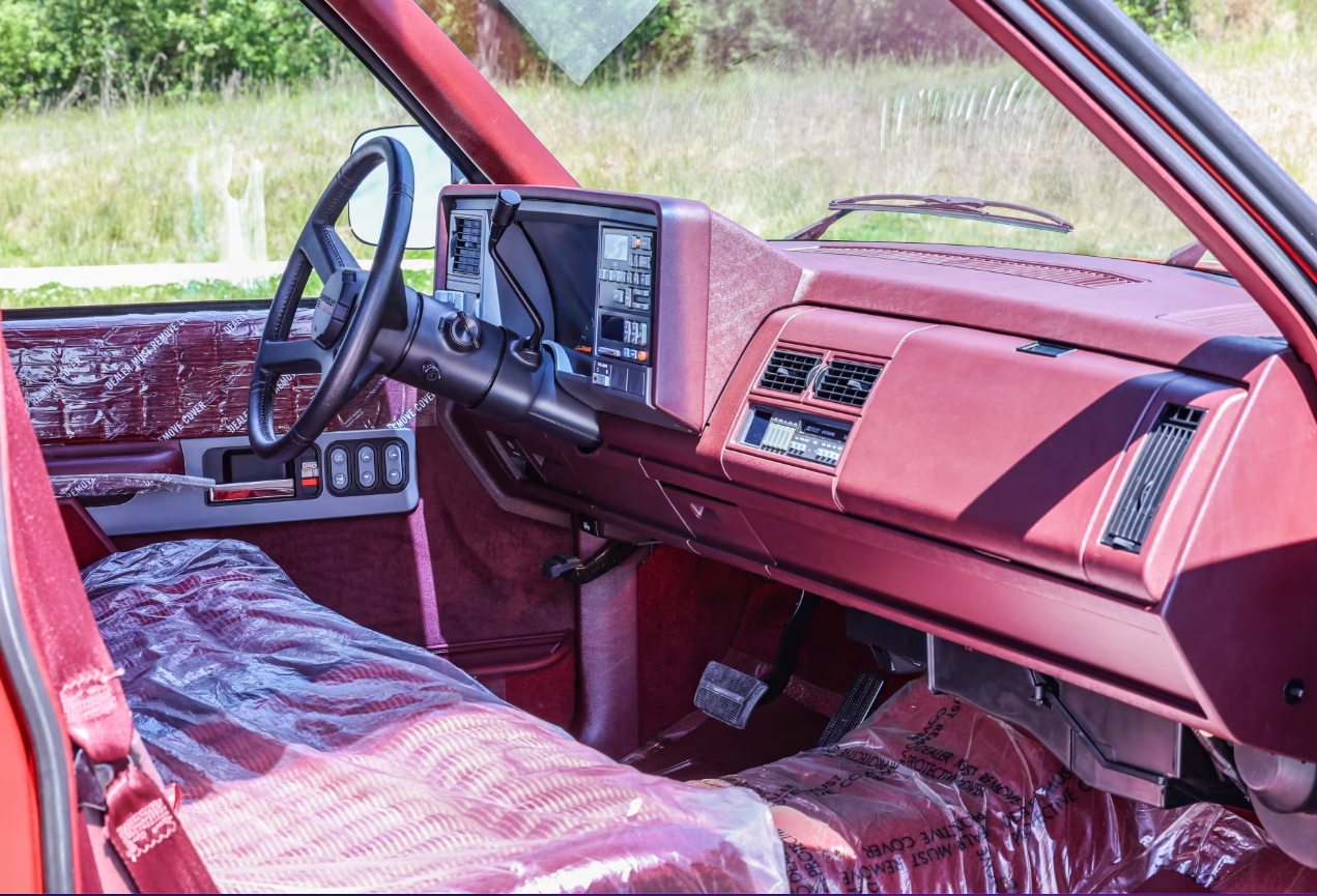

DJMar Posted April 9 Posted April 9 On 4/7/2025 at 8:09 PM, Valvefloat said: That Dull red looks brownish but smooth application. The Garnet Red is a tough color to replicate exactly. It's more of a maroon, definitely brownish red, but not as brown as the Tamiya TS-33. The last time I tried to find a close match I went with a Tru Color paint from their railroad line, I think. The interior finishing is also complicated by the fact that the seat insets and the top of the door panels are a different pattern materiel and have a slightly lighter shade.

av405 Posted April 25 Author Posted April 25 (edited) On 4/7/2025 at 8:09 PM, Valvefloat said: That Dull red looks brownish but smooth application. It is definitely browner than the real-life Garnet Red, but it looks redder in person. Maybe next time I'll experiment with a white primer base to see if the dull red pops just a bit more. On 4/8/2025 at 10:14 AM, espo said: Solvaset may help on the really small decals where the dash gauges have raised features on them. I've found that if the features are too raised or there are uneven features, the decals look unrealistic. But yes, a product like solvaset does help with dash instrument clusters since the details on those tend to be much more subtle. I ended up using the decal for the AC that goes to the right of the steering wheel, but not the piece on the left side or the radio decal. On 4/9/2025 at 10:26 AM, DJMar said: The Garnet Red is a tough color to replicate exactly. It's more of a maroon, definitely brownish red, but not as brown as the Tamiya TS-33. The last time I tried to find a close match I went with a Tru Color paint from their railroad line, I think. The interior finishing is also complicated by the fact that the seat insets and the top of the door panels are a different pattern materiel and have a slightly lighter shade. I agree. TS-33 is about as close as I can get. I also found that spraying some semi-gloss clear makes it pop a bit more, especially on areas like the dash which are plastic in real life. I'm always open to new suggestions regarding paint. I thought about replicating the different shades of red depending on the pattern material, but the detail is just too faint and hard to do for the interior tub. At least for my skill level. On 4/9/2025 at 11:16 AM, titino said: It looks very pretty Thank you! On 4/9/2025 at 11:40 AM, Ace-Garageguy said: Looking like a good build. I think that particular OBS Chevy is the last really good looking pickup GM built. Clean styling, nothing forced or gimicky, just a truck that isn't stoopid huge, is at the right height to actually work out of, and isn't trying to be a luxo ride. I must like 'em. I have 2 real ones, a '92 extended cab Silverado and an '89 GMC longbed fleet stripper. OBS trucks have really grown on me the last few years. And I say that as a Ford guy! I personally think the GMT800s were the last good looking GM trucks. They rapidly went down hill after that. On 4/12/2025 at 8:55 PM, slusher said: Dash and interior is looking very nice! I have been hopeful that maybe hobby lobby would get some of these trucks in! Thank you! The interior is done. I applied flocking to the floor to simulate carpet. I left the side door panels alone as I just found the detail to be too faint or non-existent to paint. Again, something else that I find disappointing about this kit since it is a new tooling. The interior may be too brown for some when compared to Garnet red, but I don't have a better alternative at the moment. The body parts and bumpers are all primed. I started with Tamiya Grey Primer and moved up to Tamiya Pink primer. I no longer use Tamiya primers as I am now an avid fan of the Mr. Hobby/Mr. Surfacer line of primers, but these are still good and I wanted to run through my old supply. I also wanted to see how the Pink primer would help with getting me close to the real truck's bright Victory Red paint. I'll sand the body down with some 3000 grit sponges before applying the paint coats. Speaking of paint, I will be using Tamiya TS-49 Bright Red to replicate GM Victory Red. I tested it out on the hood and liked the look of it: It looks like a close enough match to the real thing: Up next, I'll be working on the grill and headlights. Edited April 25 by av405
DJMar Posted April 25 Posted April 25 Looking good! I think the exterior paint color is right on, and it's as close as you can get to the factory color from a can. Any idea what you're going to do for the mirrors, since the new kit doesn't have the "correct" ones? 14 hours ago, av405 said: The interior is done. I applied flocking to the floor to simulate carpet. I left the side door panels alone as I just found the detail to be too faint or non-existent to paint. Again, something else that I find disappointing about this kit since it is a new tooling. Comparing the two, the newer kit has deeper engraving on the interior bucket, dash and seats, but the fabric detail is much more pronounced on the old kit, especially on the seats. I'm not an industry insider, so I don't know how much of this kit is actually new, and how much of it is simply a modification of AMT's original tool. Obviously, the grille and chassis and wheels and tires are new. But so much of the rest of the kit is dimensionally the same as the old, albeit with sharper engraving or different attachment points on some parts. New or modified? I couldn't tell. Just my two copper, but the original AMT glue kits (Sportside, 454SS, etc) were great models, even though they had some issues. You couldn't go to a contest in the early to mid 1990s without seeing a bunch of them on the table. Personally, I would have been much happier with a straight reissue of the old short bed kit, warts and all. My hope is that they didn't destroy the original molds to give us the new curbside.
