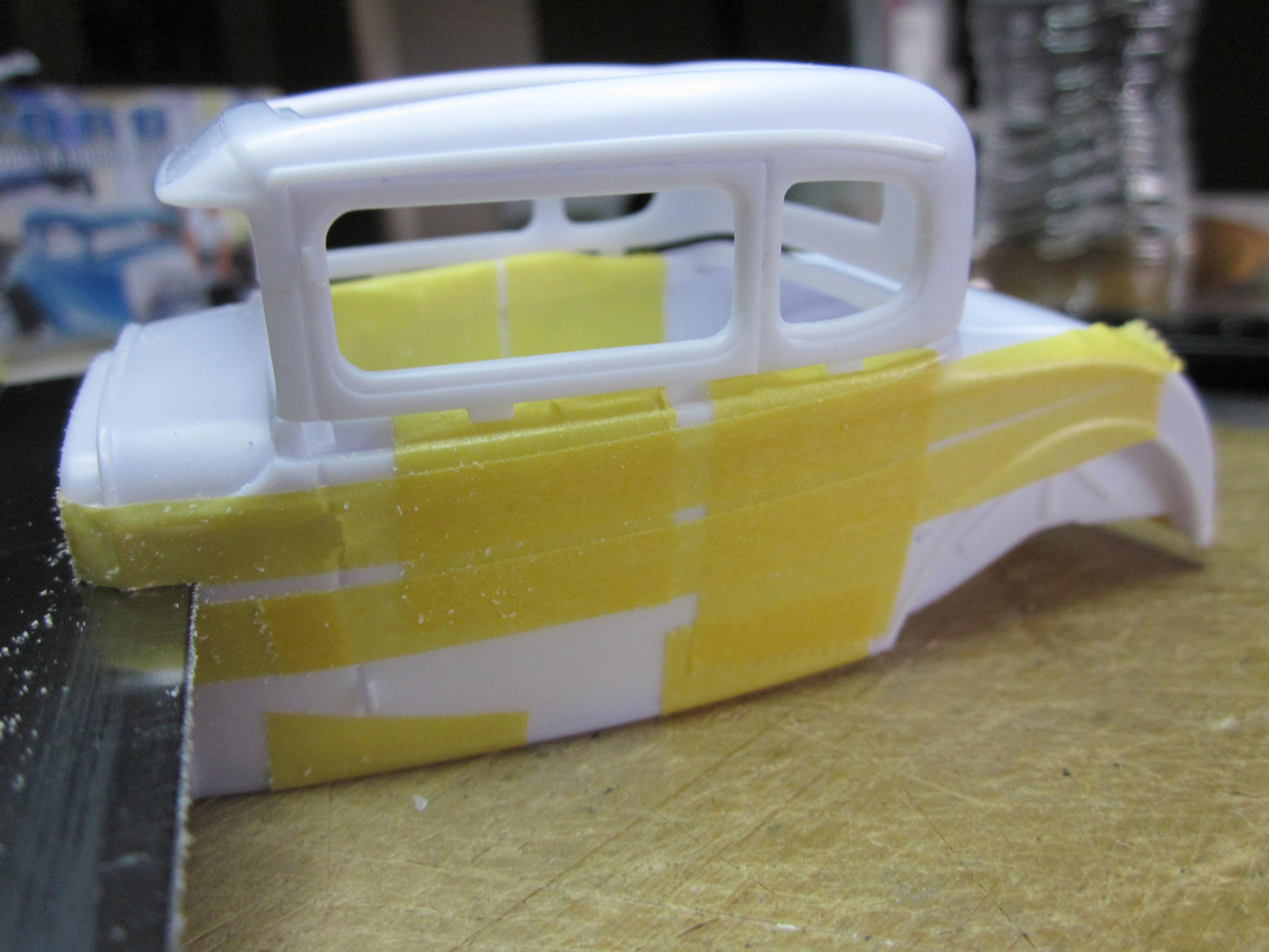

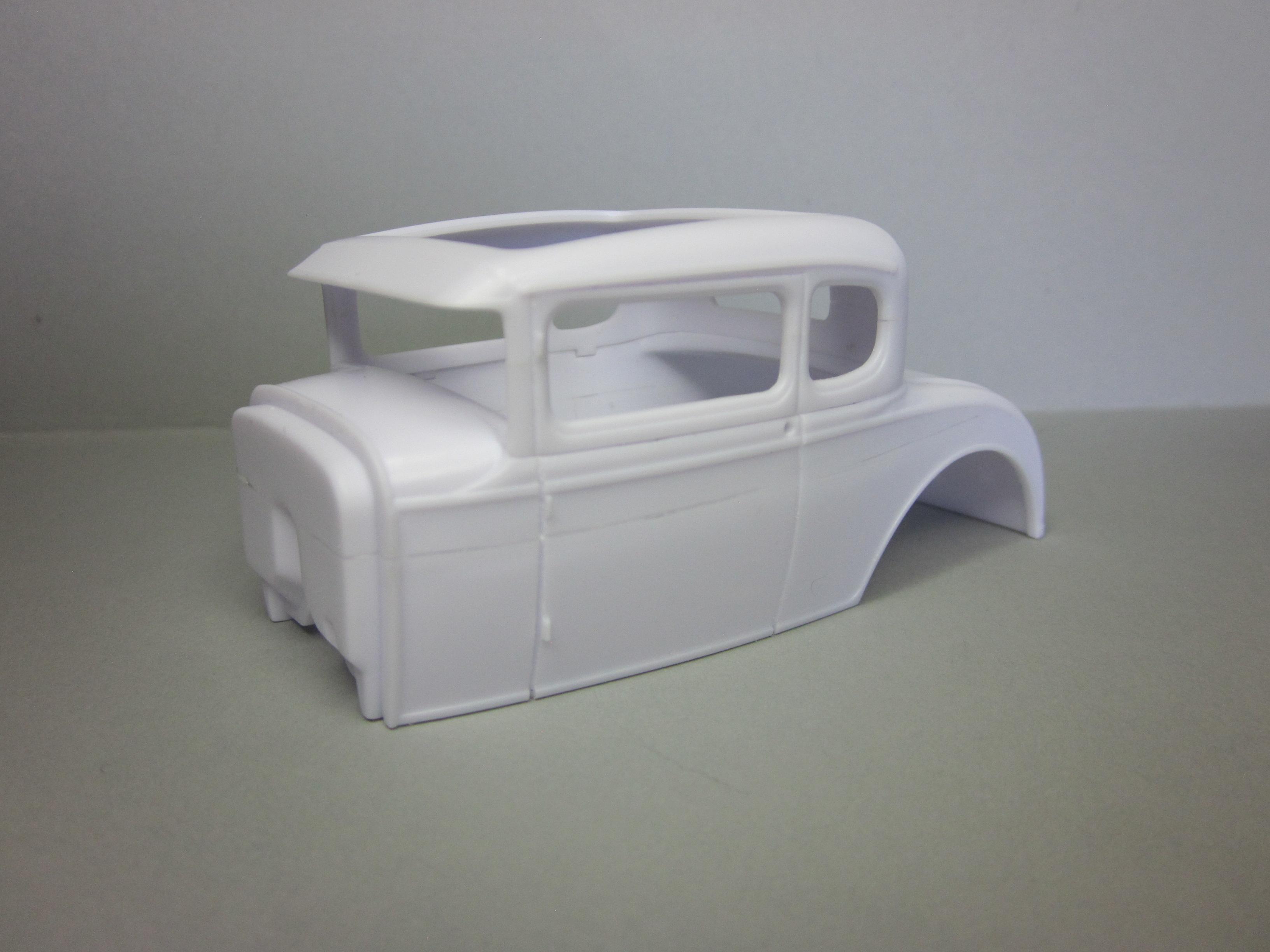

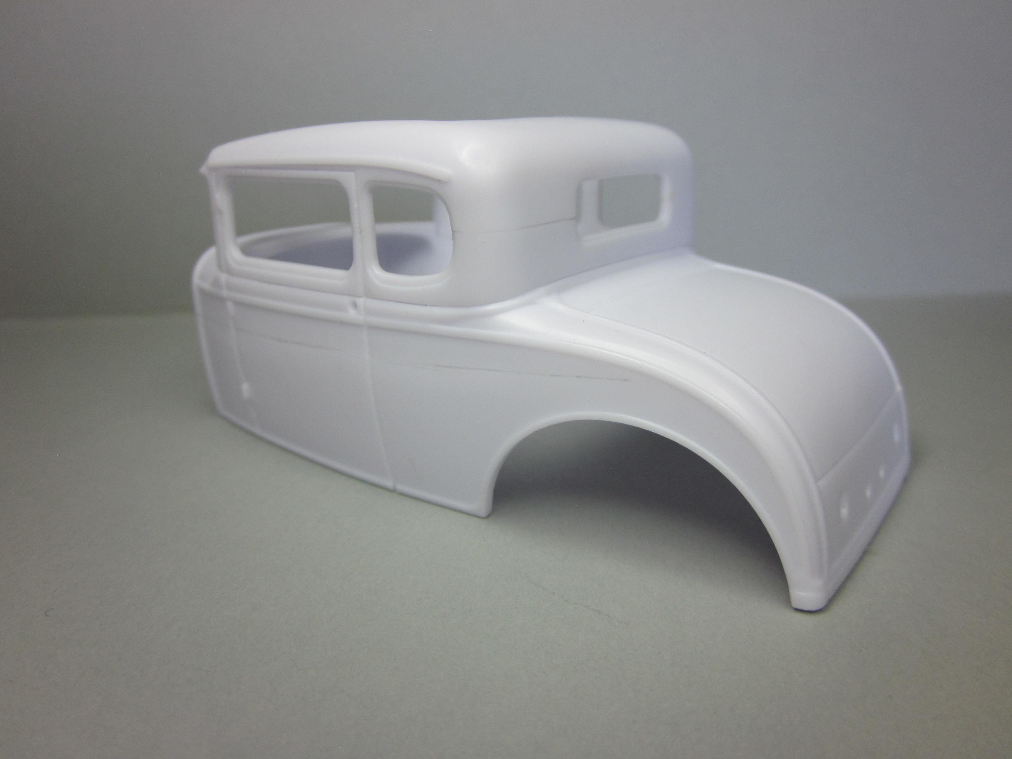

So the next mod was for the body. Plan is to take 2-3 inch wedge cut out of the body. The interior side panel's and fire wall were taped to the body.  The side panel will be used for locating the first cut. If you look at the second picture you can see the blade cutting through both the body and door panel at the same time. It was important that the cut is perfect separating the top of the door panel from the bottom part of it that has the pleats. The next cut took out 2-3 scale inches tappering from front to back. Things were cleaned up and the body was glued back together. No putty here, just ca glues to fill all gaps. You can see by the cut line, It was a challenge at times. The top is not attached yet.

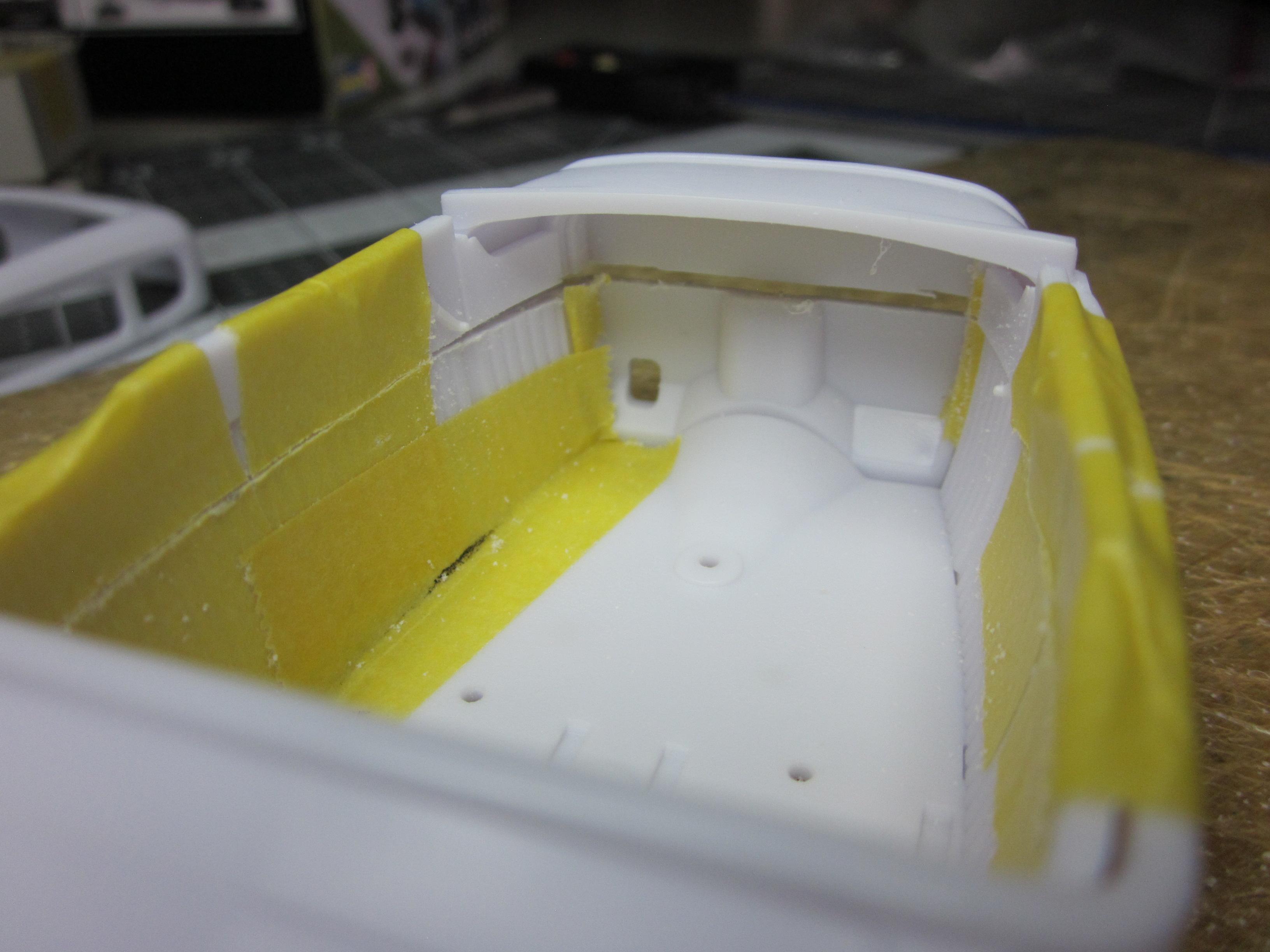

With the wedge in the body done, filling the top is next. Using the kit part of course, test fitting shows the top filler sits too low in the body. There is a channel that the filler panel sits on that needs to have some material added to get the filler panel sitting were it needs to be. Using some .026 sheet, strips were cut and added to the channel in the top. Things were cleaned up and the top put in place to check the filler panel fits correctly. Since the filler panel was raised,the bottom side now needs material added. Using the needed thickness of evergreen sheet, a panel was made to fit the bottom side of the filler panel and glued in place. The filler panel is now ready to be installed using some ca glue. No filler's were used to fill gaps, just the ca glue, then sand and repeat as needed. Next, some primer was sprayed on and sanded smooth a couple times, till things looked good. While I was at it, I recessed the license plate and added a little something to the lower leading edge of the cowl.
