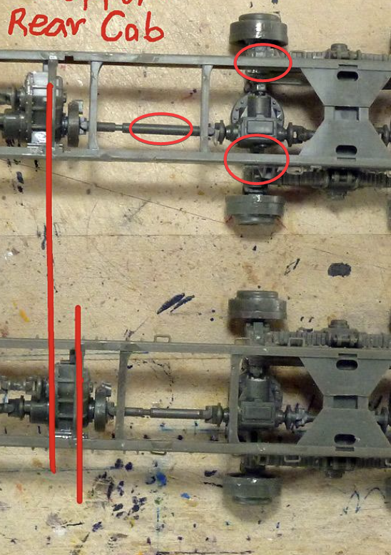

Warren D Posted Thursday at 07:02 PM Author Posted Thursday at 07:02 PM The non-GT M51 dump truck showed up yesterday afternoon. The chassis is mostly together, enough so that you can see the difference between the long chassis rails the instructions call for and the correct, shorter rails that are for the dump truck. In the photo, the long rails (A1/A2) are on the top and just removing 15mm from the back clearly won't make it work. With the rear axles lined up, you can now see that the rear cab mount is too far forward as is the front body mount and front axle. Building this way leaves too much space between the back of cab and front of dump body/gun box. I received word today that the replacement parts are in and will be shipping out to me in the next few days. I'll continue using the borrowed parts from the straight dump truck kit to complete the gun truck build.

ksnow Posted 6 minutes ago Posted 6 minutes ago Nice work on this truck. Could you save the too long chassis by sectioning the frame rails and drive shaft where the ellipses are in this pic?
