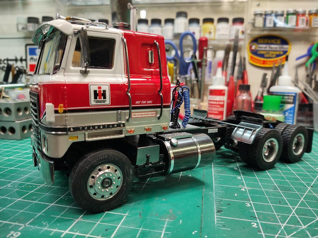

I decided to not paint the chassis flat black but lo leave it as it is!
Here's a little mock-up:
The exhaust (heat shield) is from a Volvo F12 Globetrotter. The end pipe is printed.
Wheels are painted. I'll mount them later this evening probably!
The space between cab floor and engine is very thin so I hope to get the cab in a position where it doesn't touch the engine and still isn't to high. The great challenge will be to fit in the shift tower.
  • Like 1
A mock-up to see if the cab will fit over the engine without collisions:
Up to now everything fits perfectly!
Quarter fenders are just mocked up, they still need a bit of adjustment.
The rear panel, fifth wheel, battery box and air cleaner are permanently in place!

The shifter fits perfectly and the tilting of the cab will work fine!
It's still a bit shaky though cause the tilting axle I used here is too thin. It's just for try outs.
 I also printed the grille and side trim.
Looks OK! Maybe It could use a bit of improvement though!
  • Like 1
