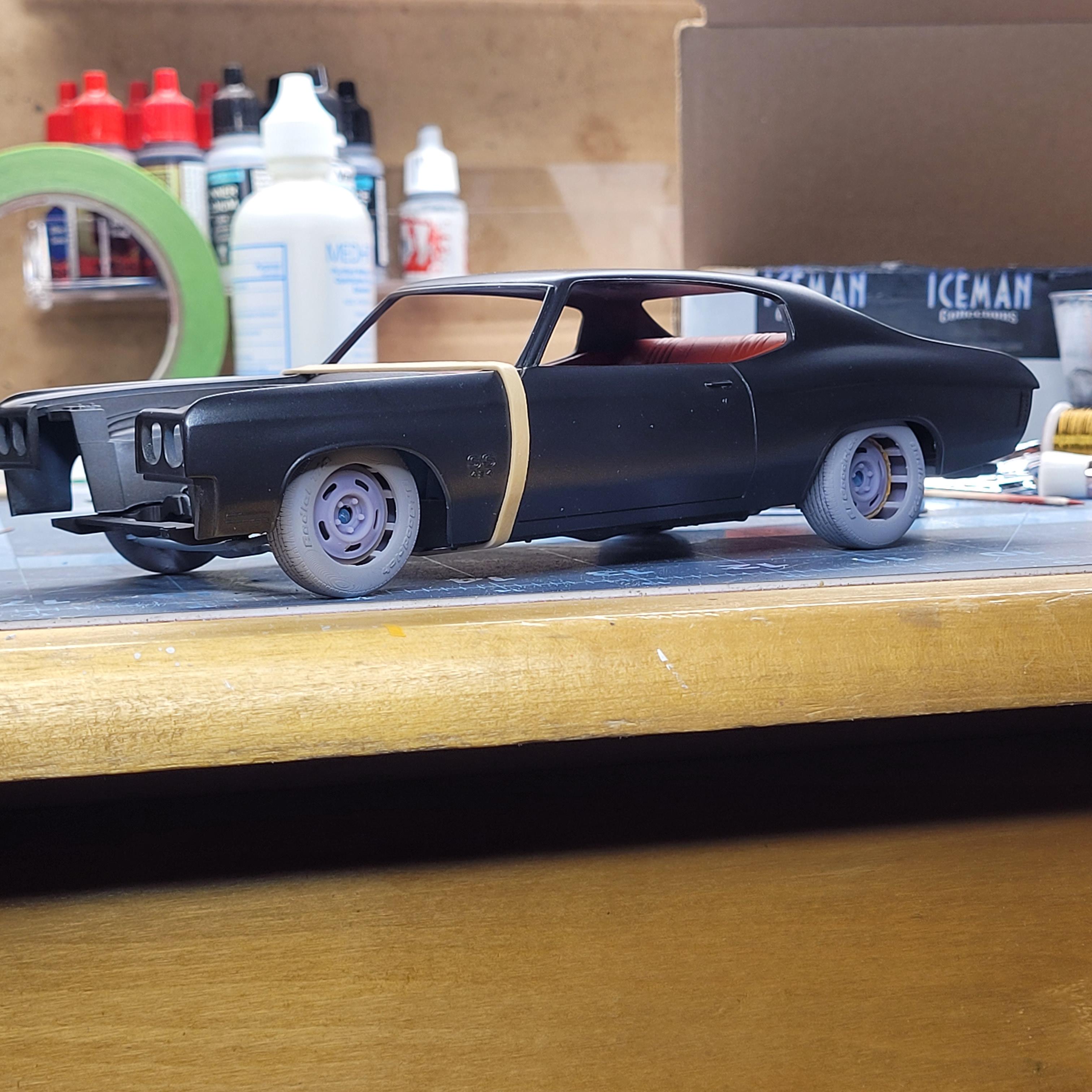

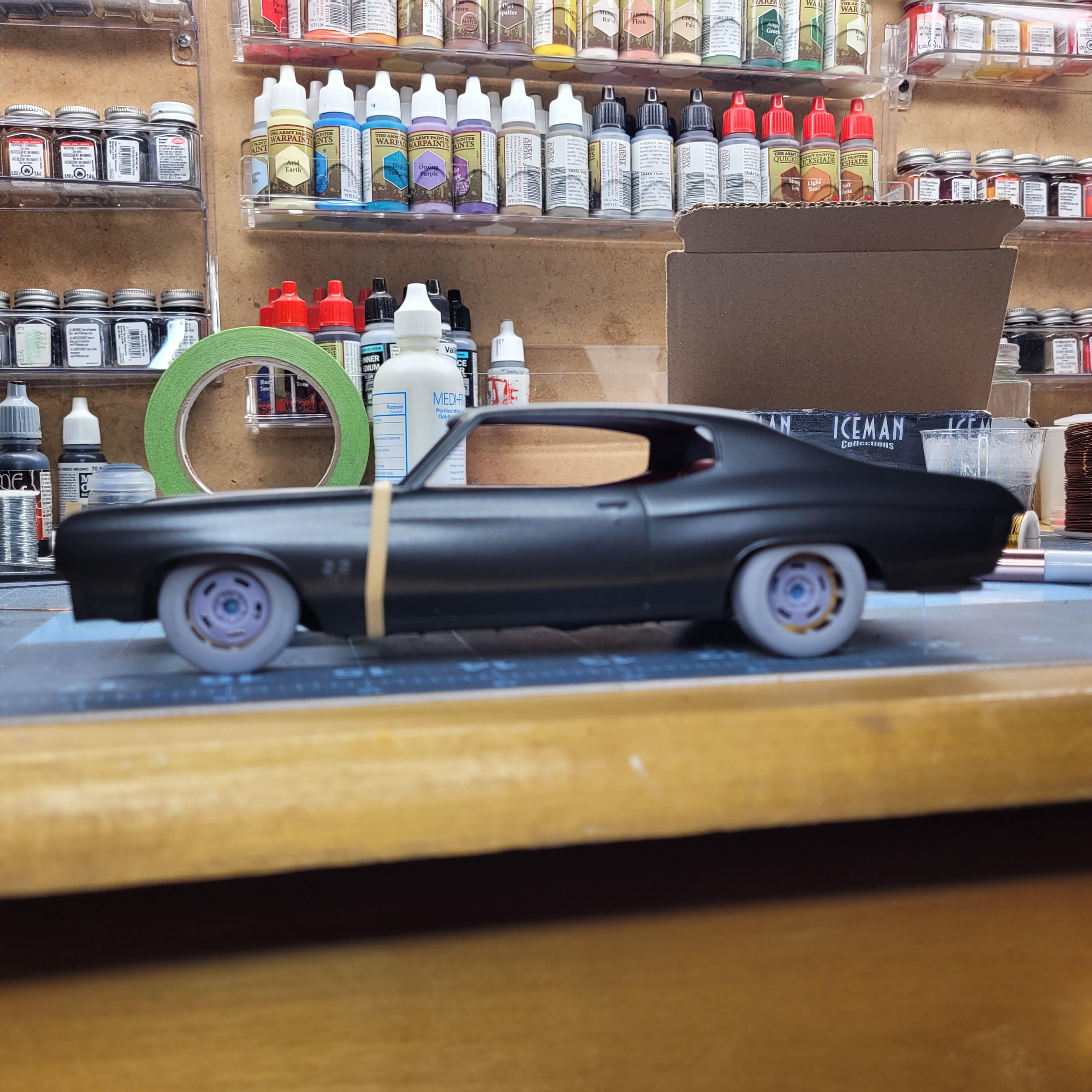

Spent most of the morning lowering the suspension and adapting the wheel backs to fit the new wheels. Here's a shot of the stance, let me know what you think

I like it.. stance is nice. How'd you go about lowering my favorite kit there my dude?
Thanks to both of you,gonna try and make this one stand out. I'll post some pictures on how I lowered it. It was fairly straightforward. No real butchering of styrene.

Here's how I lowered it. For the rear i removed the kit trailing arms and made a set of tubular arms,and hollowed out the pockets to the same depth,.080 rod for the arms. 17511297134975038168020210714280.jpg.0181e40201de6e31530c79159ced3297.jpgI also lowered the mounts for the rear assembly about the same, after drilling the locating hole deeper. 17511298731994086387418115822543.jpg.8bbf42f7a6b39eef98217ade0141f921.jpg17511300524055606036043407443379.jpg.c541e63c2d880a0abc61ef78cd29803a.jpg I stopped when this part of the rear differential touched the chassis
On the front, i originally goofed up just trying to "channel" the front assembly into the frame,17511304929766141489455132226918.jpg.1c1694a52829146d5946eac4390a158f.jpg so I moved the spindle mount up towards the upper control arm.17511304065281899369565138848691.jpg.671f2ef24073376e903dd288e7e4197b.jpg Had I not made that mistake, it would probably be lower in the front, but I'm not looking for a "slammed" look. The final part was to remove about .040 from the bottom of the firewall and inner fender, that tucked the chassis up underneath so the frame isn't showing from the side. 17511306334426275333801434390369.jpg.ca5ea235154736dab17e08ea1a01f00d.jpg17511308578831373357300326121375.jpg.13666e6732648f11000c5c6f3c9eb559.jpg

Thanks. It wasn't all that difficult to do, getting the wheels to fit properly wasn't a chore either,I just hope the paint and chrome work on them work out.

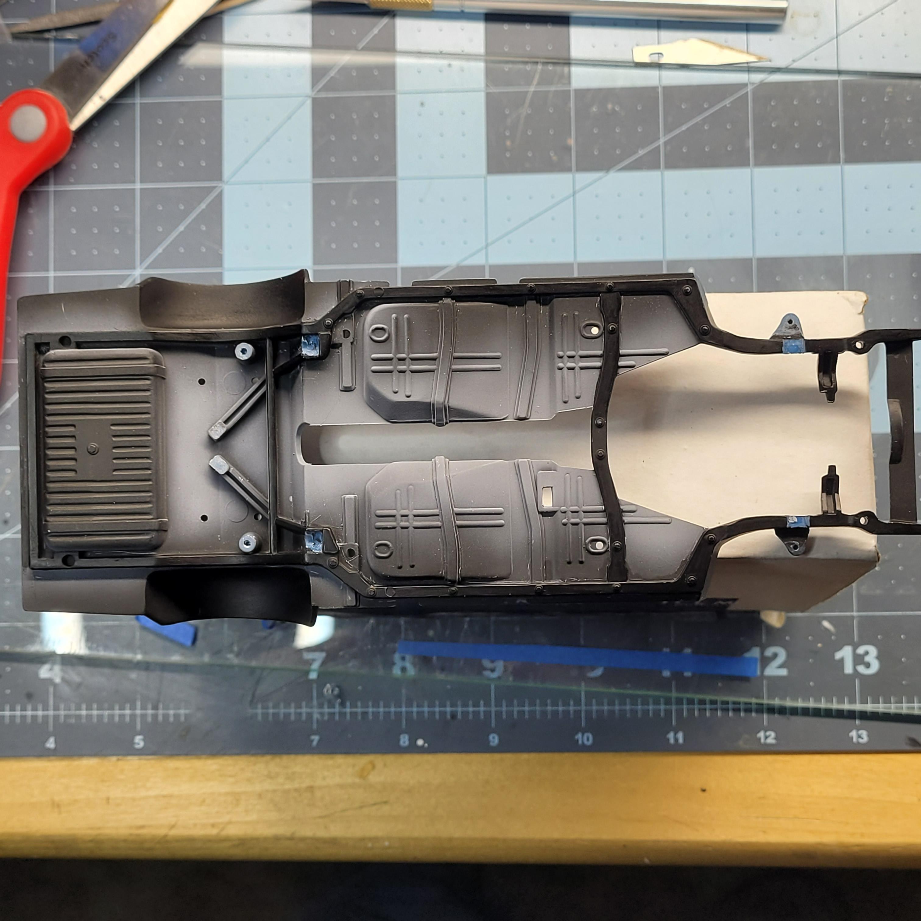

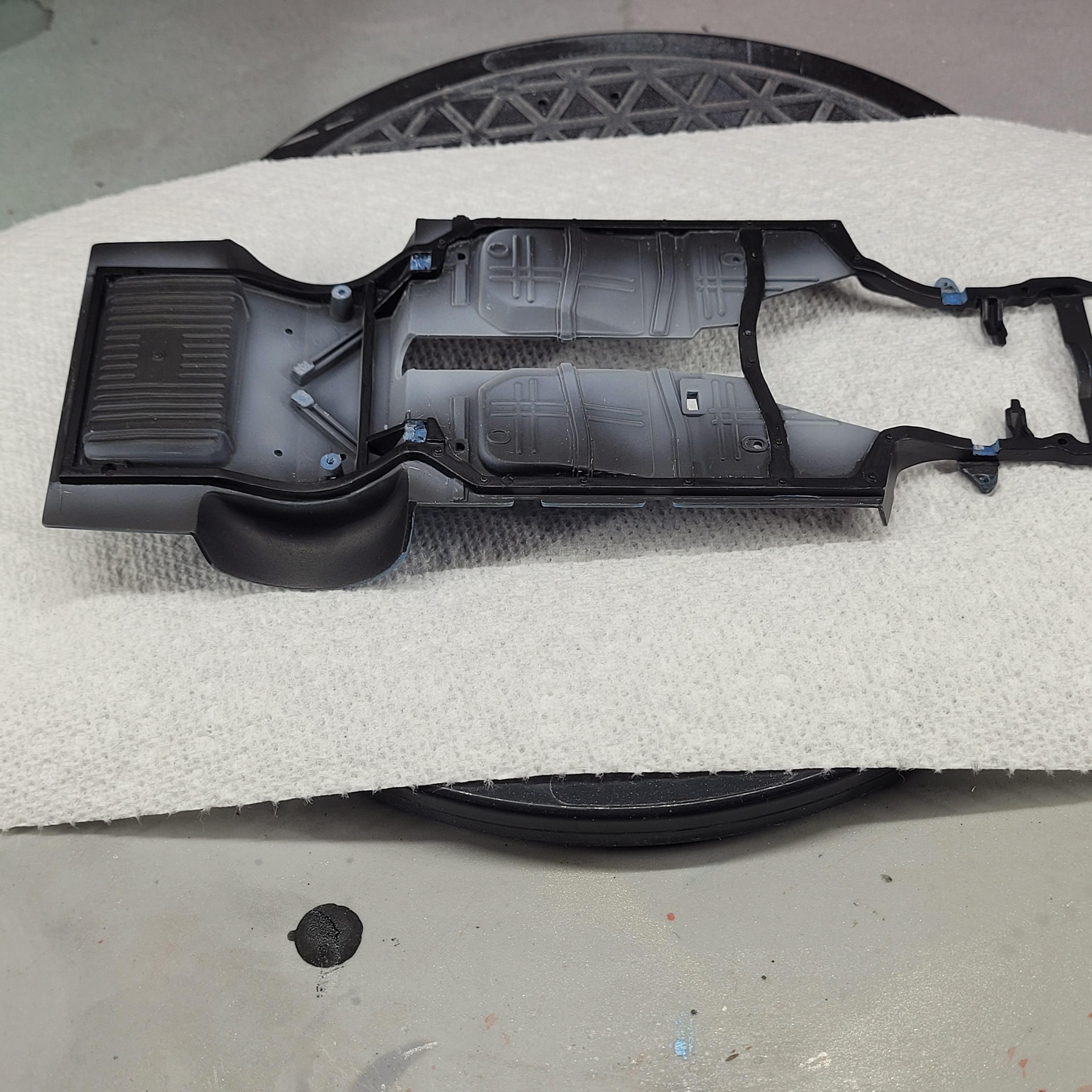

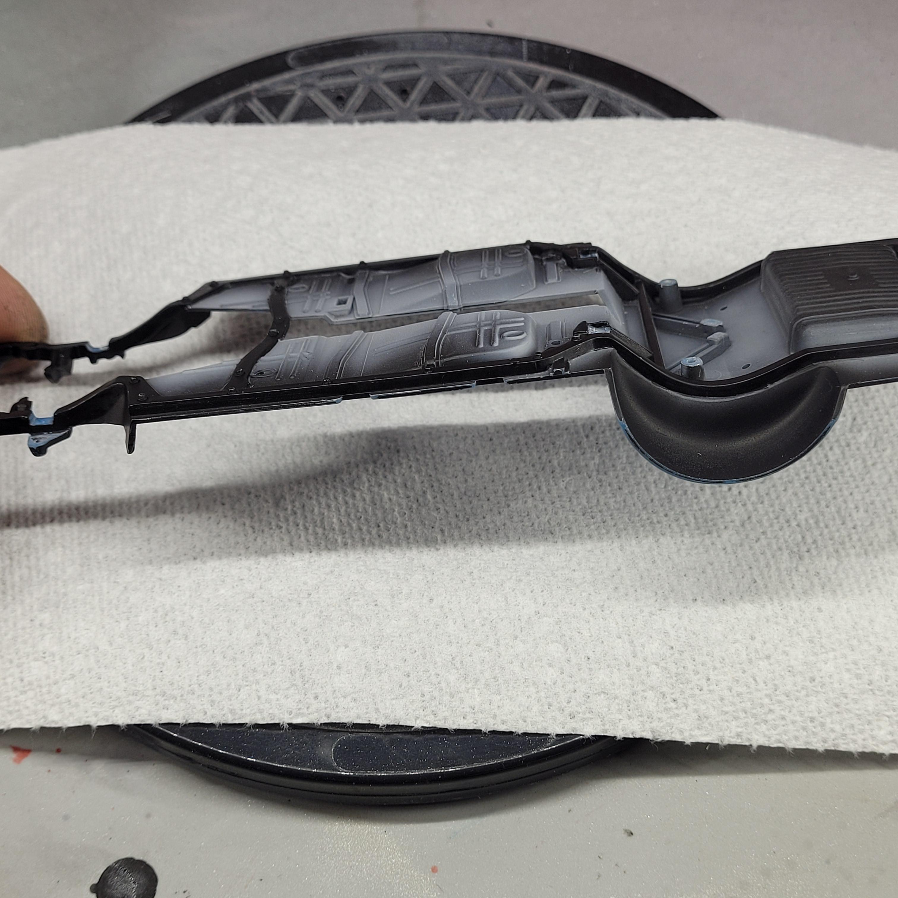

Got a little more done tonight. painted the chassis, I wanted this to look like a fairly correct restoration. There's primer overspray, varied coverage of paint,and I tried to include the factory undercoat on the rear wheel wells. There's a couple different blacks, and different sheens,I'm horrible with photography so I'm not sure it shows up well. I still have to do the tank,straps and some subtle weathering.
  • Like 2

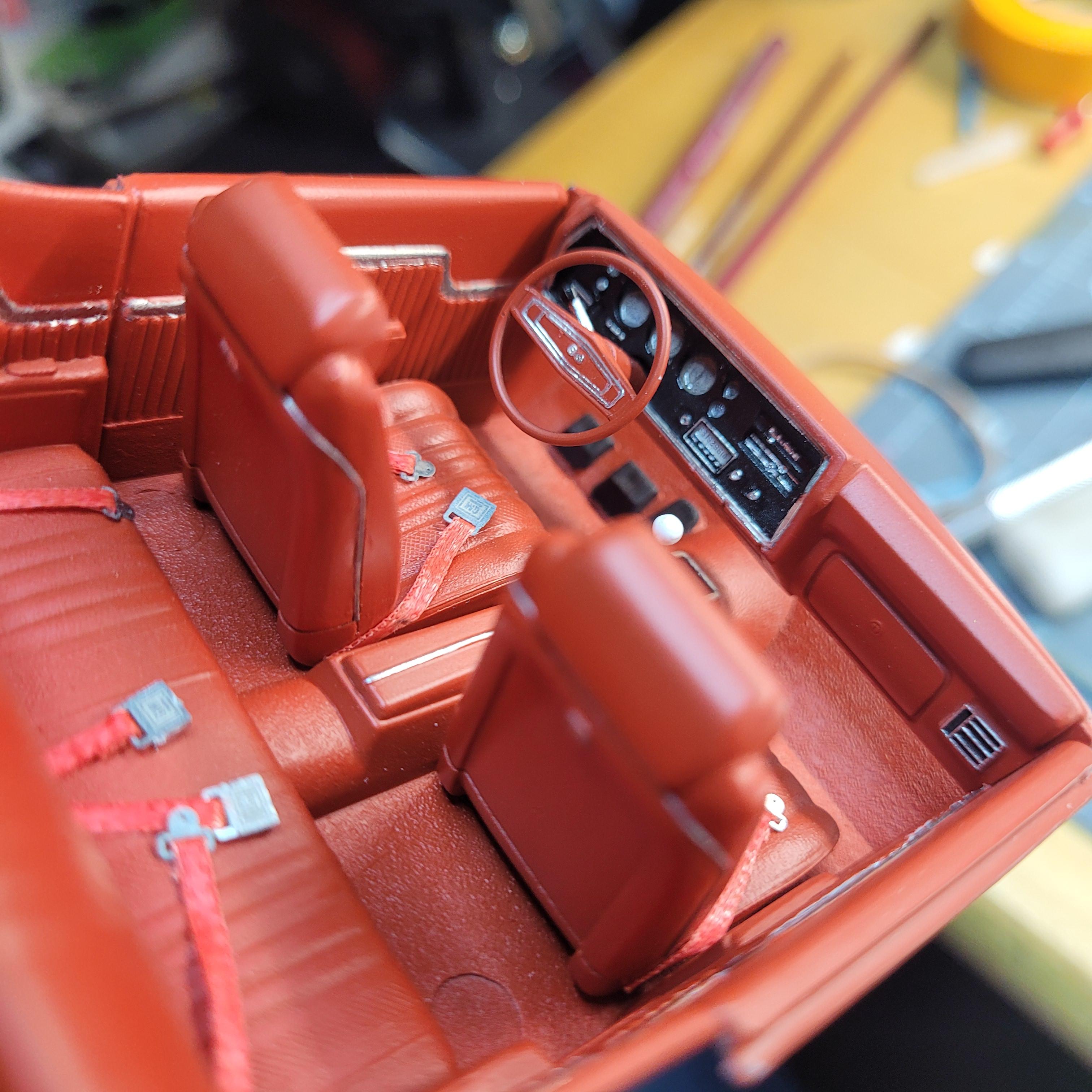

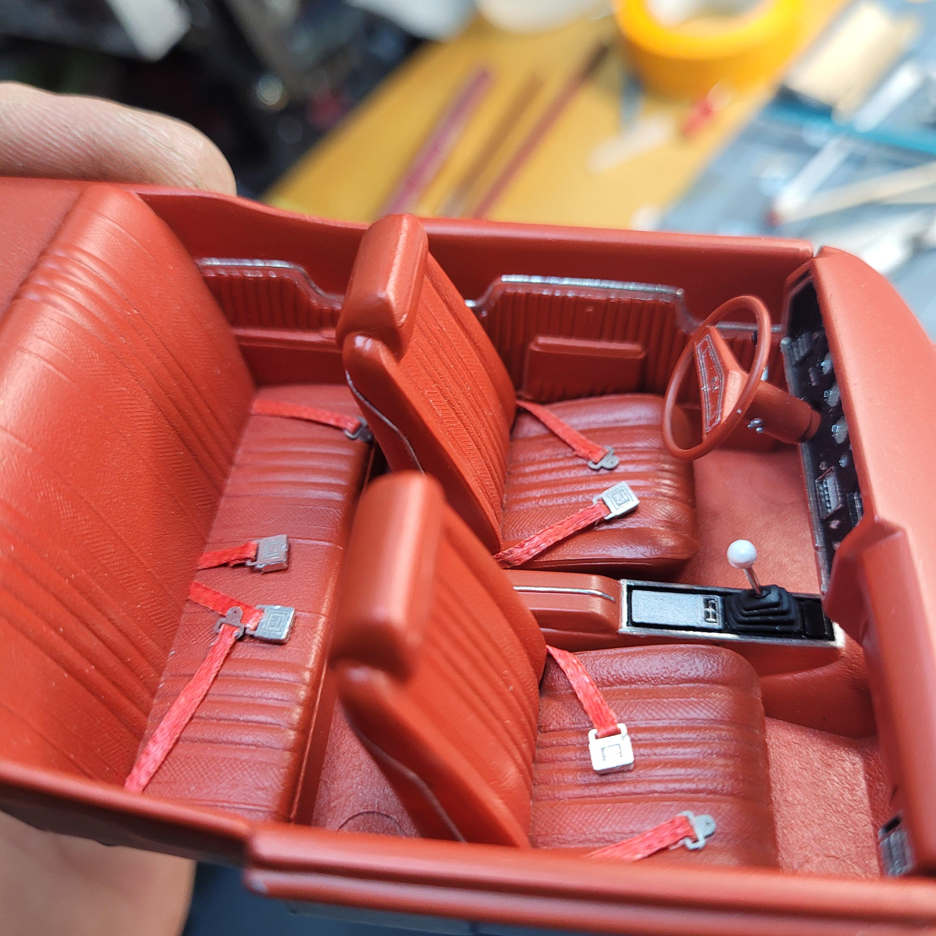

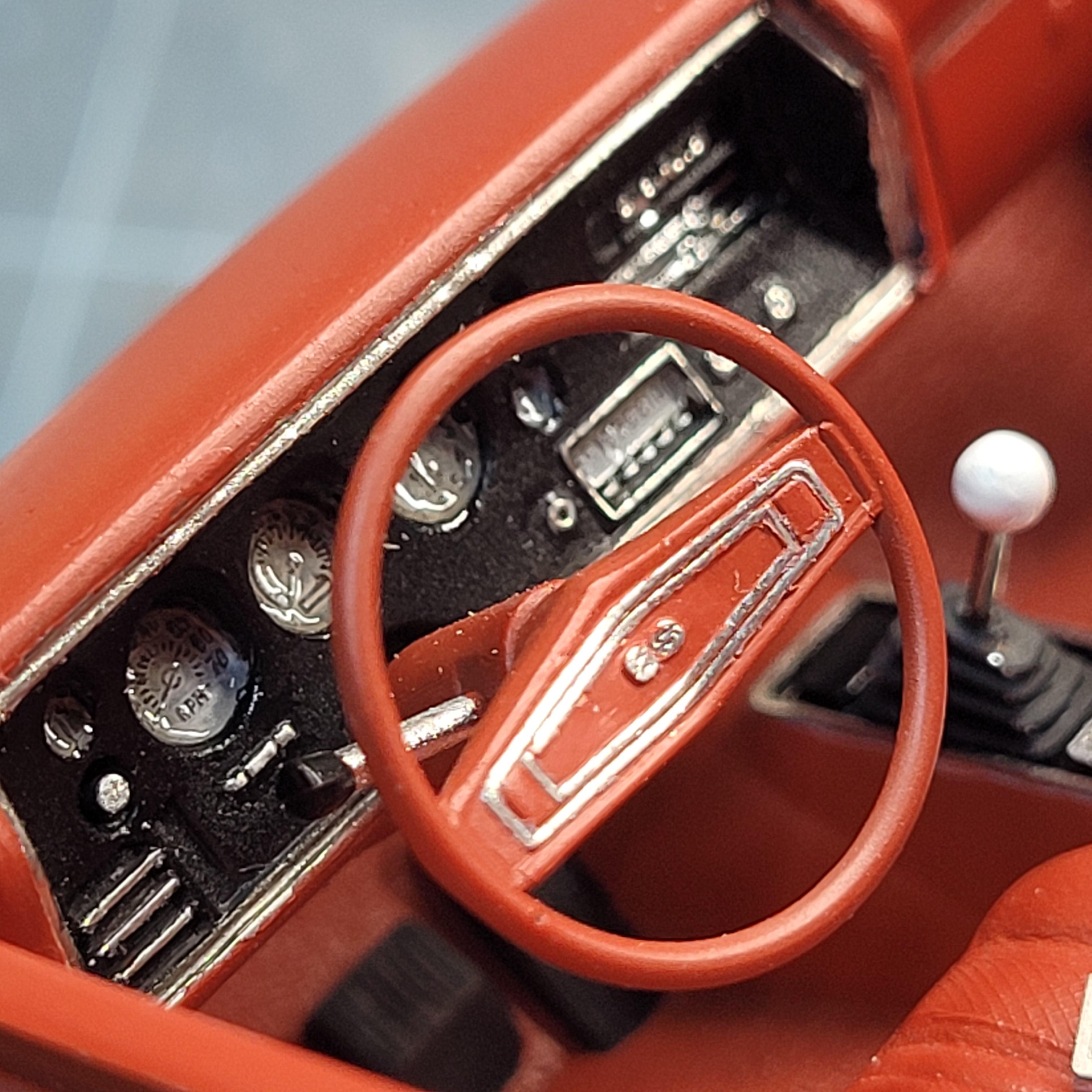

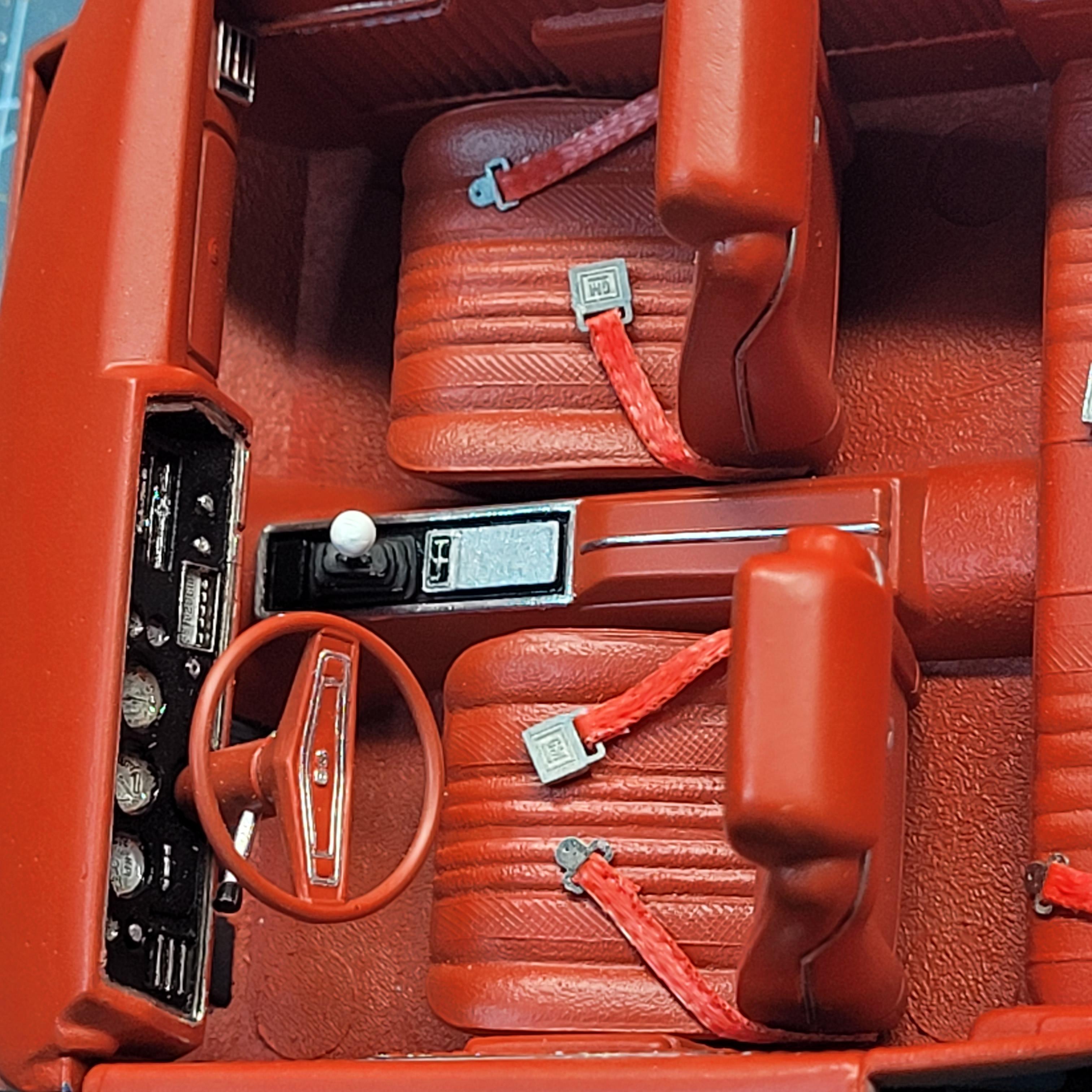

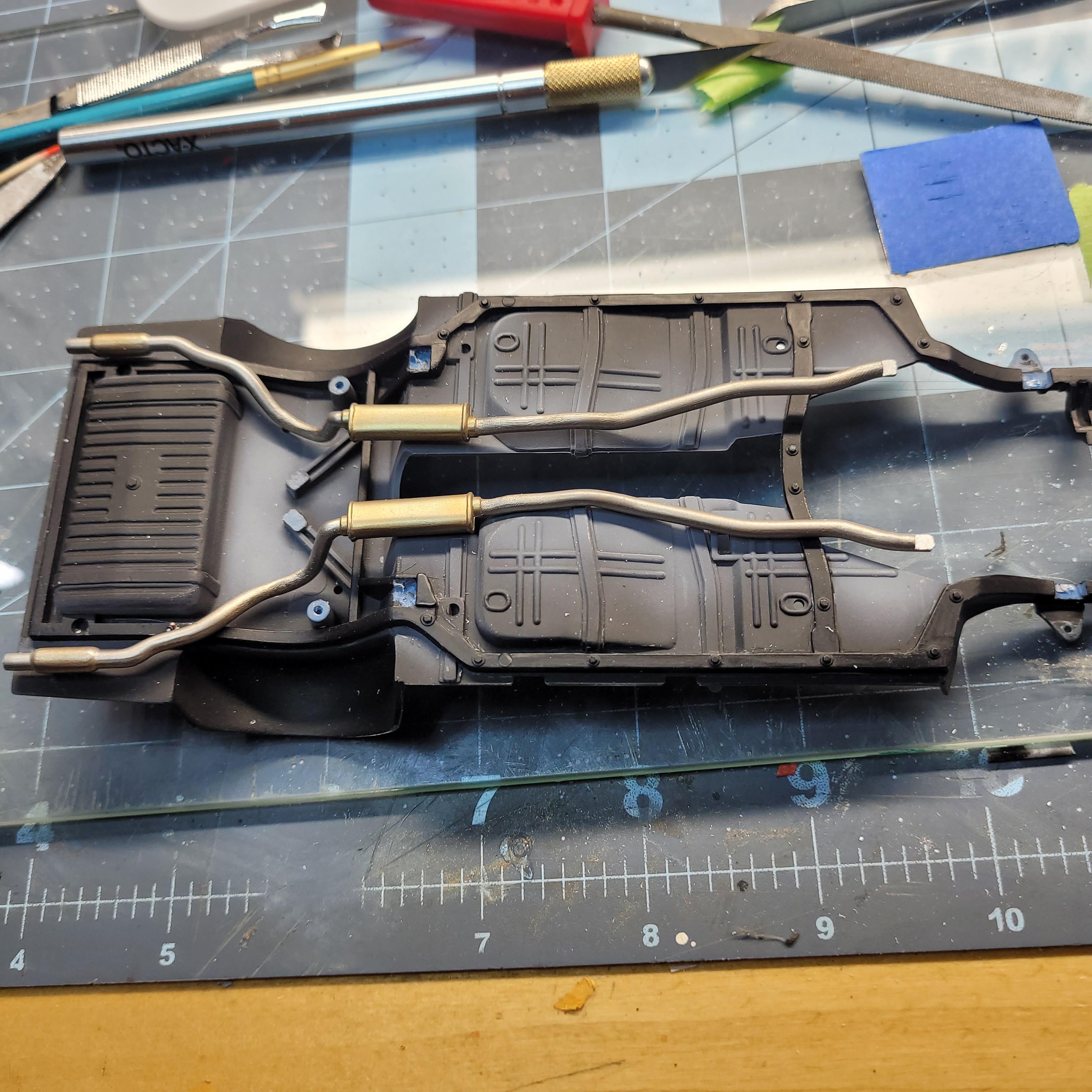

The interior is finished. I'm very pleased how this turned out,and of course Murphy showed up. The only part in the kit damaged was the shifter,so I had to make a new lever and knob. Starting to finish up the chassis, the exhaust broke off so i made them separate.  Thanks for looking.
  • Like 5

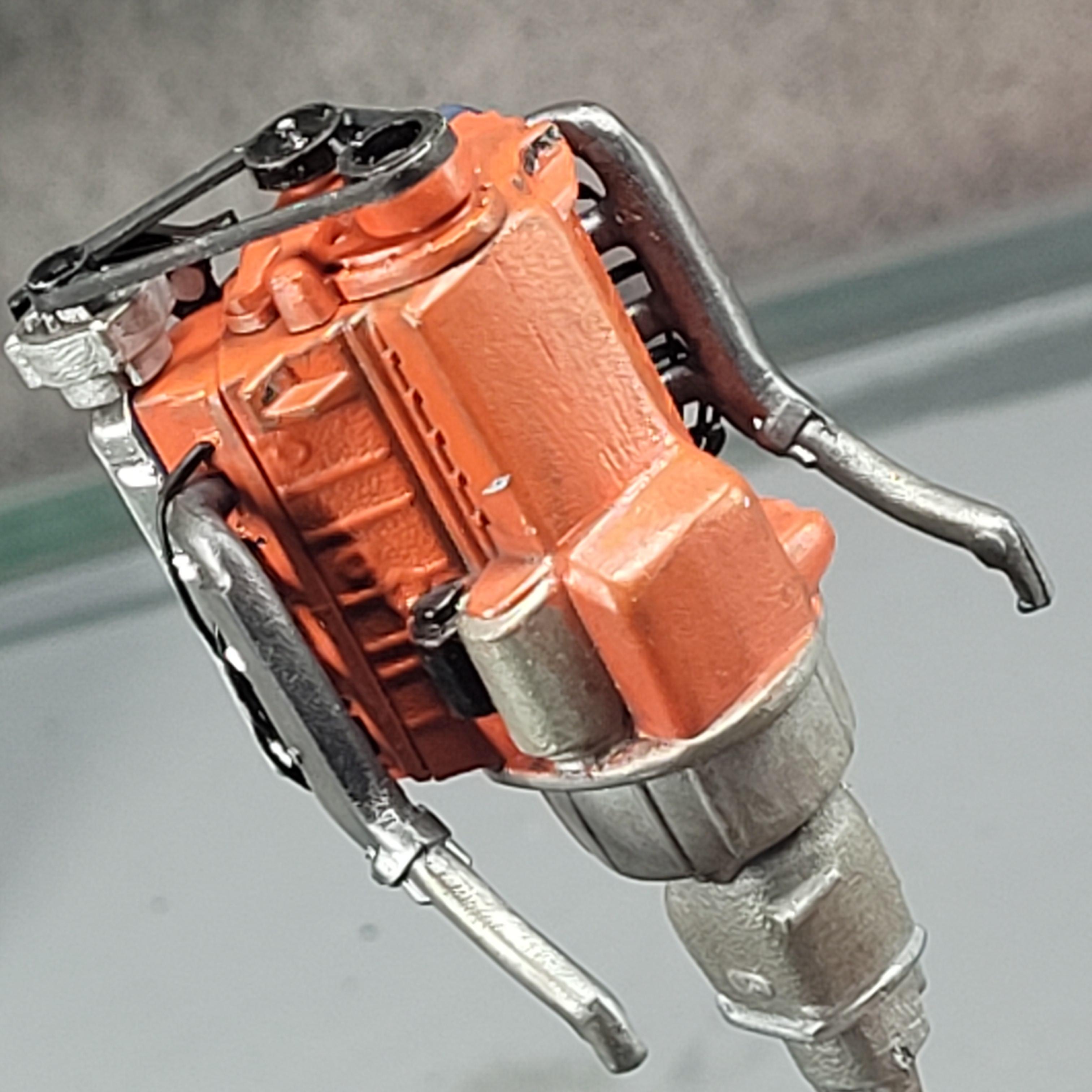

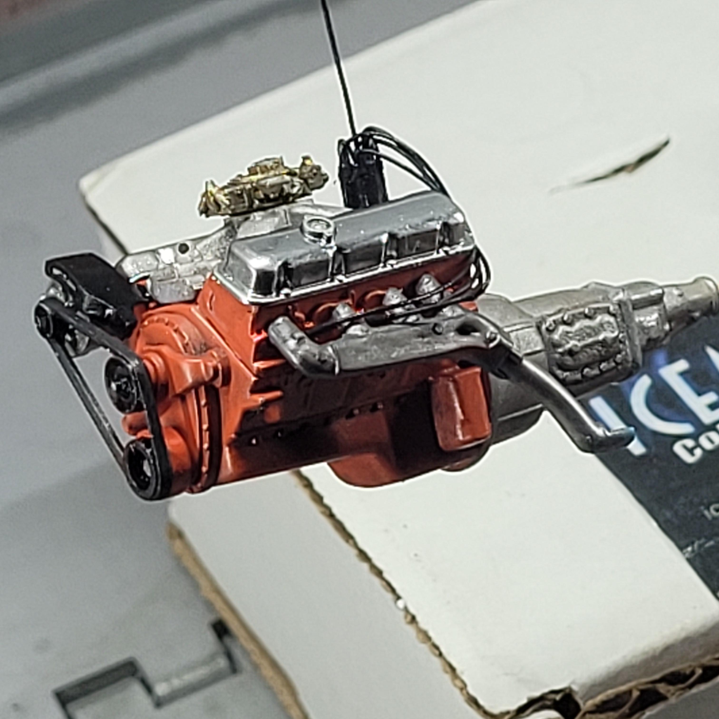

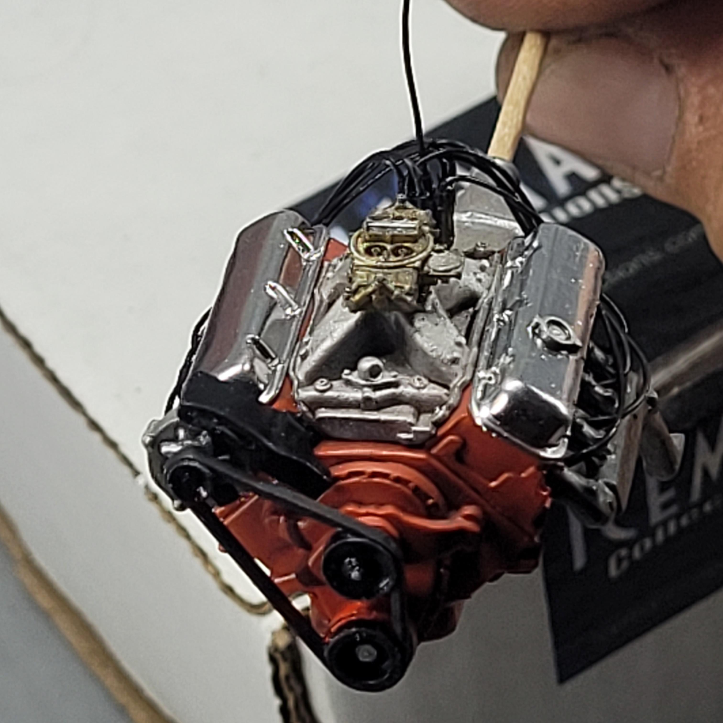

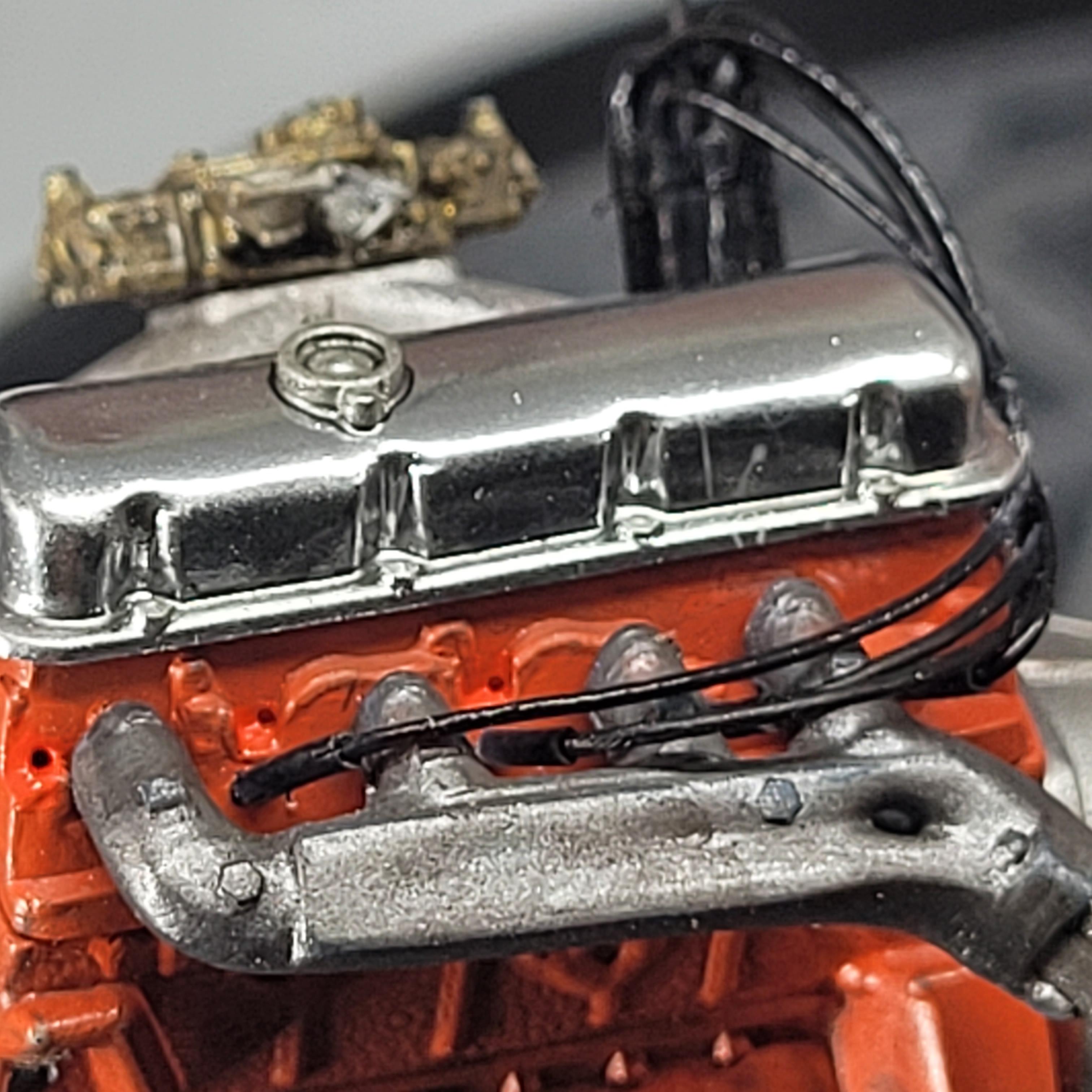

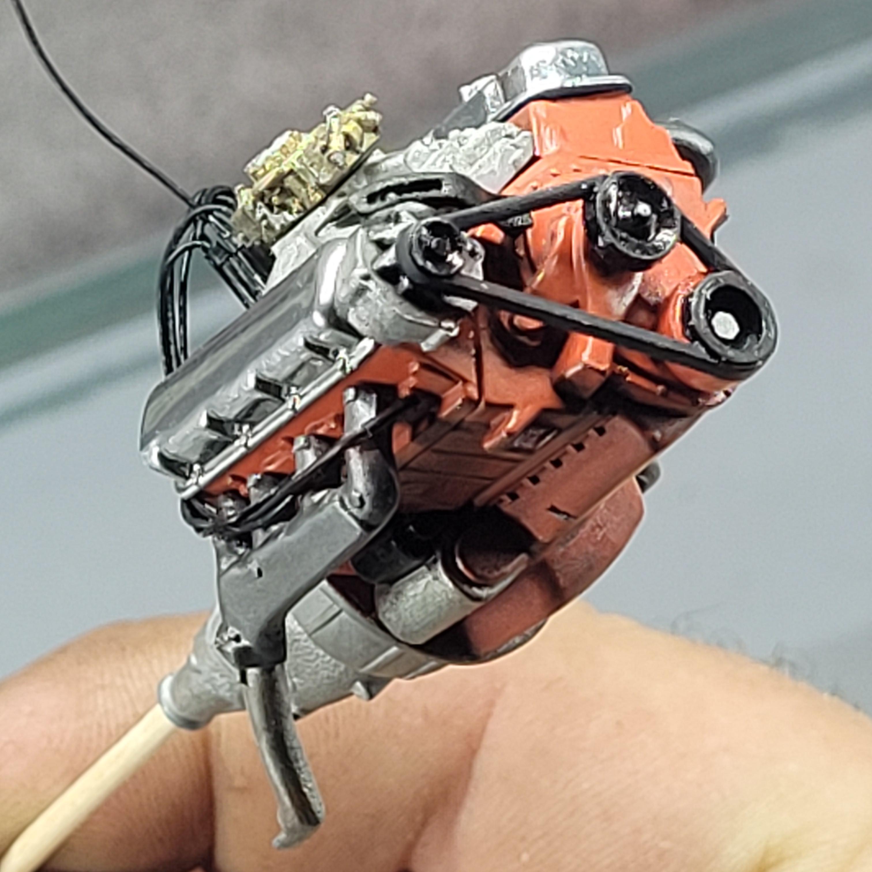

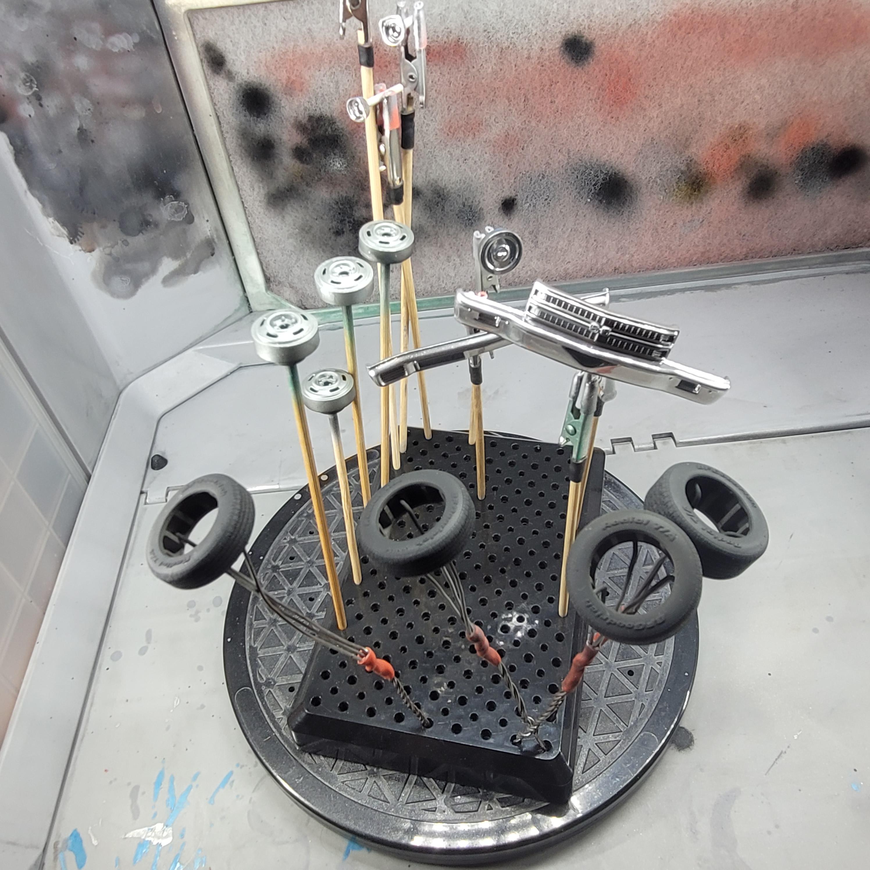

Got the engine wired and did a little weathering. Also got the wheels/tires painted and the chrome stripped and shot with molotow. The trim rings for the wheels are giving me fits. I cannot get an even finish no matter what i do.
  • Like 4
I’m really liking the interior of this one, especially the chrome trim on the steering wheel horn pad. 👍🏻
  • Thanks 1
Your Molotow chrome work sure looks good - I'm sure the question has been asked (and answered) on the forum before, but how long are you waiting before handling/assembling the Molotow chrome parts?  You don't seem to have any smudges on your parts, like I get.
Edited by BK9300
I have limited time to build, so it will sit anywhere from 2-3 days  to a few weeks.  I also handle it as little as possible and clean hands are a must. Other's have said they use white gloves, I should get some.
