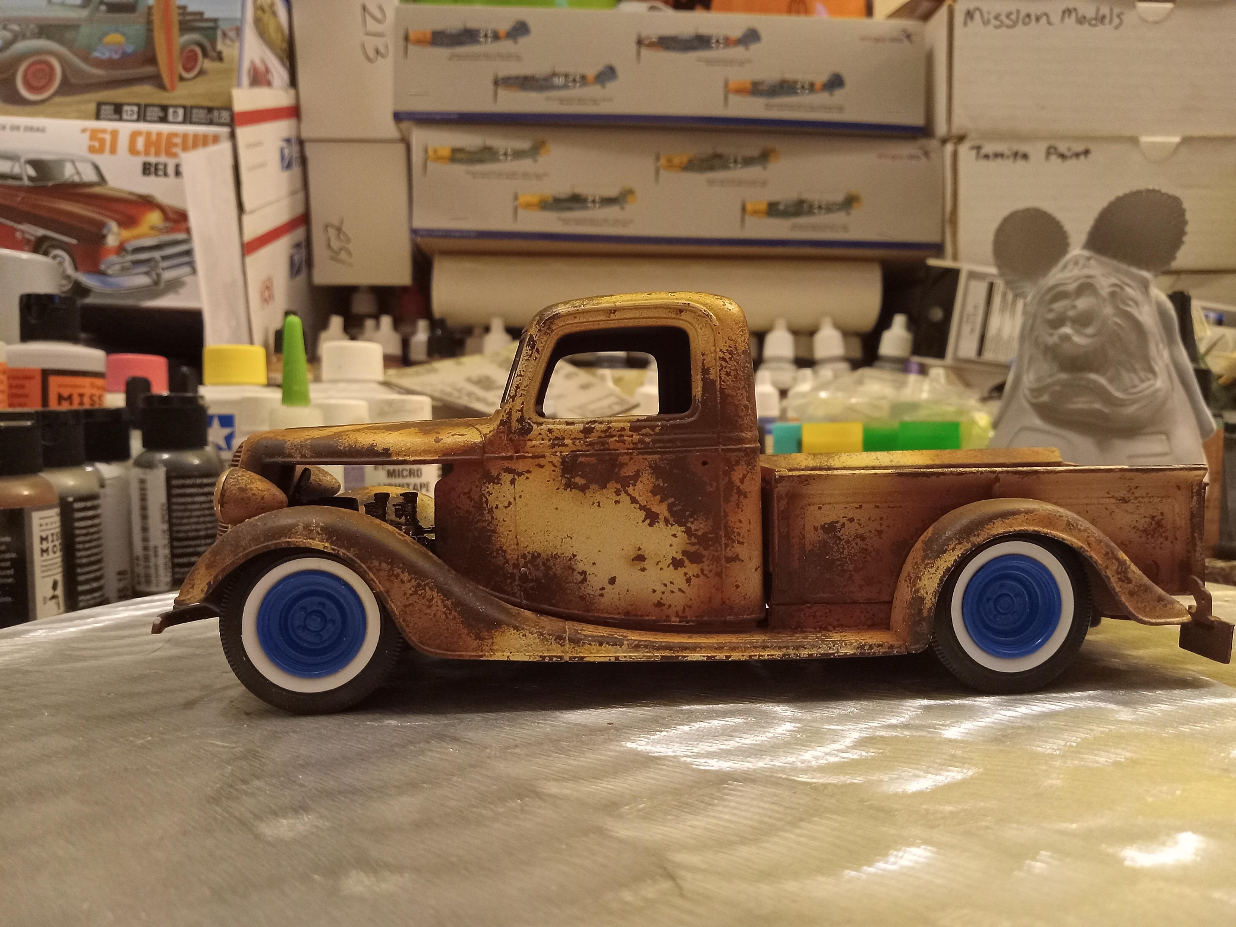

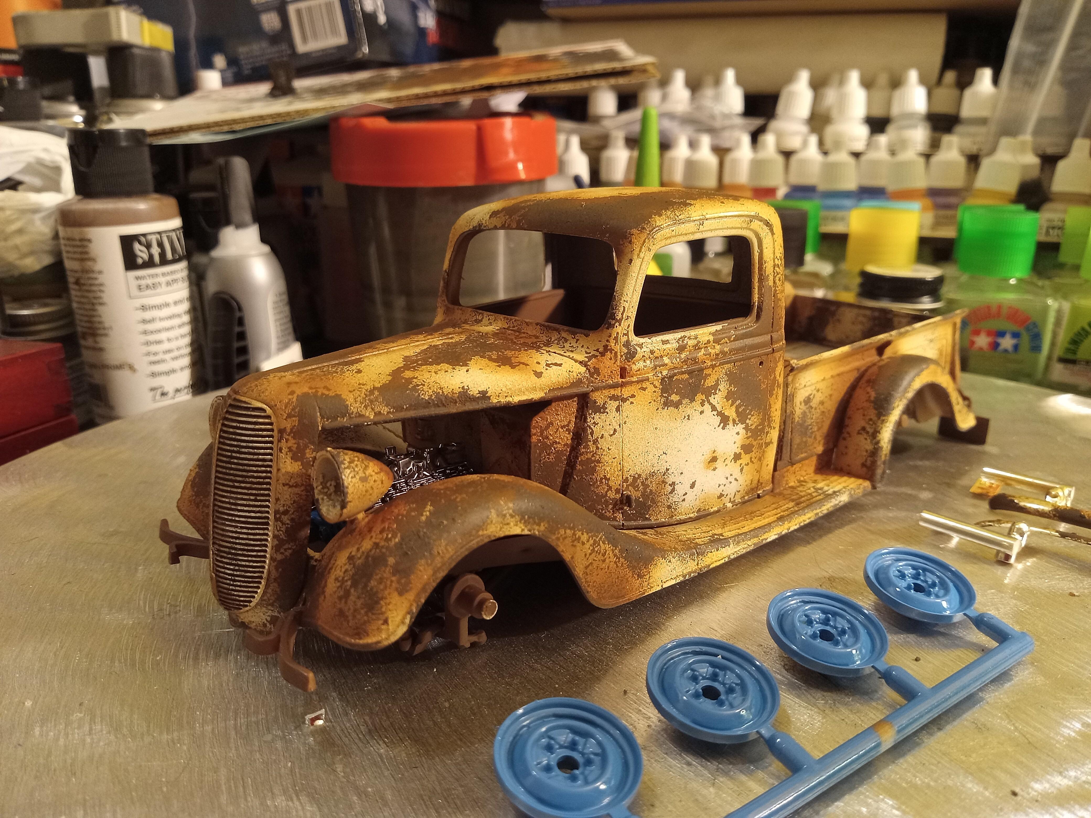

Dtimmerman89 Posted November 10 Author Posted November 10 I have decided to use MCW enamels and it will be a factory yellow and white two tone. I have been building armor for over twenty years, and my specialty is weathering, so I may give this ride a slightly patina look since it's all the rage these days. I won't argue, either. I love the rusty resto mod look. 1
Dtimmerman89 Posted November 10 Author Posted November 10 I have decided to use MCW enamels and it will be a factory yellow and white two tone. I have been building armor for over twenty years, and my specialty is weathering, so I may give this ride a slightly patina look since it's all the rage these days. I won't argue, either. I love the rusty resto mod look. 3
BK9300 Posted November 10 Posted November 10 (edited) Wow, amazingly realistic rusted treatment. Really like all the paint edges around rusted areas. Every bit of surface area blends believably with the area around it. Awesome skills! Edited November 10 by BK9300 1
Dtimmerman89 Posted November 10 Author Posted November 10 12 minutes ago, BK9300 said: Wow, amazingly realistic rusted treatment. Really like all the paint edges around rusted areas. Awesome skills! Thank you, sir. I appreciate the compliment. I painted the rust using multiple techniques to give it that look. Not only does it look like it, it feels like it. She's a real barn burner at every show I bring it to.
BK9300 Posted November 10 Posted November 10 1 minute ago, Dtimmerman89 said: Thank you, sir. I appreciate the compliment. I painted the rust using multiple techniques to give it that look. Not only does it look like it, it feels like it. She's a real barn burner at every show I bring it to. In looking closely at all the techniques - I don’t do weathering yet, so wouldn’t be able to identify them all! - do you use salt to get your basic paint edges? Also looks like some very handy , air brushing to blend the oldest rust areas, to bleed the newer rust into surrounding paint. Boggles my mind to think of all that work - read somewhere that a weathering job like yours can take longer to do than the entire rest of the build! 1
Dtimmerman89 Posted November 10 Author Posted November 10 5 minutes ago, BK9300 said: In looking closely at all the techniques - I don’t do weathering yet, so wouldn’t be able to identify them all! - do you use salt to get your basic paint edges? Also looks like some very handy , air brushing to blend the oldest rust areas, to bleed the newer rust into surrounding paint. Boggles my mind to think of all that work - read somewhere that a weathering job like yours can take longer to do than the entire rest of the build! Yessir. I started with a brown primer as the base and added multiple gradients of salt to vary the size of the rust chips, multiple layers of sponge chipping to blend the colors from darkest to lightest and blended the same colors with an air brush to stain the paint. 1
BK9300 Posted November 10 Posted November 10 Thanks for all the information! Finally, if I may, what do you use to give that additional layer of texture, under some of the paint, to make it look like unexposed rust lifting underneath? So much detail! 1
Dtimmerman89 Posted November 10 Author Posted November 10 How i achieved the bubbled rust effect is to leave some areas of the salt behind, typically the finest gradient is left behind. You can see it mostly on the outside of the wheel cutout. Also, make sure you use an 800 grit to knock down some of the ridges and pooling around where the salt was removed. Use your discretion on what you sand down to give it some texture, but to keep it from looking like an obliterated mine field. I may have to do a tutorial to show and explain my process. I think it would give lots of insight to weathering rust and how it works irl. 1

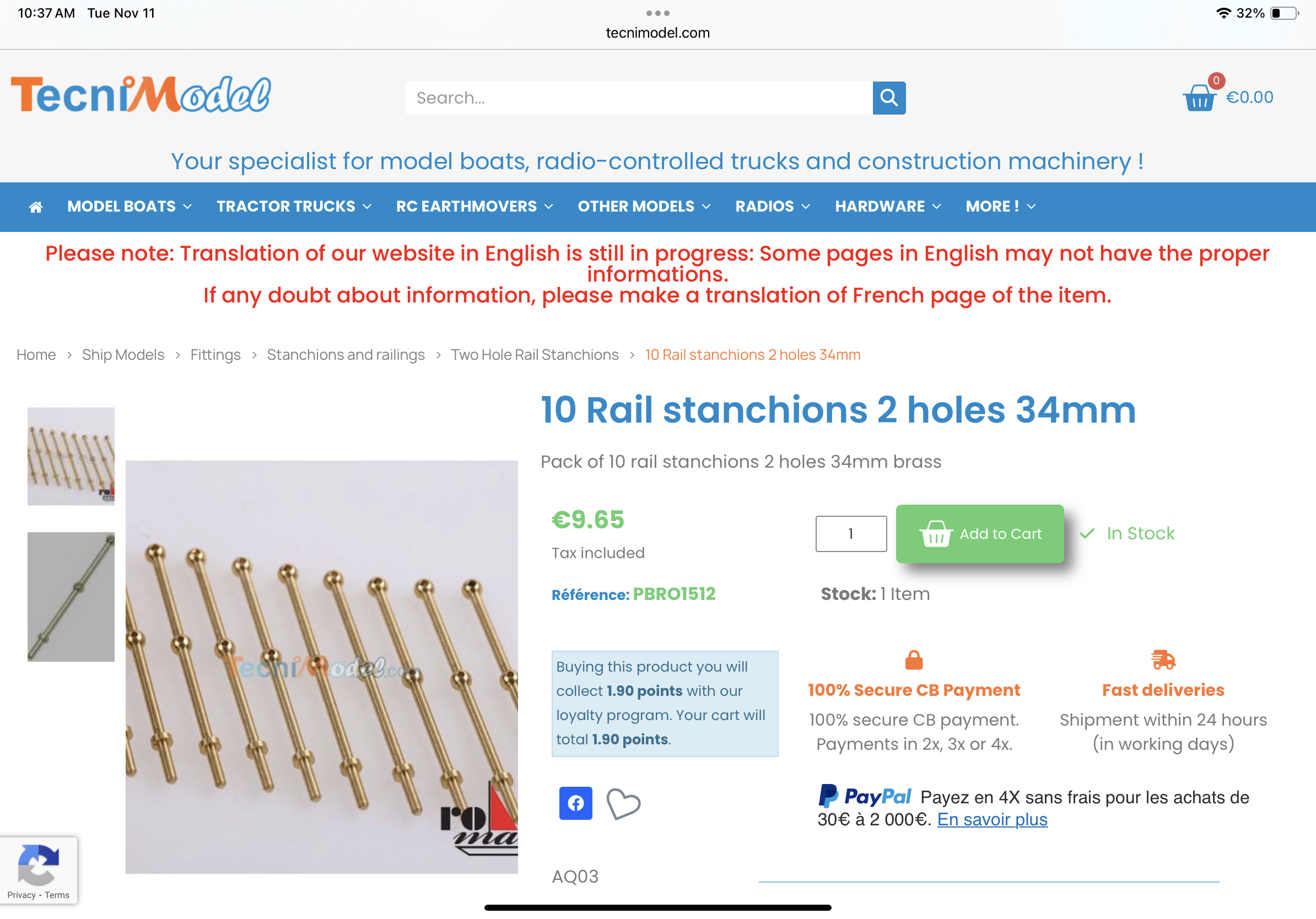

BK9300 Posted November 11 Posted November 11 4 hours ago, Dtimmerman89 said: I can't find any RB Motion rod ends to save my life. I'll have to make my own, I suppose. 3d printed parts are still just too brittle and not nearly enough resilience to hold up for long. I was hoping to get some rod ends from RB, too, for some 1/24 Italeri truck suspension upgrading. While looking for alternatives, I found, and ordered some different size brass, model ship, handrail stanchions that might be modified to work as rod ends. There are some types available from model railroad sites, too. No high jack intended - thought maybe these could be used by others looking for rod end substitutes - 1
Dtimmerman89 Posted November 11 Author Posted November 11 4 hours ago, BK9300 said: I was hoping to get some rod ends from RB, too, for some 1/24 Italeri truck suspension upgrading. While looking for alternatives, I found, and ordered some different size brass, model ship, handrail stanchions that might be modified to work as rod ends. There are some types available from model railroad sites, too. No high jack intended - thought maybe these could be used by others looking for rod end substitutes - Those look like they'd work pretty well. I typically use nickel wire, loop it around a pin, pinch it shut with my needle nose and a dab of solder to finish. For larger rod ends, I'll flatten the end of some aluminum wire or rod, drill out the center and file the edges round. I try not to spend money if I can help it, so I have learned to be quite crafty with the basics.
