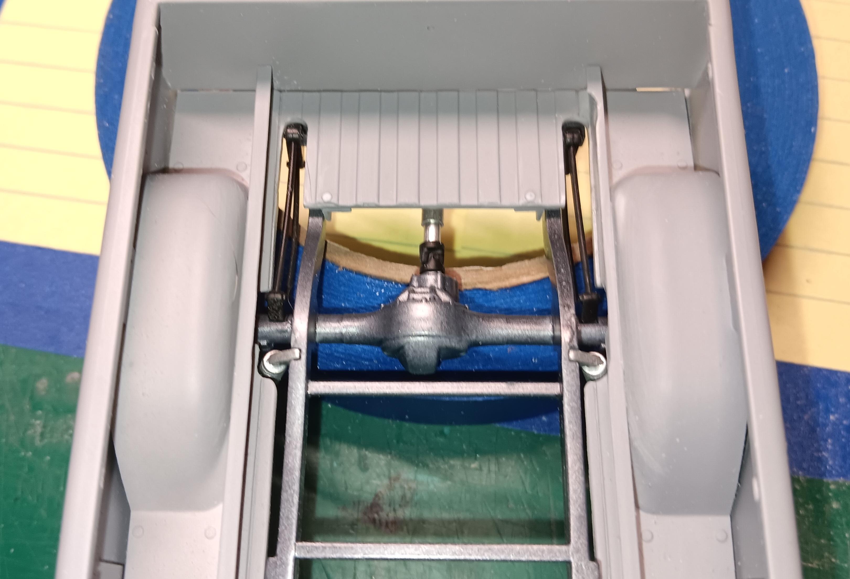

A lot of slice & dice work with all the woes along the way. I added the rear 4-link and have a bed interference.
The bed is shortened 22 scale inches. I made the bed floor from diamond plate stock. Gas tank is a Norm Veber item. Wheels & tires from VCG Resins.

I had to relieve part of the bed do the 4-link and coilovers had clearance. The bed cover hides everything anyway.

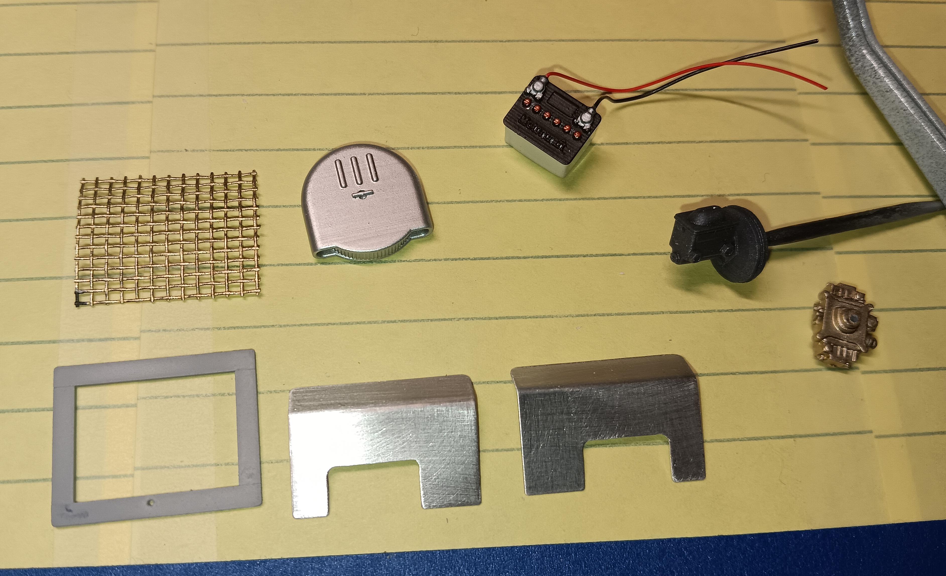

I had to open the firewall (I added a piece to mount the master & booster) to clear the driver side valve cover. I closed up the passenger side by 1/8".
The fender wells interfered with the upper control arms, those were opened up. They will be covered with aluminum pieces I made. The ones pictured might be made bigger. Possibly may add a firewall piece.
