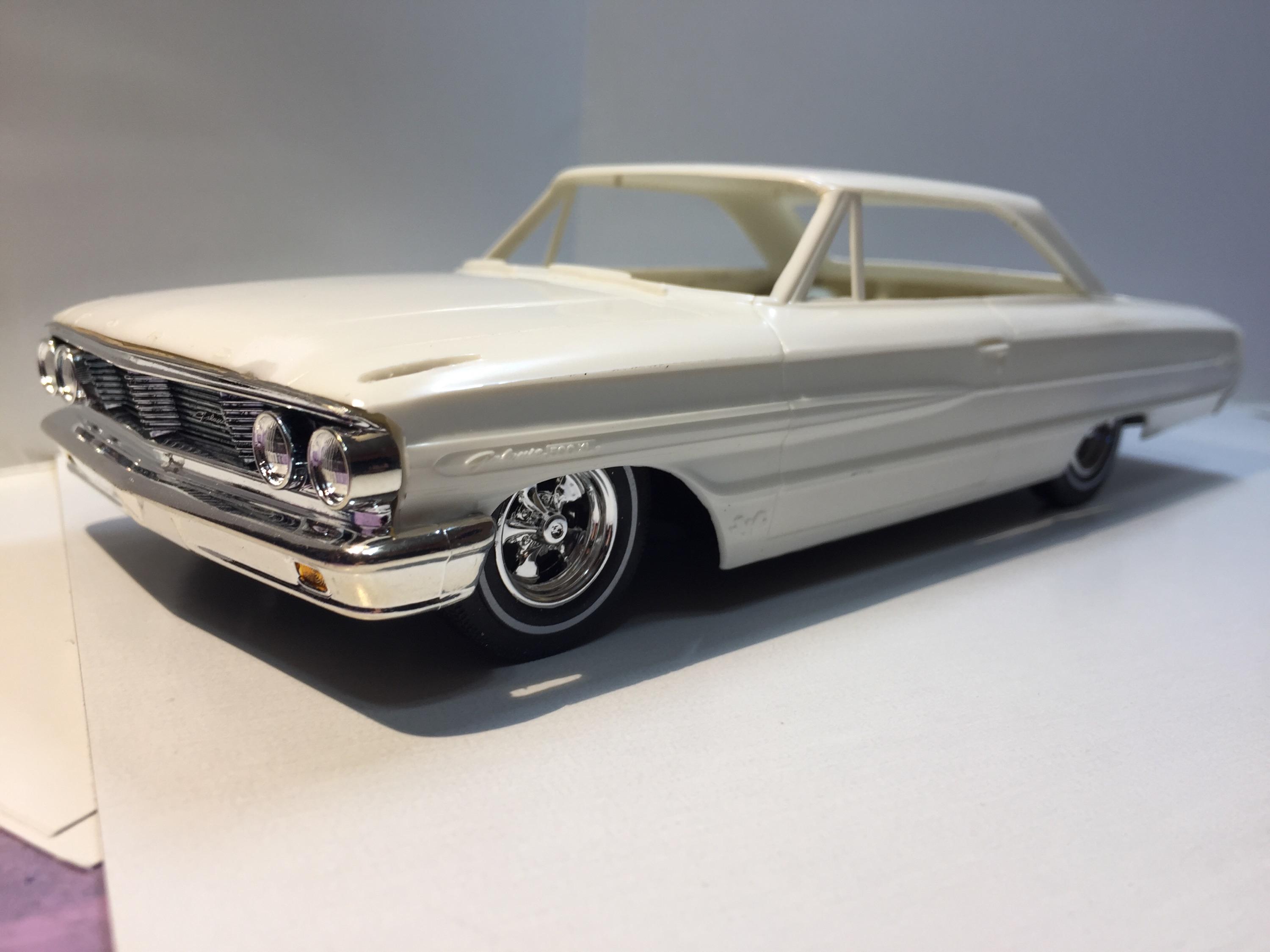

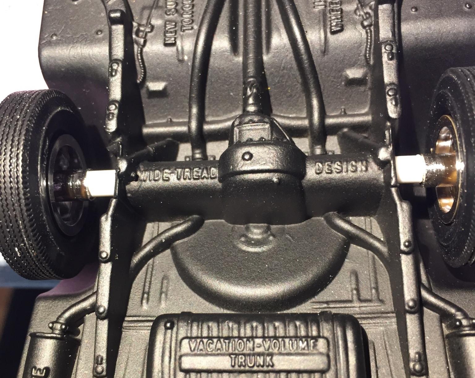

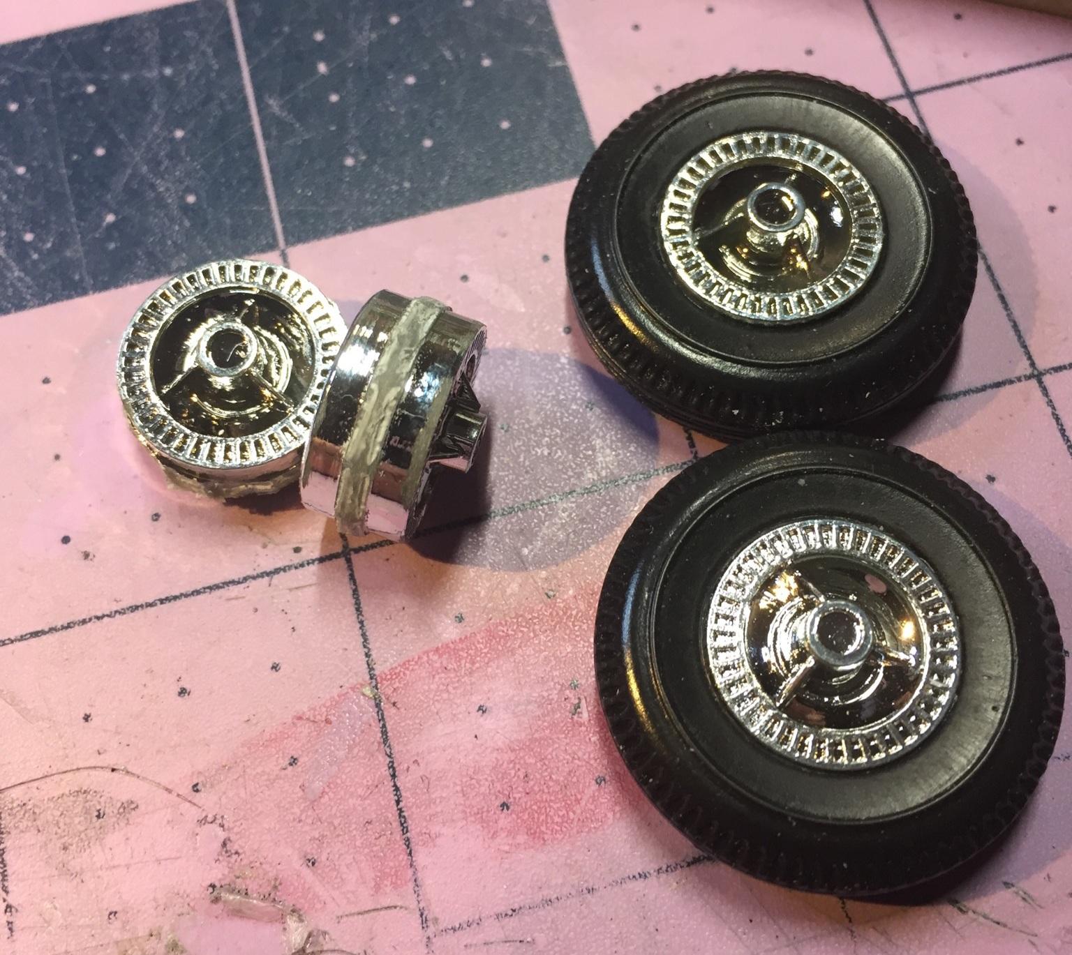

After chassis swapping to create a full detail '63 lightweight, I have decided it's not worth the expense and time to do the same for the '64. The styling of this big Ford is a favorite of mine.  I scored the kit for a decent price on Ebay and it had been started with paint on the chassis and the wheels were "narrowed" by cutting off the axle bosses.  I had considered trying to swap the chassis with the Edsel's but decided against it. There's a chance I can open the hood. It's a lot of work but I'm thinking about it. I won't be changing anything on  the chassis because I kinda like the promo look with all the features called out on the bottom.
This is kinda cool since other promos are equipped with flat, featureless bottoms. I have not decided about repainting it but it's perfectly acceptable the way it is. I won't be "fixing" anything here.
The grille/bumper was detailed by a former modeller and its good to go. I am debating adding lenses.

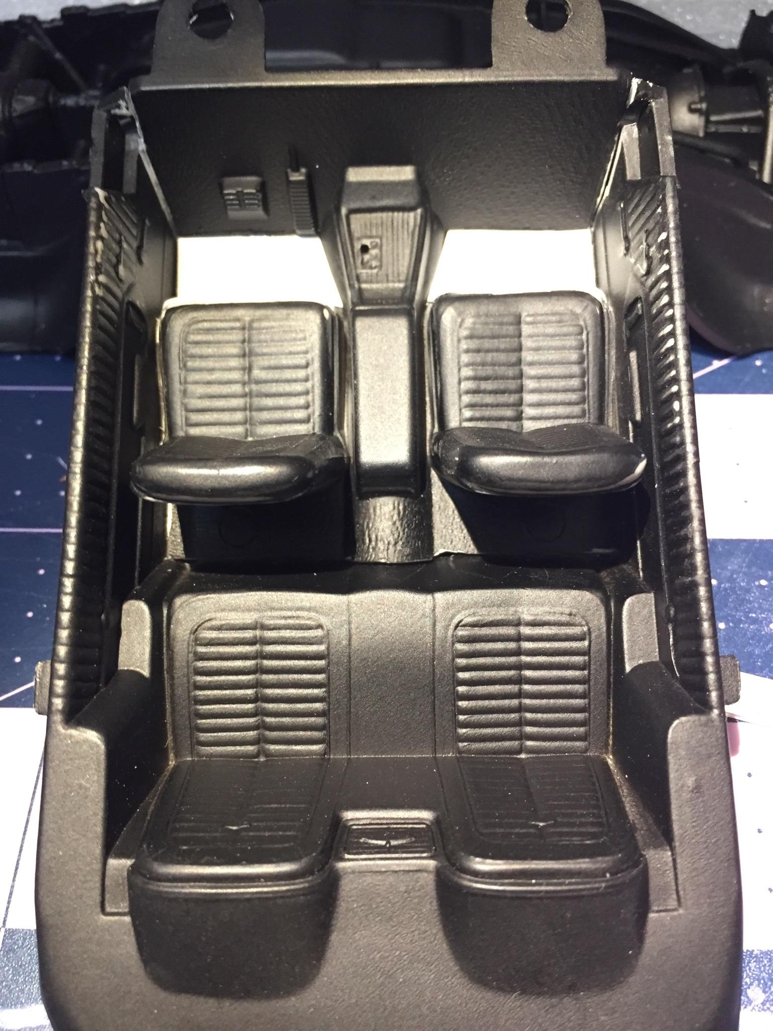

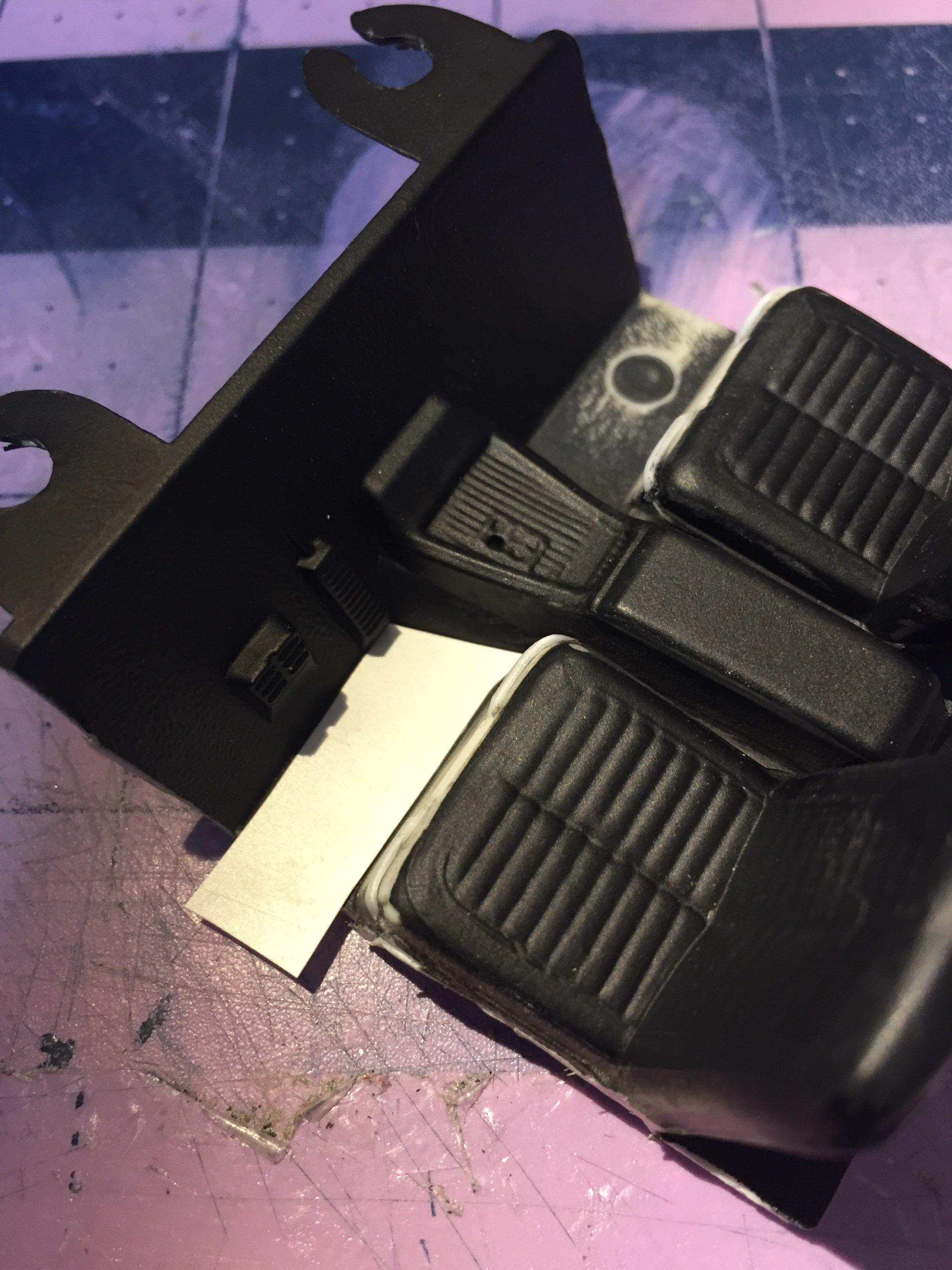

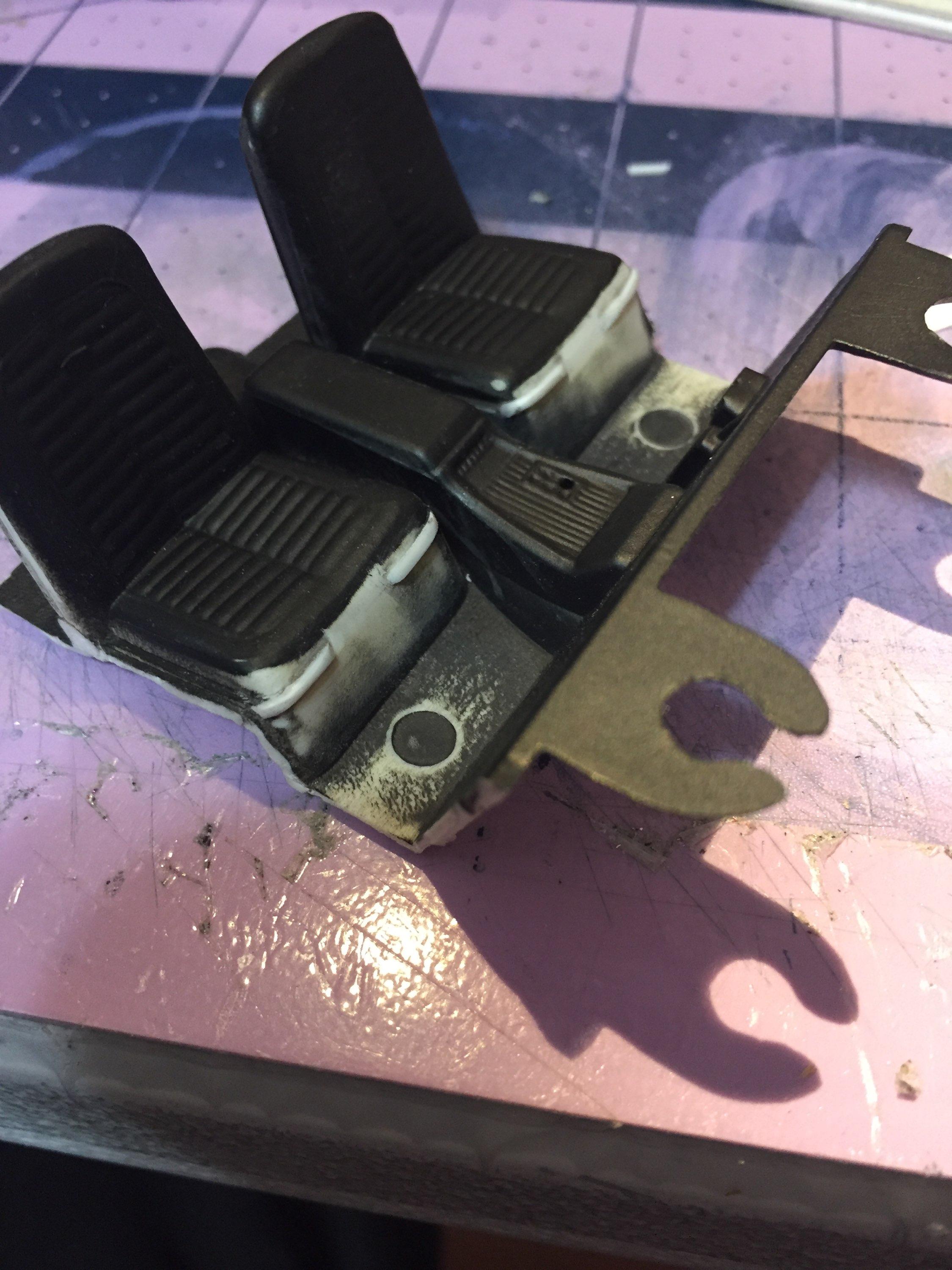

There's some work to be done filling sink marks due to all the bosses. My efforts will focus on a good paint job and giving the interior some visible detailing. In order to do that, I will need to cut it apart. The tub was also painted by the former craftsman. I'm grateful the dash and steering wheel escaped the flat black treatment. I plan to go with red with no secondary color. Three dimensional cranks and handles are planned and I figure I can make them. The seats and door panels will need foil- not happening without cutting it up.
Yup. All one piece, a la promo. This version is a full-on screw bottom and that's how it's going to stay.

This is my first '64 Galaxie so I wasn't ready for the chassis with War and Peace embossed on the frame and I thought about what a pain it would be to remove all that.  Then I realized how charming it really was and decided to just build it as the folks at AMT intended with some added interior detailing.
There was no way to add foil to the one piece tub without cutting it apart. I started with my razor saw but I saw that would wreck the door panels so I tried several ways and ended up with the Dremel and the sanding drum. I used the sander to thin the plastic on the outside where I needed to make the cuts and used a 5/8 chisel blade to cut through from the inside.
This is the only way I could think of to expose the door panels without having to deal with the back seat. After it's painted and foiled I can add some decent cranks and handles. Then just glue it back together and we're good. This is my reference for the interior detailing 👇🤓
