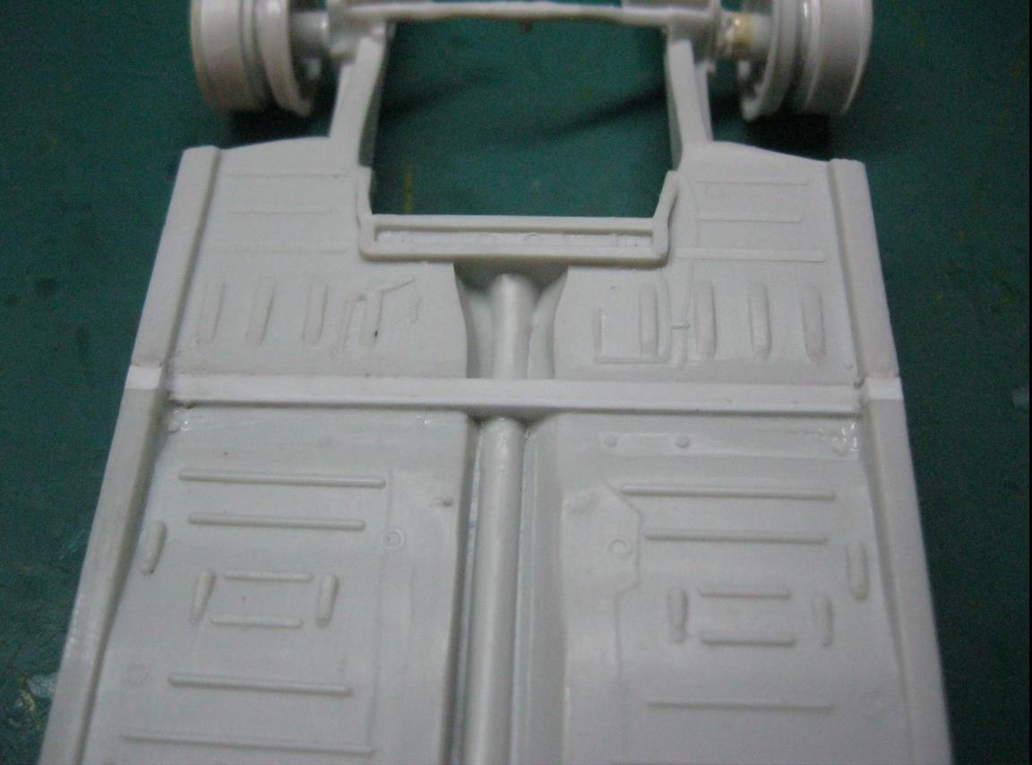

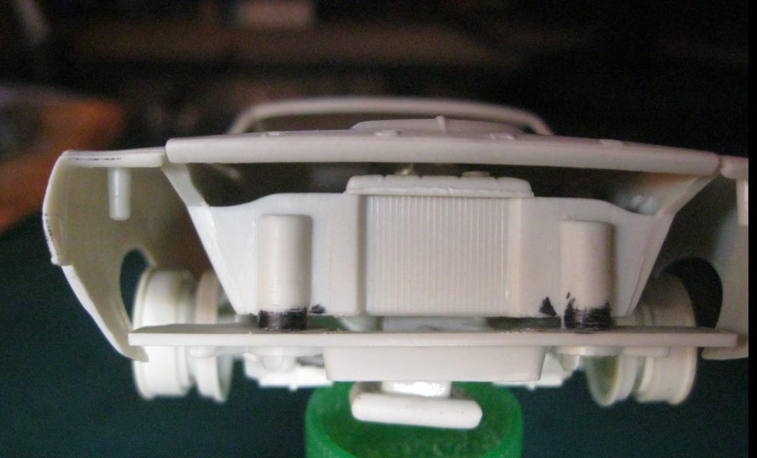

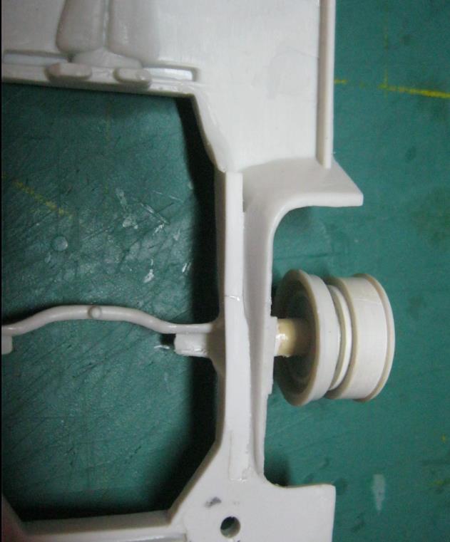

Extending the Chassis 2mm to get right wheelbase!Shaving of the rectangular increases left and right of the Cardan tunnel to make the chassis ffit deeper into body!image.jpeg.9b3f8016a99e342b17028d8a1b3a8321.jpeg

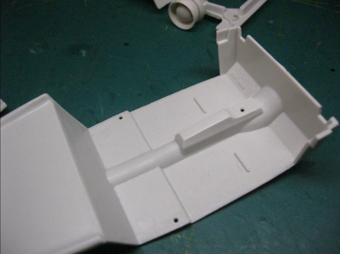

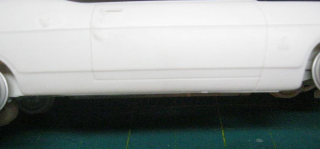

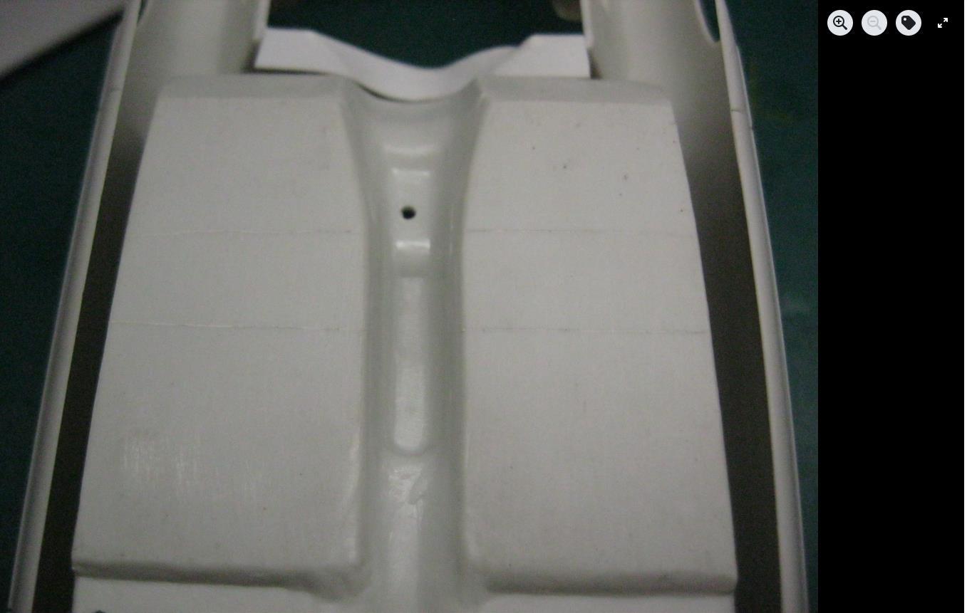

Yiew of the lengthened chassis from the underside and widening of the track 2mm driverside and 4mm passengerside

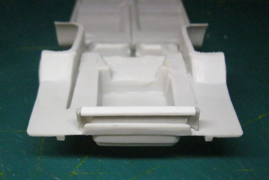

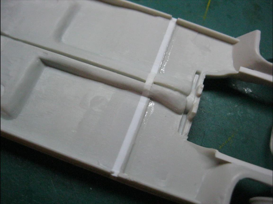

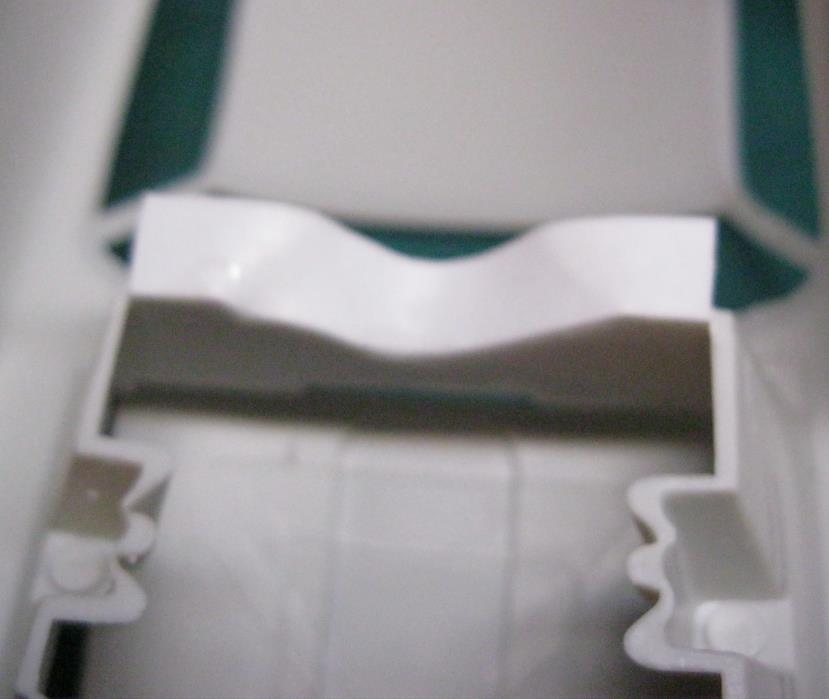

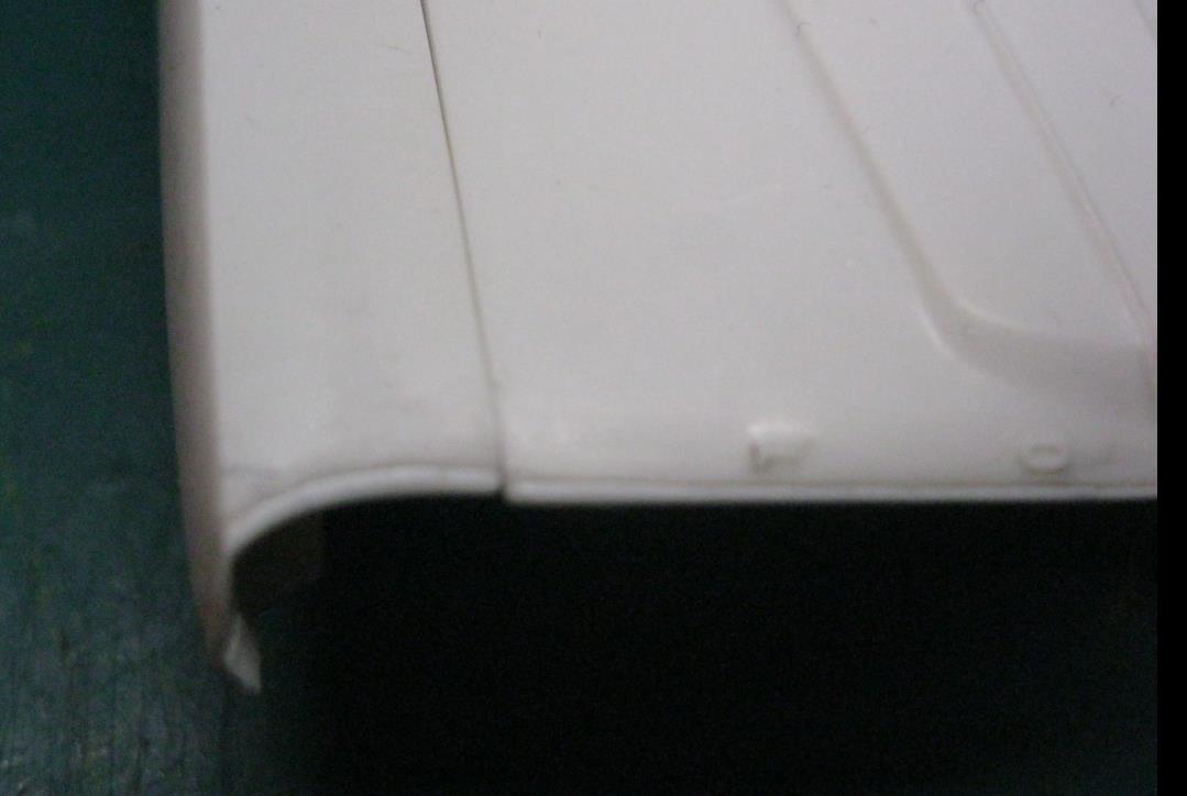

Smoothing of the tub underside to get the chassis more into the body especially deepening it between those 2 "ghostlines"

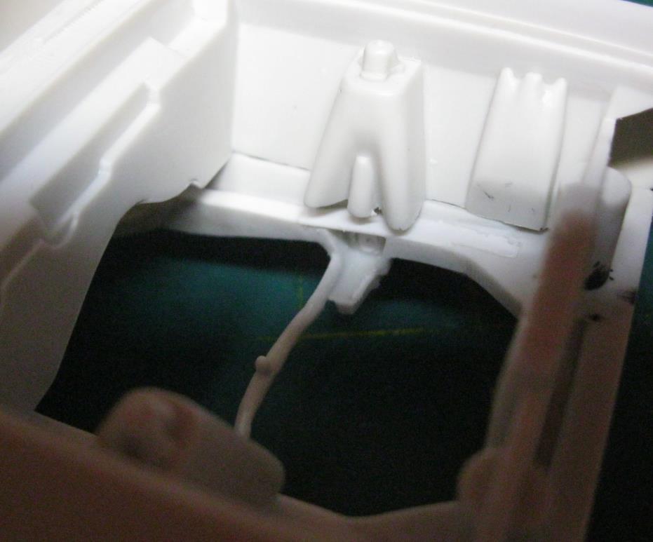

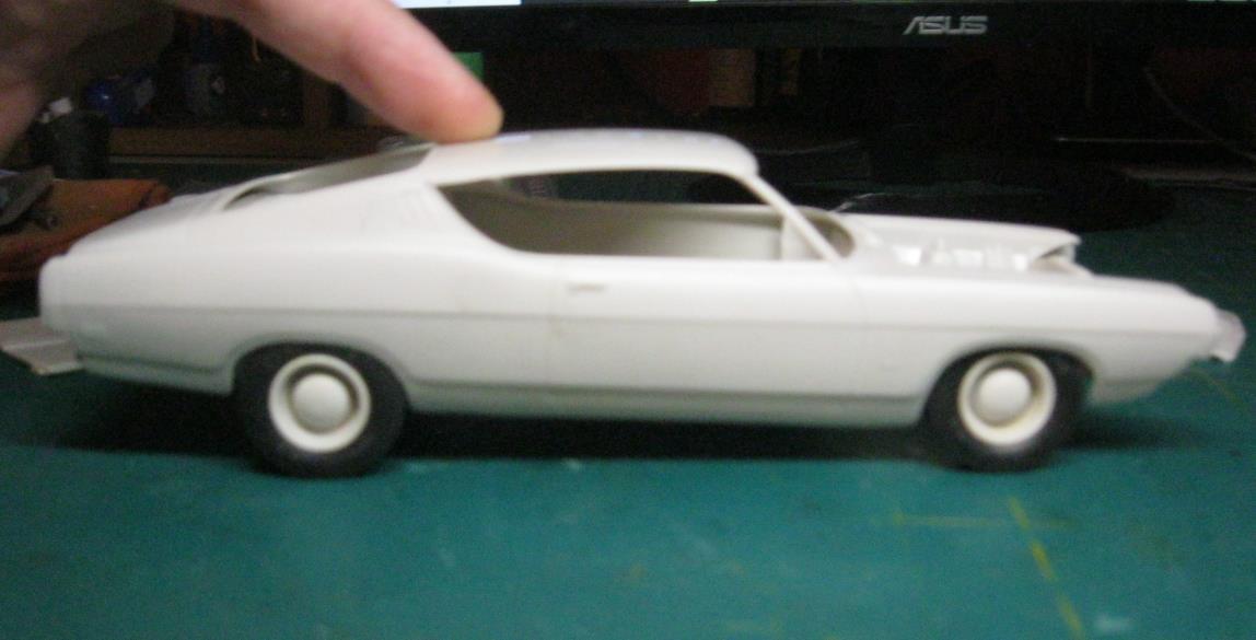

removing the sidewalls for better detailing

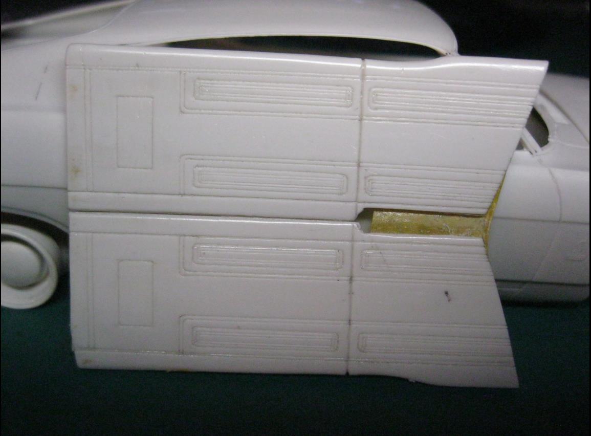

Detailed sidewalls.Plasicsheet handgraved

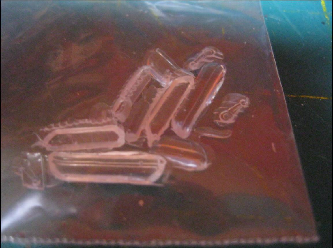

made negatives of the Revell Talladega with oyumaru and filled them with UV resin

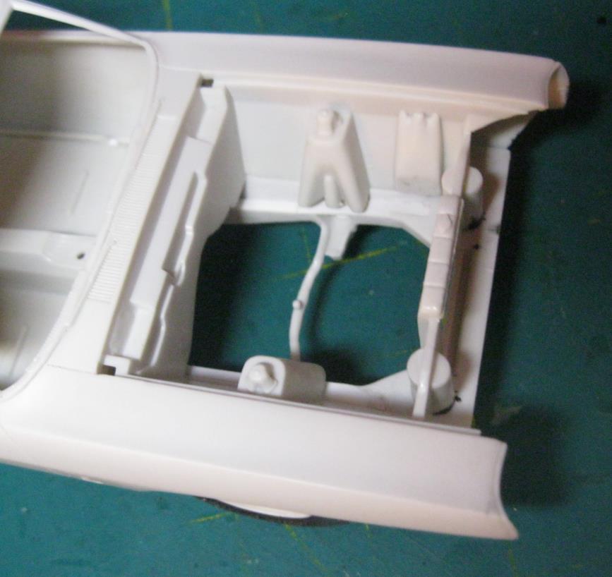

covering of the hollow front frame rail
engine room with covered frame!Dome and washerbag still to be modified
Centered front frame
Spacer for chassis to body

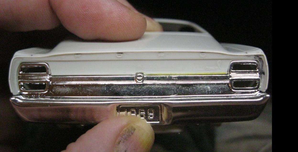

Alingnment of the half mm on right side of body over the chromed rear panel

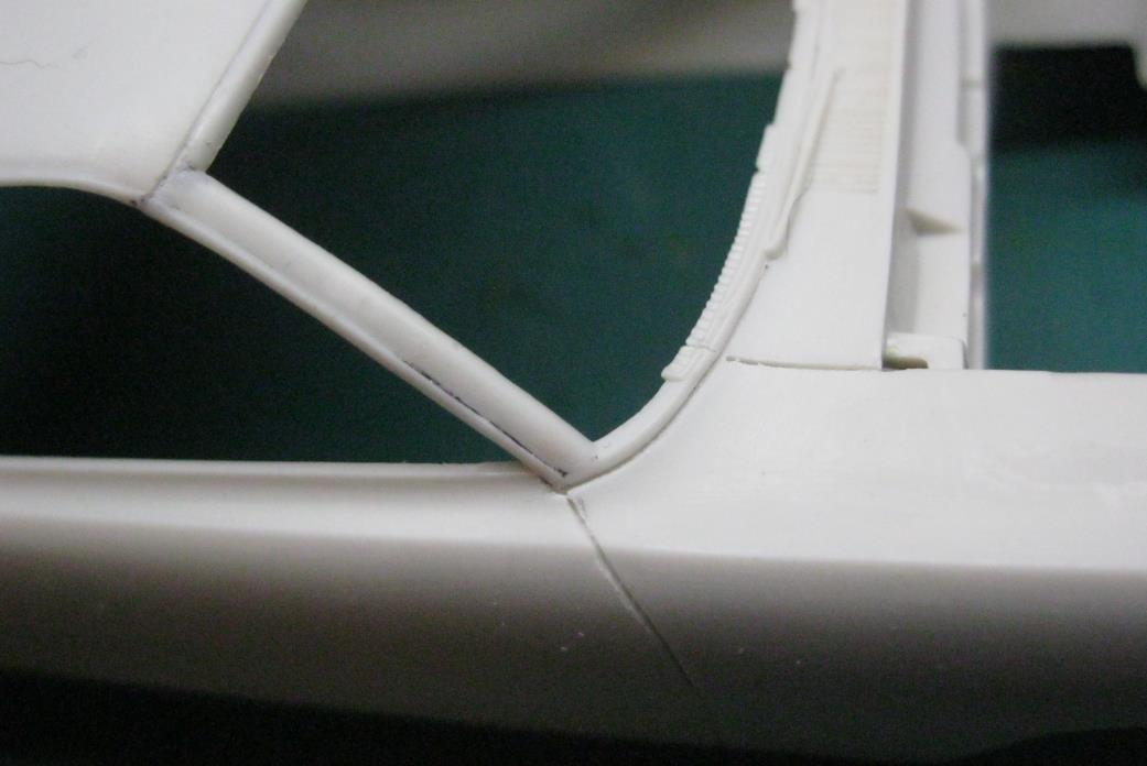

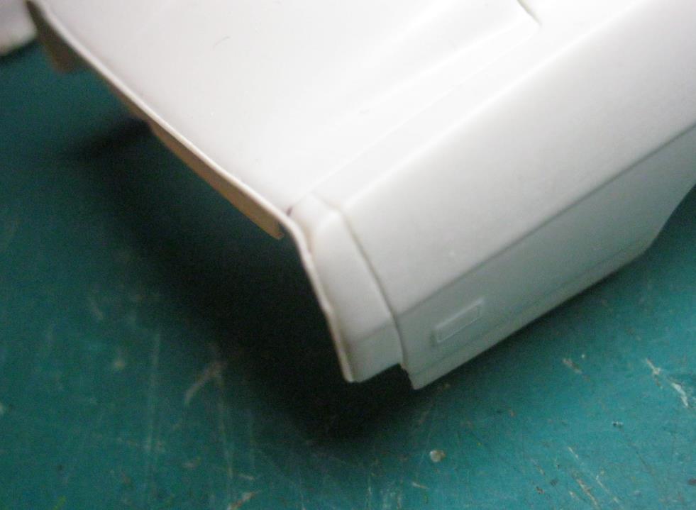

engraving of the seperation line of fender and winddeflector
engraving of the seperation line between side panel and rearend and attahcment of the really not existing chromestrip
engraving of the sep line between frontfender and the carsill(? maybe wrong word,i am from Germany)Sep line to side panel still missing
reworking the cromepanel on the front
cover for distance between firwall and interiortub

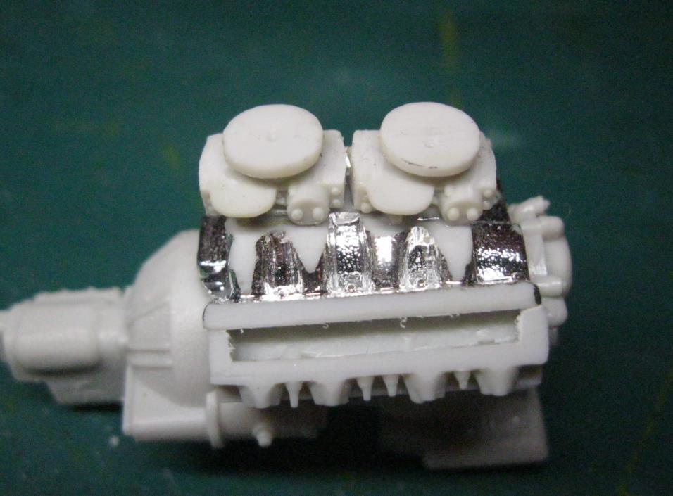

Engine with flattened carbs(on top and on the underside) and flattened intake manifold These mods to car,manifold and airfilter have to be done because of the lenghtening of the chassis the engines is 2mm further to the front and keeps the hood from closing!
Hollowing out the airfilter so that it sits lower on the carbs
Still tight between hood and airfilter!but now fits
modded ridehight and rims
So thats most of the problems with the kit adressed!have fun and greetings from Germany
