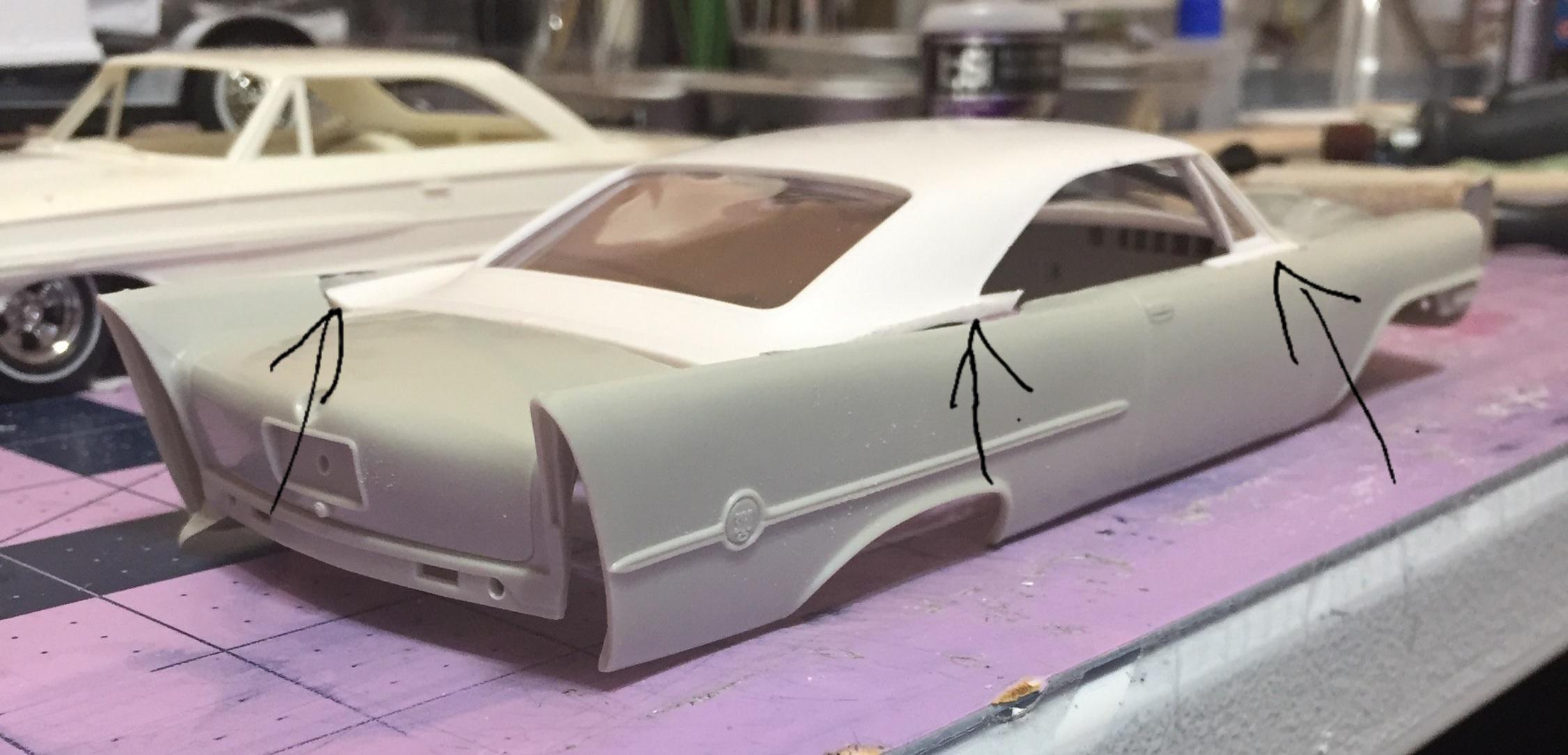

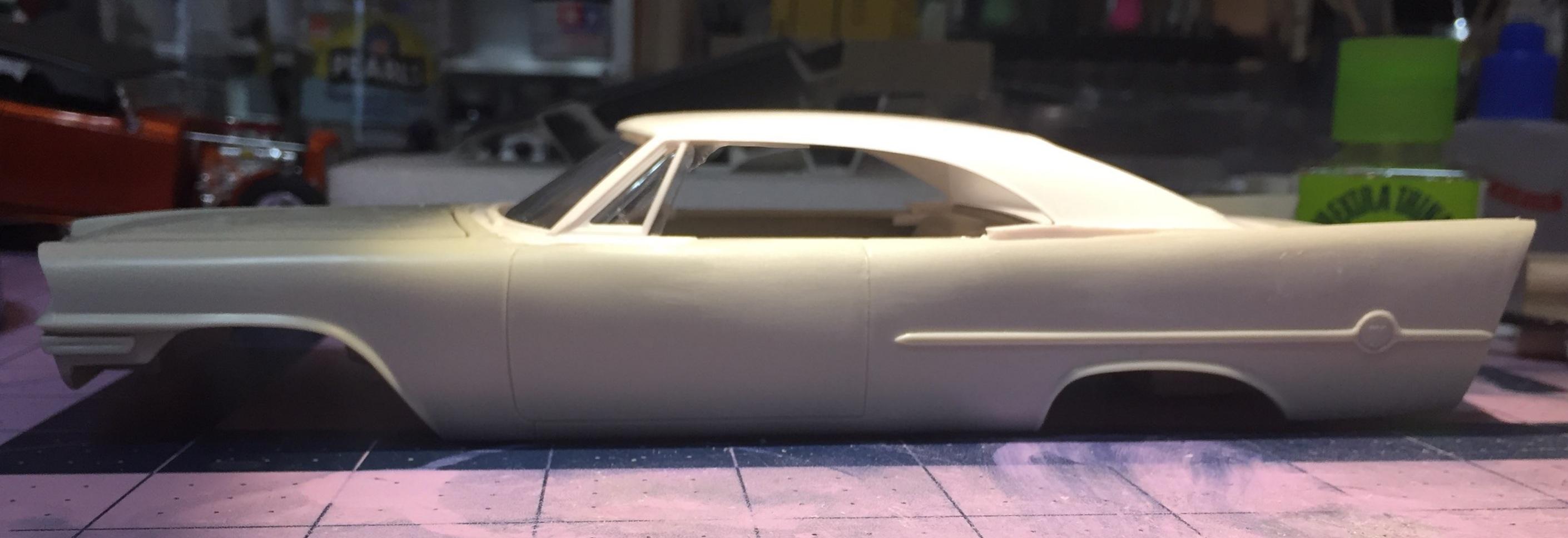

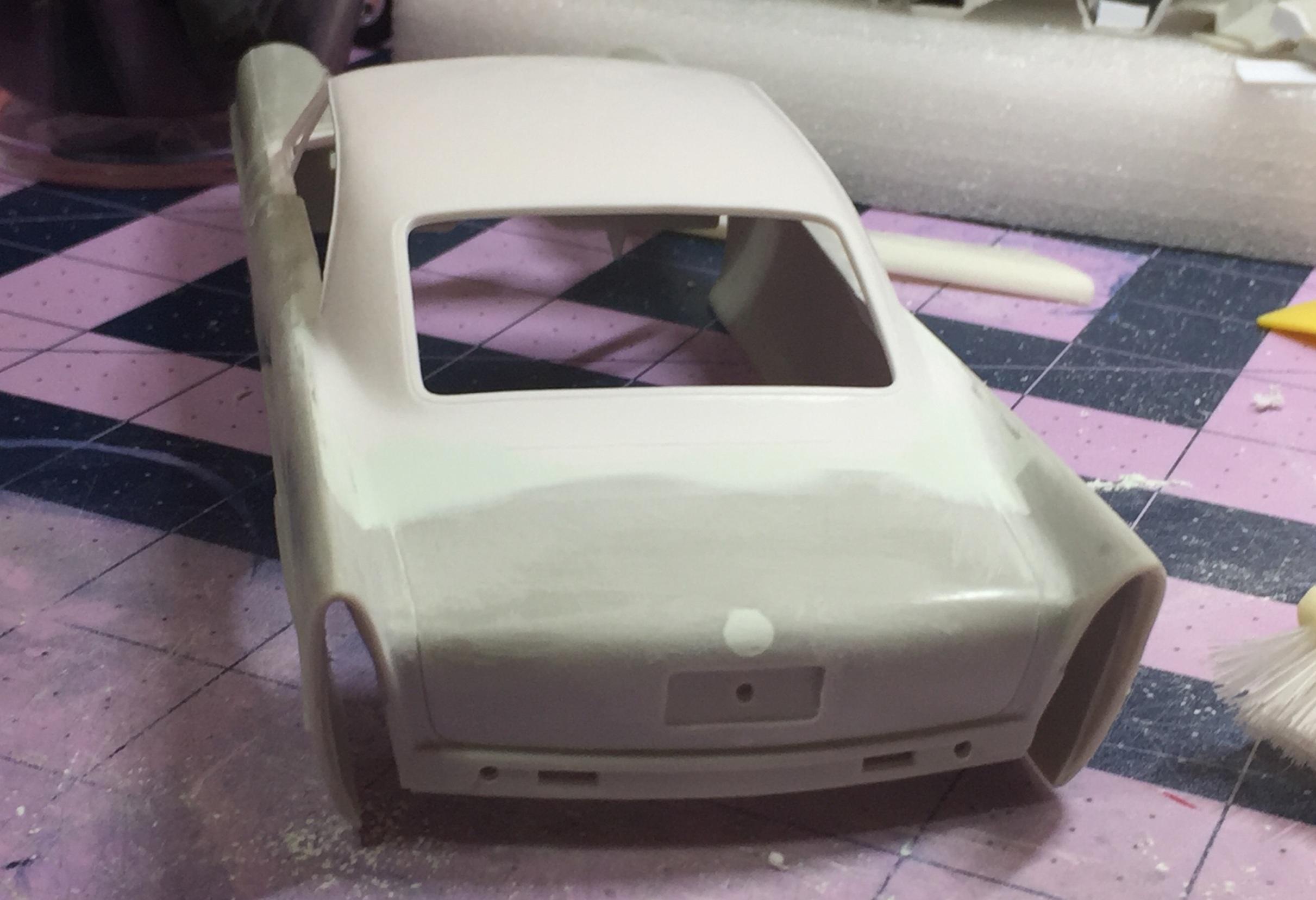

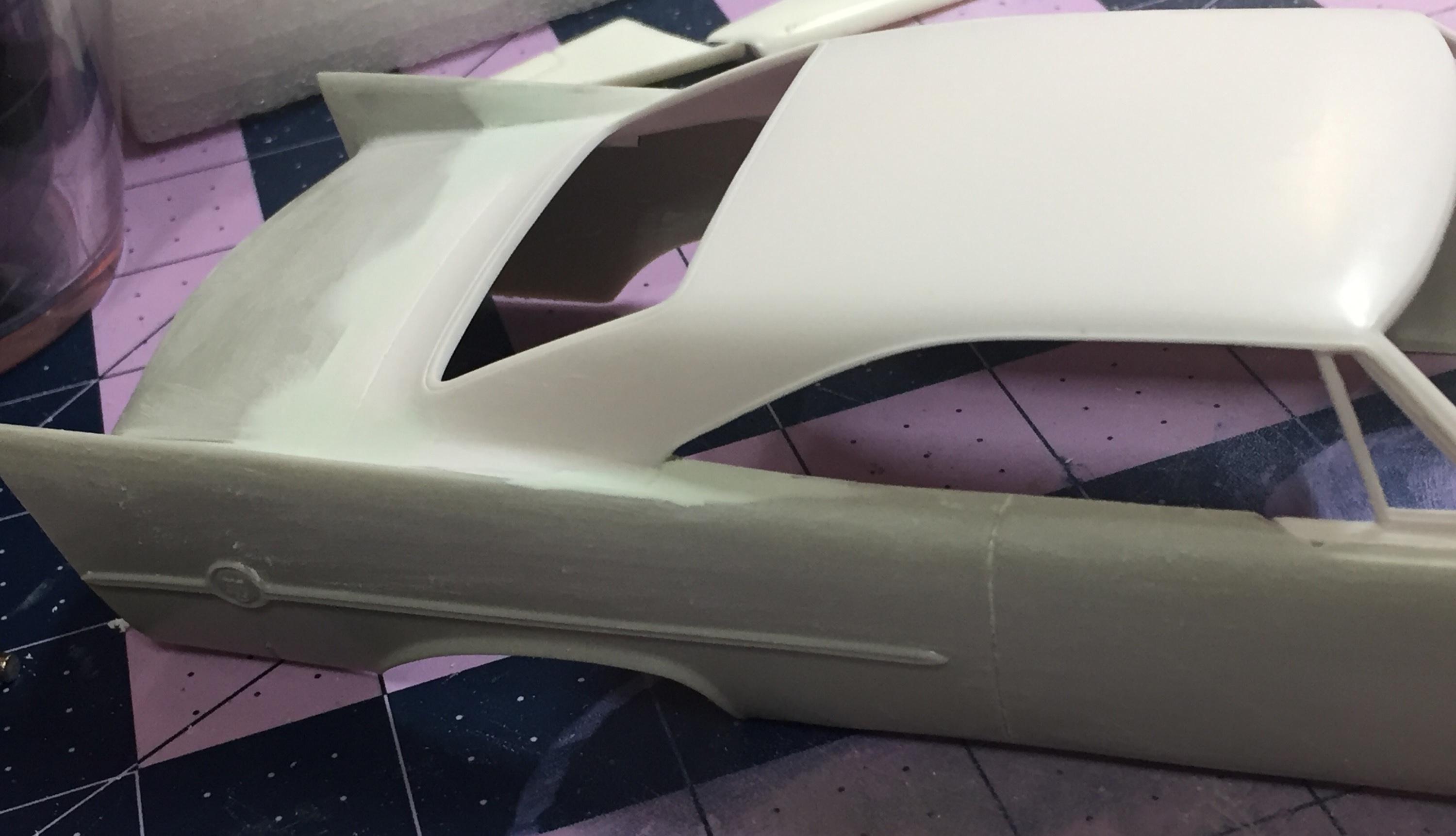

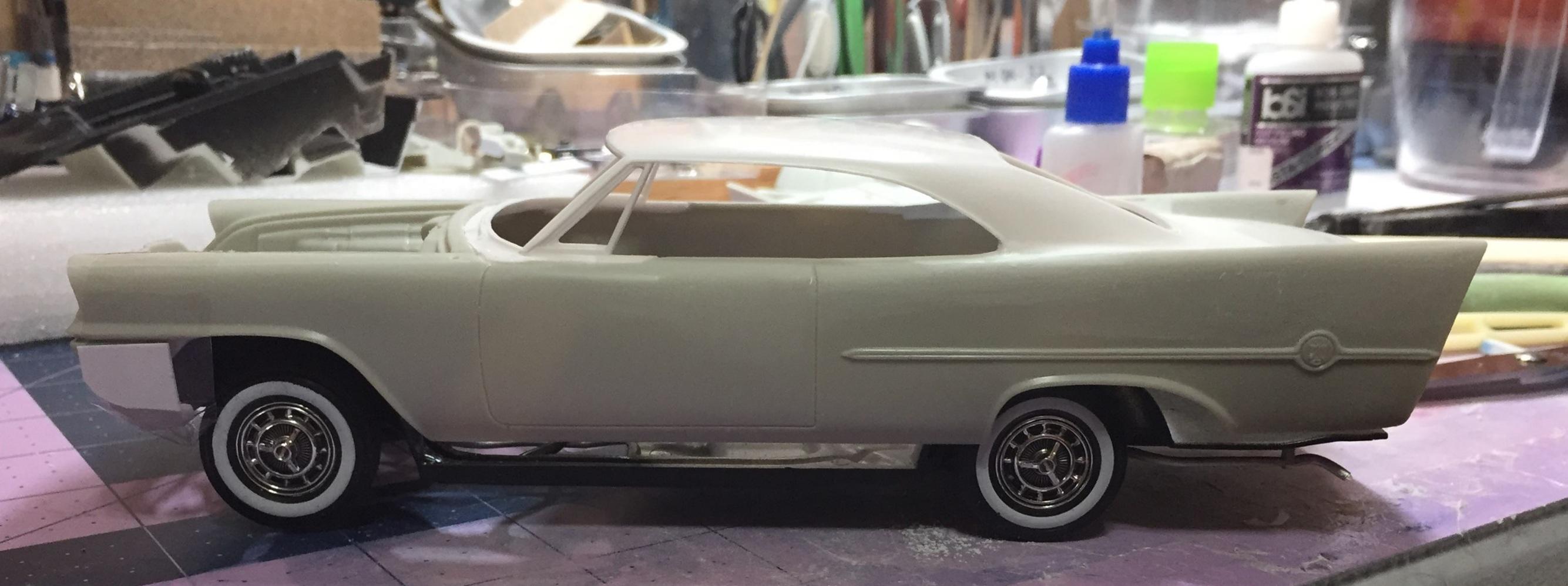

The initial attachment of the new roof was at the cowl ends/A pillar. At one point I thought I might drop the C pillars down a bit to lower the profile but that would cause a problem at the trunk. I wish I had spent more time analyzing things because the trunk panel lines line up perfectly. It may have been possible to get a precision fit and retain the original panel lines on both mating parts. It's still pretty close but I have a gap to fill. The rear of the roof is attached now and this 👇 is how the finished profile will be.

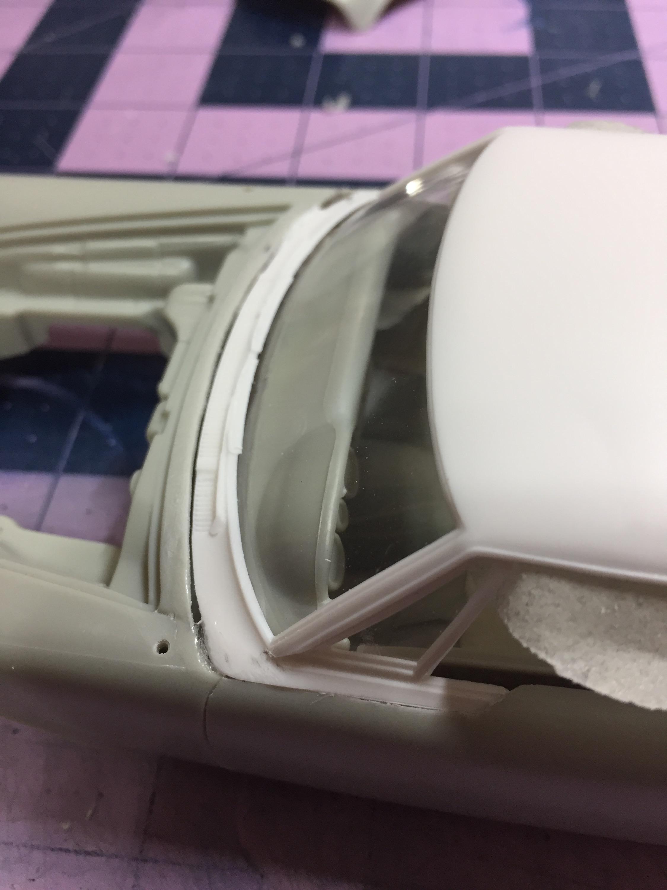

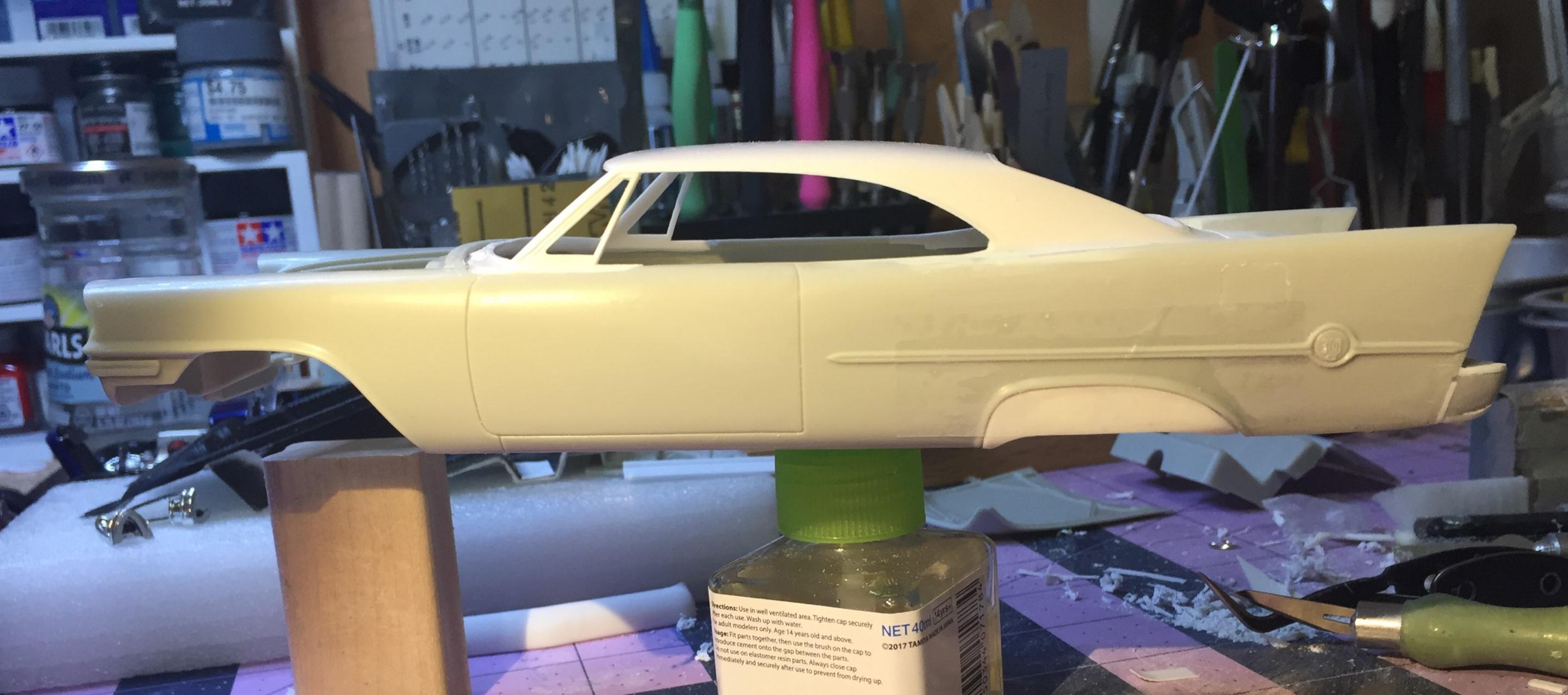

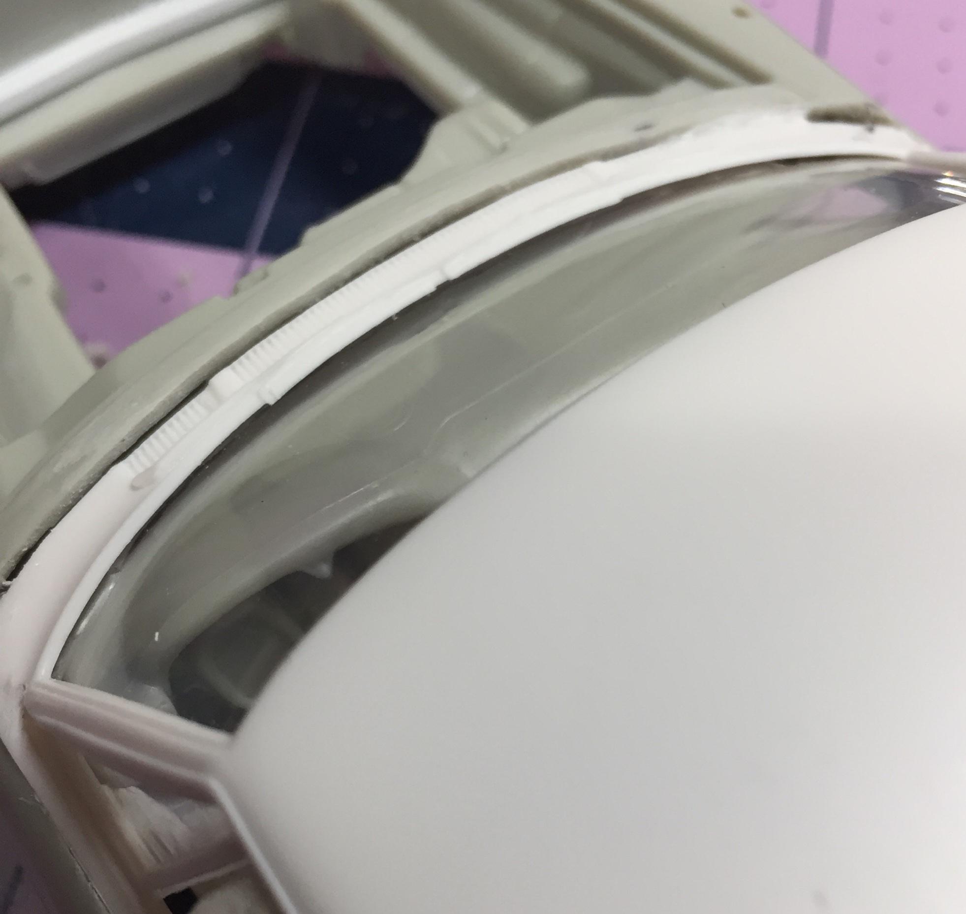

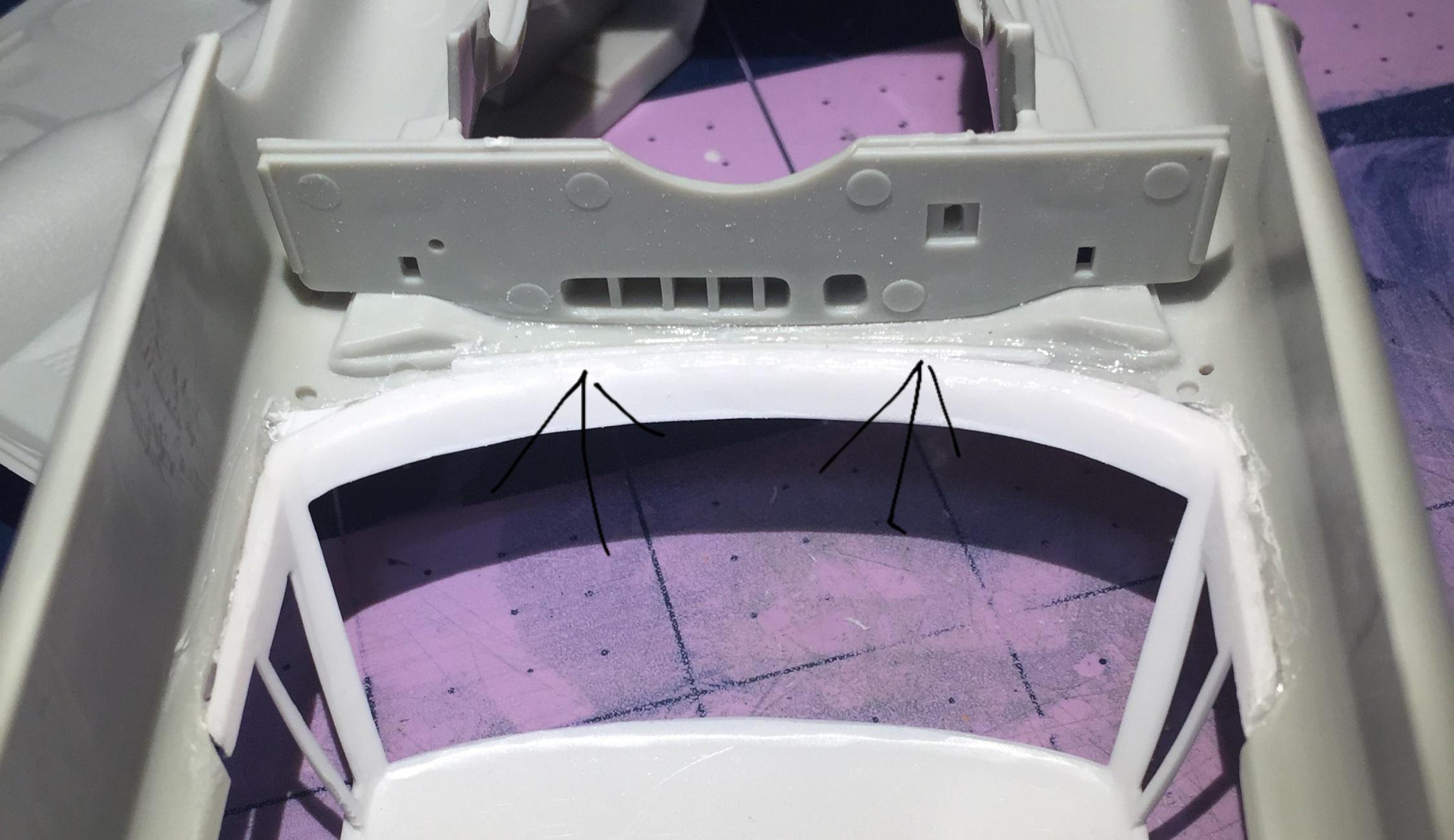

I reinforced the cowl with some styrene rod and CA. The top side will be filled and a strip will be added to the bottom of the windshield opening to have something to foil later on.

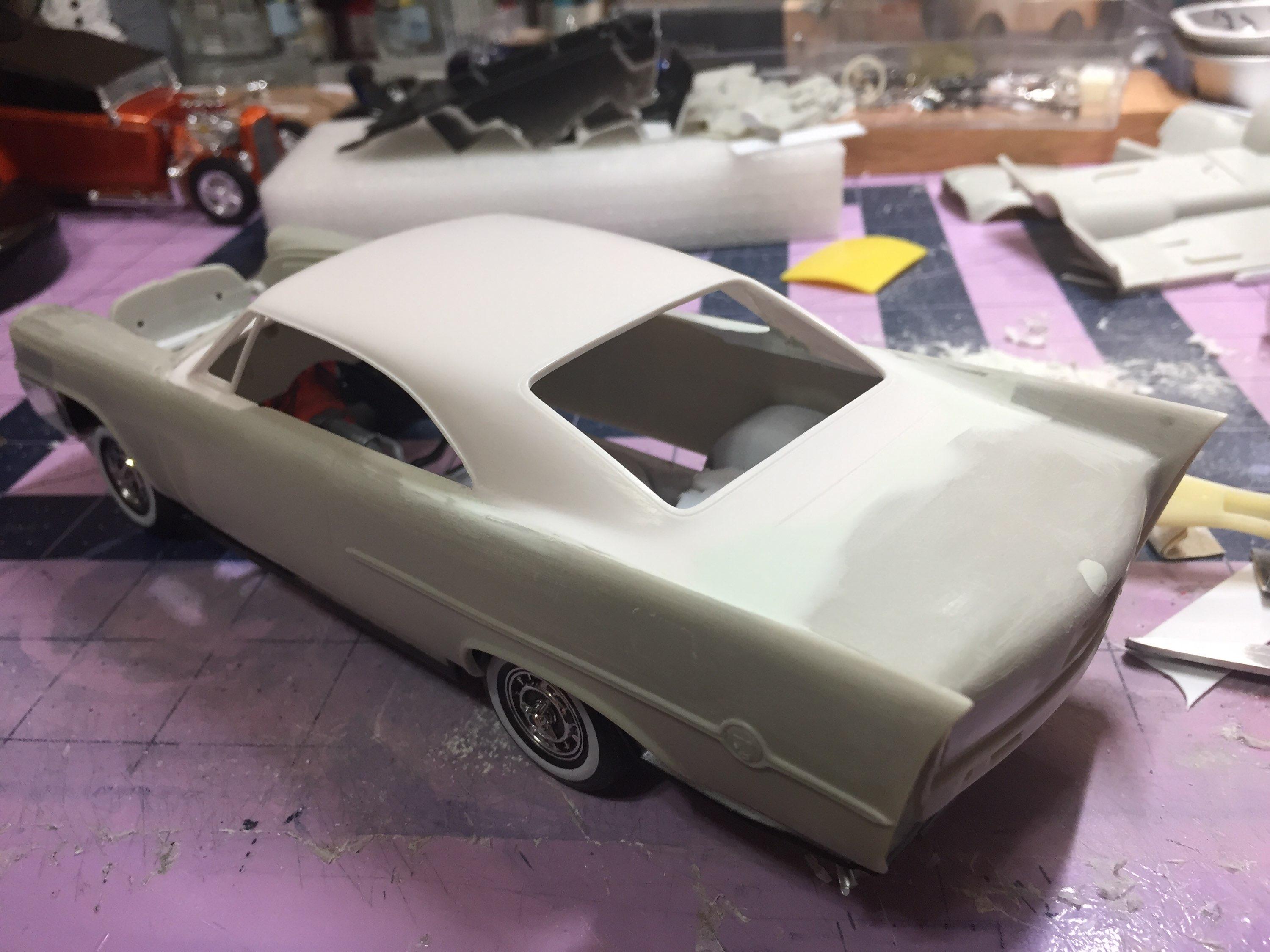

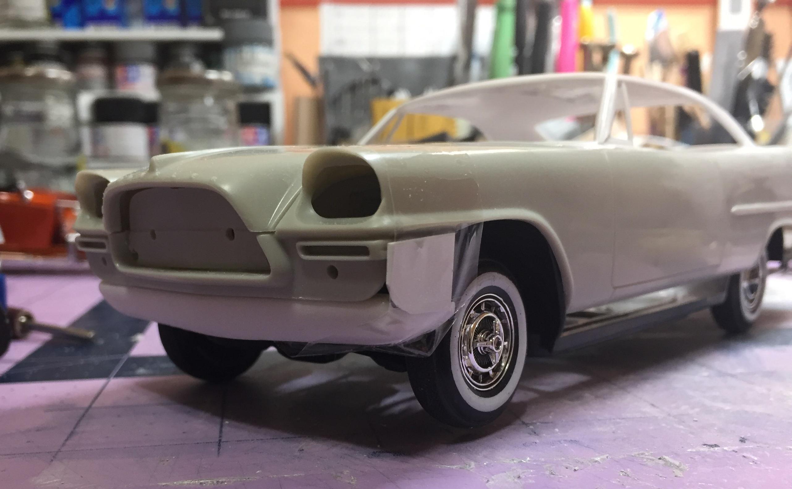

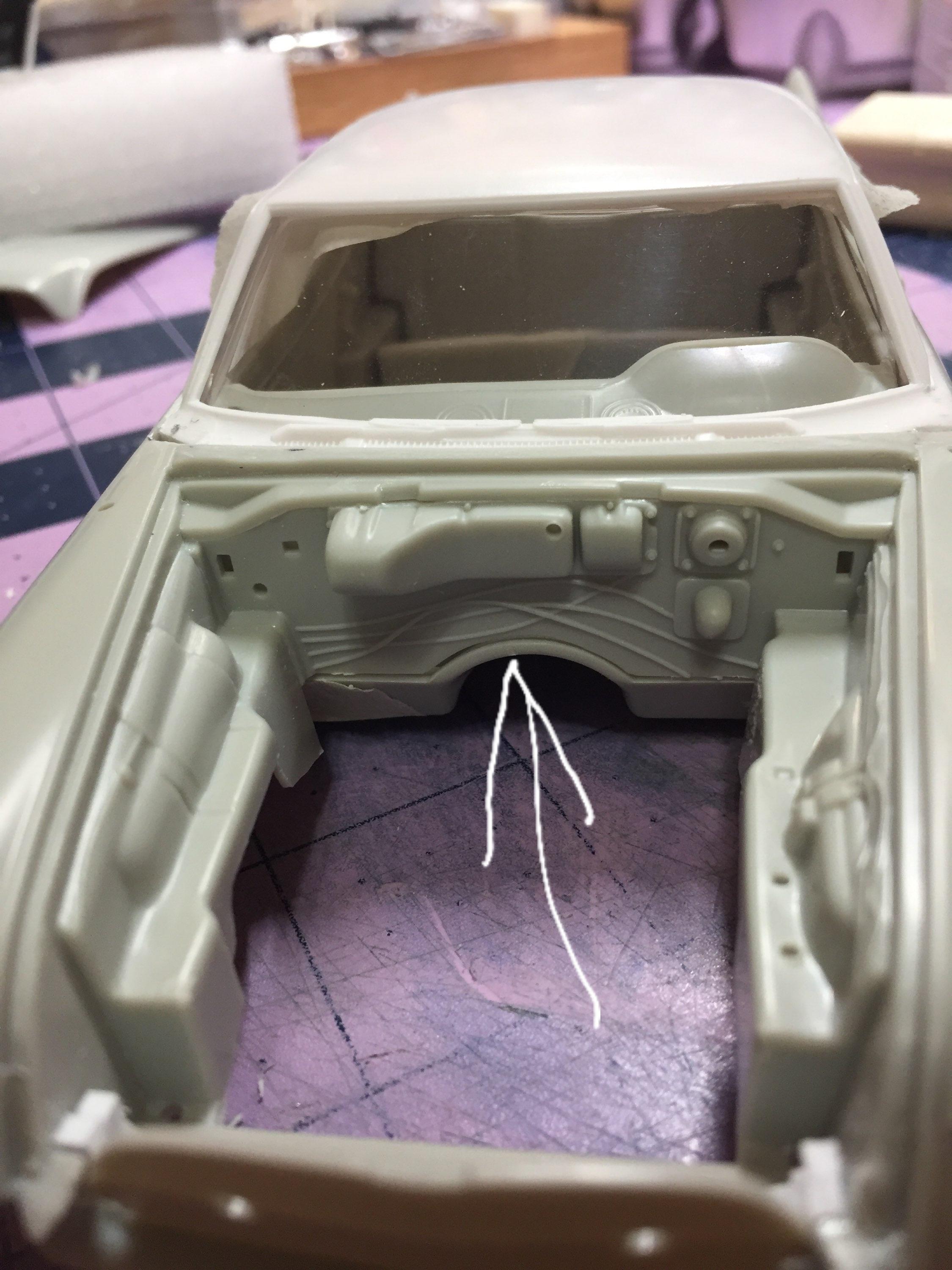

I spent some time getting the floor pan to mate with the firewall. I had a 2mm gap caused by windshield-to-dash interference. I removed some windshield material, some dash material, and rolled the dash down at the front edge. Lots of trial and error. But I got it.
IMG_9602.jpg.621427c5ca20fe6e805101ebf36384ba.jpgIMG_9601.jpg.3b33c82ab40b2e5cb52d3e9cc9a571b3.jpgIMG_9600.jpg.3a3b51a4e12dde64be7e9d529fdd6b6c.jpg

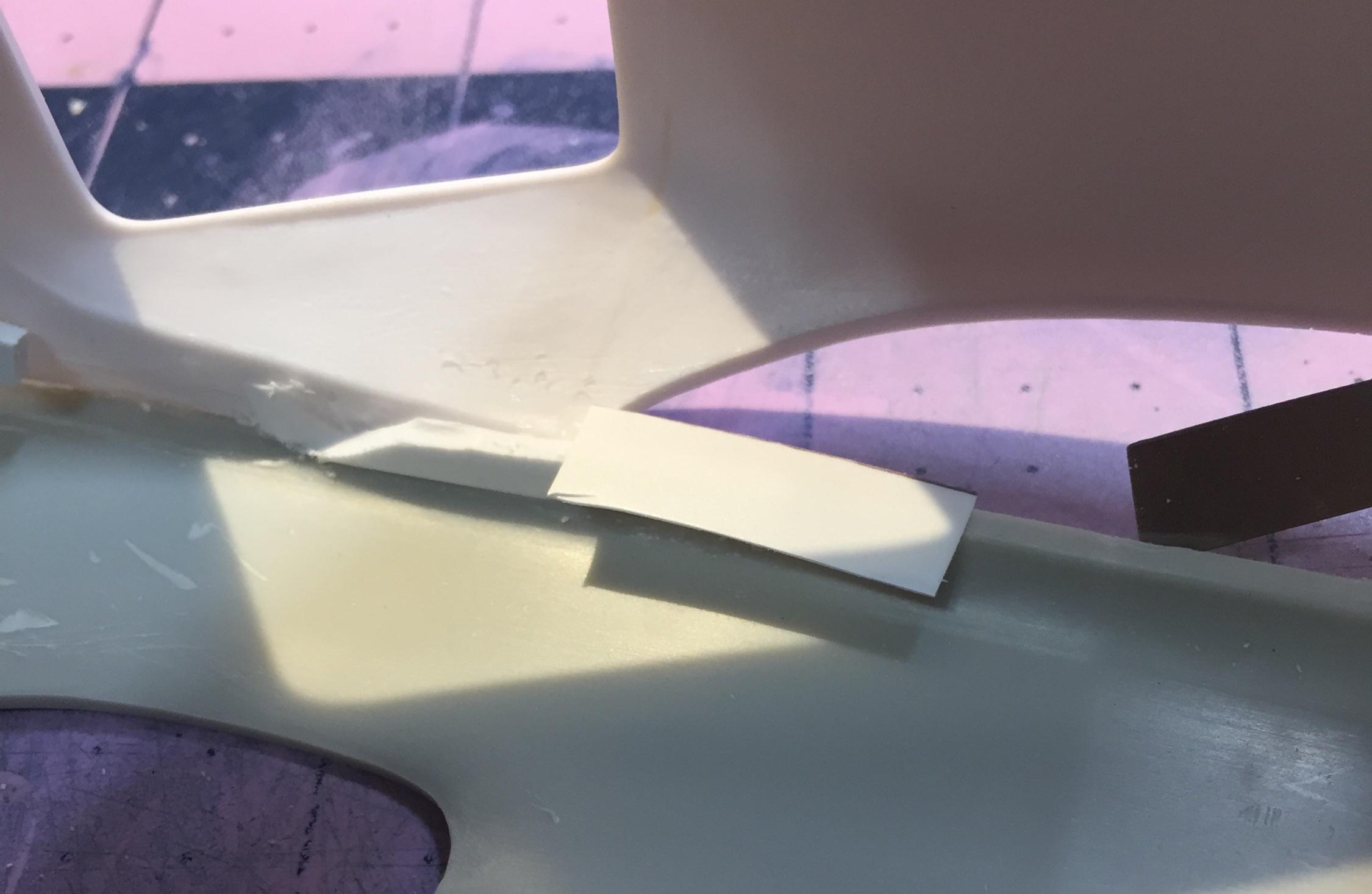

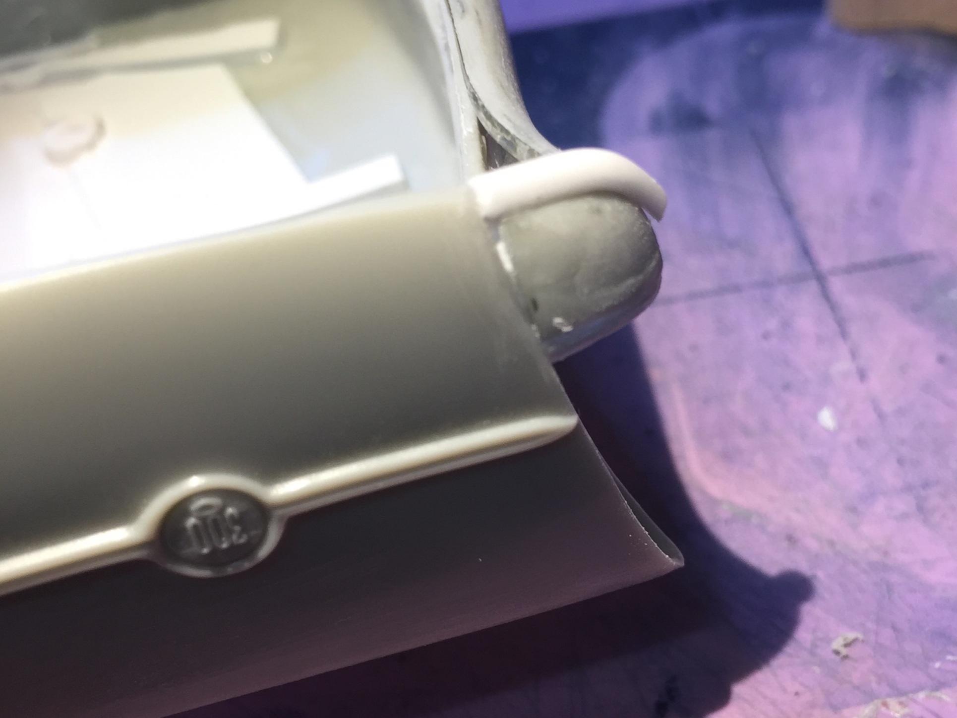

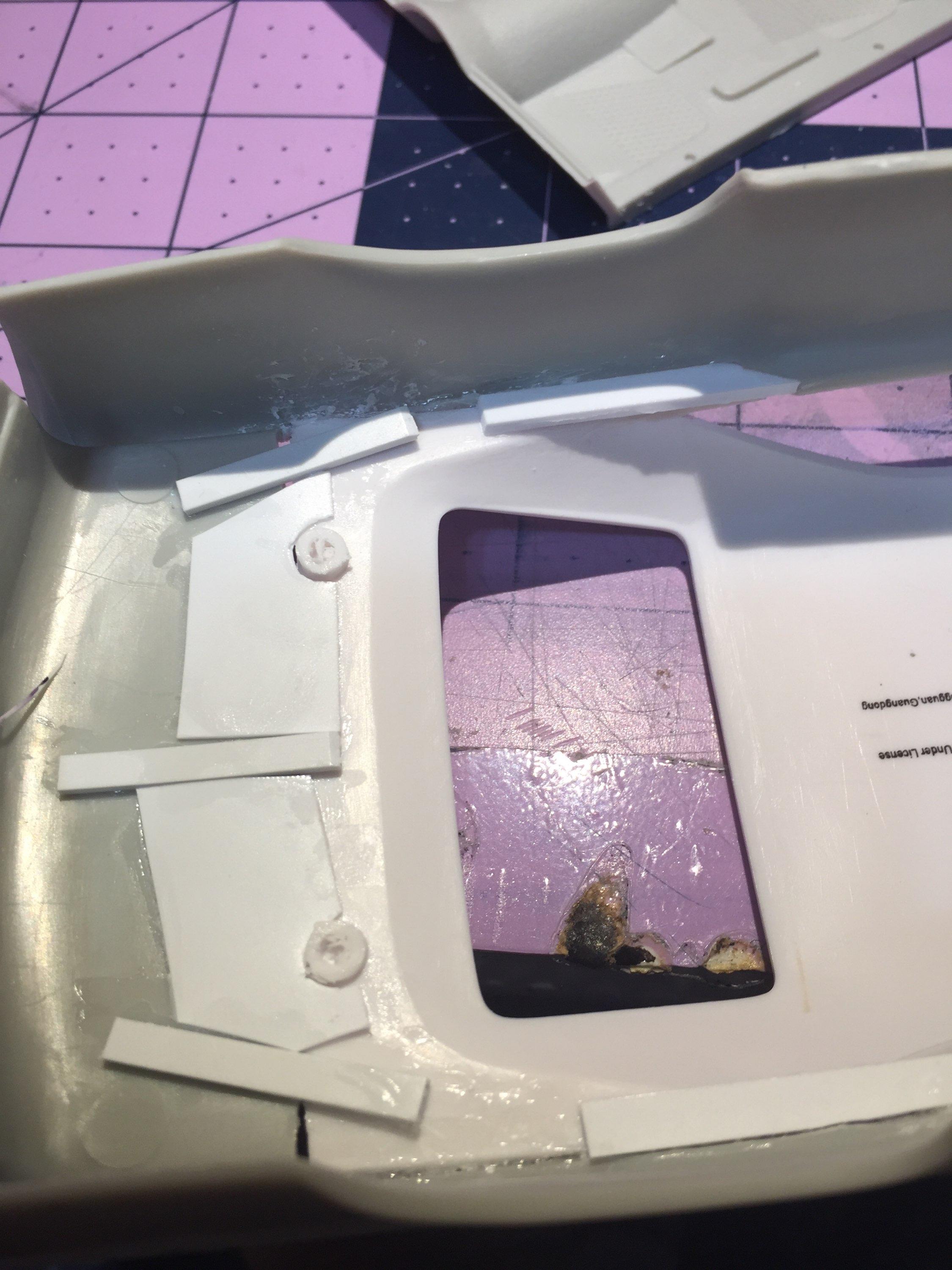

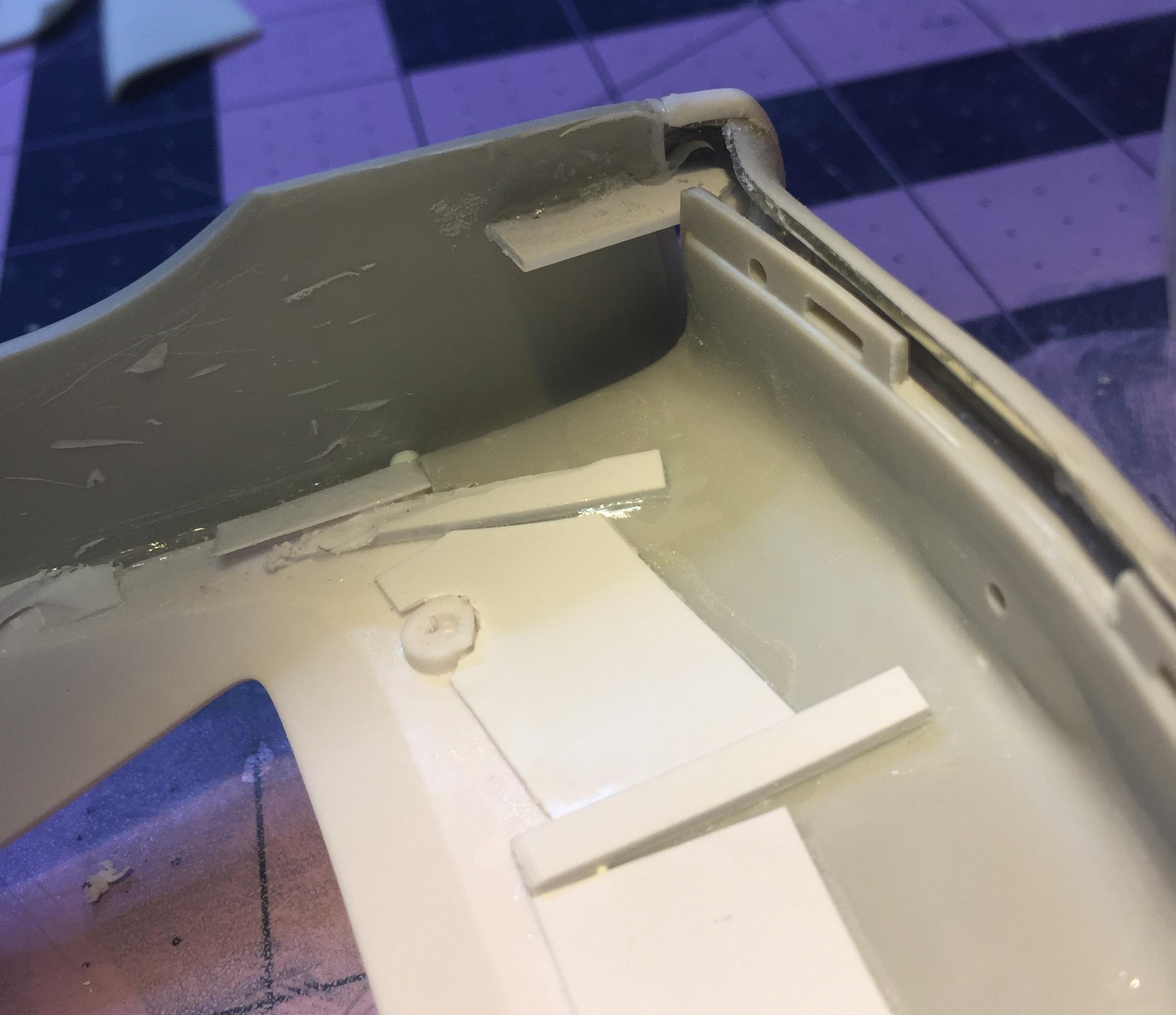

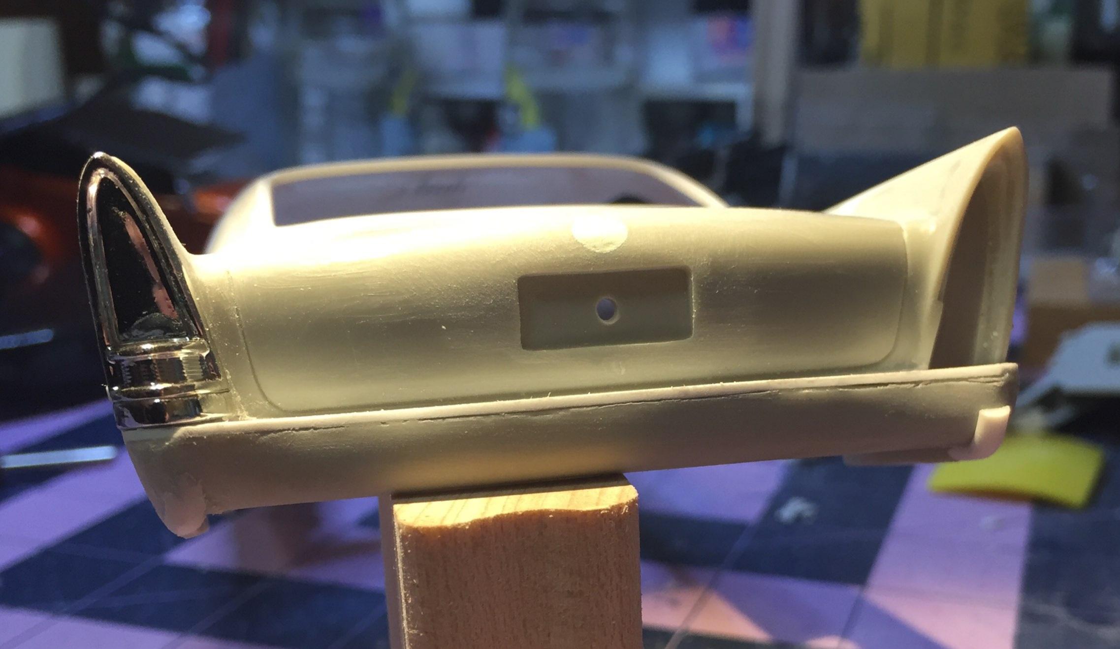

The rear attachment is reinforced around the C pillars inside. The "extra" material will be ground away.  Scrap sheet was added under the trunk gap to catch what squishes through the gap.

I have to say I was a sceptic and concerned about the gaps but you nailed it! The roof chosen is perfect! Can’t wait to see as you progress.
  • Like 1
I've always thought the '57 roofline was the weakest part of that design. Makes the whole car look clunky. I also think the GM swept back roofs look good on almost anything and I've been playing with your same kind of project on other cars. That roof swap looks wonderful on the AMT '62 Buick Electra.
  • Like 1

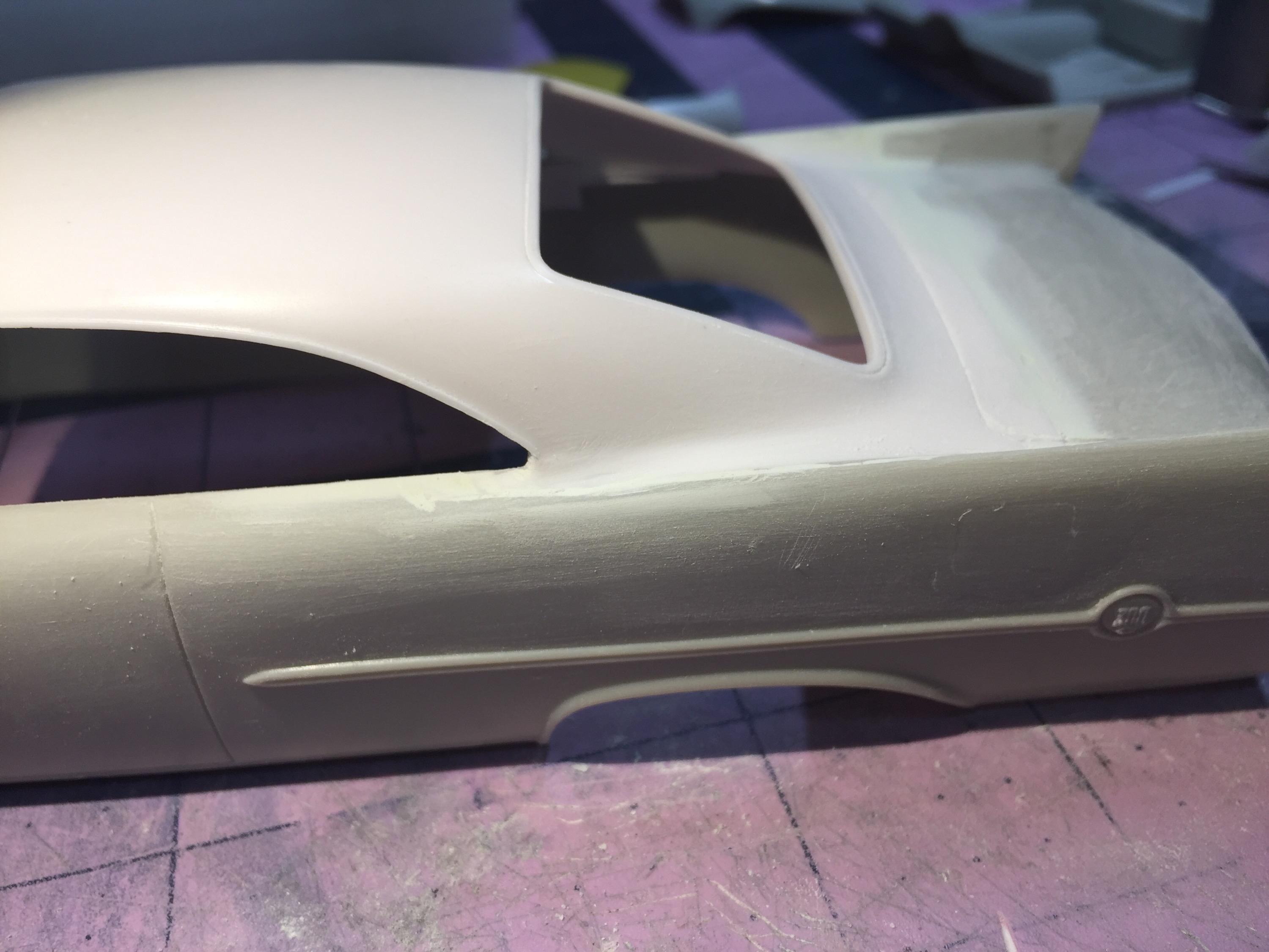

Did some body work.  It's my second-favorite task. I just like the smell 😌

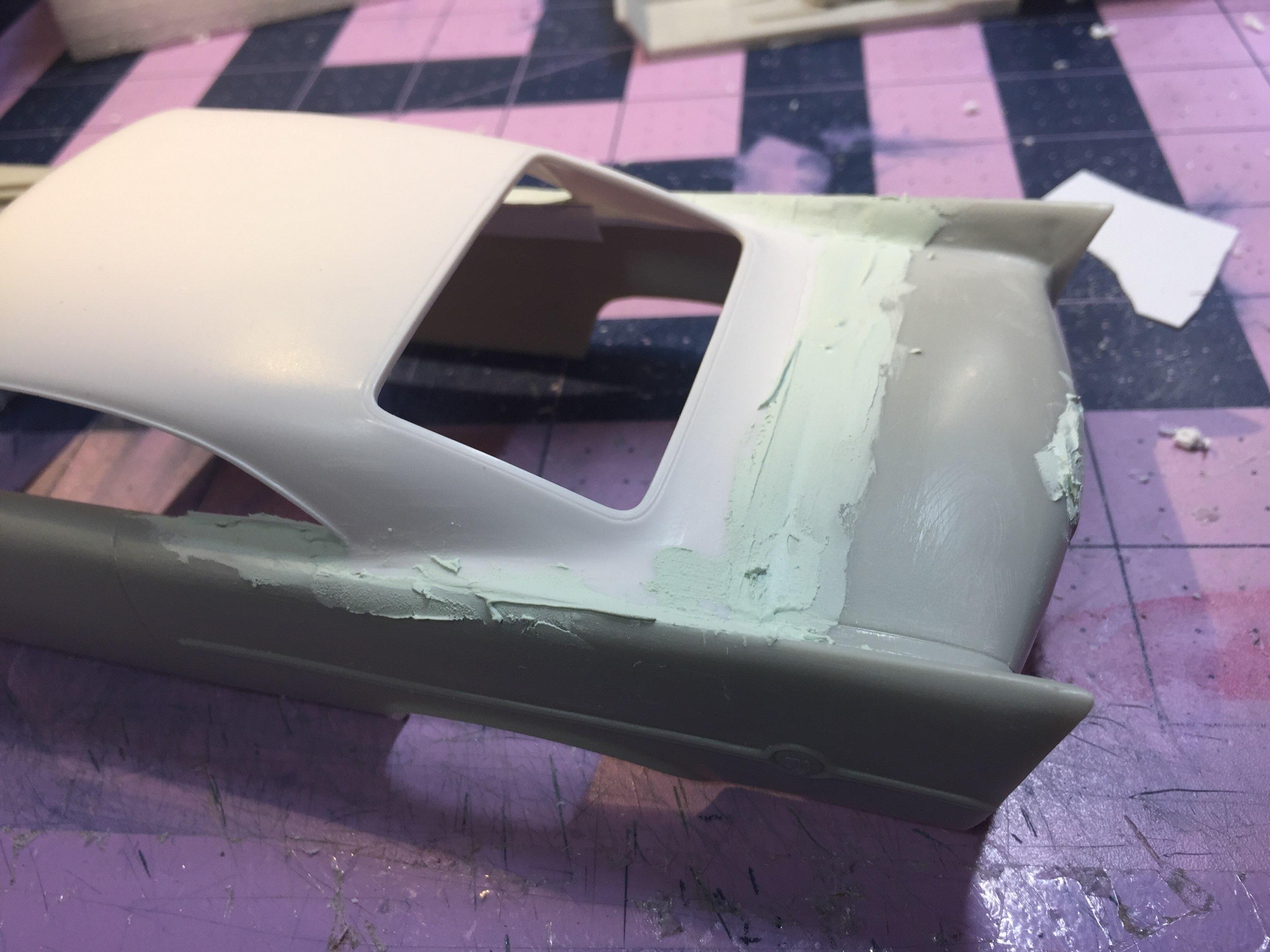

Had to dremel the extra meat. Gotta plug a couple of holes. Sanded areas to be filled with 320. Almost Bondo time! 😛.

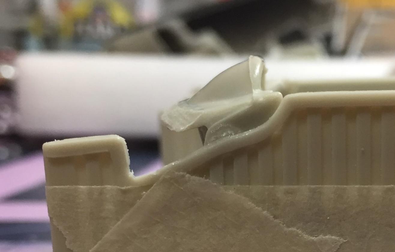

More slugging at the C pillar, this is a backing wall for filler on the outside
Pistachio frosting 🥳.  Yay!

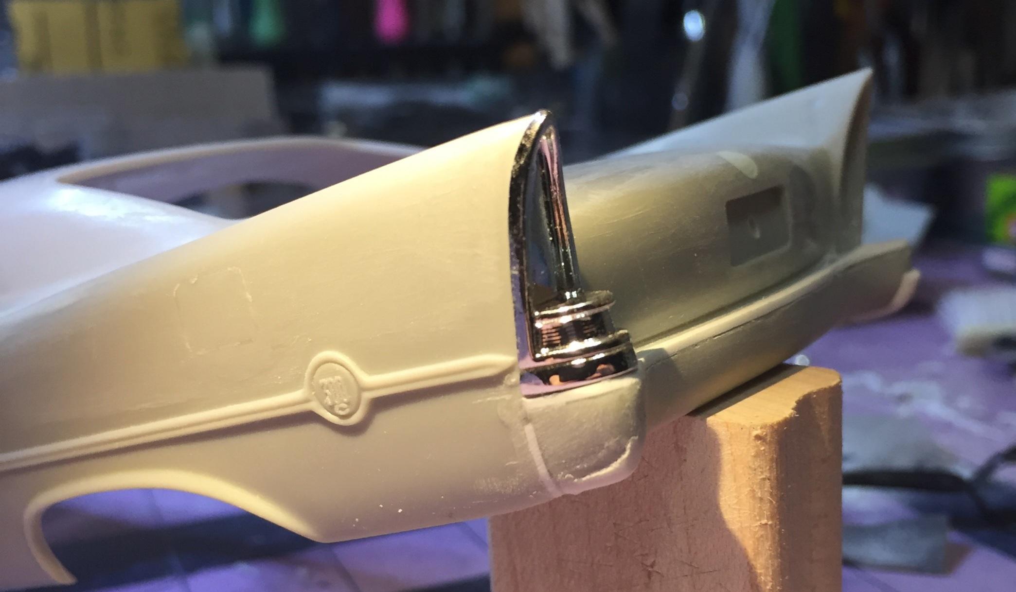

Blending in the dissimilar curves at the aft seam. The trunk panel lines will be a headache. 😕 but not if I square 'em off 🤔.......🙂
