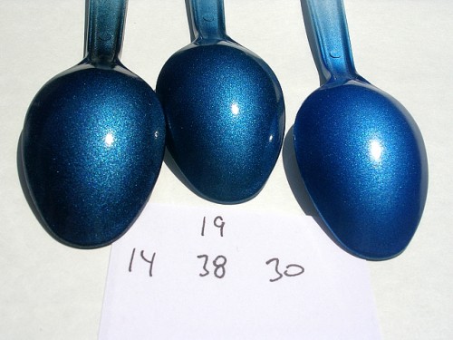

VW Dave Posted November 8, 2009 Posted November 8, 2009 Not the best picture....do you have any better ones? Tamiya TS-50 Mica blue might be the color indeed, but you should try it over different base colors to get it as close as you can. Here are my tests over(from left to right) TS-14 gloss black, TS-38 gunmetal, and TS-30 silver leaf: 1
Bridgebuster Posted November 8, 2009 Author Posted November 8, 2009 Not the best picture....do you have any better ones? Tamiya TS-50 Mica blue might be the color indeed, but you should try it over different base colors to get it as close as you can. Here are my tests over(from left to right) TS-14 gloss black, TS-38 gunmetal, and TS-30 silver leaf: Thanks!! I'll go get a can of the Mica Blue. I think the TS-30 looks closest. Since we don't have the Chevelle anymore, I'm going from memory (which is about shot like the rest of me). Thanks again, Phil
VW Dave Posted November 9, 2009 Posted November 9, 2009 Thanks!! I'll go get a can of the Mica Blue. I think the TS-30 looks closest. Phil - If that one looks the closest, you will need more than one can of paint; the Mica Blue is TS-50, while the TS-30 is Silver Leaf(the base color). My numbering system on the spoon pics shows the base color numbers under the top color number, so I can make more accurate captions. Not having the car anymore allows you more color leeway, so you have it made IMO....I hunted for about 6 years for a color to get even near to the metalflake finish on my 1:1 dune buggy, and having it right in the garagemade it hard to accept an 'almost.'

VW Dave Posted April 15, 2013 Posted April 15, 2013 (edited) I'm not familiar with PS-16...after Googling it, I see it's a metallic blue polycarbonate paint(for clear RC car bodies).....I won't be testing that any time soon I did test Tamiya's TS-19 metallic blue over(from left to right) TS-14 gloss black, TS-38 gunmetal, and TS-30 silver leaf: Edited April 15, 2013 by VW Dave
OrLoko Posted April 16, 2013 Posted April 16, 2013 Man this color TS-19 with TS-30 looks great, with TS-14 too... I Think I'll paint with 19 and 30, if I find it on local stores... Thx so much for post it man ! just another thing, do you think this TS work in the same "way" like PS ? I'll use in a polycarbonate clear body.. Thx so much ! Have nice day !
