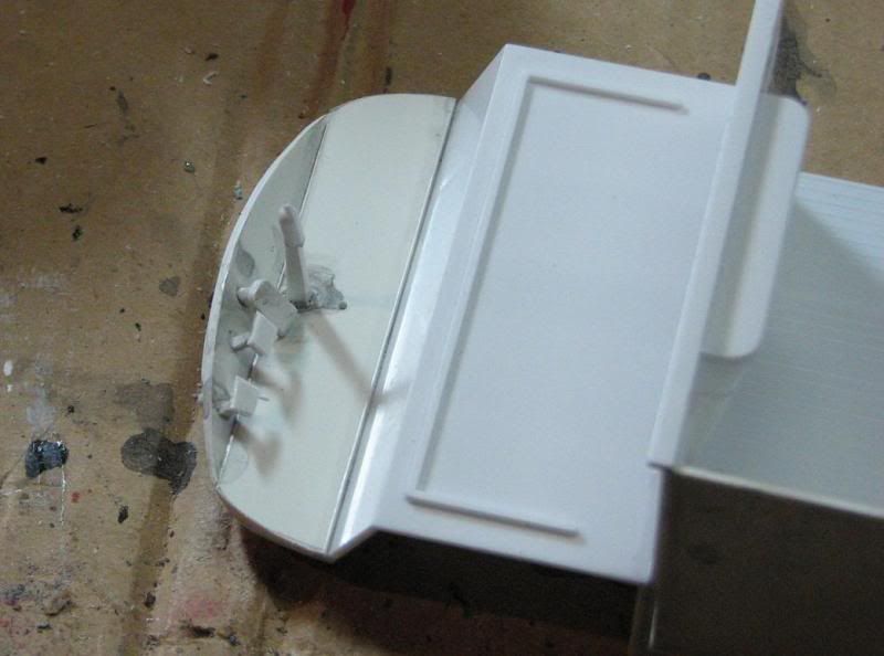

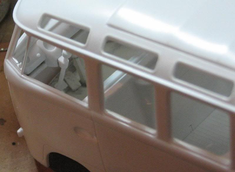

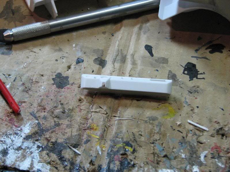

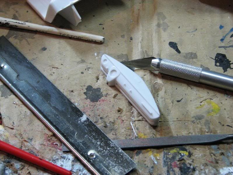

Worked on the dash today. The dash should have a shelf at the bottom of it.
Before:
During:
After:
Enjoy!
Edited by Tony T

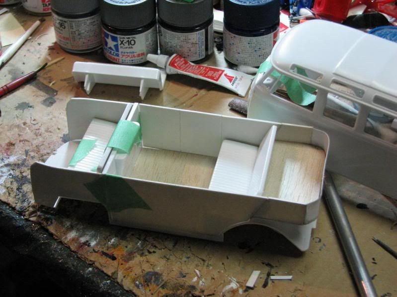

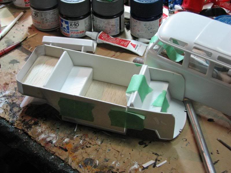

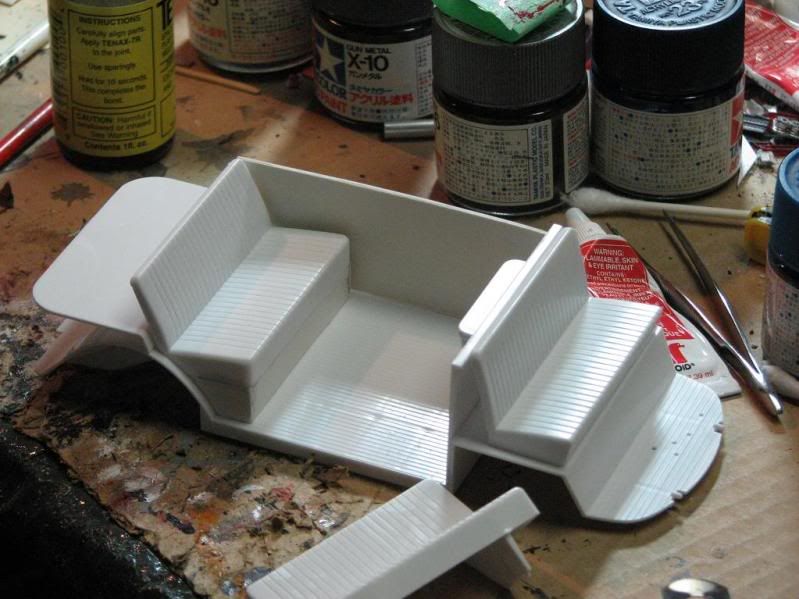

I was wondering why you had changed the floors to balsa wood?

Jerry - The balsa is what I am considering to cover the floor, due to the sink marks from the frame under the floor. Easier than trying to fix the floor! I do like your build, too, and see we both fixed the dash!!

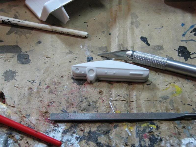

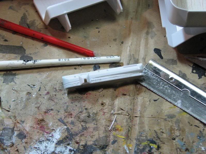

Updates from today:

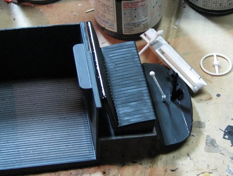

Driver's area, new front floor with the toe board kick up, scratchbuilt pedals and park brake (none in the kit!):
Looks pretty good from outside:
A coat of Tamiya German Grey to the interior, flat black on the seats, and front floor-also filed off what was supposed to represent the grab-handle, now a piece of wire.

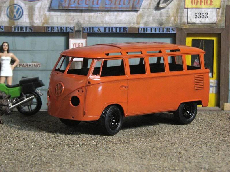

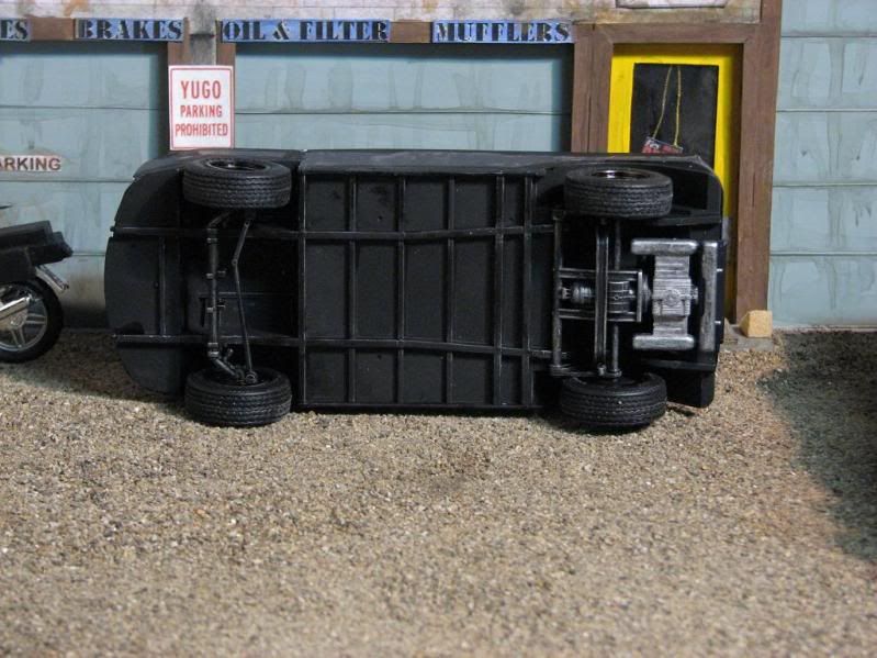

Finally had some bench time for this one...got a coat of paint on it, over some red oxide primer. Got the interior panels done, and wheels & tires on...bit of dry brushing on the chassis...I'll give the paint a few days to gas out, get another can, and give it a bit of a sanding to smooth it out some. Also, got a coat of light wood stain on the balsa floors...
Paint is Tamiya Orange in the spray bomb...Enjoy!

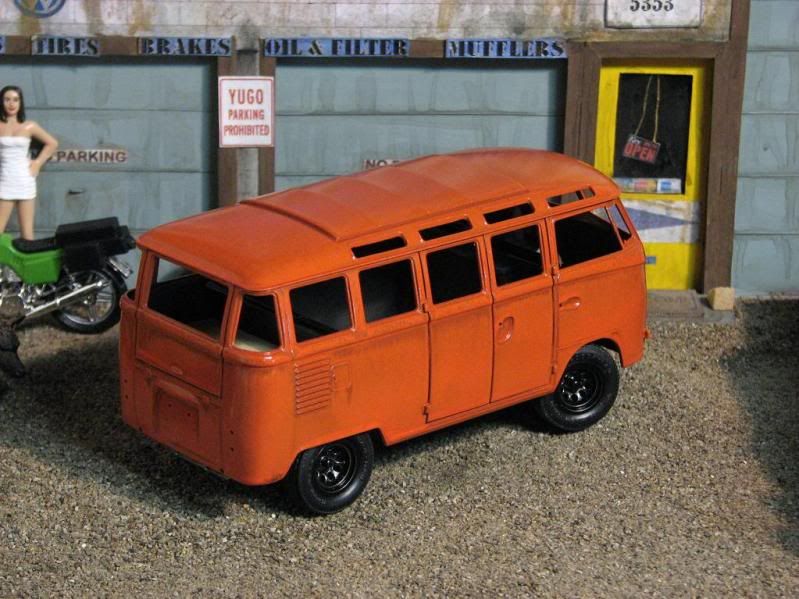

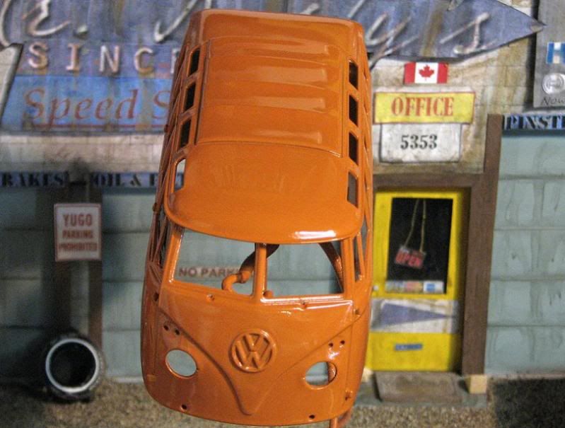

Fresh coat of paint just now...Krylon "Pumpkin Orange"...Cheaper than another can of Tamiya orange!! Plus I'll have more for another project! (Not sure how close this would be to a certain Charger, with a number "01" on it.)
Anyways, here are a couple of pictures...don't touch, though, the paint is still wet...B)

Orange looks good on the VW bus
I like Krylon's new nozzle. You can adjust the spray pattern angle from horizontal to vertical, and all points in between. I found it is no heavier than Tamiya, or Testors out of the rattle can.
