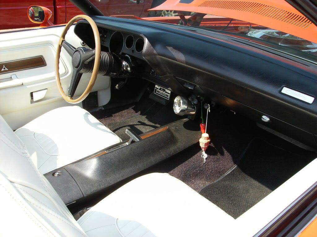

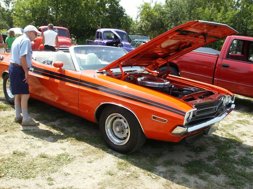

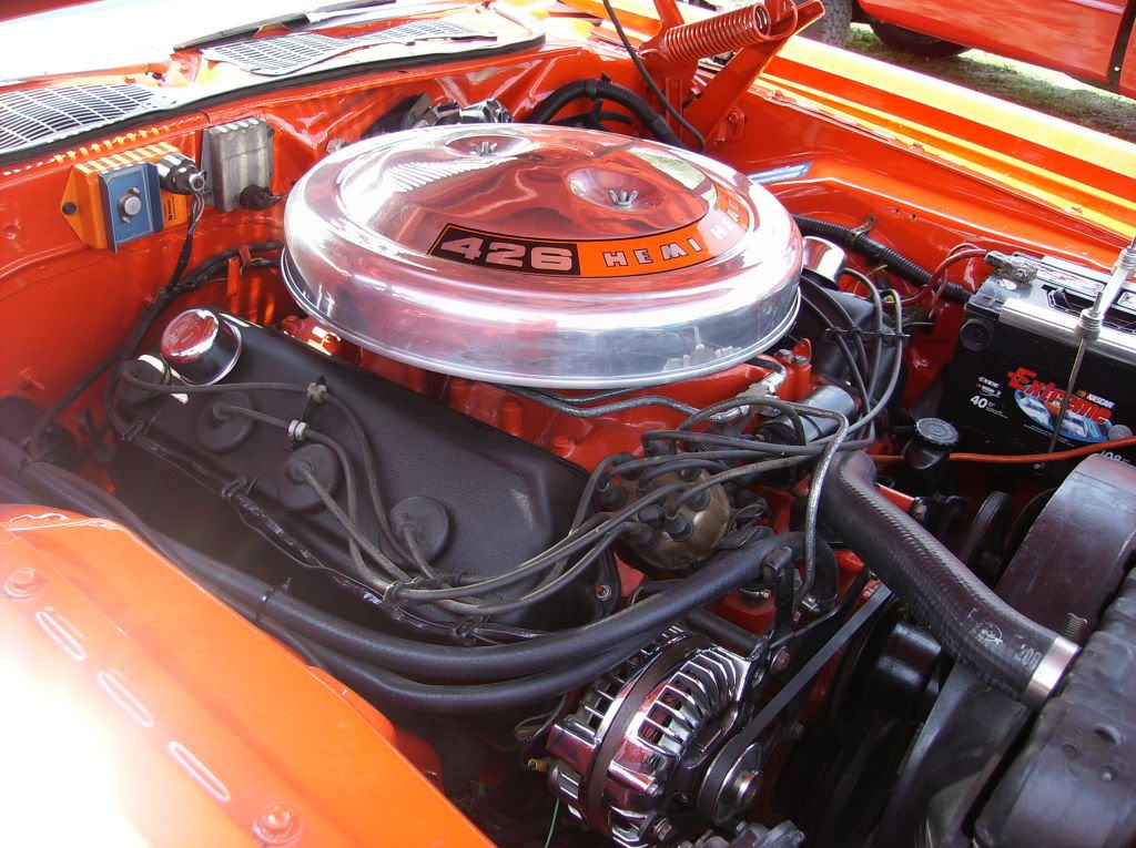

Thanks for the pictures, Nick. Other than the exterior/interior colors, it's not what I'm building. But, I do appreciate it! B)

Thanks for the pictures, Nick. Other than the exterior/interior colors, it's not what I'm building. But, I do appreciate it! :lol:
I know that's why I posted it, the interior exterior colors :lol:
