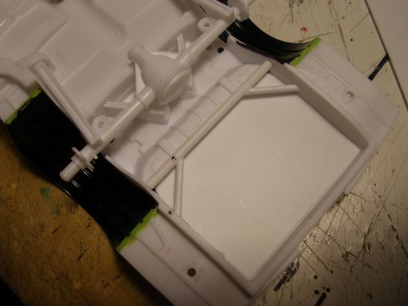

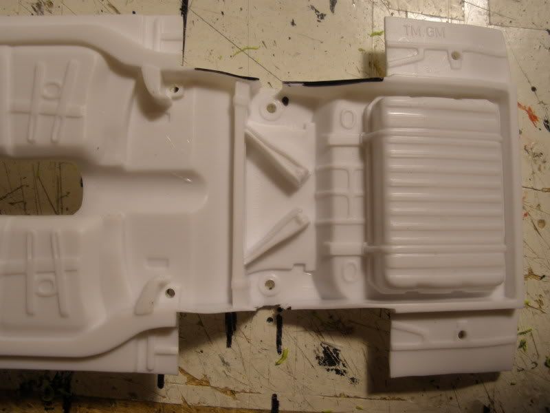

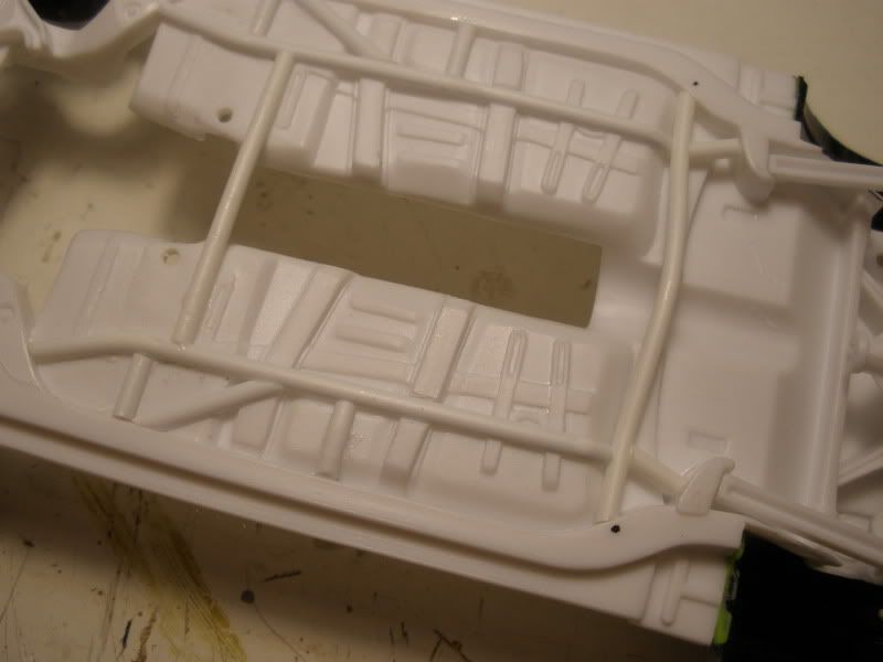

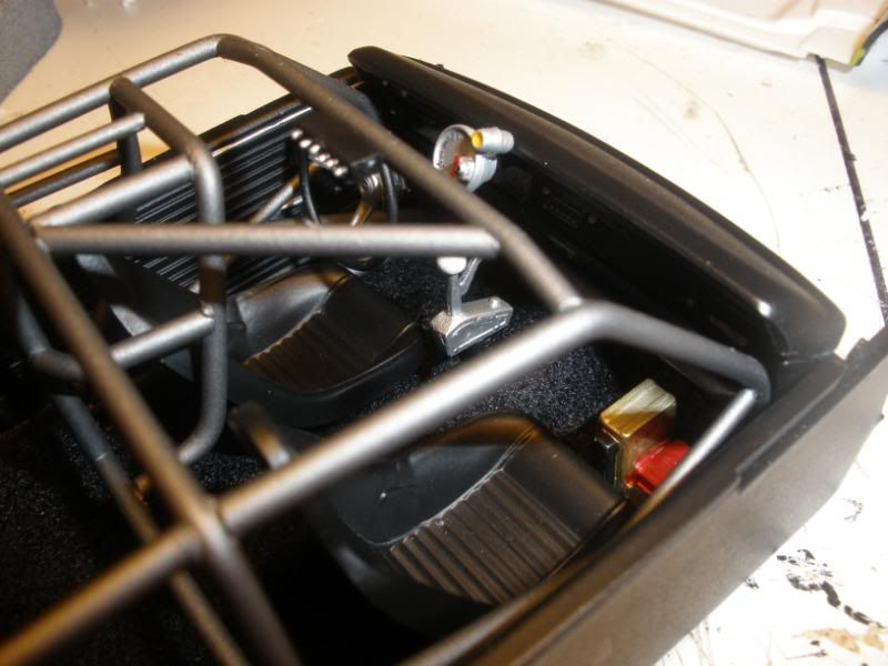

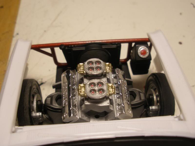

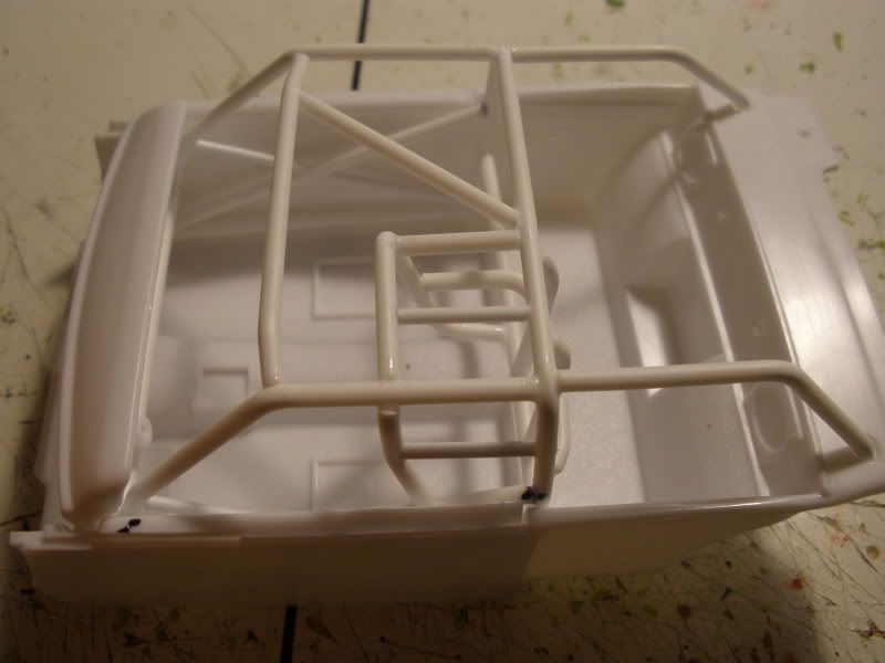

RTK434 Posted February 14, 2010 Share Posted February 14, 2010 I started on this kit some years back. I had got some of the chassis mods and the roll cage built and that was about it. Since I'm building a car that would be legal to run in drag radial the rear frame rails have been notched but remain in the stock location. I then installed some mimi tubs and removed the stock gas tank. I then added some bracing to the rear frame as well as the under car tubes needed for the car to have a 25.5 chassis cert that is needed to go quicker than 8.50. Over the past few days I cut out the inner fenders from the body, fabbed a new radilator support filled the top of the frame rails and did some work on the interior. On to the pics. A few more. Thanks for looking! Quote Link to comment Share on other sites More sharing options...

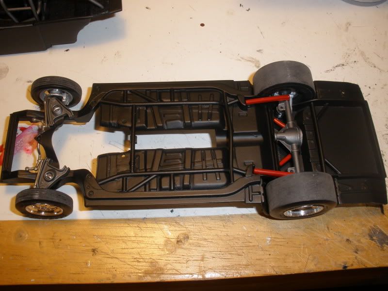

RTK434 Posted February 15, 2010 Author Share Posted February 15, 2010 That's looking real nice Jeff! I like all of the work you've done to the chassis and the roll cage. Are you planning on making a 4 link for the rear? Also where did you source the rear tires from? Thanks for the compliments everyone. No 4 link for this one. Drag radial cars have to run stock style suspension. A typical drag radial A or G body will have tubular upper and lower control arms and an anti roll bar. Most rules allow coil overs but not everyone runs them. My 1:1 drag radial camaro has all bolt in replacement parts and still runs the stock coil springs. The tires are some old good year blue streaks from the parts box. I'm going to cut some tread into them to look like a Mickey Thompson drag radial. I hope to post more pictures later tonight. Quote Link to comment Share on other sites More sharing options...

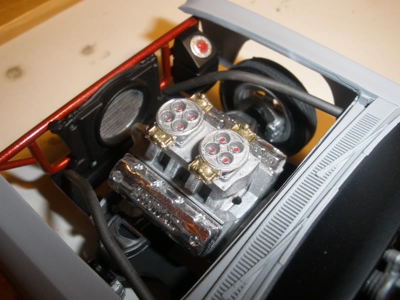

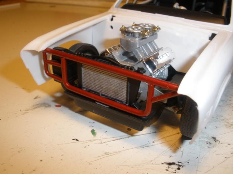

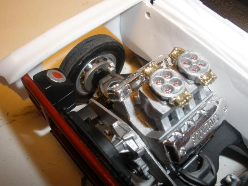

RTK434 Posted February 16, 2010 Author Share Posted February 16, 2010 Small update. Got some paint on the chassis and front suspension. I used krylon semi flat on the chassis and testors gunmetal metalizer on the control arms. I added a set of parts box calipers and rotors to the front. The radiator support was painted hondurus maroon which will be the body color. The scirroco style radiator and 1 gallon fuel cell for the nitrous fuel system are from the parts box as well. Quote Link to comment Share on other sites More sharing options...

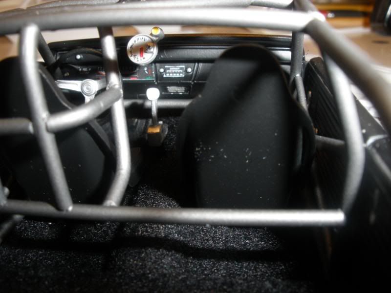

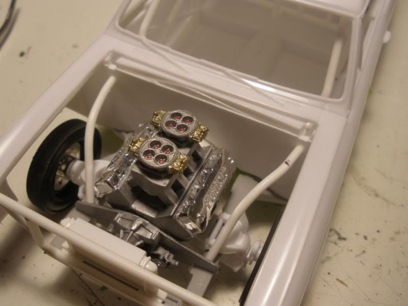

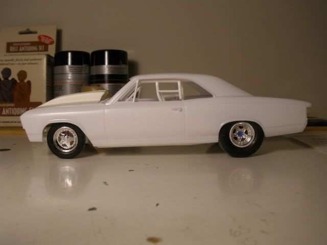

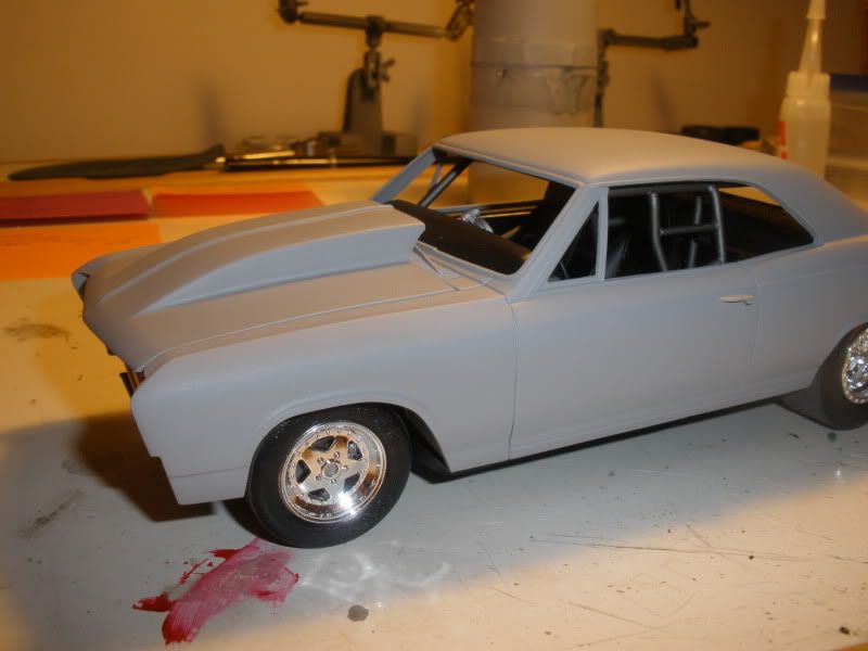

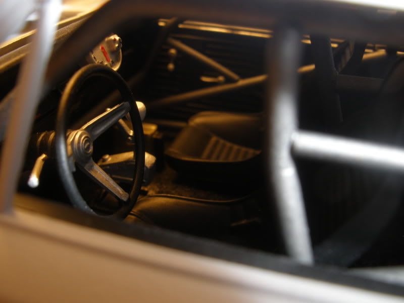

RTK434 Posted August 24, 2010 Author Share Posted August 24, 2010 (edited) I finally took a break from the 1:1 race car a.k.a.money pit to get a little work done on this. Body is in primer and a little more progress has been made on the chassis. Here's a few quick pics i snapped tonight while I was working. Thie is my first real departure from a pretty much box stock build so its taking awhile. Thanks for looking. Edited August 24, 2010 by RTK434 Quote Link to comment Share on other sites More sharing options...

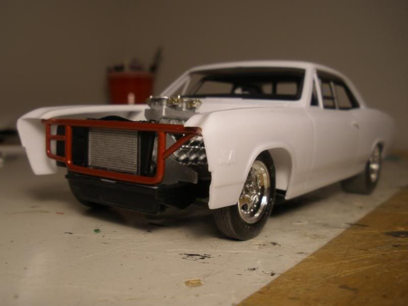

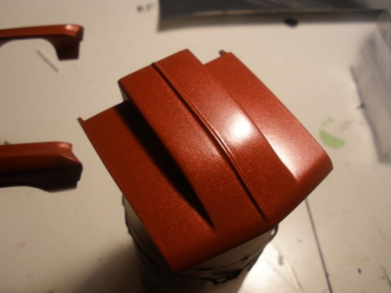

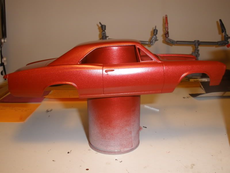

RTK434 Posted August 25, 2010 Author Share Posted August 25, 2010 Thanks for the positive comments. I got some color on the car last night. It's model master laquer hondurus maroon. Hope to get some clear on it soon. Quote Link to comment Share on other sites More sharing options...
