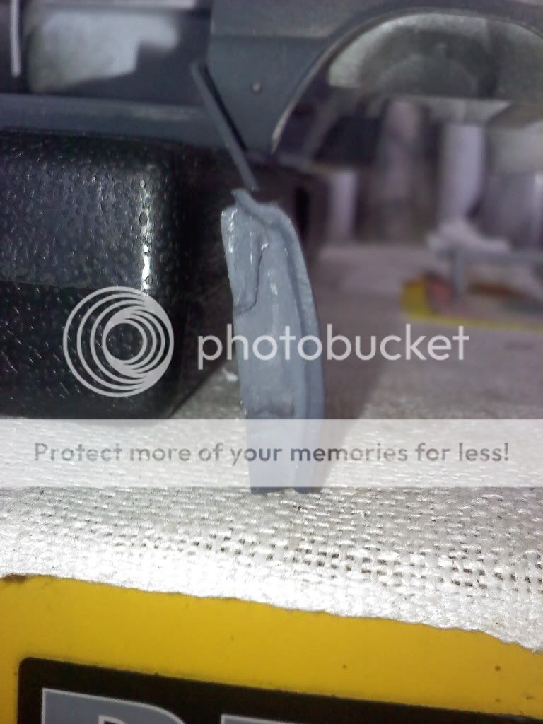

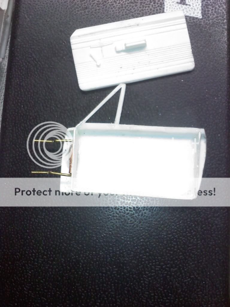

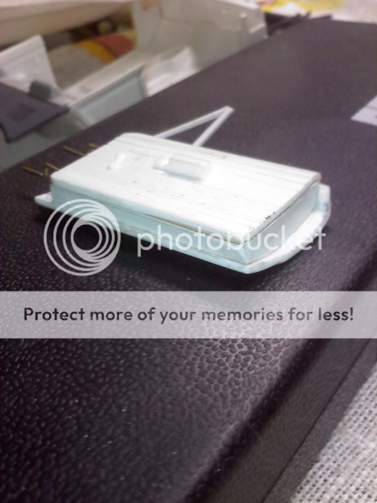

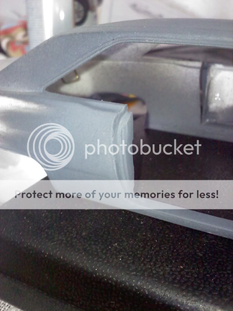

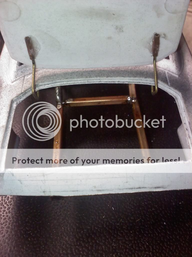

bobbyj Posted September 19, 2010 Author Share Posted September 19, 2010 (edited) im interested in how you made the doorjambs?...i cut the doors open on a scrap body once and in trying to figure out how to make al the jambs and hide the cut marks i about pulled my hair out well I first googled the car to find out what the jambs looked like. I then looked at where the steps in the jamb started and ended. cut my styrene sheet at those points and layered it. i placed the interior in the car along with the chassis and cut a paper templet to fit that area and cut a styrene sheet to fill it. al the other layers built it up to end at the rear int. panel. but first you must use iether brass rod or guitar string to support the body where you cut it the "A" pillers are a must and the rocker pannels aren't a bad idea iether. hinge the doors and place your door panel in and tack it to the top of the door and build the doors jamb first. here ill get some pics up in the order it needs to be done. hinges first then doors then body door jambs ther are like 84 pics in my photobucket of what and how i did a lot of this work and more come daily its just hard to post them all everywhere at the same time. this car is also on the scaleauto site too. my bucket screen name is bobbyjjiii check it out it is public. let me know ill take more pics of whatever you guys want to see. bobbyj Edited September 19, 2010 by bobbyj Quote Link to comment Share on other sites More sharing options...
bobbyj Posted September 19, 2010 Author Share Posted September 19, 2010 ALL of my body work is done with polyester glazing putty 2 part obviously. and super glue and zip kicker!!! depending on the size of the flaw i'm fixing. Quote Link to comment Share on other sites More sharing options...

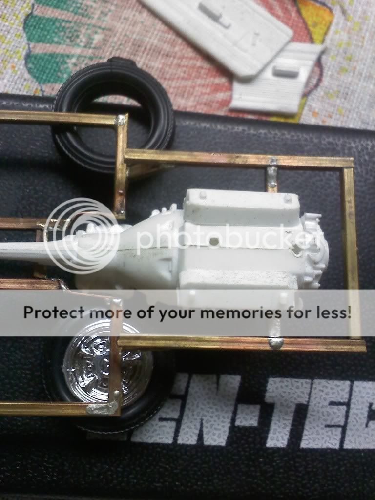

codie27 Posted September 19, 2010 Share Posted September 19, 2010 This build is great, its very informative when somebody posts pics of how they go about getting the job done. The idea of using brass is new to me and I couldnt really understand how it was used before you showed these pics. With some practice it looks like it could be easy enough. What do you use to weld the joins? I have scratchbuilt 4 truck cabs out of styrene (posted in model trucks pages) and I can really appreciate the work you have put into this build so far. Looking forward to seeing more of this one. Quote Link to comment Share on other sites More sharing options...
bobbyj Posted September 19, 2010 Author Share Posted September 19, 2010 This build is great, its very informative when somebody posts pics of how they go about getting the job done. The idea of using brass is new to me and I couldnt really understand how it was used before you showed these pics. With some practice it looks like it could be easy enough. What do you use to weld the joins? I have scratchbuilt 4 truck cabs out of styrene (posted in model trucks pages) and I can really appreciate the work you have put into this build so far. Looking forward to seeing more of this one. I use a silver solder. any solder should work. def have to solder though make sure parts are clean and use lots of flux. Quote Link to comment Share on other sites More sharing options...
Harry P. Posted September 19, 2010 Share Posted September 19, 2010 Making the same chassis out of square styrene rod would have been easier, Any particular reason why you used brass? Just a personal preference? Quote Link to comment Share on other sites More sharing options...

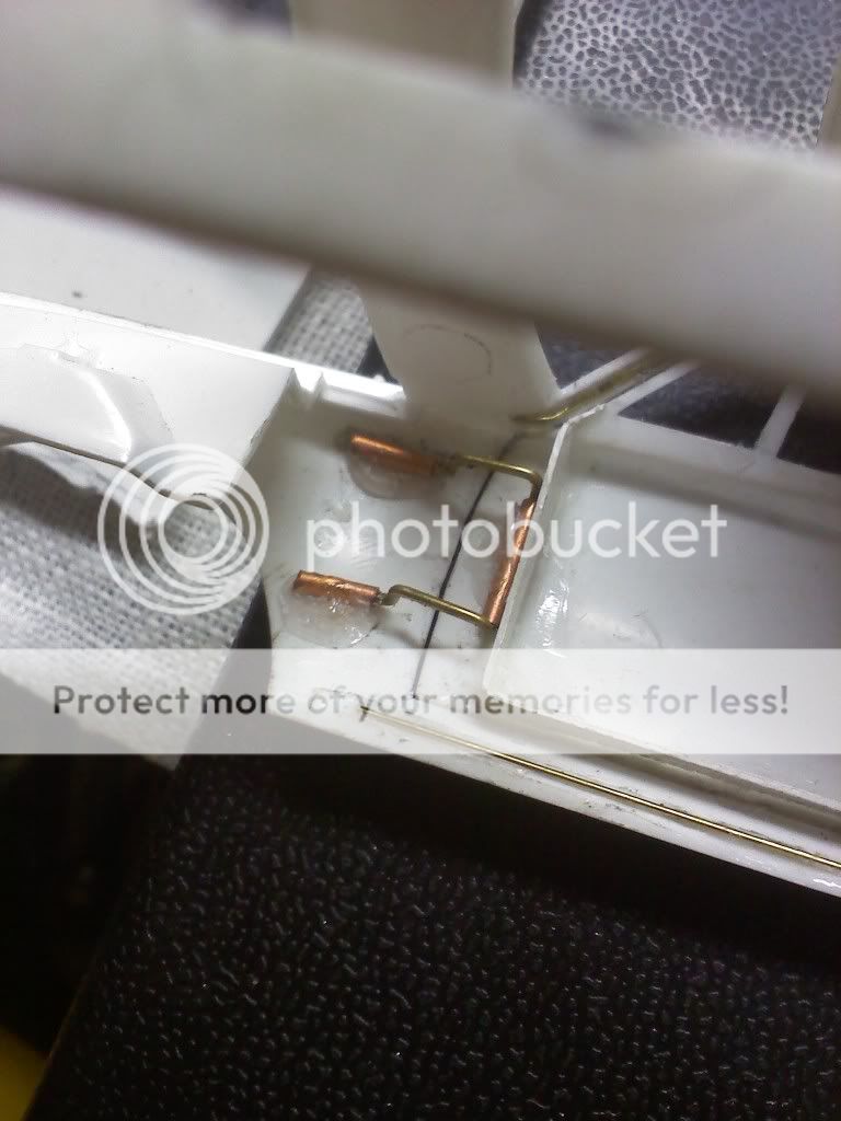

David G. Posted September 19, 2010 Share Posted September 19, 2010 (edited) Nice brass work! What kind of soldering gun do you use? Also, do you have a jig or just eyeball everything? Edited September 19, 2010 by David G. Quote Link to comment Share on other sites More sharing options...
codie27 Posted September 19, 2010 Share Posted September 19, 2010 Thanks for that Robert, I gonna have to learn how to work with brass, it would come in handy for making some truck parts etc. Quote Link to comment Share on other sites More sharing options...
Scale-Master Posted September 19, 2010 Share Posted September 19, 2010 I think using brass is a good way to go. It provides strength and a solid base to build to. Especially after opening the panels, a rigid stable brass frame can really pay off in the end. Tell me about the radiator, the pic is a little blurry but I can see through it. Not trying to start up anything, but I think the reason an issue was made about scratch-building is due to the revered level of skill it takes to scratch-build well. Throwing the term around can be interpreted as an insult to those who do actual scratch-building, and there is a definition for scratch-building, not subject to such loose interpretations in my opinion. Quote Link to comment Share on other sites More sharing options...
bobbyj Posted September 19, 2010 Author Share Posted September 19, 2010 (edited) i use brass for strength and just to be different. augie has used brass for a lot of sttuff. he once made a running 1/25 scale sb chevy!!! i use a micro torch not a soldering iron. brass is just a stronger medium and be a collision tech and metal fab. its just second nature to work with metal its more fun and easier. plus it make for a go convo piece to say something is brass. and its easier to plate when wanted. brass door hinges are the best you dont have to worry about them breaking when you put the door on and take it off a lot. the rad. core is see through its detail master rad core it is directional. ill try to get a better pic up later of it. great questions love answering them any others? Bobby JERNIGAN p.s. yes I used a dial caliper to mic the frame and drew it out with suttle changes i wanted to make i.e. slight tub raised the front frame area up some to make it easier to lower. i then made a jig with those measurments on a piece of 1x6 and used finishing nails to hold it while i did my soldering. ill get some pics up of that too. Edited September 19, 2010 by bobbyj Quote Link to comment Share on other sites More sharing options...
