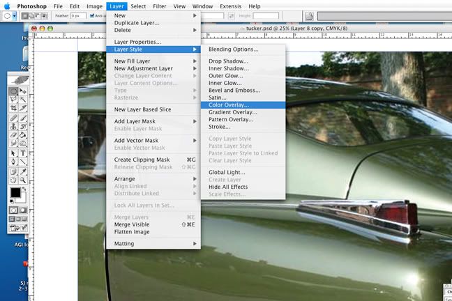

Harry P. Posted September 18, 2010 Posted September 18, 2010 Now that I've created my door line, I want to create the highlight that runs along the edge of the door. To do that, I'll take my door line layer that I just created and duplicate that layer... giving me an exact copy. Now with my duplicated door seam layer being the active layer, I'll go to the dropdown menu and select Layer>Layer Style>Color Overlay: Now that I have selected the color overlay option, I can "overlay" any new color onto my dark green door line copy. I'll change the color to light green, then move my light green door line (on its own layer) slightly to the left of my original dark green door line (also on its own separate layer) to get my door edge highlight. I used the eraser to slightly fade the highlight towards the bottom: Now I want to add a white highlight at the point where the door curves. I'll draw an ellipse (again, on a new, separate layer) to define the shape I want, and hit it with the brush, using white: Then, just like for the door seam, I'll move the selected elliptical area slightly to the right, leaving my white shape in place: and hit "Delete" to remove the unwanted white: Again, like the white fender highlight created earlier, this highlight isn't exactly the right shape, so once again I'll use the "distort" function to reshape the highlight until it matches the shape of the door seam: More to come...

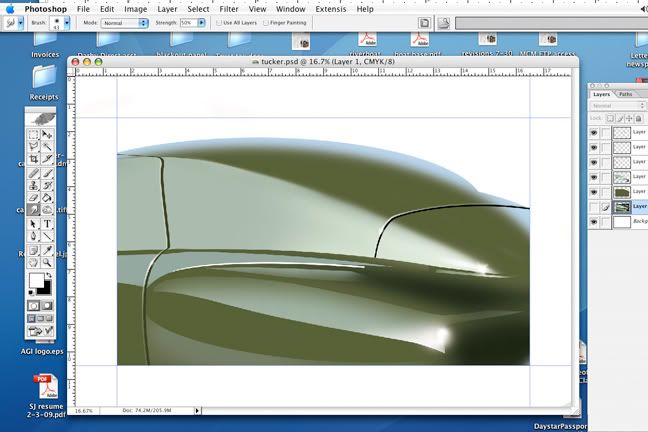

Harry P. Posted September 18, 2010 Author Posted September 18, 2010 The trunk seam was created exactly the same way as the door seam line. I added small white spectral highlights with the brush tool to both the door and trunk seams. In this shot only the layers I've created are "on"... the photo reference layer is "off" and isn't visible, but you can see the separate white backround layer, also "on," under my illustration layers (see the layers palette on the right):

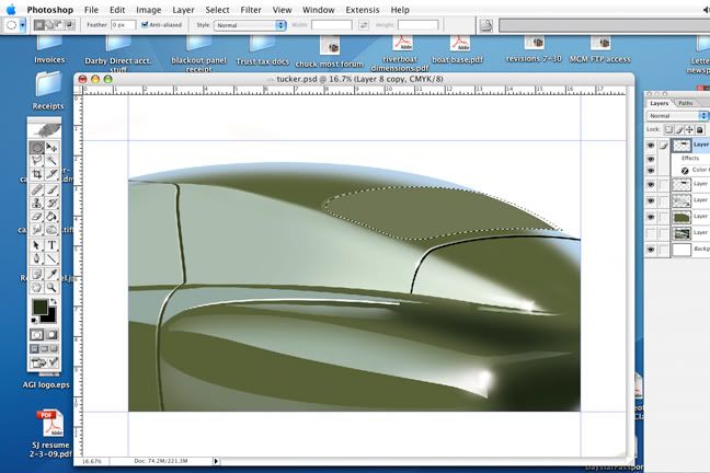

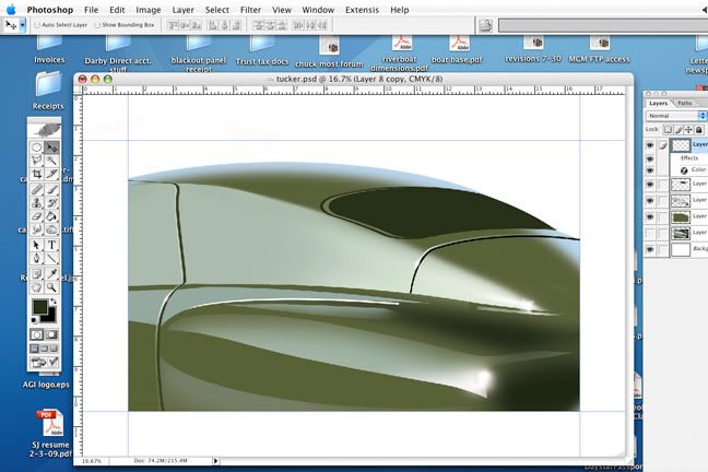

Harry P. Posted September 18, 2010 Author Posted September 18, 2010 Now let's do the rear window. This is a little tricky, so follow along closely. First I created the basic shape using the techniques already described, and dumped black into the shape (remember, each new shape I create is always on a separate layer): Now I duplicated my window layer, to give me an exact copy on a new layer, and use the color overlay function to change the color from black to green. The new green window shape is on a new, separate layer above the original black window shape, which is also on its own separate layer: Now I selected the green window shape with the "Magic Wand" tool (circled in red). This tool selects an area of solid color, in this case the green window shape: Then, as you've seen in previous steps, I move the "active" selected area slightly to the right, while leaving the green shape in place: And hit "Delete" to remove the unwanted color area, leaving me with this "window surround" detail: Which I then scaled down slightly to fit within the black window area: More to come...
