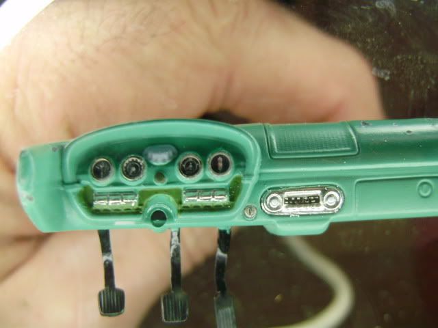

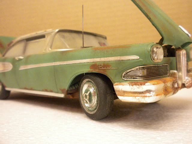

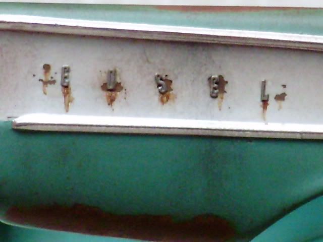

I personally think their worth the money, (that is if you don't have to bid through the roof for them). I did these on an Edsel build and thought they enhanced the model quite well. I also had good results by using Model Master Flat Clear Acrylic. The parts stayed in place and dried with no signs of adhesive.....in the pic of the dash board I used rings around the gauges and the ignition...
