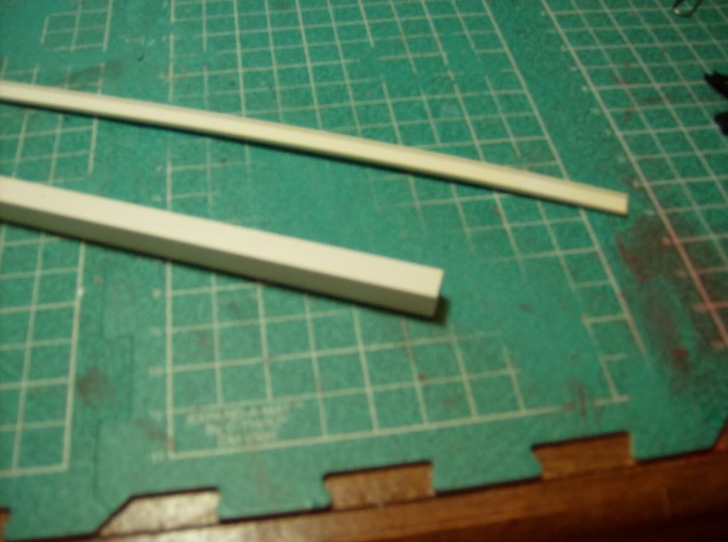

I also have some other WIP pics not in that thread, since I started the build on another forum before posting it here too. I'll have to check that other thread to see if I mentioned what I used, but I know I cut the square tube in this pic in half to make the main frame stretch pieces.

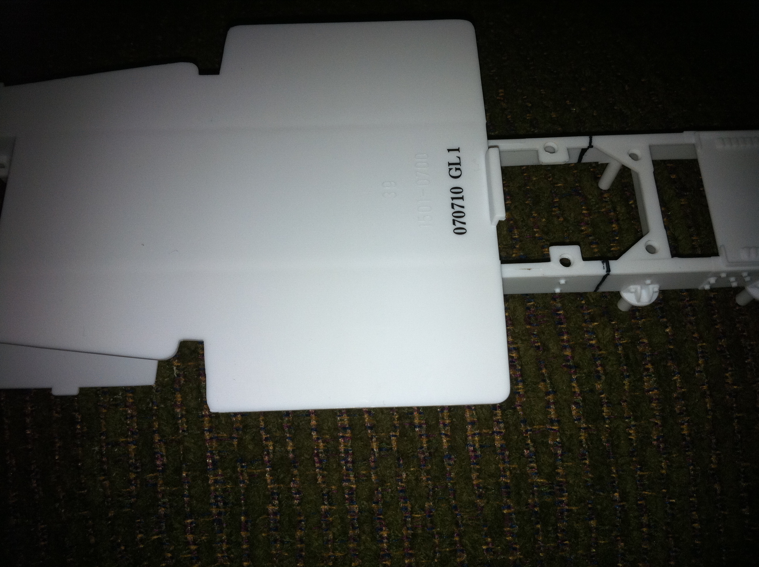

Ok here is the plan. I’m going to cut the frame where the black line is. I’m going to use this styrene I picked up at hobbytown usa and cut 3 1/2 in strips. The styrene is thick so it should support plus I’m going to box the frame anyways. I added a windshield visor

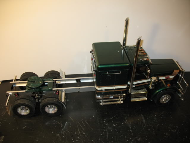

I streched the frame on the Monogram Ford F350 to make a rollback towtruck. If your going out to by strip styrene get the C channel, It is stronger by nature. I also added a X member using a sprue from the kit. Once its sanded it looked factory. The Jardin website has all kinds of good info. I got the wheelbase info from them and strched it to one of their models.
