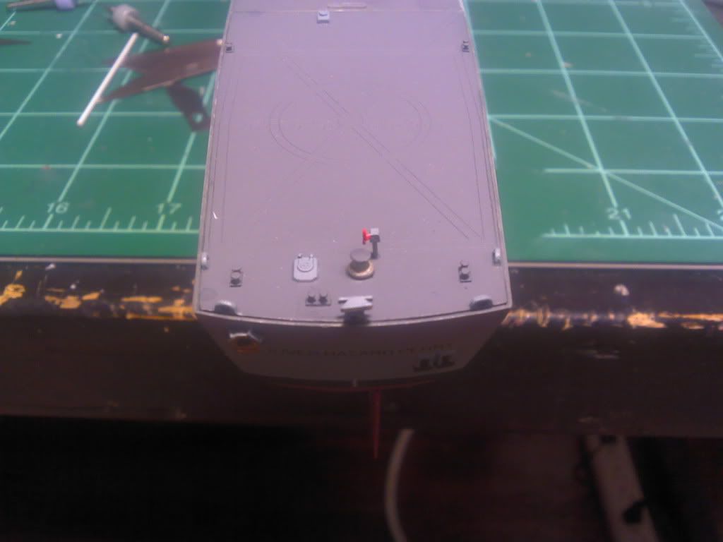

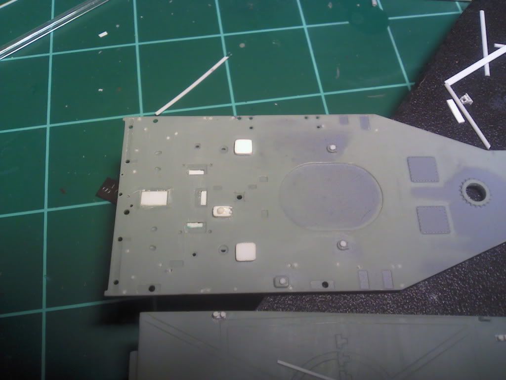

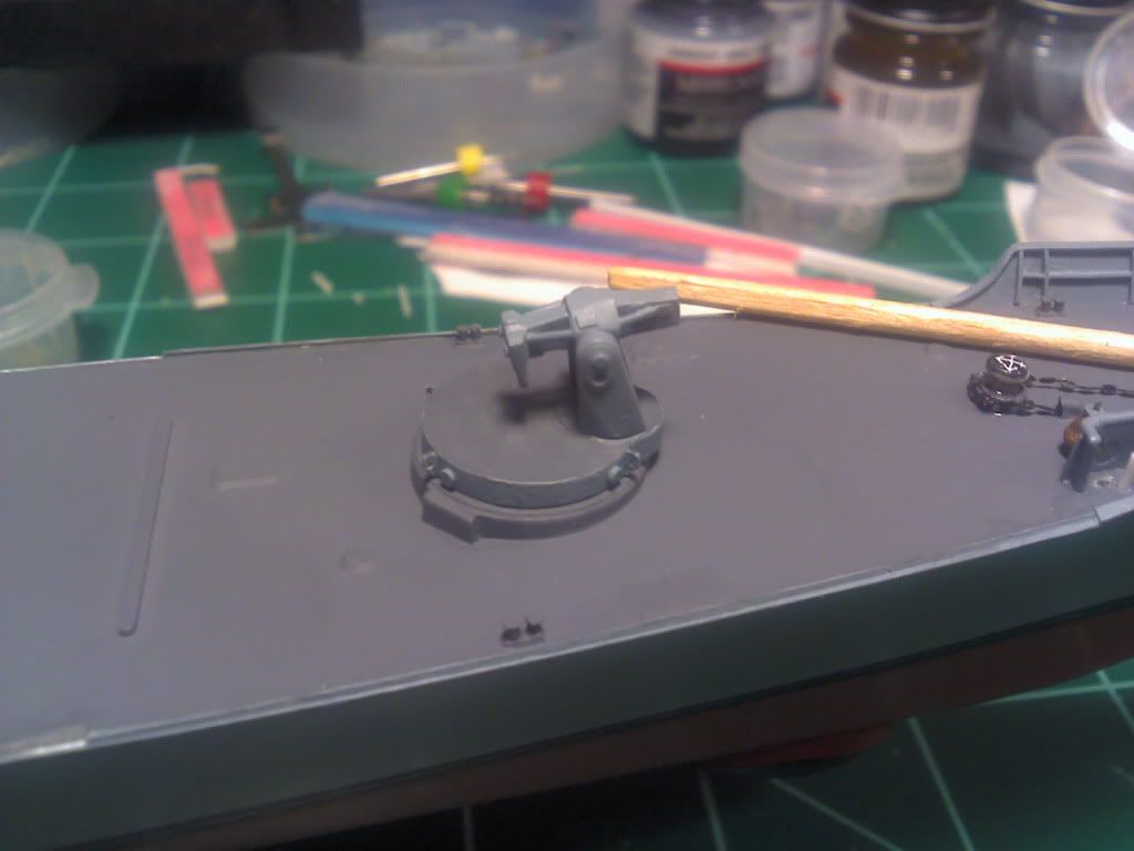

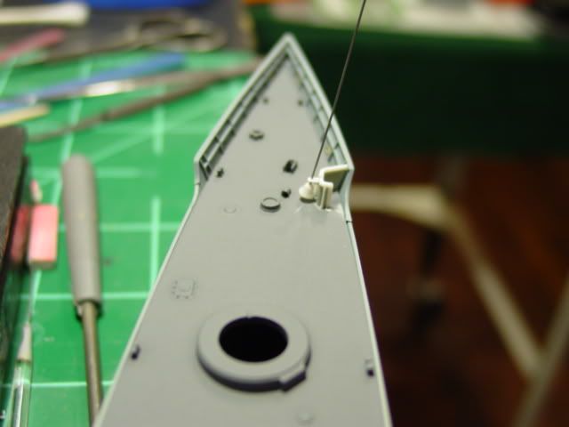

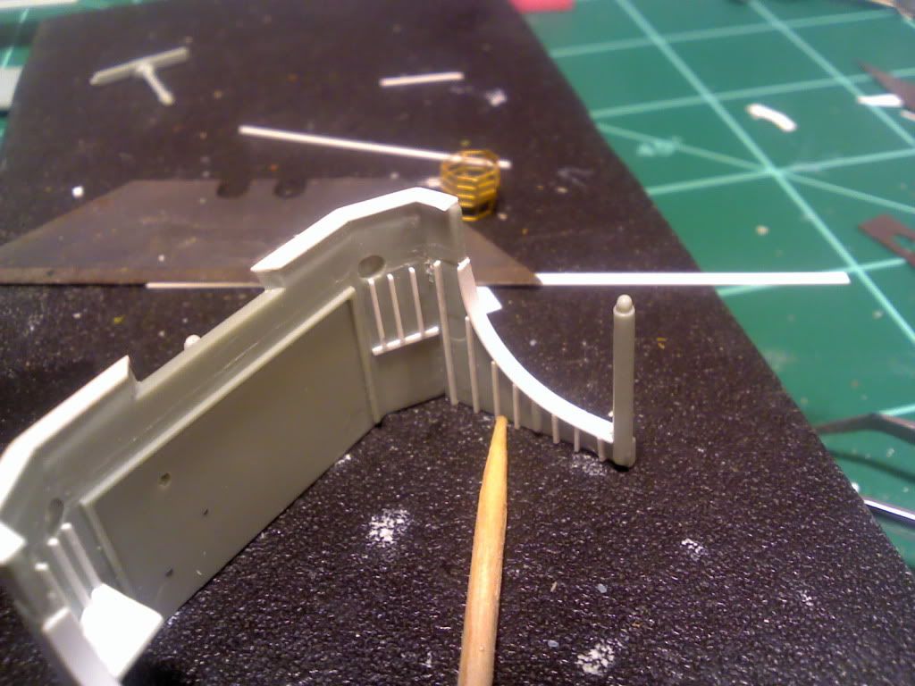

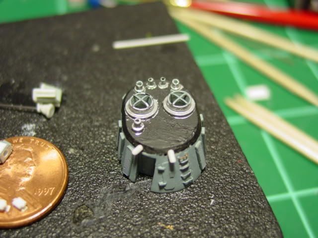

Hi again, sorry for such a long delay but I have been busy moving and dealing with life in general. I have had some time to work on this and have a few extra pics to show, as always Thanks for looking and feel free to critique.
This shows some small parts like ammo lockers and deck lights plus an early version of my ships bell, a bit big there :(
http://DSC02013.jpg
This shows that modified bulkhead in place with the bell
This is the flight deck with scratch made bollards and hatches plus the 02 lvl in the background. I've striped all detail off the 02 lvl as it looked pretty bad IMO.
My modified stacks with scratch steps and lights plus a new rear door.
