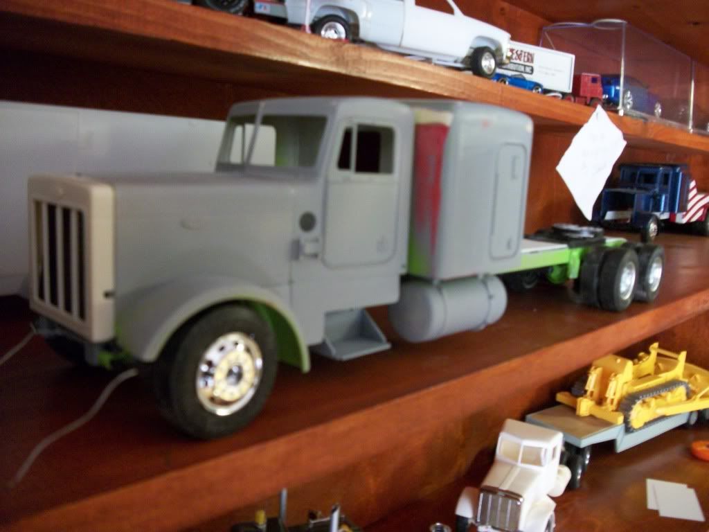

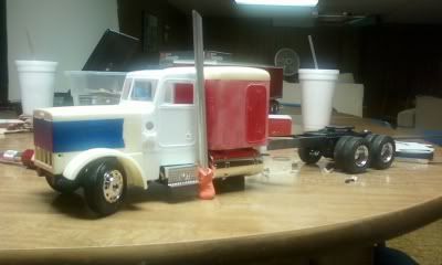

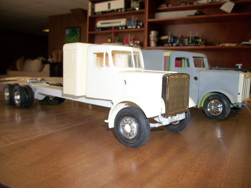

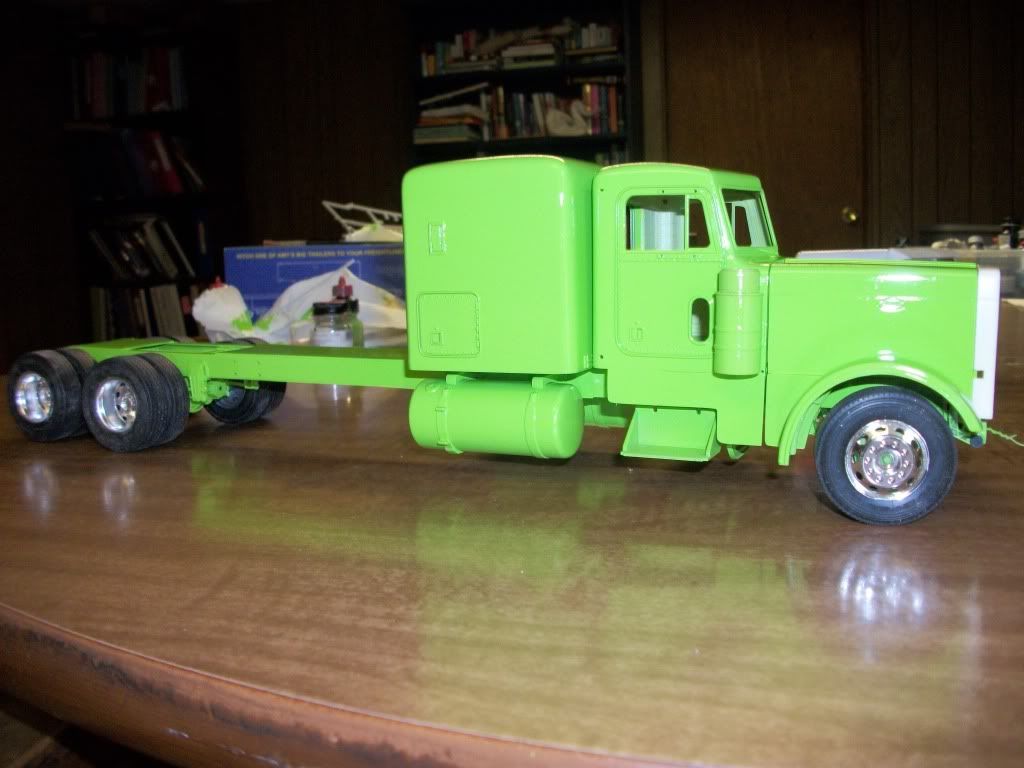

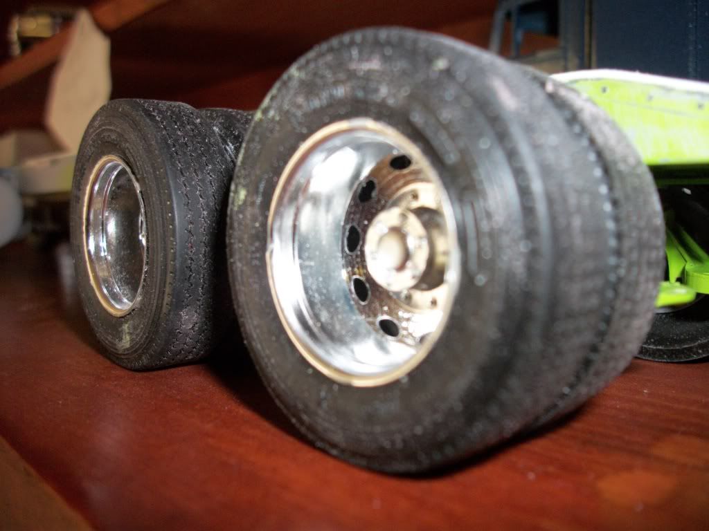

Here's my latest project. started with a Italeri 378, added a P&P hood and sleeper top, stretched the frame 3 1/2inches, lowered the suspension 3/16", lowered the cab,hood, and sleeper 1/8", installed full deck, recessed the hub centers on the rear wheels 1/8". Going to order some P&P RF4 fenders for the rear, texas front bumper, and some bullet headlights this week. Planning to paint the frame and body Sub-lime green. Photo0051_001.jpgPhoto0050_001.jpg100_0696.jpg

That is looking pretty sweeeeeeet !!! I like seeing pics of our parts being used. I noticed you siad you wated to get some of our RF4 fenders for it but they are 1/25 scale and I don't think they will fit, all the rest of the rear fenders I am casting now are 1/24 scale and should work fine.
sorry Eric, I was looking at the wrong list( I'm building a 1/25 RG pete at the same time). I will be using the RF2 fenders on this one, probably send you an order tomorrow. Thanks for making your products, they are super nice and super easy to use
If anyone out there knows where I can get a 1/24 scale 3406 or big cummins so I can ditch this detroit that came in the kit I would love to get one for this truck. the oilpan on the detroit is hitting the front axle and wont sit down in the frame at all. Any suggestions?
have you tried lifting the motor up enouph to have clearance? also im not positive but i think if you used a 1/25 front fender it will problly take away the "flat spot" look and be more rounded to the tire. good luck i cant wait to see this one finished :D:blink:

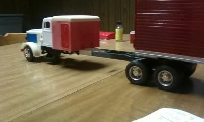

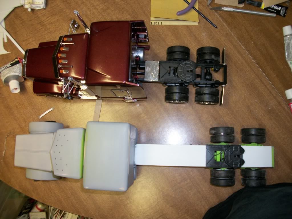

okay so after getting the bright idea of modifying the detroit with a different oilpan and twin turbo to make it unique( may it rest in pieces) I am game for a new engine. So i decided to start a side project out of my parts box last night.....100_0702.jpg100_0701.jpg

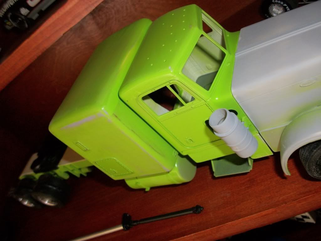

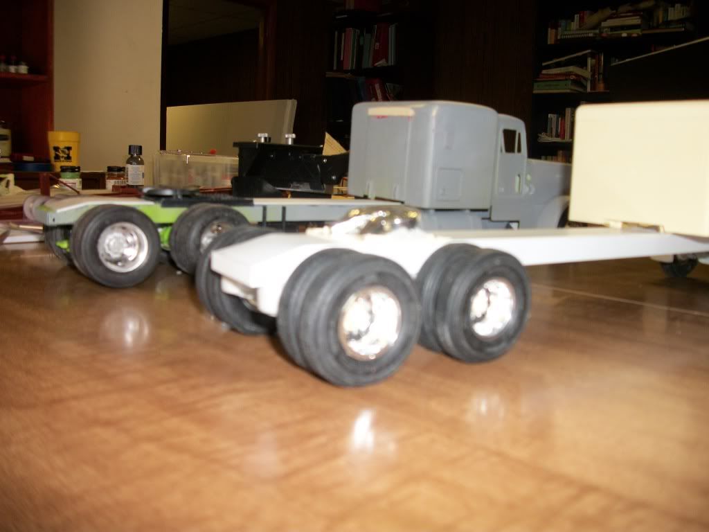

Okay I shot a quick coat of paint on the truck to see how it is going to look then sanded more because I found a few spots I wasnt completely happy with but here are some quick pictures100_0720.jpg100_0721.jpg

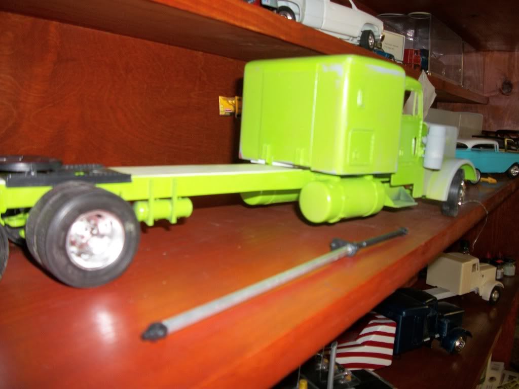

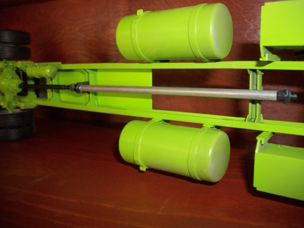

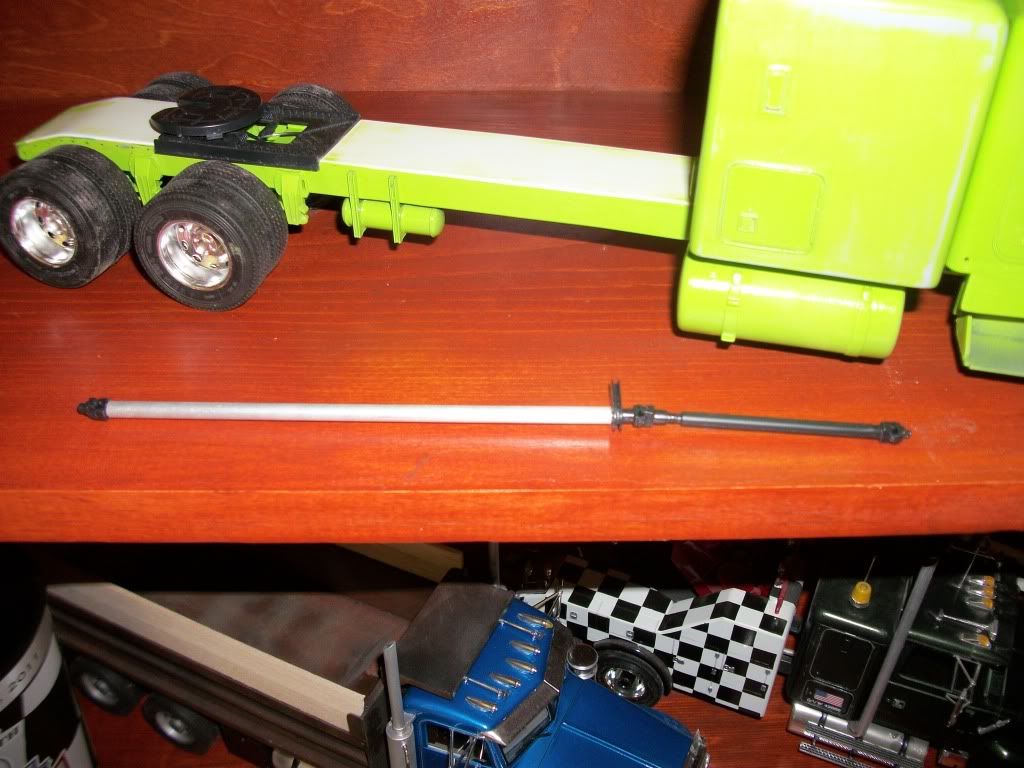

I also lenghtened my driveshaft using some scrape aluminum tubing I had laying around100_0722.jpg100_0723.jpg

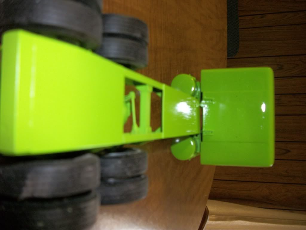

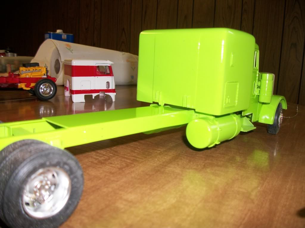

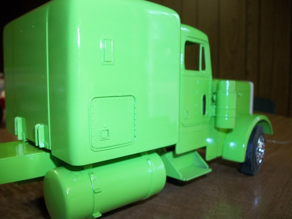

Okay here it is, finaly painted. I used Model Master Sublime Green and Boyds clear on it. I did 3 coats of the green and let it dry for a hour in the sun then came back with 3 coats of the clear over the whole truck. the pictures arent really doing it any justice but it looks great.Hope you all like it100_0727.jpg100_0725.jpg100_0729.jpg100_0728.jpg
Lookin' good.
Going to put a trailer on it?
Thank! Yeah planning a 53 ft super hopper that i'm going to scratch build after i finish the truck so I can get the stance right
gonna look great once ya get the stacs and lights etc etc all on it. i like it !! :P:(:P
[/quote
Now talk about a green Thom(SP) that stand out in a crowd.Looks good.
