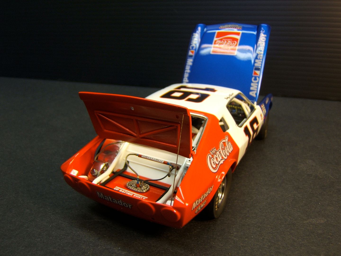

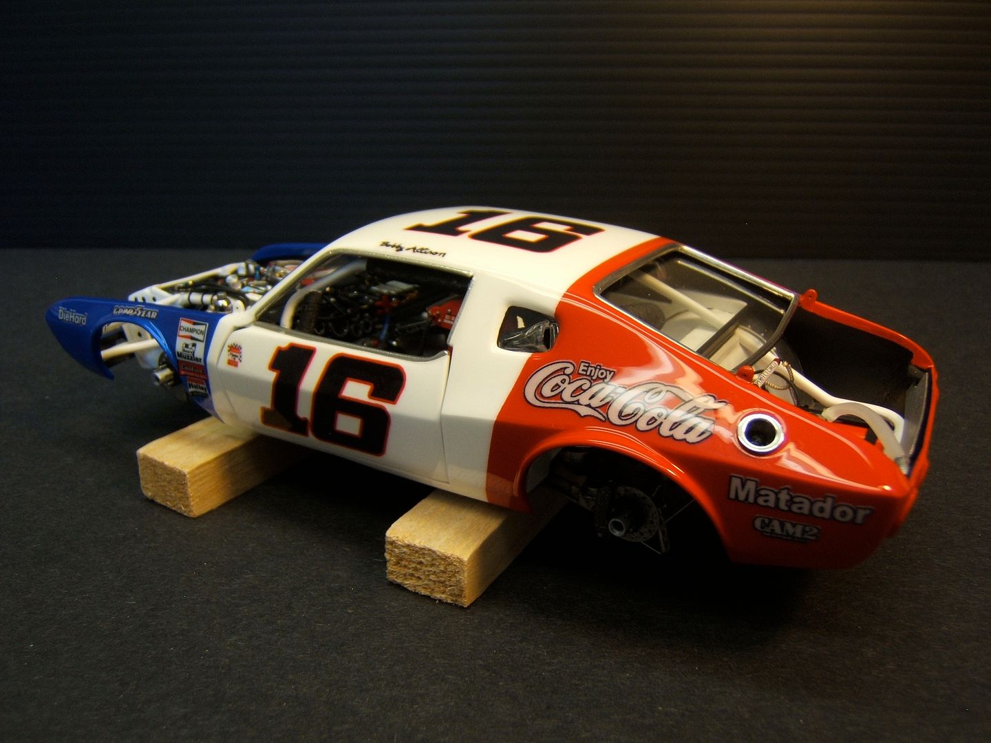

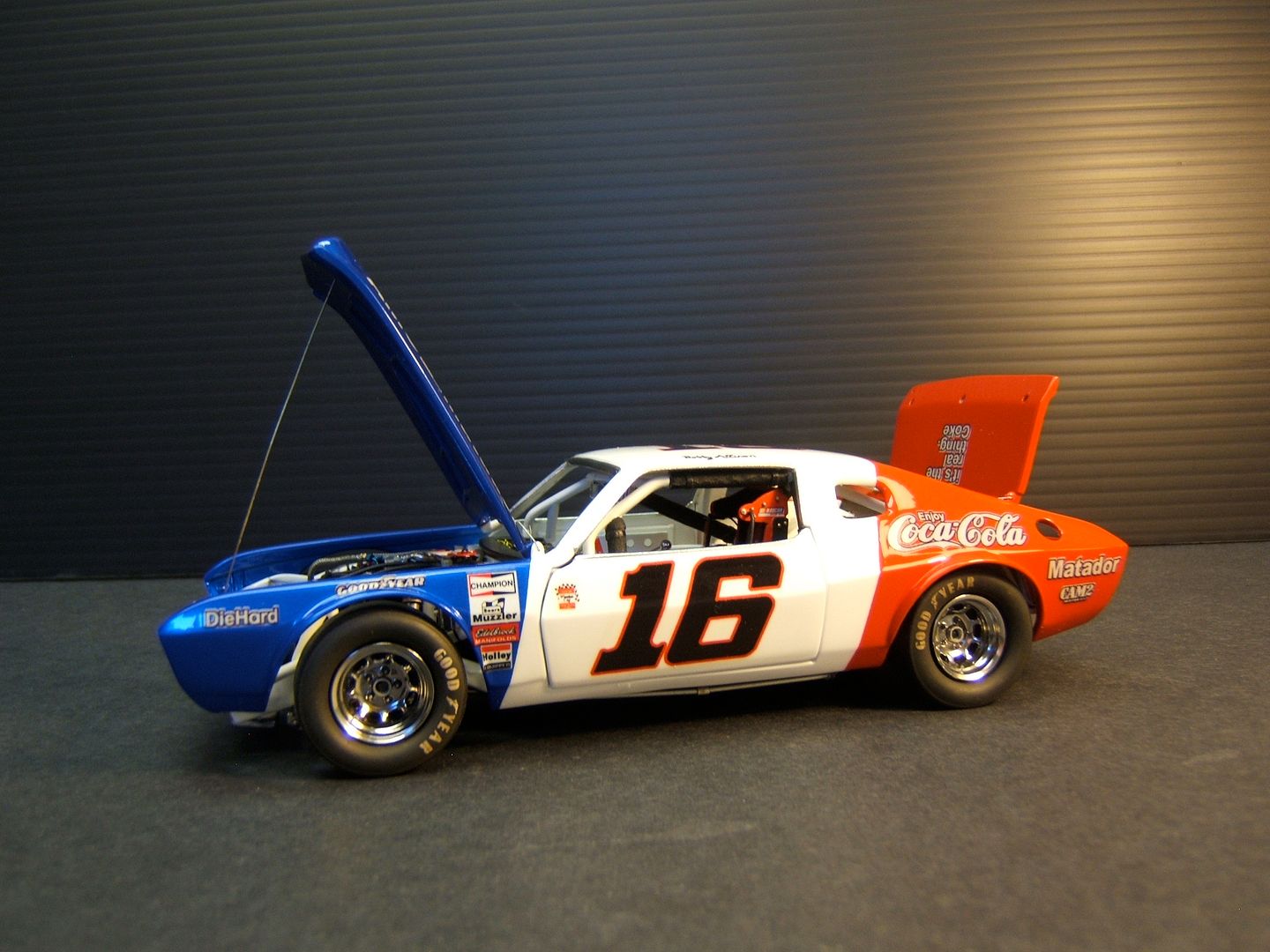

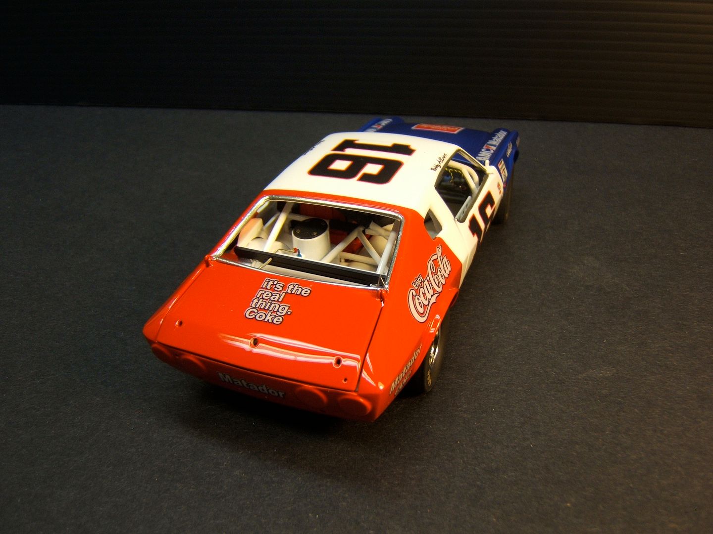

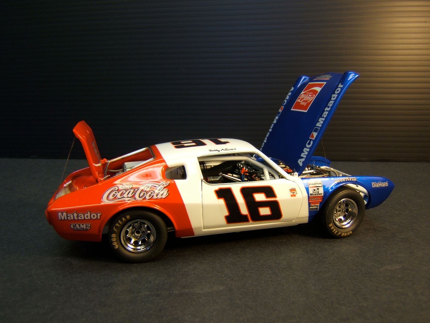

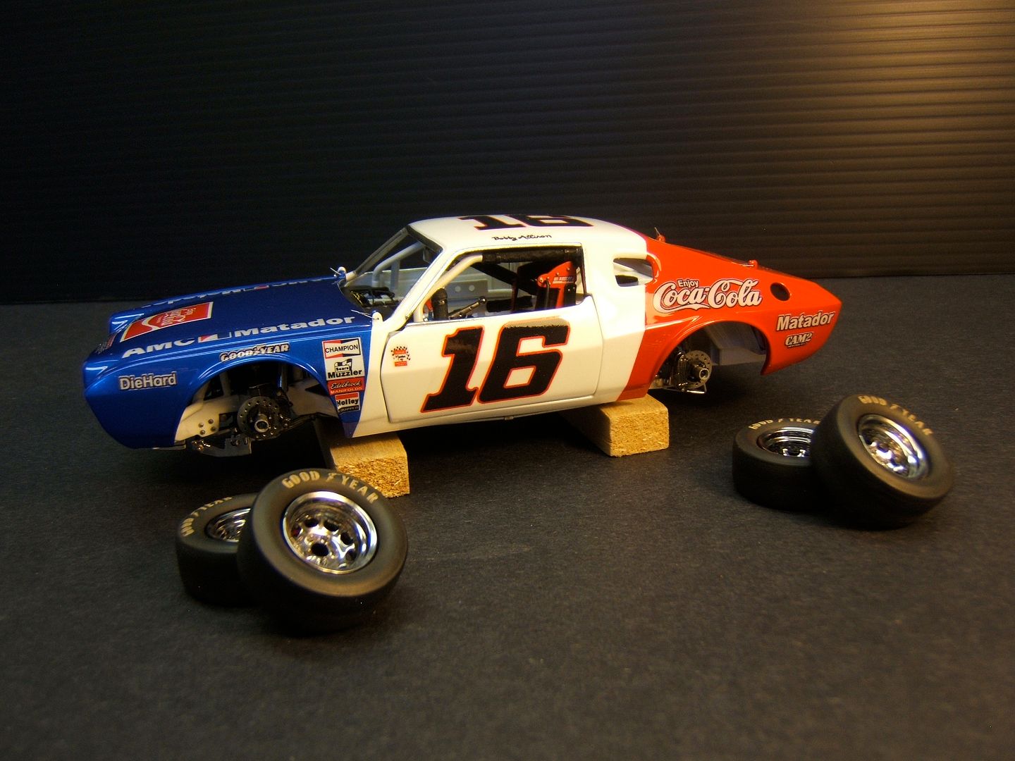

John Teresi Posted June 27, 2011 Author Share Posted June 27, 2011 Hello.......here are a few photos of what the build is going to look like.......I wiil wet sand and put the last coat of clear on today........I like to clear over my decals what ever the build is because,......after time the decals will get old and flake off ......the clear will keep them from getting old ........maybe for ever?.......I have went back to some of my paint job`s from 3 years ago and no yellowing or cracking.......I stiil need to put in the glass,bumpers,spoilers and a few details......should be done by the end of the week......thank`s for looking. Quote Link to comment Share on other sites More sharing options...
Lanny Haas Posted June 27, 2011 Share Posted June 27, 2011 Great model. And I like the "build what I want" kind of deal. And I do concider you a model builder. All Drama aside. it turned out great. My only question is when do you sleep? I know how time comsuming a build like this is.....Looking forward to seeing you next April for the Cactus Contest. Quote Link to comment Share on other sites More sharing options...
GTMust Posted June 27, 2011 Share Posted June 27, 2011 Super sweet! Another great build you have every right to be very proud of. All your builds are a great inspiration to me....... Tony Quote Link to comment Share on other sites More sharing options...
LAone Posted June 27, 2011 Share Posted June 27, 2011 wow john, awesome work bro. ill be honest with you, up until i joined this forum. i never heard of you and even after all this bickering, i gotta say. im glad i joined and getting to see this type of builds. Quote Link to comment Share on other sites More sharing options...
bigmikevee Posted June 27, 2011 Share Posted June 27, 2011 Hey John, Thanks to you and Art for providing details on urethane and link for decals. Man, is this looking sweet, I swear it looks like you could get it and drive it. You work just knocks me out, and I sure thank you for posting...for all of us. Mike Quote Link to comment Share on other sites More sharing options...
Tony T Posted June 27, 2011 Share Posted June 27, 2011 Looks good, John. The paint and decals look good, very clean build all around. NASCAR Resto-Mod? I like it! Quote Link to comment Share on other sites More sharing options...

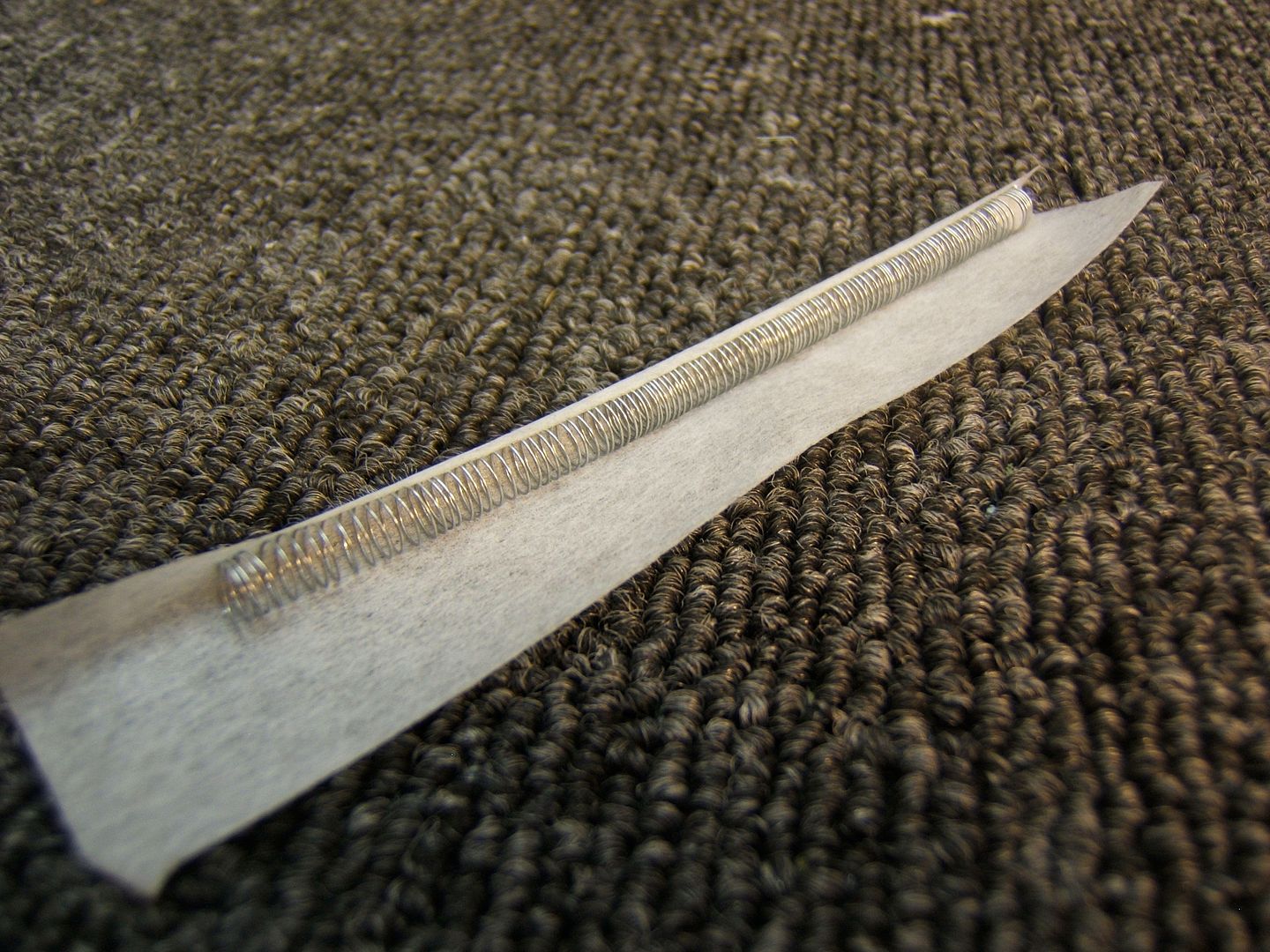

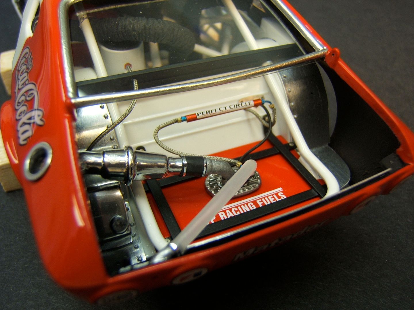

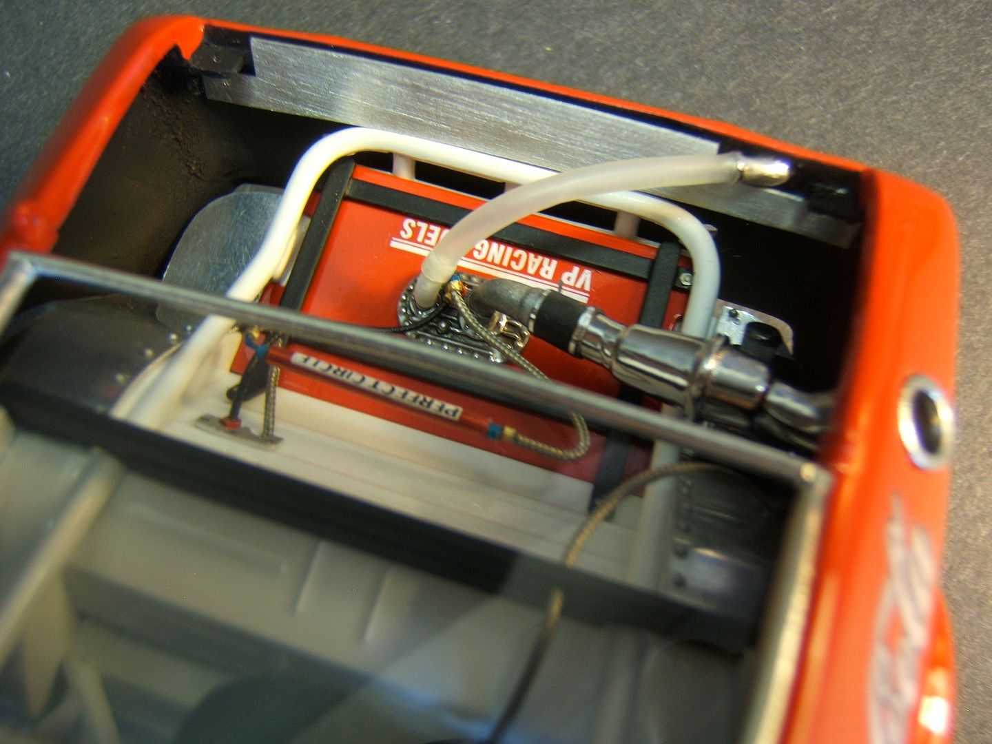

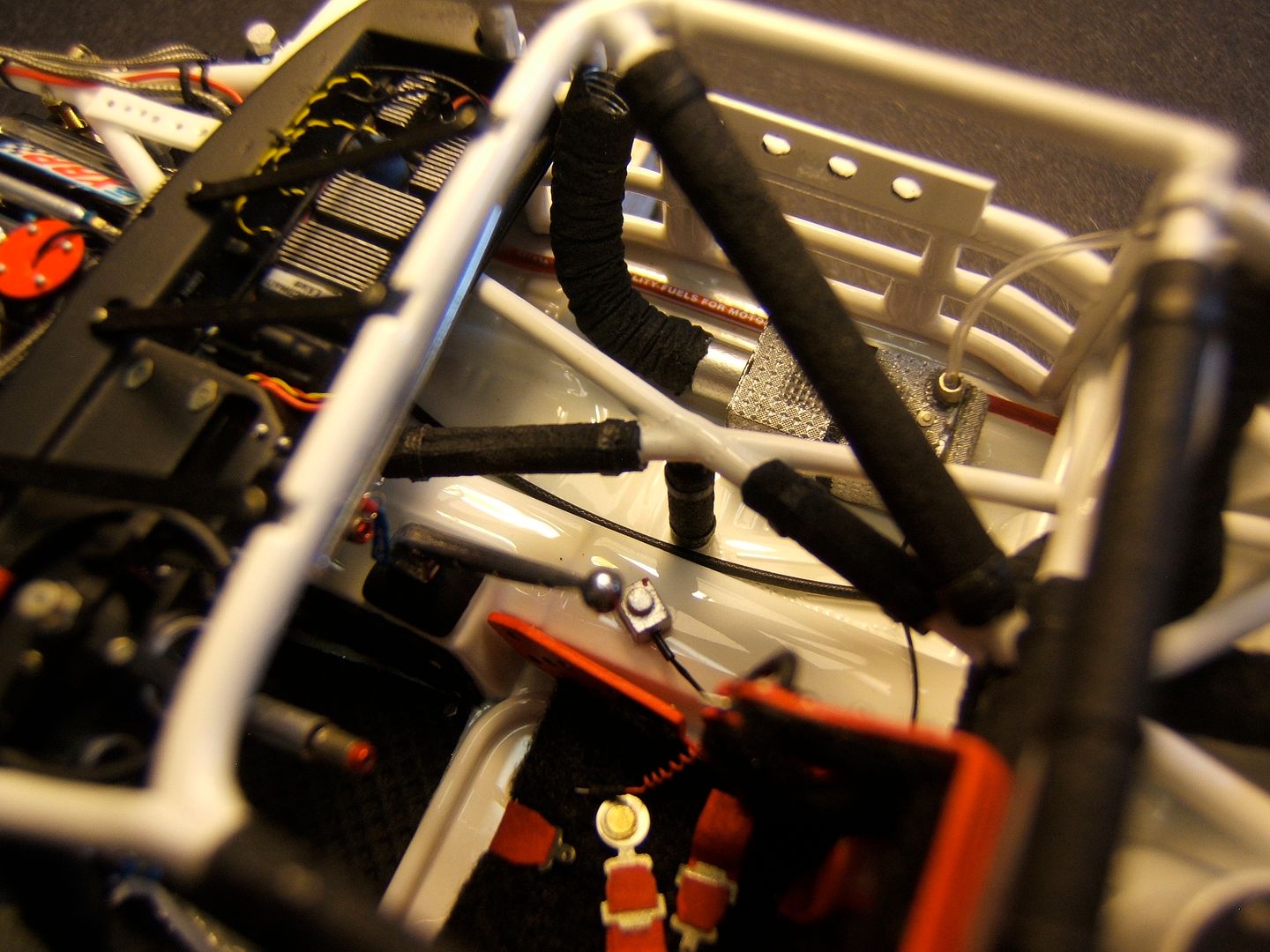

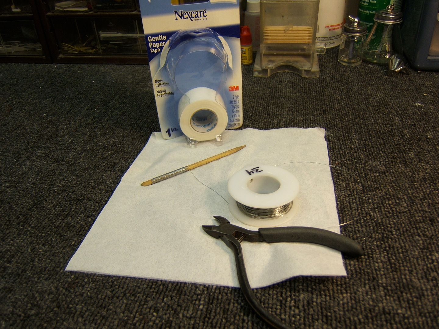

John Teresi Posted June 28, 2011 Author Share Posted June 28, 2011 Hello......I made some air hoses today......I wrapped some wire around a wooden art stick.......and wrapped some medical bandage tape around the wire......then painted it with Acrylic black paint......I will work on the body tomorrow.......thank`s for looking. Quote Link to comment Share on other sites More sharing options...
made007 Posted June 28, 2011 Share Posted June 28, 2011 that duct idea is great just look like the 1:1 i have one conected to the intake Quote Link to comment Share on other sites More sharing options...

John Teresi Posted June 28, 2011 Author Share Posted June 28, 2011 that duct idea is great just look like the 1:1 i have one conected to the intake Jose......thank`s for the tip......I just made a intake hose and connected it.......thank`s. Quote Link to comment Share on other sites More sharing options...

Lanny Haas Posted June 28, 2011 Share Posted June 28, 2011 Notice the air brush holder. how simple is that? Quote Link to comment Share on other sites More sharing options...
Ron a.k.a. Grouchy Pants Posted June 28, 2011 Share Posted June 28, 2011 Genious idea, I never would of thought of doing that in such a way. And it was like such a great suprise lol I thought you were pretty much done except for a couple things mentioned. And then you go and get all creative and teach me a thing or two :lol: Quote Link to comment Share on other sites More sharing options...

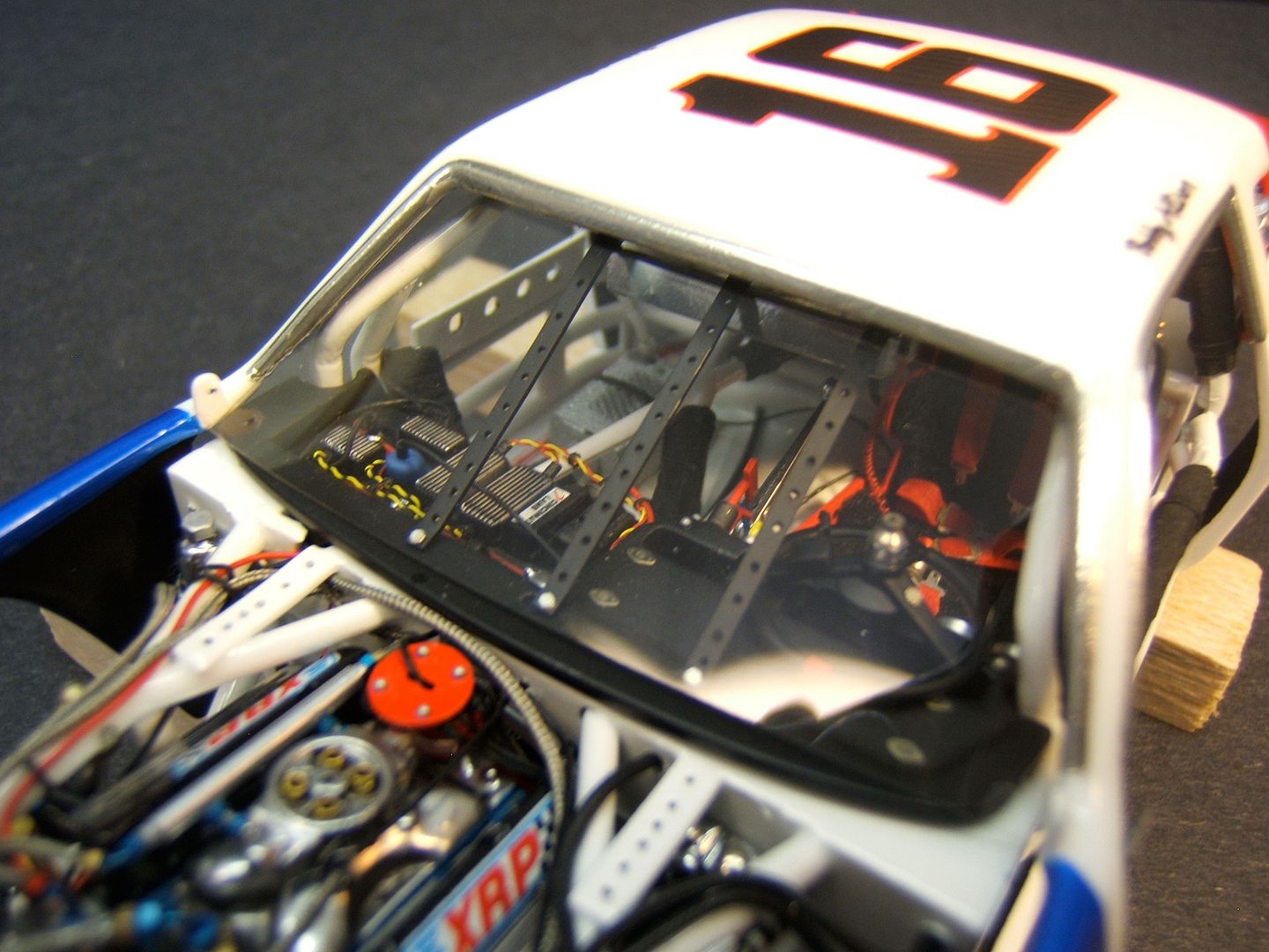

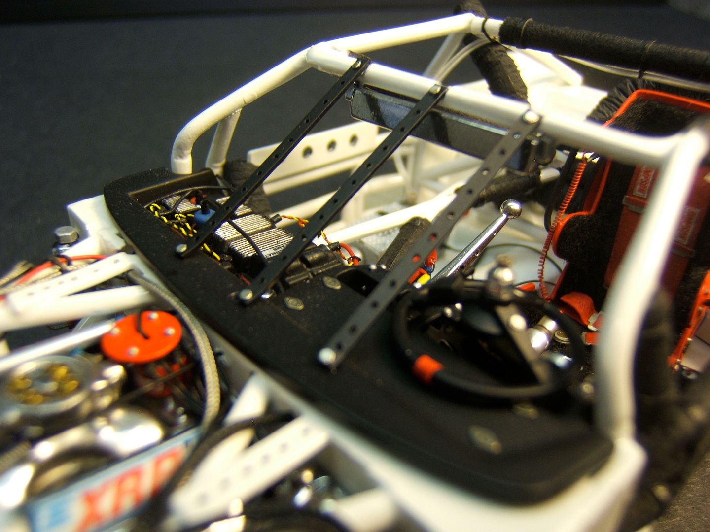

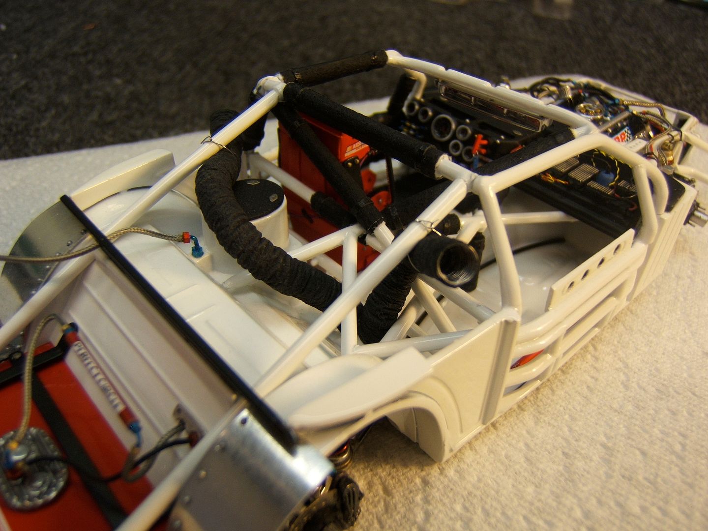

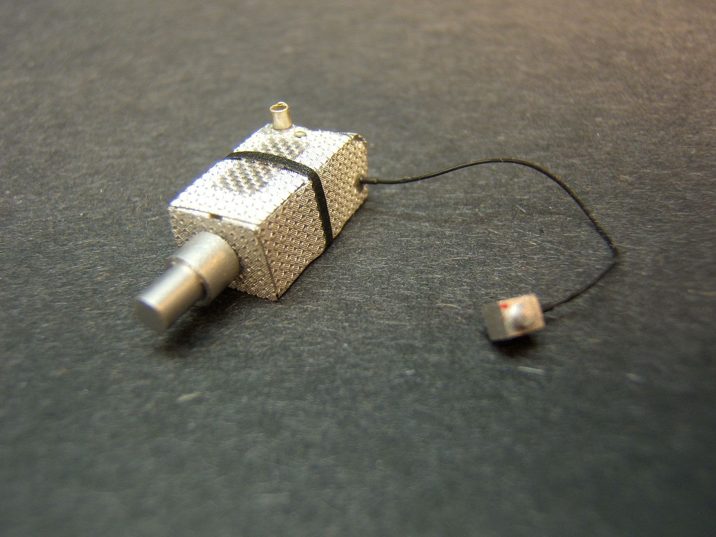

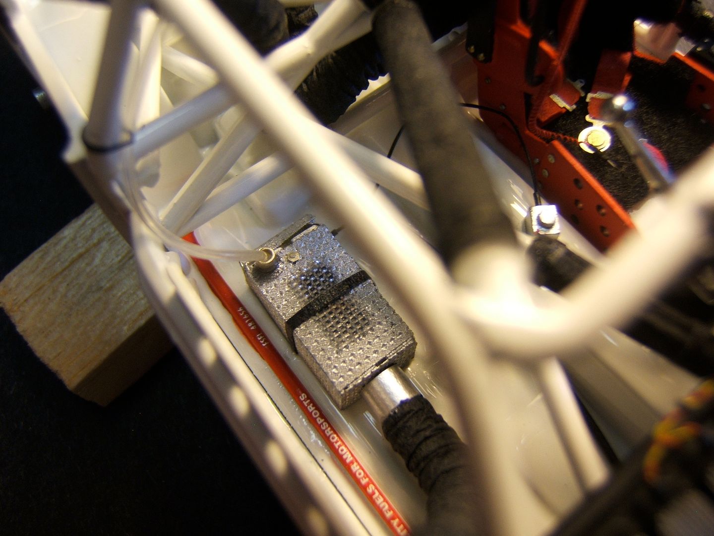

John Teresi Posted June 28, 2011 Author Share Posted June 28, 2011 Hello......I made a kool-box and installed........steering wheel installed......made some window braces and installed.......I worked on the fuel cell ......got the glass installed and the body is on......I will put on the bumpers and spoilers tomorrow........getting close......couple more days......thank`s for looking. Quote Link to comment Share on other sites More sharing options...
