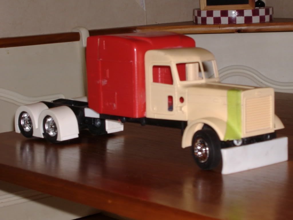

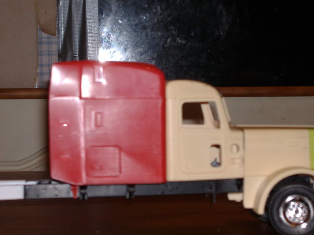

scale trucker Posted October 20, 2011 Posted October 20, 2011 mark if you need some pics i have a new 388 at work that i can take pics of..

scale trucker Posted October 20, 2011 Posted October 20, 2011 (edited) hope this helps.. Edited October 20, 2011 by scale trucker
