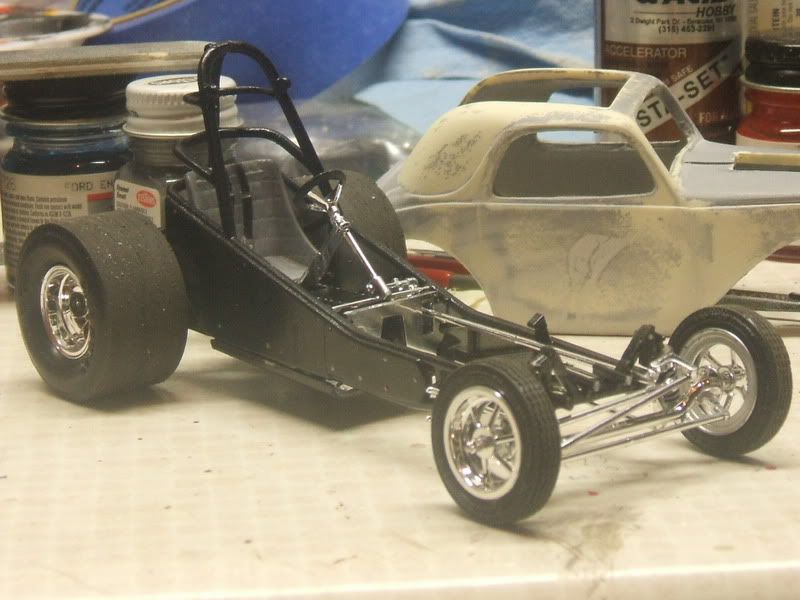

The body is a Jimmy Flintstone fiat and the Winged Express Altered kit. With this build I get to do 2 things I've been wanting to do for a long time. First is build a Fiat Topolino bodied drag car, second is I'm finally giving resin a try. When I was cutting out the windows and roof I learned resin is softer than plastic luckily it wasn't a real bad opps and I was able to fix it easily. Next I assembled the chassis and taped the suspension in place so I could fit the body to the chassis and cut the hole in the hood for the blower.
I wanted the drag slicks to look like they've done a burnout or 2, so I used 220 sandpaper to take the sheen off the tires and then 80 grit to rough them up and I finished them up by turning them on 40 grit.
After I got the suspesion permanately in place I found I needed to remove more material from around the wheel wells, to clear the roll bar, and the blower belt.
This picture gives a good idea of how things are going to look when the build is done. The slicks were mounted in the direction they were turned on the 40 grit sandpaper. For right now the engine is just set together in place and that will be my next project on this build.
