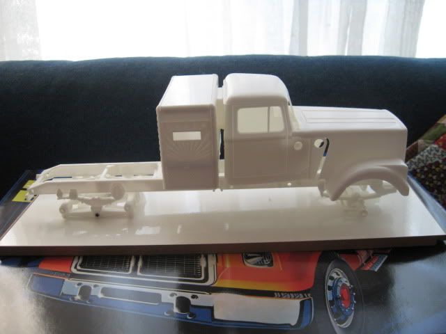

Badluck 13 Posted November 2, 2011 Posted November 2, 2011 Ikea has some hardwood floor samples that i like to use to build cars and trucks off of. there are some small pieces that are perfect for cars and small trucks and then some longer pieces, like under this White Road Boss that are perfect for big trucks. .......Man when are you gonna start back on that thing??????
