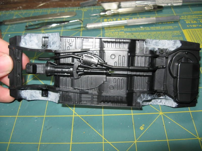

Roadkill2525 Posted November 16, 2011 Posted November 16, 2011 (edited) If you're refering to the undercoating you can use Tamiya Surface Primer or Gunze Sangyo Mr Surfacer and dab it on. Used Tamiya Surface Primer on the wheel wells of my Trueno. Edited November 16, 2011 by Roadkill2525

GrandpaMcGurk Posted November 18, 2011 Posted November 18, 2011 Krylon has textured paint in spray cans, some is fine enough to look like scale sprayed on undercoating. I've even used it for vinyl tops. Color doesn't matter as it can be top coated with any color you want. Just be careful not to get the course stuff as it has too much texture to look right. Best part is that it comes in large cans for just a few bucks.
