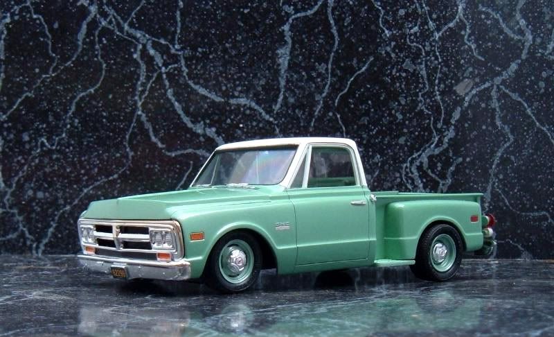

Guest Posted December 29, 2011 Posted December 29, 2011 (edited) That little fleetside Chevy is looking wicked Tyrone! The valve covers on the GMC are a big improvement. I need to put better valve covers on my GMC. I would think the master cylinder from a '69 or '70 1/2 Camarp would work. One suggestion I'll make for both trucks is to cut the tabs off of the interior on the front where they go through the firewall and fill in those holes. It makes the firewall look a lot better. Edited February 16, 2012 by plowboy
tyrone Posted December 29, 2011 Author Posted December 29, 2011 (edited) That's looks good Roger, I like that color, I'm thinking about green and white two tone, or gold and white on the fleetside, I have some paint left over from my nova, and impala.. any more pics of yours?? Edited December 29, 2011 by tyrone

Guest Posted December 29, 2011 Posted December 29, 2011 (edited) any more pics of yours?? Edited February 16, 2012 by plowboy

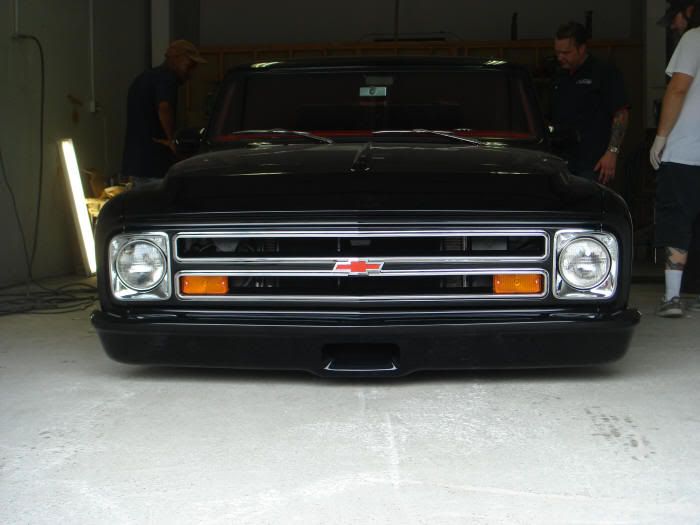

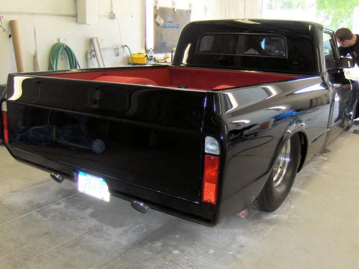

bandit1 Posted December 29, 2011 Posted December 29, 2011 I went the other way with mine and widened the rear fenders a bit. I think the kit fenders are a bit on the narrow side of "stock" [same with the AMT '53 Ford pickup] Those are the BIG 19 inch Pegasus Michlin Pilots stuffed under those back fenders with no tubs. BTW, the inner fenders on those kits is way wrong. They're right for a '60 to '66 pickup but they went with a more conventional rounded inner fender from '67 up. [i should have changed this on mine but,,] like these http://www.lmctruck.com/icatalog/cb/full.aspx?Page=92
Nate Posted December 30, 2011 Posted December 30, 2011 here's the stepside,,, Echoing what Steve said about the rear fenders, take a look at this photo. You'll see that the rear fender is not flush with the sides of the cab. The fenders might benefit from a little widening. I plan on doing this with my 69-72 Stepside, if I ever get around to it. BTW thanks for posting up your 69 again, Steve. I love that thing!

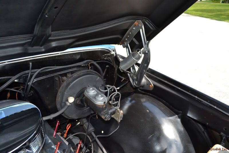

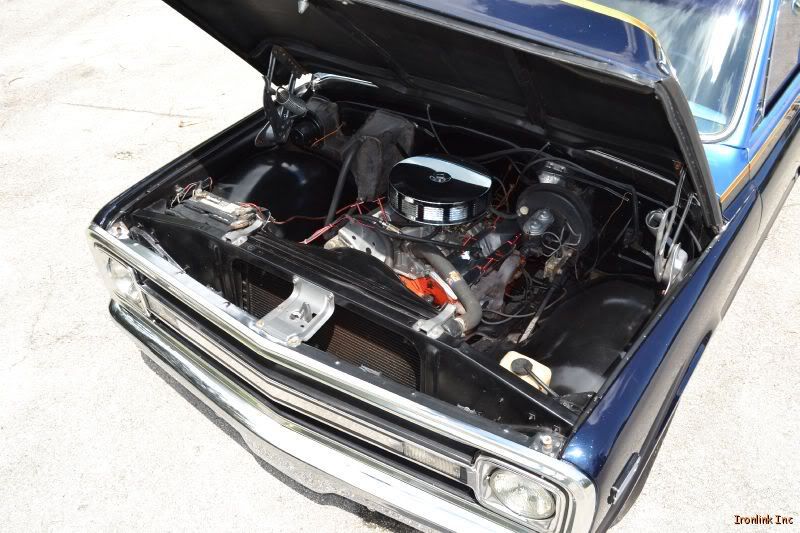

Nate Posted December 30, 2011 Posted December 30, 2011 Here are some photos of the inner fenders snagged off of E-bay, which is a great place for reference photos.
