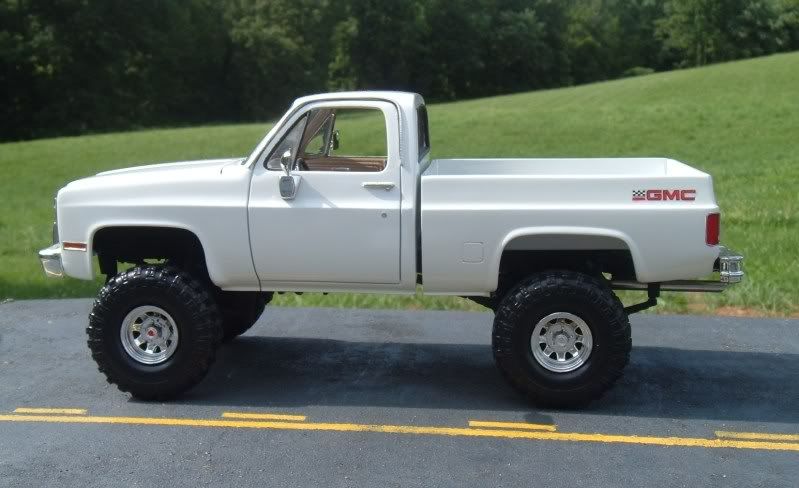

I've painted a couple of models white and have found that Tamiya TS-13 won't yellow like Testors will. Plus, Tamiya paints are much more user friendly and dry much faster than enamels. Do yourself a favor and get acrylic laquer paints like Tamiya, Model Masters,Dupli Color or Dupont. I used enamels for thirty years and had a lot of good luck as well as bad luck. Since I've started using laquers, I won't even consider enamels anymore.
Here's a model I painted with Tamiya Pure White and their TS-13 clear. I didn't capture the shine,but the clear is slick as glass and only two coats. You can also see the effect of deepened panel lines.
