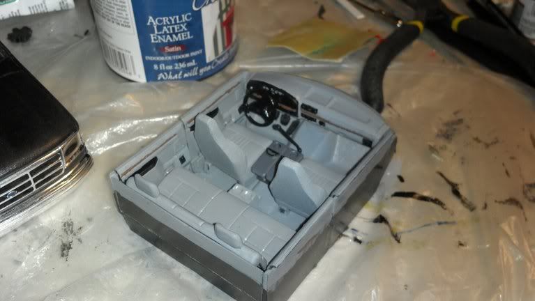

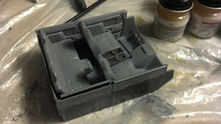

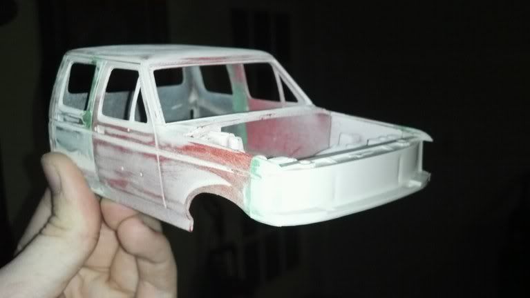

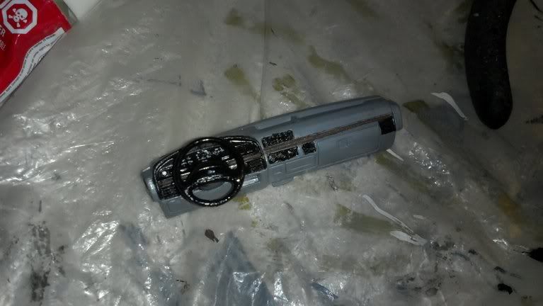

Pakmule87 Posted February 27, 2012 Author Posted February 27, 2012 Figured it has been a little while for an update, and have gotten alot done. So here are some more pics for you all to enjoy. I decided that since I bought an F150 kit for the grill, and it would be too much pain to try and mold around it to make it fit, it would be easier to just cut it off the F150 and put it on the F350. Also took the hood and cut down the F350 to the base of it to graft onto, used thin plastic strips to widen it. Surprisingly the width wasn't that far off from the 1/24 scale, though you would have expected it to be considering the difference in the heights of the cab. I am sure this will cause some problems later on when I start putting the engine in place, but I will worry about that when I get there. Cab interior with before detail paint, which I decided to just go with the interior door panels that came with the F350, since cutting the F150 cab would just look shoddy. And used the F150 bench seat for the back, since that would be the only way I can get cup holders for the back seat (none in the 1:1) After Took the dash out of the F150 kit Mockup of the cab and bed fenders Forgot about the roof ribs, but I figure its nothing that another coat of paint can't handle. Only have 2/6 glued in place, and this pic was just a mockup to see how the spacing should be. Thinned the strips I used as well so they wouldn't stand out too far. I do have some other work done, painted the chassis and attached the axles, but I am going to wait for the tires I ordered to get here before I get a good pic of it. Hopefully will also have a clear coat on the truck body by then so I can get more of it together. And I have made one of the 2 oversized clearance lights. Thinking of getting my hands on a resin mold starter kit and give it a try so that I don't have to make a second one, and so that the detail can be matched between them.

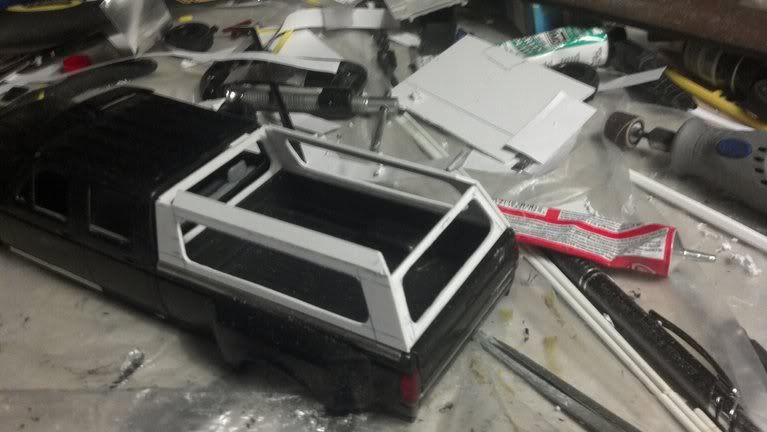

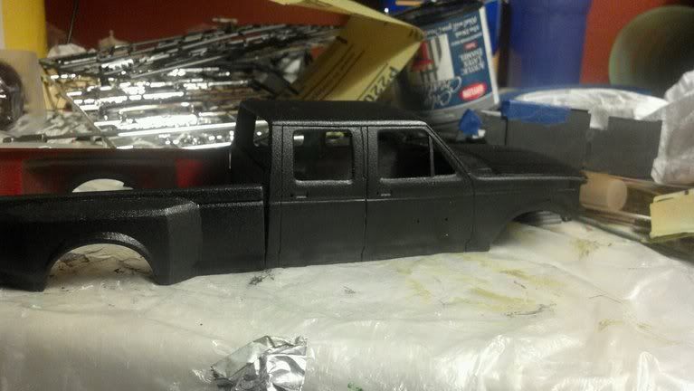

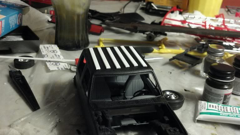

Pakmule87 Posted March 6, 2012 Author Posted March 6, 2012 Oh, while I'm here...I have "finished" the paint job...I use finish as a loose term here since I went the stupid route of can spray paint (don't have the setup yet for air spraying), but I will later on go through and redo the paint job, but for now, I will stick with this. The tires I used were from Herb Deeks, They look alot nicer than what came with the kit, but are a little bit narrow (about 2-3mm) from what should be on here, and the inside diameter was a little large for 1/24 scale, but with the help of some foil tape to add some to the wheels (and not using the rear spacer, filing the front wheel rim) they fit just perfect. Decided also to start building a camper shell to put on it, since that is the plan for the 1:1 when my dad gets around to fixing the one he found at a garbage dump which was in pretty good shape. Here is the start of it. Will have more updates as I get it looking closer to done. And btw, haven't started on the engine yet just so yall know.
Pakmule87 Posted March 9, 2012 Author Posted March 9, 2012 Just a slight update, so far have the pieces together of the camper shell, though no pic since I didn't think of getting one yet since also I have it slathered with putty and have taken the past few evenings off. But here is a teaser pic for yall of the sides and front/back cut out for glass. Currently toying with the idea of whether to let the back hatch be able to open, so have it taken off. Though will probably leave it off for now, since I plan on trying out my hand at resin casting with the BMF starter kit when I get the spare cash. Figured the resin would also make it easier to make the copies for side marker lights and the oversized clearance lights (have 1 of each made), and you never know who would be interested in buying some off ebay , along with the rear bumper which I keep forgetting to take a picture of... And decided on my next build which I may toy with while I am still working on the truck, and that is making a model of the trailer my dad uses to pickup equipment when it needs to be hauled to the shop that he made, tilt bed, tandem axle, all those goodies, along with a 1/24 scale scissor lift (we specialize in their repair), since the only ones out there seem to be in 1/32 die cast JLG, and I would rather have a Genie 1930 sitting on it
