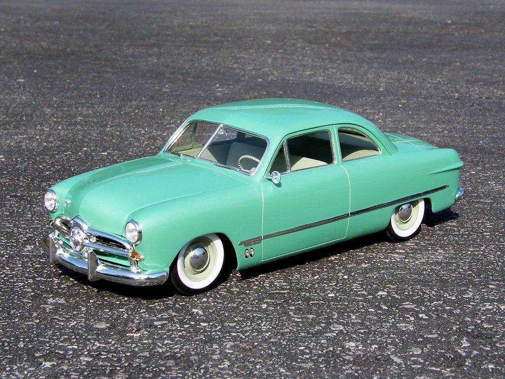

MonoPed Posted February 12, 2012 Posted February 12, 2012 There is something to be said for shooting in sunlight, this was shot on my asphalt driveway, with the camera mounted on a desktop tripod.
Dr. Cranky Posted February 12, 2012 Posted February 12, 2012 Brian, that turned out to be a great picture of a beautiful model. And you are right, there's no way to go wrong out in the daylight.

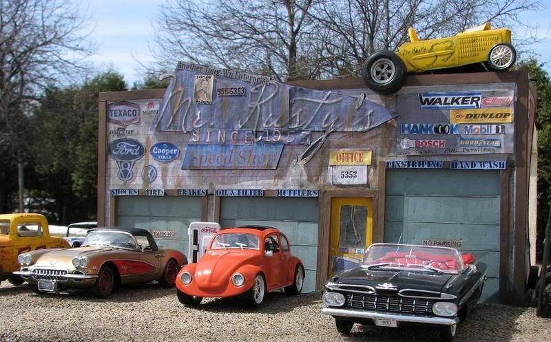

Tony T Posted February 12, 2012 Posted February 12, 2012 It was a Jerry Sims suggestion that I take my garage diorama outside. Here is one of the results of that exercise!
