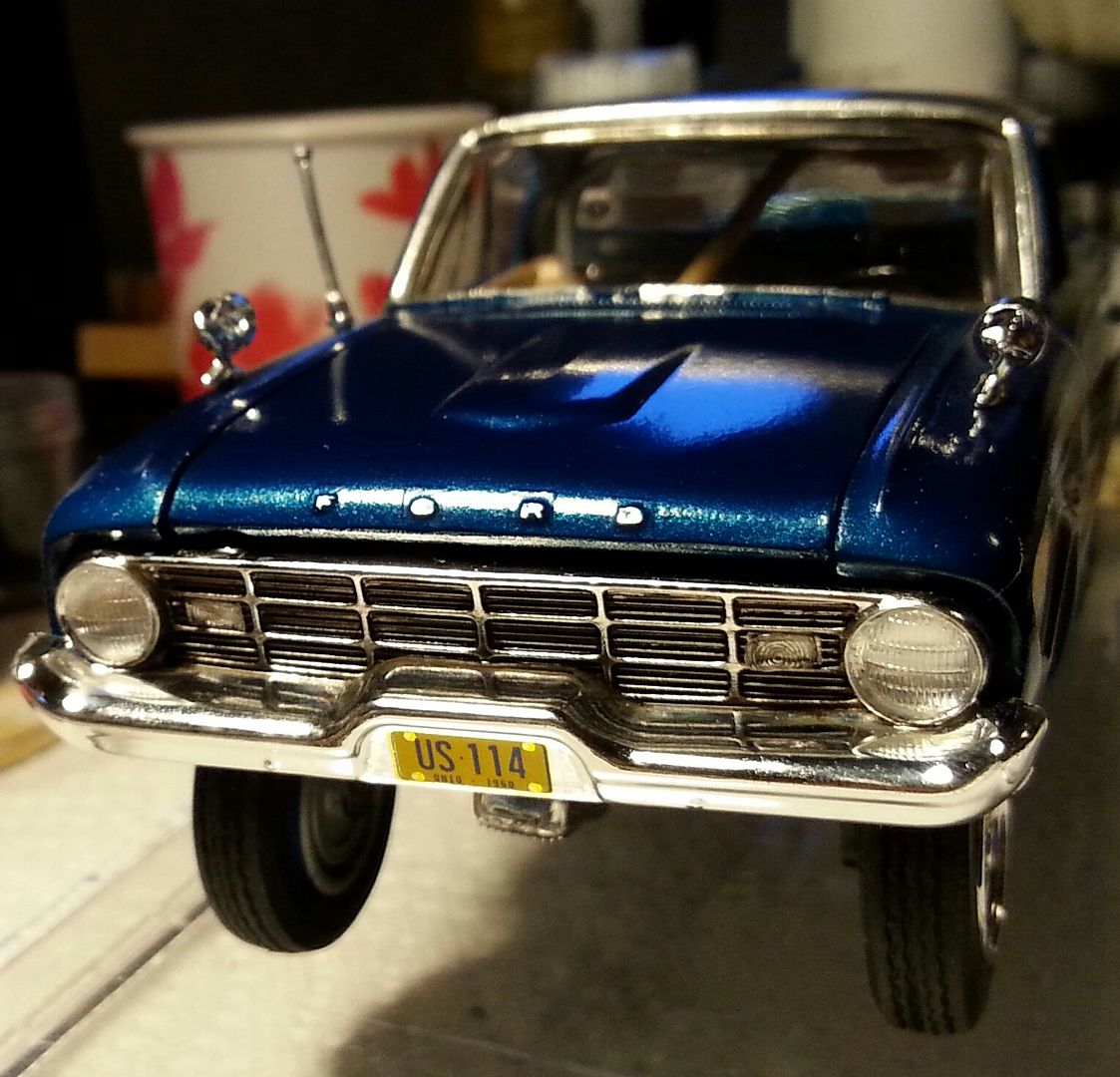

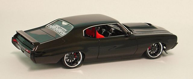

Johnt671 Posted November 6, 2016 Posted November 6, 2016 (edited) More pictured. Duplicolor and Rust-oleum clear 70' paint job. Testors with Testors clear. The specks are dust. Duplicolor and Future. Rust-oleum semi gloss. Duplicolor and Future Edited November 6, 2016 by Johnt671 Duplcate pictures

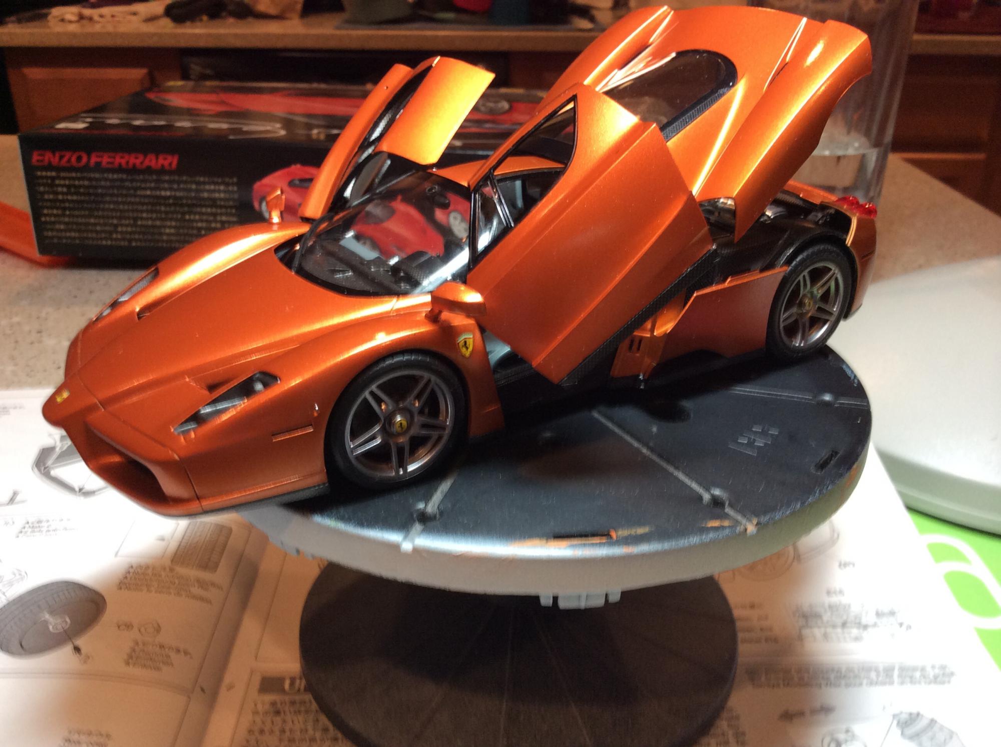

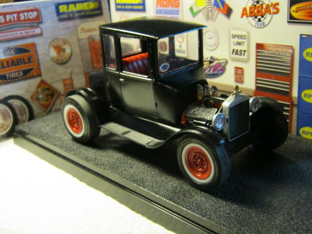

Gt fan Posted November 7, 2016 Posted November 7, 2016 Tamiya paint . Met. Orange with gold under base and racing blue with silver under basebase

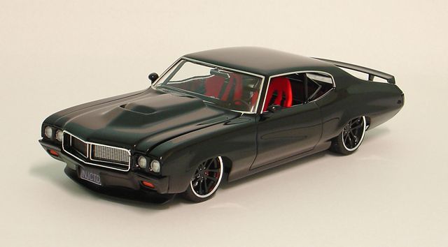

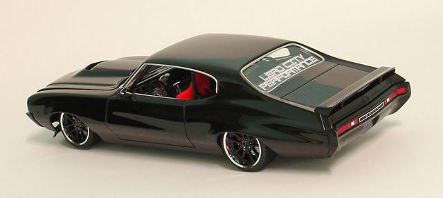

Cool Hand Posted November 7, 2016 Posted November 7, 2016 (edited) As always Tamiya TS-14 black. Although this build was wet sanded with 6000-12000. Then polished with the following Meguiars products in the order they are shown.. Not surprised this topic has turned into the usual measuring contest by the same old suspects Edited November 7, 2016 by Cool Hand

moparfarmer Posted November 8, 2016 Posted November 8, 2016 Cool Hand... WOW what a beauty..I use the cleaner only its in a maroon container but the Hi Tech is silicone based..I use it on my 1:1 64 Fury Convertible..Sure is nice stuff..Oh, and did I say, your Buick is awsome...?

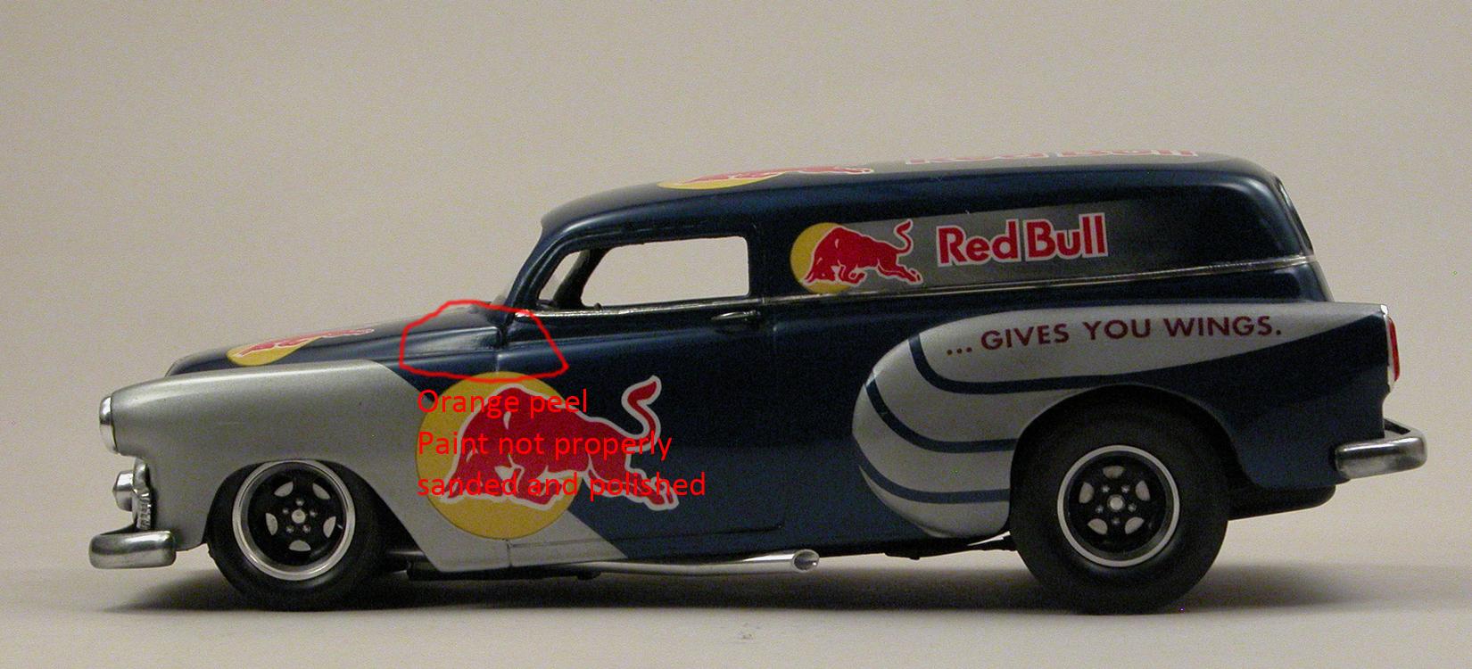

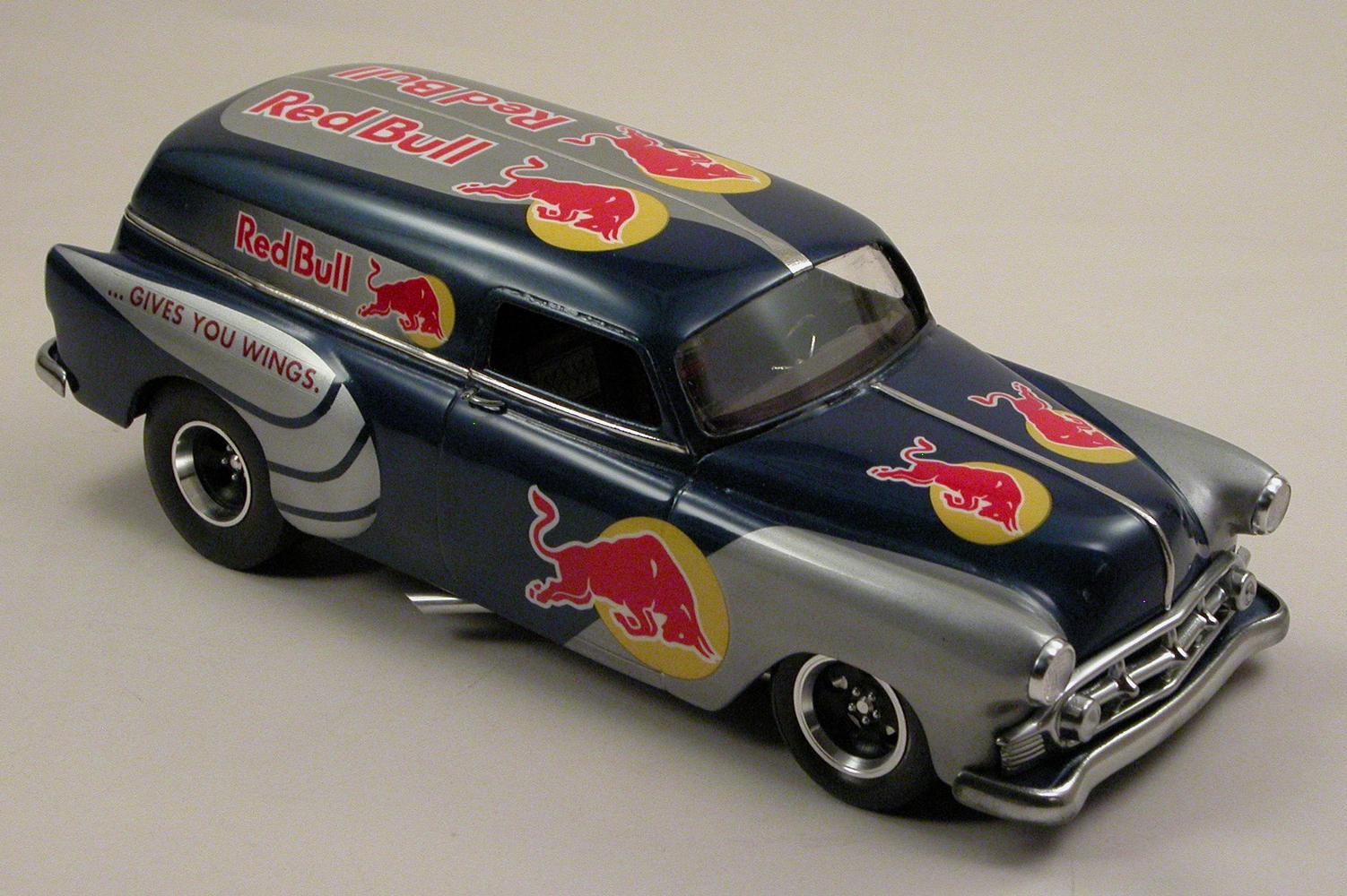

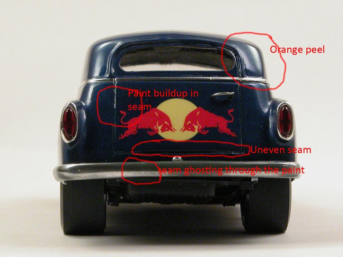

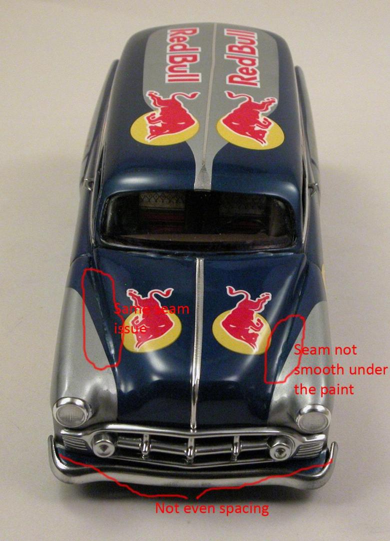

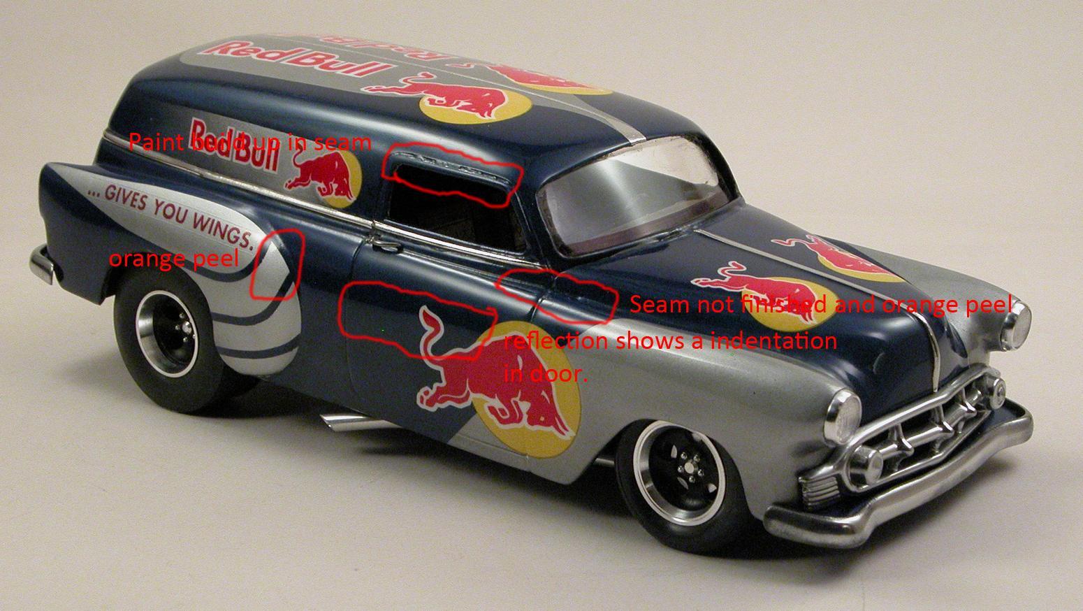

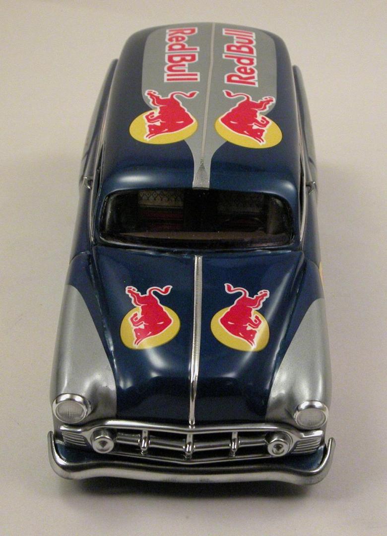

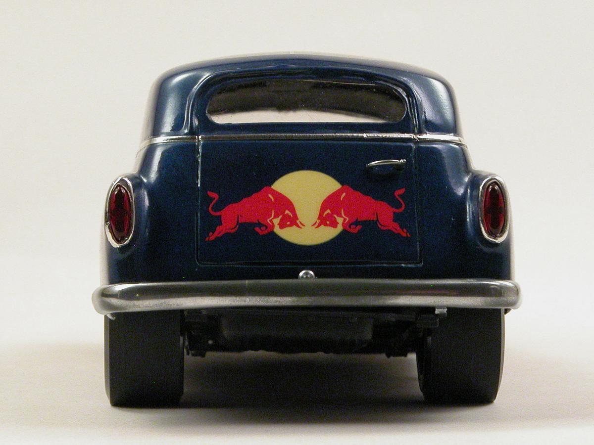

Pete J. Posted November 10, 2016 Posted November 10, 2016 Ok, since no one took me up on critiquing the paint on my model, in a effort to help people look a little more critically at their own work, here is what I see. Frankly, this model has some nice things, but as I said it will never make it off my shelf. It is not to a standard that I prefer. I hope this helps others look critically at their models and learn how to make them better.
Harry P. Posted November 10, 2016 Posted November 10, 2016 You forgot to mention the Red Bull logo crossing over the door panel line. Would never happen in real life.

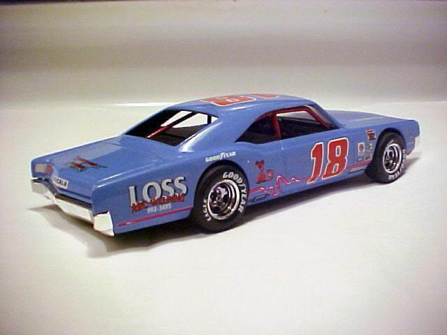

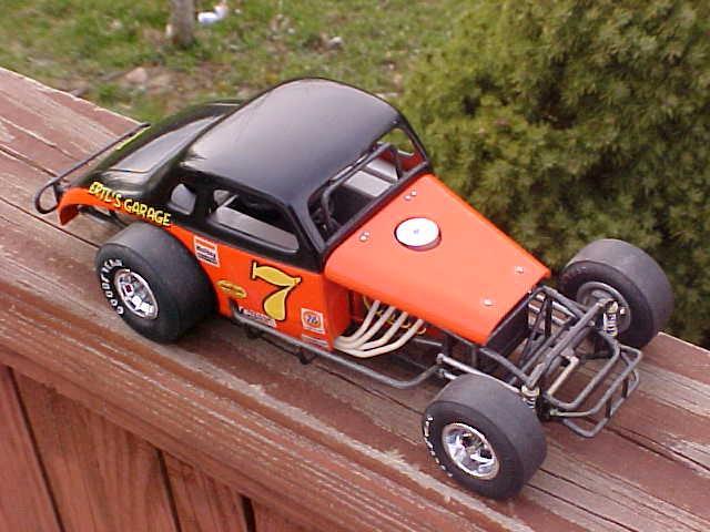

Hawk312 Posted November 10, 2016 Posted November 10, 2016 All done with spray cans. The blue stock car was done with Lowes Valspar and Rustoleum:
Ace-Garageguy Posted November 10, 2016 Posted November 10, 2016 All done with spray cans. The blue stock car was done with Lowes Valspar and Rustoleum: Man, now THAT is some PAINT.
Ace-Garageguy Posted November 10, 2016 Posted November 10, 2016 Ok, since no one took me up on critiquing the paint on my model, in a effort to help people look a little more critically at their own work, here is what I see. Frankly, this model has some nice things, but as I said it will never make it off my shelf. It is not to a standard that I prefer. I hope this helps others look critically at their models and learn how to make them better. It's good of you to use your OWN work to illustrate flaws and things people should try to pay attention to. A very genuinely helpful gesture.
Pete J. Posted November 10, 2016 Posted November 10, 2016 (edited) You forgot to mention the Red Bull logo crossing over the door panel line. Would never happen in real life. ummm, not necessarily true. Edited November 10, 2016 by Pete J.
