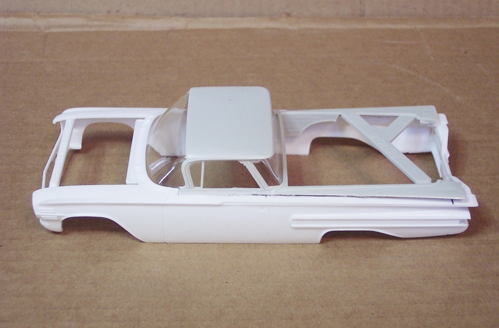

TooOld Posted February 16, 2013 Posted February 16, 2013 (edited) I thought I'd share a few pics of what's on my bench right now . It's still a bit rough but I mocked it up to get a feel for what it will look like . Hope you like it ! Edited October 11, 2018 by TooOld
Eshaver Posted February 16, 2013 Posted February 16, 2013 Bob, that came out remarkably well ! I saw an "In Progress shot somewhere else . I could see you were really taking the time to make sure everything was ling up well an it shows too.
Custom Hearse Posted February 17, 2013 Posted February 17, 2013 That is nice! Definitely gotta watch this!
TooOld Posted February 17, 2013 Author Posted February 17, 2013 Thanks guys ! I'm not very good at doing a work in progress so you might want to go ahead and eat your popcorn now .

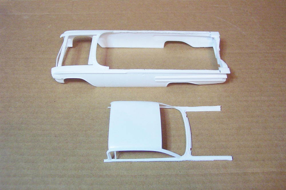

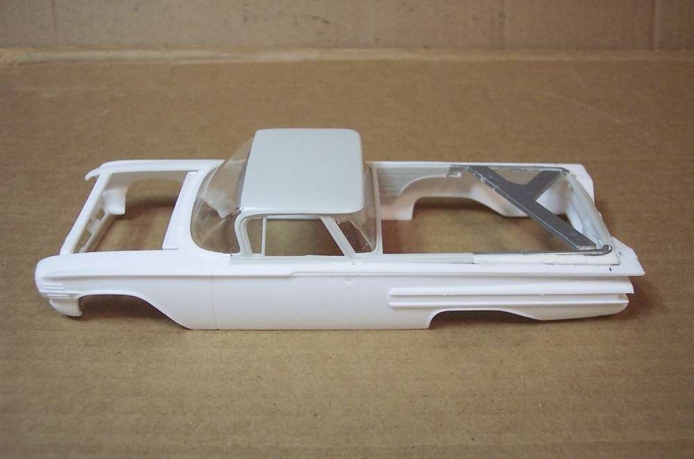

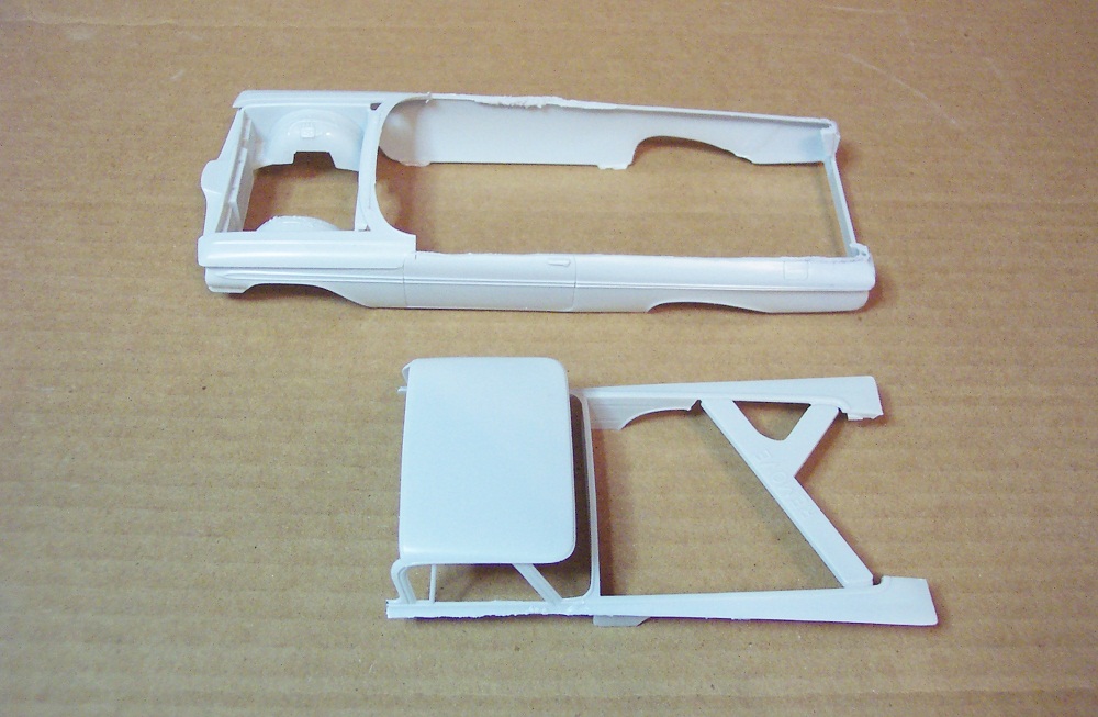

TooOld Posted February 19, 2013 Author Posted February 19, 2013 (edited) Just out of curiosity what did you order from Modelhaus ? I didn't know they had any parts for this . I guess I should explain that this isn't a resin kit , I mated the top from the AMT '59 El Camino to a Revell '60 Impala . It actually worked pretty good . I spent a lot of time filling and sanding to make the tailgate and taillight panel correct . Here's a few photos . Edited October 11, 2018 by TooOld

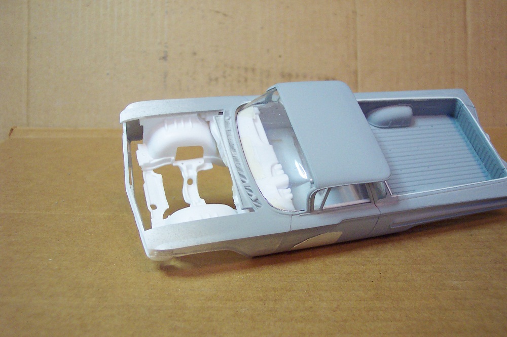

TooOld Posted February 20, 2013 Author Posted February 20, 2013 (edited) I've made a little progress the last couple of days . I 've got the interior pieces fitted and fabricated a hood hinge . I also painted the tires , they are really nice ! Thank you Joseph at Fireball Modelworks . I need to clean up the center caps on the wheels , got a little bit too much paint on them ! Edited October 11, 2018 by TooOld
TooOld Posted February 22, 2013 Author Posted February 22, 2013 (edited) Thanks Dave , so do I ! I've about finished the mods on the chassis and made up a new fuel tank using the one I cut from the AMT kit . Everything seems to fit okay , I'll add some tank straps after paint . I also narrowed the track simply by opening up the backing plates and sliding them in on the axle ( I'll cut the ends off later ) . This narrowed it by 3/16" total ! Edited October 11, 2018 by TooOld

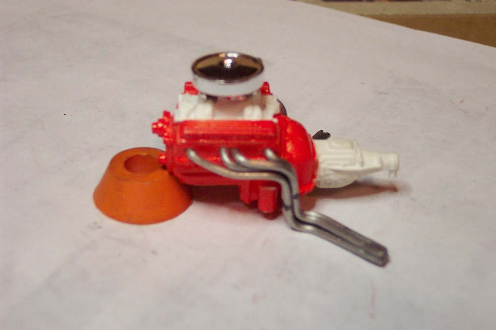

TooOld Posted March 2, 2013 Author Posted March 2, 2013 (edited) I decided it was time to start working on the engine so I found a nice small block in the Revell '64 Pickup kit . It looks just like the 283 I had in my El Camino , with stamped valve covers , a 4 bbl intake and a 4 speed trans . I'm making my own headers out of .062 solder , which scales to 1 5/8 diameter . If you ever buy headers made for a '60 Chevy , they are made to really hug the engine and then they dump to the outside of the X - frame where they hook up to the stock exhaust . It took two trys but I finally have a set that I think will be okay once they are cleaned up and painted . I have flanges made but they aren't installed right now . The orange paint was done quick just to take some pictures . Edited October 11, 2018 by TooOld
