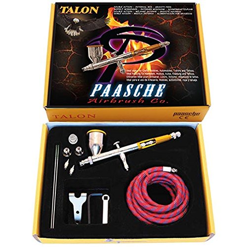

I have had allot of airbrushes. I currently own 2 Iwatas and 2 Neo for Iwatas(trigger action) and a Paasche Talon and Paasche Millenium. I love them all and use them all but the best value because it is a set with three sizes that should cover all your needs is the Paasche Talon TG3-F set. It is currently $102 on Amazon. It has a pre-set needle limiter so you can get a consistent spray pattern like a single action. The parts are very sturdy and easy to find.

Dale that is a great deal and a great suggestion, I wish I would have found it before I got my outfit.
With this set up you could get everything you need for under 300$ if you don't already have a compressor and have great quality at the same time.
