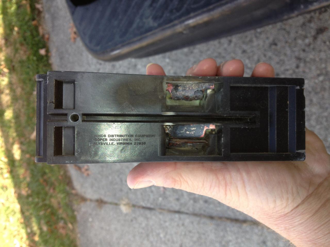

Had a problem a while back at my home (built in '87), when I started smelling that weird "ozone" smell. Kept searching around the house to find the source. Ultimately, I thought to check the main utility box, and it was HOT. To make the long story short, the main 150 amp breaker was going bad, and was *melting*, and the electrician I called in to help said we were only hours away from a possible fire. If my family and I had been away on vacation or something, we could have lost the house. See attached photos.
Moral of the story, if you live in an old house like mine, get the electrical system checked out once in a while, and get help if you suspect trouble. You'll be glad you did...
post-10758-0-04935000-1367781077_thumb.j
post-10758-0-90821900-1367781165_thumb.j
post-10758-0-66841000-1367781251_thumb.j
