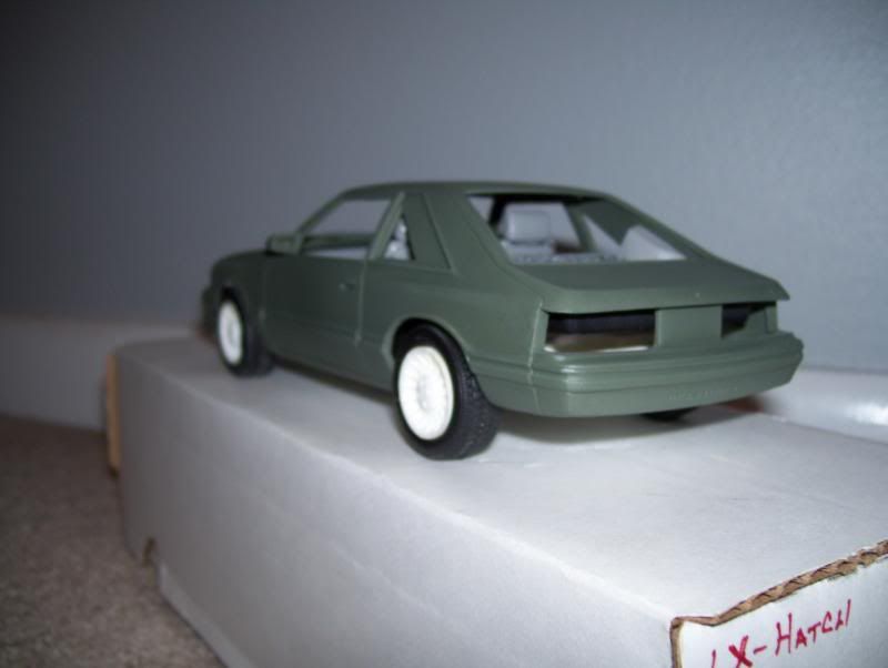

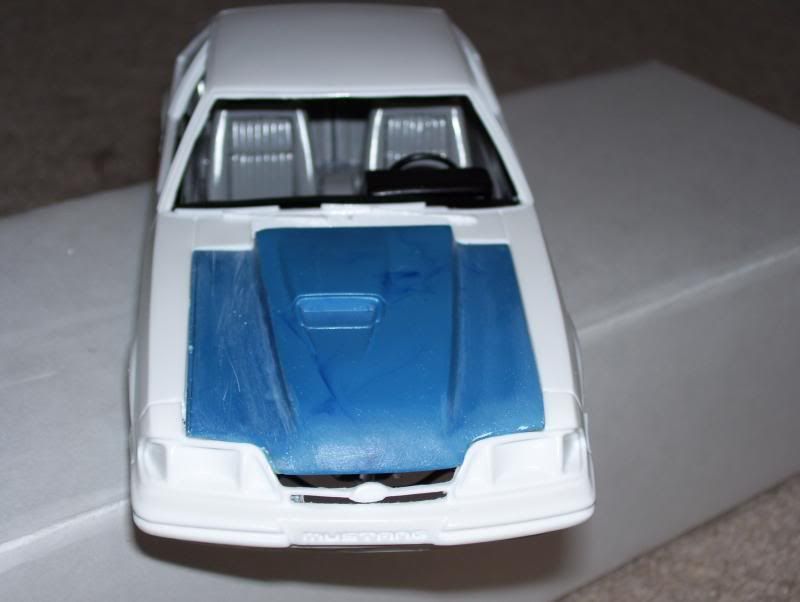

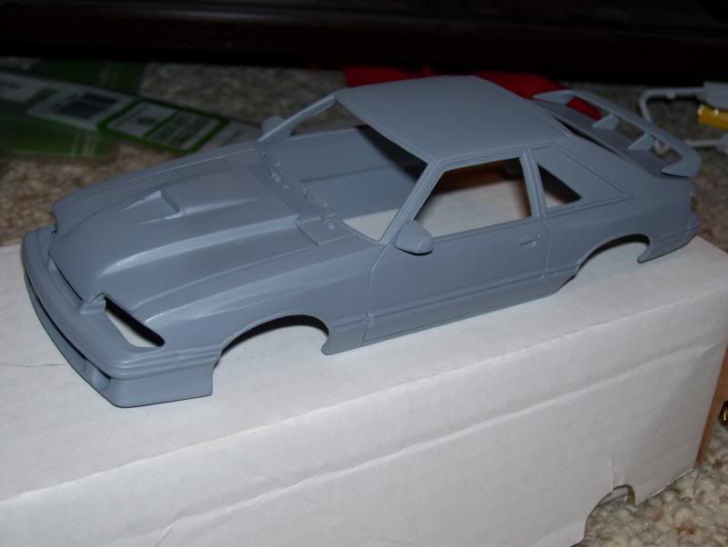

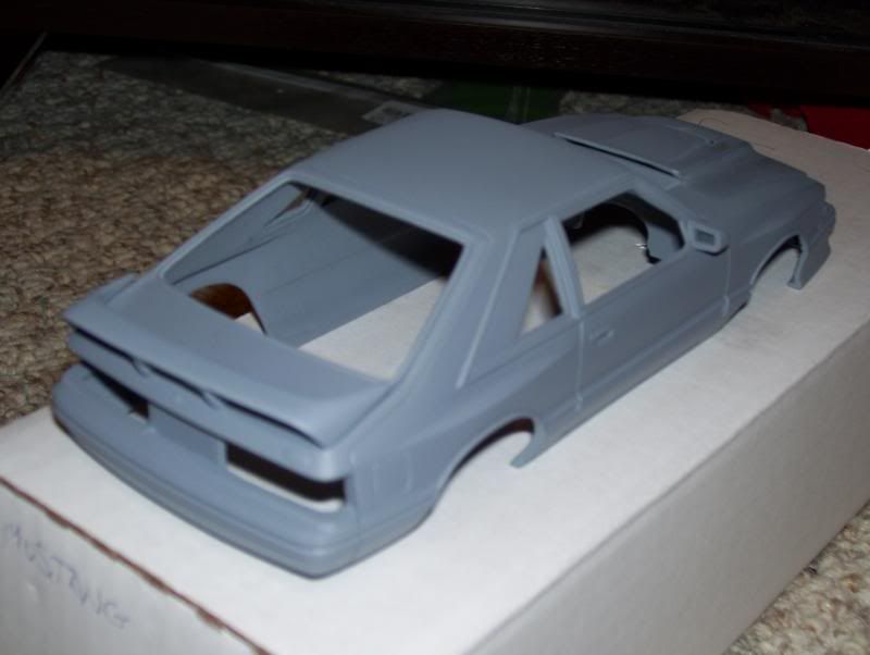

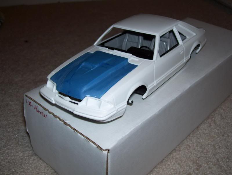

Abell82 Posted September 14, 2013 Posted September 14, 2013 (edited) No not a coupe. A Hatchback. Yes it is resin. It may need a new nose, but then again I just may leave it alone, and just build it. The custom cowl hood, is also resin. Edited September 2, 2014 by Abell82
Devilsnake98 Posted September 14, 2013 Posted September 14, 2013 Where did you get this body? Ive seen a couple that are being sold on ebay and the surface looks to have a very course finish and I dont think I wanna sand my brains out just to have a smooth body.
Abell82 Posted September 14, 2013 Author Posted September 14, 2013 (edited) This is from Ebay. I have 3-4 of these, they do not have a course finish. However they are too long below the doors, (2mm) AND the roofs have gotten very thin. So it is, as always... buyer beware. edit: It may be the coupes you are thinking of, as they do have a rougher finish. Edited September 14, 2013 by Abell82

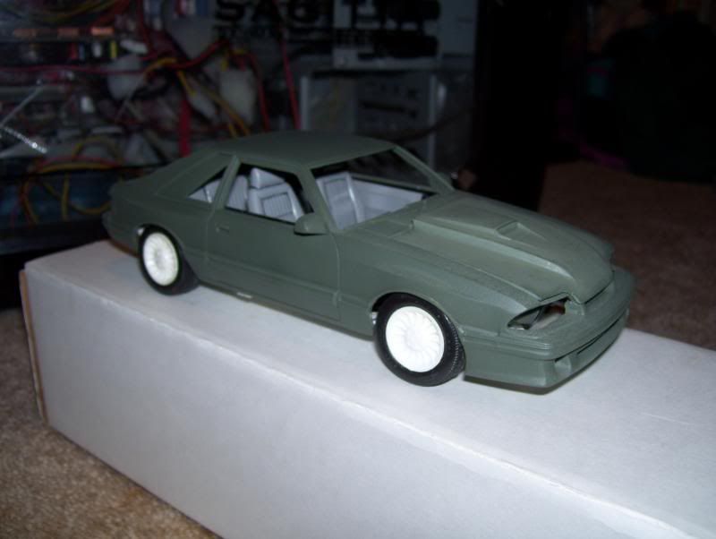

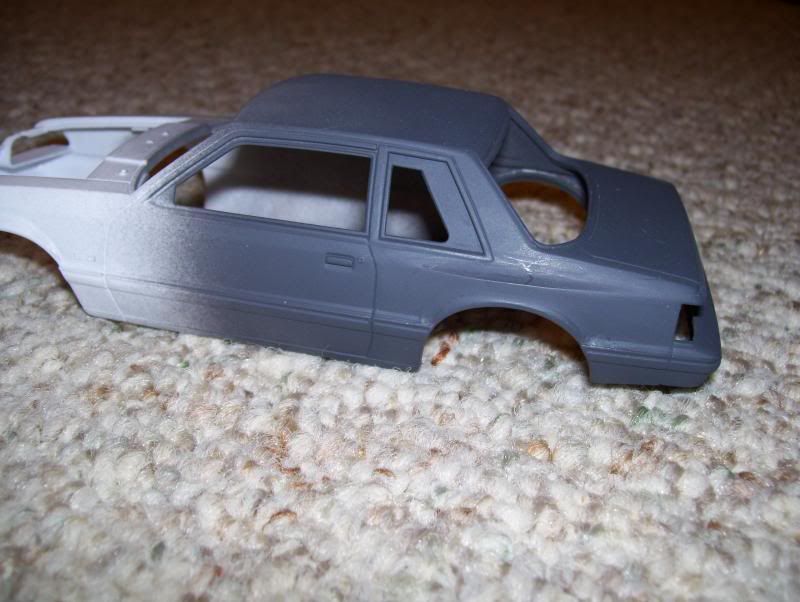

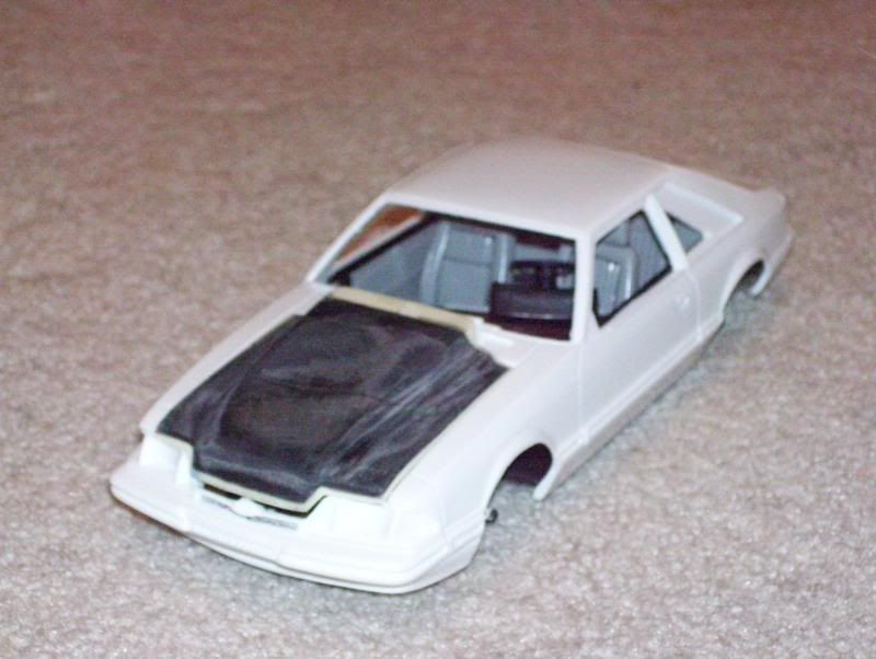

Abell82 Posted September 15, 2013 Author Posted September 15, 2013 Since I have one body with a rough finish, I decided to use that one first. Unfortunately, the first custom hood would not work with the other body. So I 'll be using a different hood as well. Here is the body and hood I will be using.

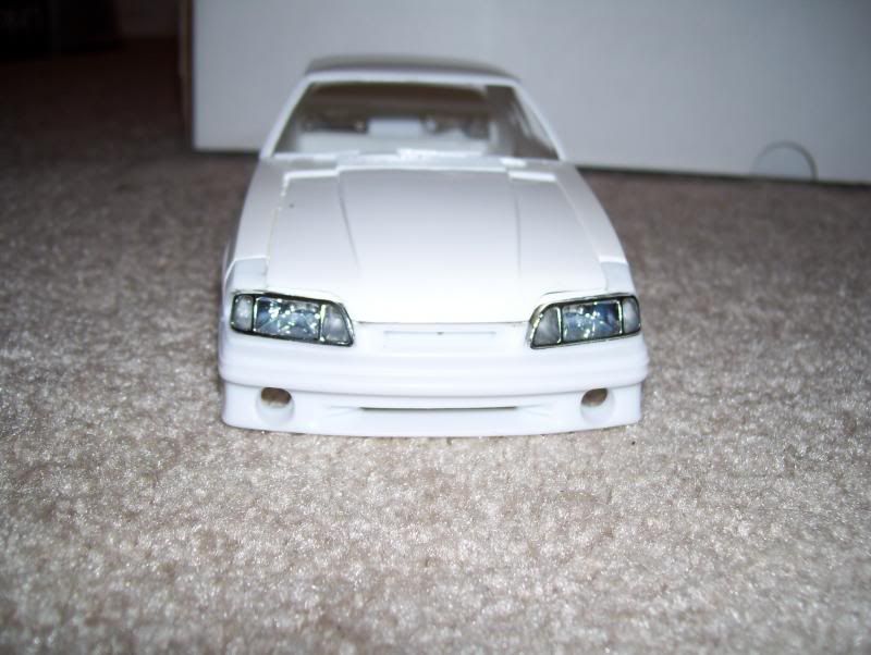

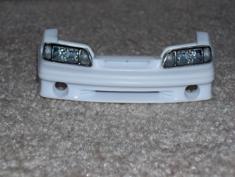

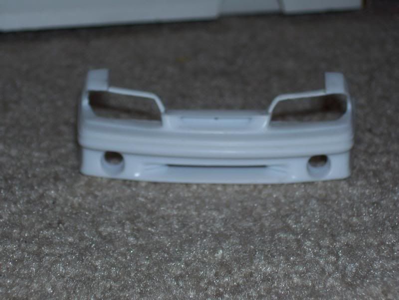

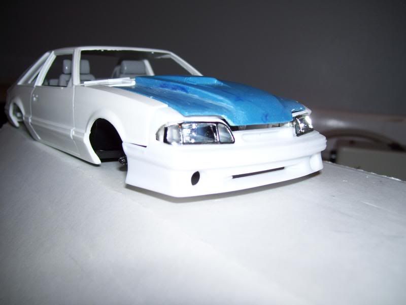

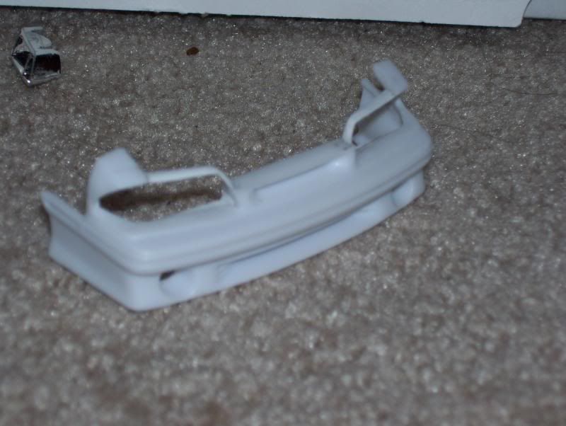

Abell82 Posted September 19, 2013 Author Posted September 19, 2013 (edited) On 9/14/2013 at 2:13 AM, Devilsnake98 said: The ones im referring to is from rdsxfan2, theres one with a cowl hood, saleen wing and drag lite wheels, then theres an outlaw version. Thanks for all the help, still will prob pass, its 1/24 scale so you have to use the 93 cobra kit as a donor and im not a huge fan of that kit detail wise. He also does a 1/24 scale coupe as well. to each there own. It REALLY isn't worth the money for the hatchback body, as it does not include an interior. If it did, then it MIGHT be. As nearly any kit could be used as the donor. If you HAVE to use a Cobra kit as a donor, your really better off just making the kit body into an LX. This is my opinion. HOWEVER... Having spent the money already... WHO says you have to limit your self to just one donor kit. Anyone notice that the headlights in the new Revell LX kit are the same size as both the AMT AND Monogram offerings? They ARE!! Since I really didn't like the stock resin LX bumper, I decided to go with a different one...modified of coarse... Looks better already doesn't it? If just the headlights look this good, what else could we use? The resin cowl hood needs a bit more work to fit properly... (The front bumper is sagging too!) Edited September 19, 2013 by Abell82

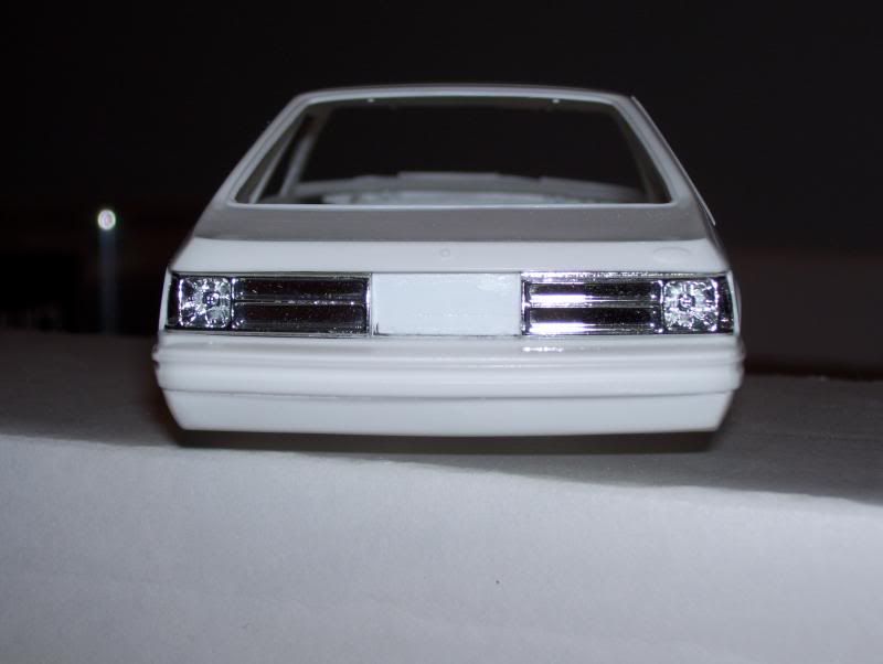

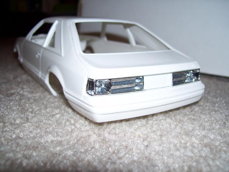

Abell82 Posted September 19, 2013 Author Posted September 19, 2013 What about the rear view you ask ? Funny you should bring that up... The taillights may be just a little too short length wise, or maybe not? An improvement either way.
Skydime Posted September 19, 2013 Posted September 19, 2013 (edited) On 9/19/2013 at 3:13 AM, Abell82 said: How in the world did you do those headlights...and taillights? IMO, the taillight width looks spot on because of the lenses making up the difference. Edited September 19, 2013 by Skydime
Devilsnake98 Posted September 19, 2013 Posted September 19, 2013 Those are from the new revell lx coupe kit.
Skydime Posted September 20, 2013 Posted September 20, 2013 Maybe it's the lighting but, they look fully detailed like you worked hours on them!

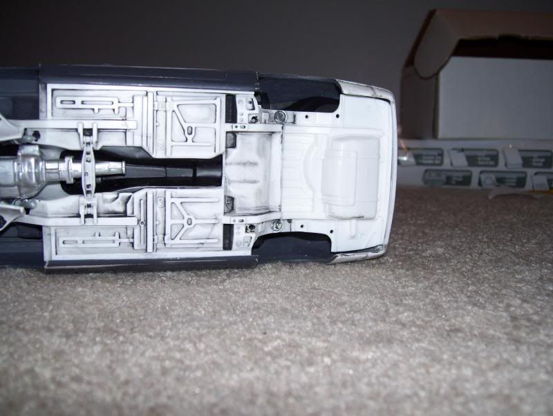

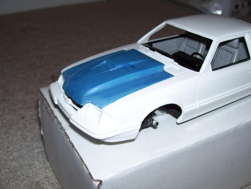

Abell82 Posted September 28, 2013 Author Posted September 28, 2013 (edited) Thanks the fronts do look good, unfortunately, The rears no longer look as nice. I went to soak the body in bleche white to get rid of the mold release and forgot the taillights were still in it. Needless to say the taillights are not chrome plated any longer. (SIGH!) I was going to literally throw this together using previously built and painted parts, but my OCD wont let me. Anyhow, the chassis I will be using was hacked up from a previous owner. So to correct it, I stripped the flat black paint off, and then back -halved it, right above the rear wheels. I got a little impatient while I was doing this, and ended up breaking the chassis, through the spring mounts. (This was due to the Missus telling me I needed to hurry. I should have known better ! ) I think I did a decent job of repairing it though. I used a piece of chassis that had been previously cut up for some other reason, and then given to me by someone else, to make the repair. But I digress.... I then glued the front bumper in place, and added some rearview mirrors ... More later... Edited September 28, 2013 by Abell82

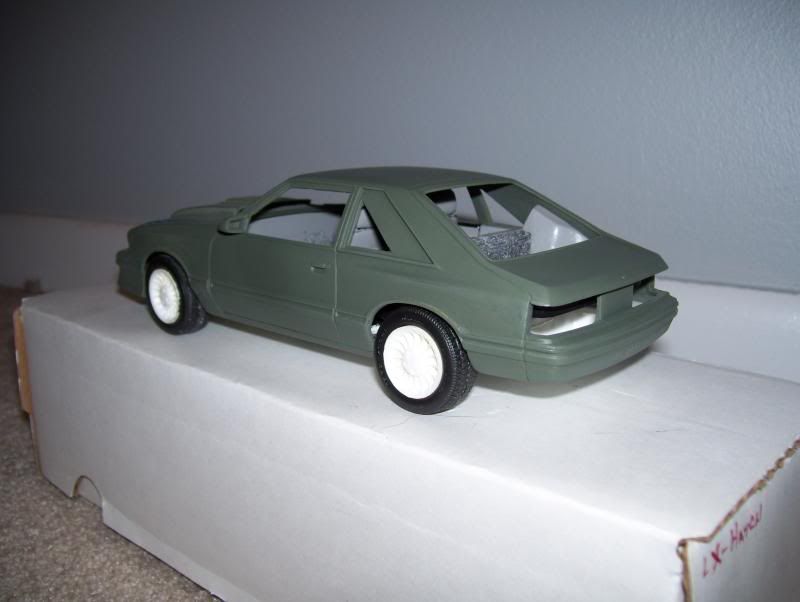

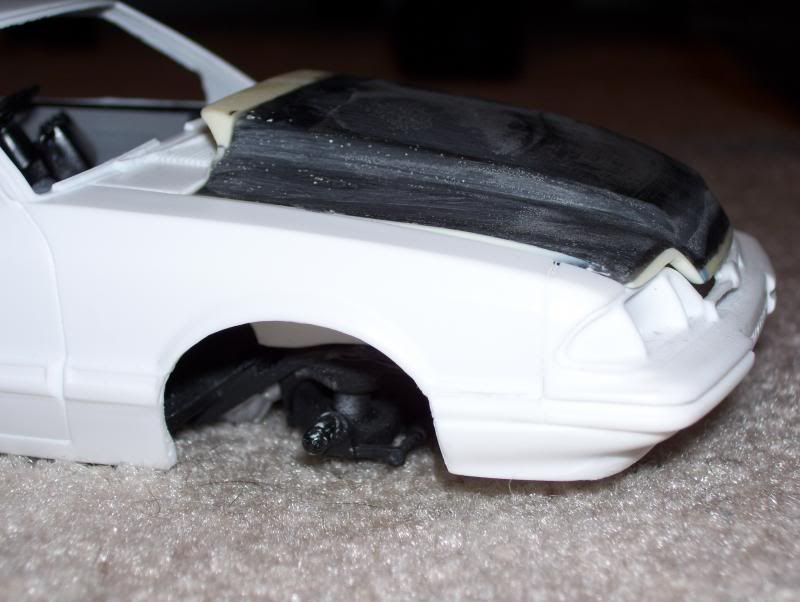

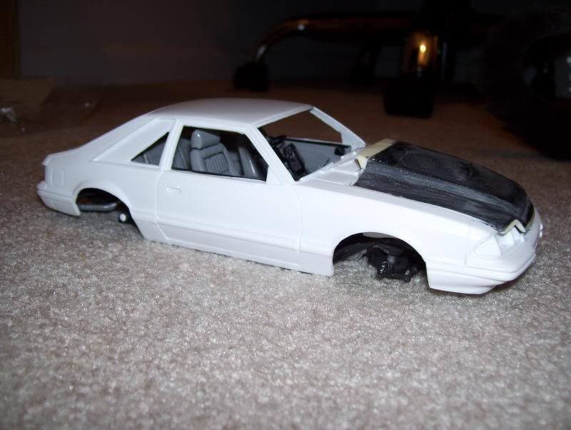

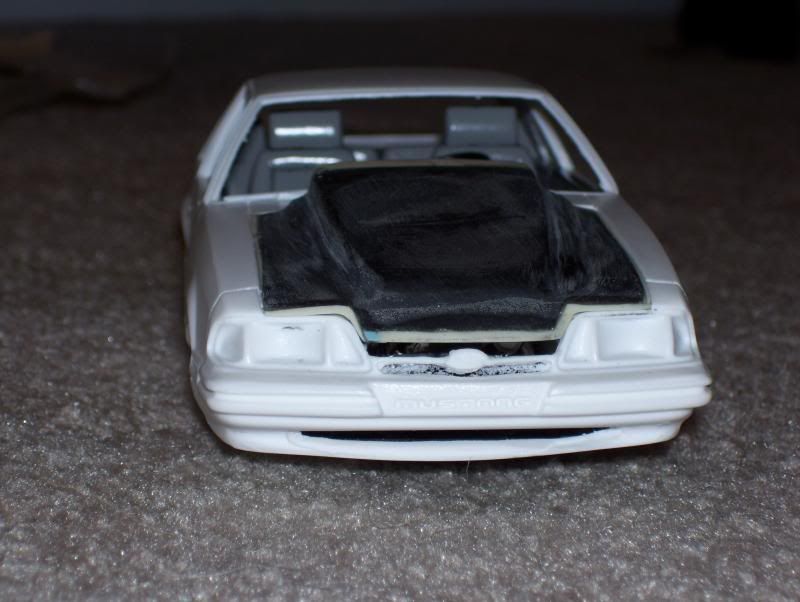

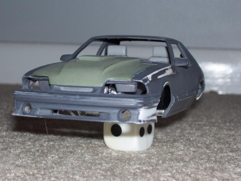

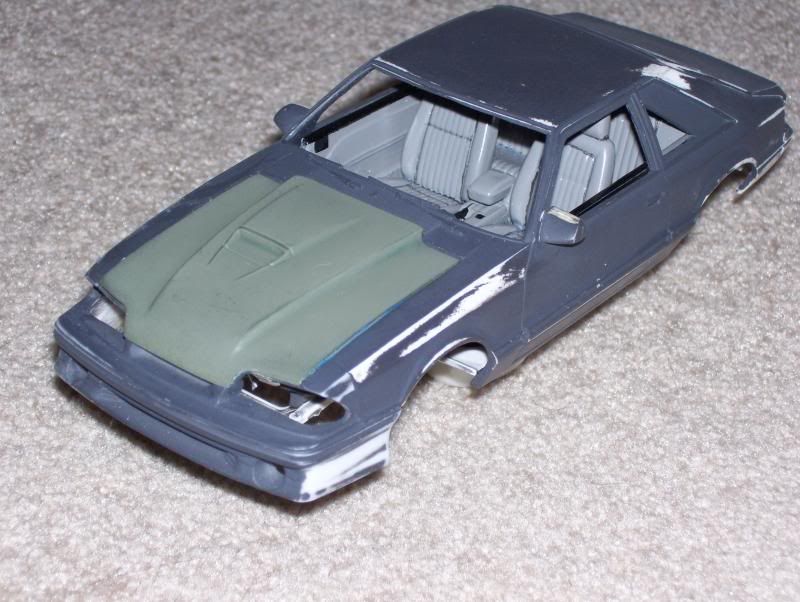

Abell82 Posted October 4, 2013 Author Posted October 4, 2013 Got a little time to work on the project, and I made a few slight changes to it. See if you can spot the changes...
Devilsnake98 Posted October 4, 2013 Posted October 4, 2013 Well capri front and rear fenders. Are those from a donor body or scratchbuilt?
Abell82 Posted October 4, 2013 Author Posted October 4, 2013 (edited) Custom made. Also changed the rear bumper, and lowered the suspension. Edited October 4, 2013 by Abell82
Devilsnake98 Posted October 5, 2013 Posted October 5, 2013 Thats cool, id like to do the capri fenders on my lx coupe but not sure if could pull it off.
Abell82 Posted October 5, 2013 Author Posted October 5, 2013 (edited) I used the coupe as a sort of test mule, to see if I could do it on this body. I only did the rears not the fronts. Edited October 5, 2013 by Abell82
Devilsnake98 Posted October 5, 2013 Posted October 5, 2013 Did you just cut where the top of the flare is, push it out and fill the gap with a shaped strip of styrene? Then cut the mustang opening flare off and filled it and reshaped it to make it flat?
Abell82 Posted October 7, 2013 Author Posted October 7, 2013 On 10/5/2013 at 6:48 AM, Devilsnake98 said: Did you just cut where the top of the flare is, push it out and fill the gap with a shaped strip of styrene? Then cut the mustang opening flare off and filled it and reshaped it to make it flat? On 10/5/2013 at 6:25 PM, freakshow12 said: Could you show me how you did that? Every Modeler does it a little differently, from what I have found. I am sorry, but I don't have a tutorial prepared. So I can't show you. BUT, Darin Bastedo has a great tutorial in the how to section Titled : How to : Widen fenders the easy way. And He can show you. Personally I prefer to fill mine with styrene rather than CA glue, but to each there own. (see the Tutorial here: ) http://www.modelcarsmag.com/forums/index.php?showtopic=55926&hl=fenders As for the Mustang flare: I don't remove the Mustang fender flare. Rather the reverse of the fender. Scribing around the flare, and then folding it in, instead of out. Once it is where I want it and filled, I remove the excess, from the inside of the fender by grinding it out with a Dremel tool. I have found this less tedious then trying to get the curve of the wheel well corrected, and then mating it to the fender that I had cut up. I have also found it to be slightly more accurate, or at least aesthetically pleasing. I then apply a "lip" of styrene stick, or rod. Does that help?

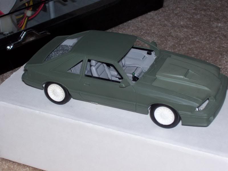

Abell82 Posted October 7, 2013 Author Posted October 7, 2013 Changed the title to better reflect the direction this build is headed. Got the body primed a little more today, still a lot of work left ahead...
