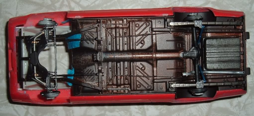

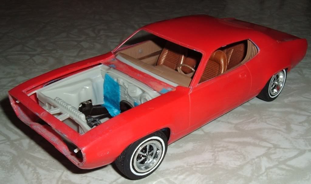

After more than twenty years , I finally got me a coveted , 1987-issue MPC 1971 Road Runner .
I have see a couple of examples -fine , wonderful examples- of bashing the AMT 1971 Charger R/T with the 1973-1974 MPC Road Runner , and am now wondering how many of you have utilised the aforementioned Charger with the 1971 R.R.
Obviously , the Charger has a different interior ; door panels and upholstery pattern are vastly different from the same year R.R. , albeit , with the same Rallye Instrument clustre (steering wheel , too).
What I'm attempting to ascertain here :
What would be the best approach to interface the R.R.'s interior door panels with the Charger's chassis ?
How about the R.R.'s seats -actually , just the rear seat- to the Charger's platform ?
Please provide photos / technique(s) , if possible .
Thanks !

The whole interior tub is shallow enough to fit on top of the platform floor from the Charger- the platform interior can also be used with some trimming- the lower door panels are the same from the Charger to RR. Possibly sand off the upper door panel detail from the Charger and rework? The Charger back seat has a fairly similar pattern to the RR with buckets
The pattern for the door panels in the tub is only correct for a bench seat RR (base Satellite trim level) which also used a much "plainer" back seat- bucket seat Road Runners got the upgraded "custom interior" door panels as used on the Sebring line. (Closest to the Charger door panel would be the woodgrained premium trim used on the Sebring Plus and GTX)
