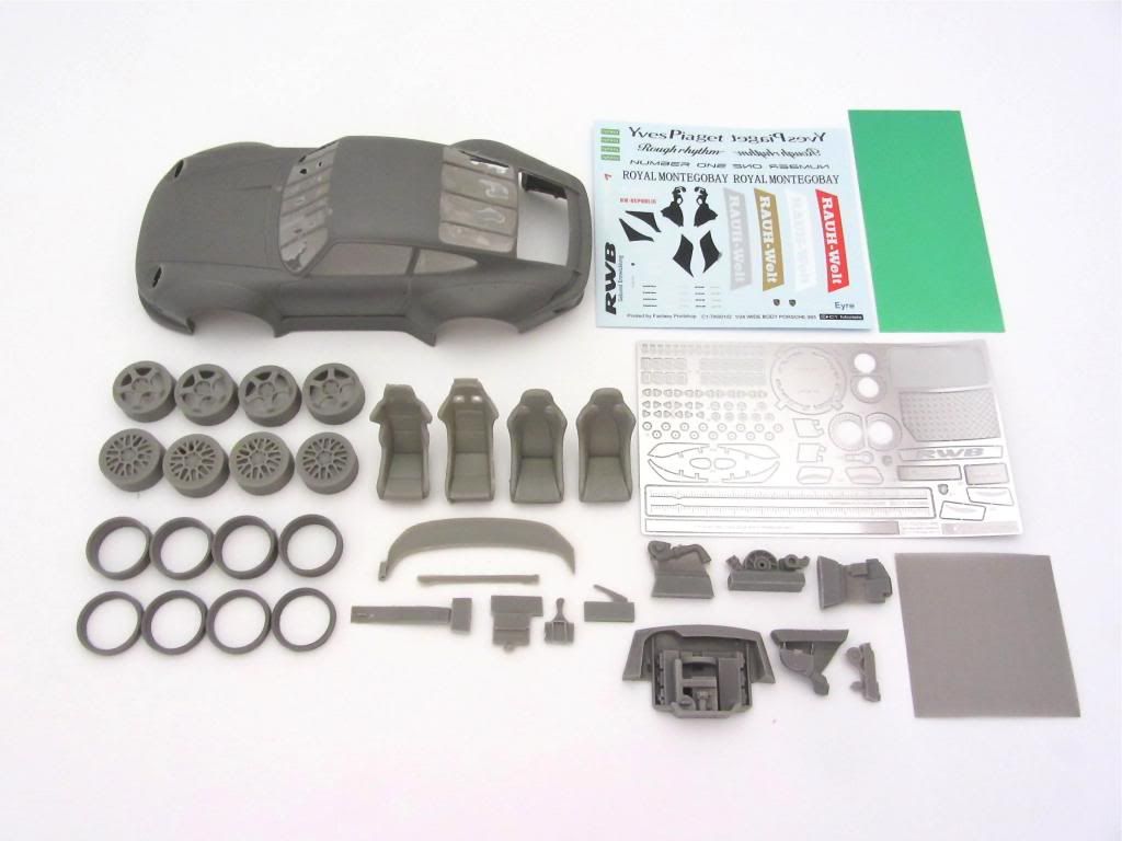

This is the kit I am most excited about. I am going to be very detailed and take my time here. I am still pretty new to modeling but I have grown a lot already I feel. I am starting work on the 993 Rauh Welt Porsche kit. This kit is used with the Tamiya 911 GT2 Road Car kit as a donor kit. These kits are by a company called C1 Models out of the UK. Chris runs the place and is very helpful. This is one of my favorite cars of all time. Following photos you will see some photos of the real car and the unboxing.

They include the green material as seat belts as well as some mesh for intake areas on the bumpers.
Two sets of deep well wheels to chose from along with seats.

The quality of your example looks to be far better than the one i've got here. Mine is No 49/ 300.
I had read where C1 Models had changed its resin caster. it looks for the better too.
My example is molded in a dark grey resin and has required a huge amount of work, particularly around the front and rear windscreens to get to a useable state.
All the resin parts in mine were very ' softly ' molded. By that I mean all the sharp edges are rounded and required a lot of work to sharpen things up.
The biggest issue I've faced is although the C1body shell is molded off the Tamiya shell nothing from the Tamiya donor kit will fit it without work.
Its like the C1 Shell has shrunk to 1/25 scale in the molding process making all of the 1/24 scale Tamiya donor parts too big.

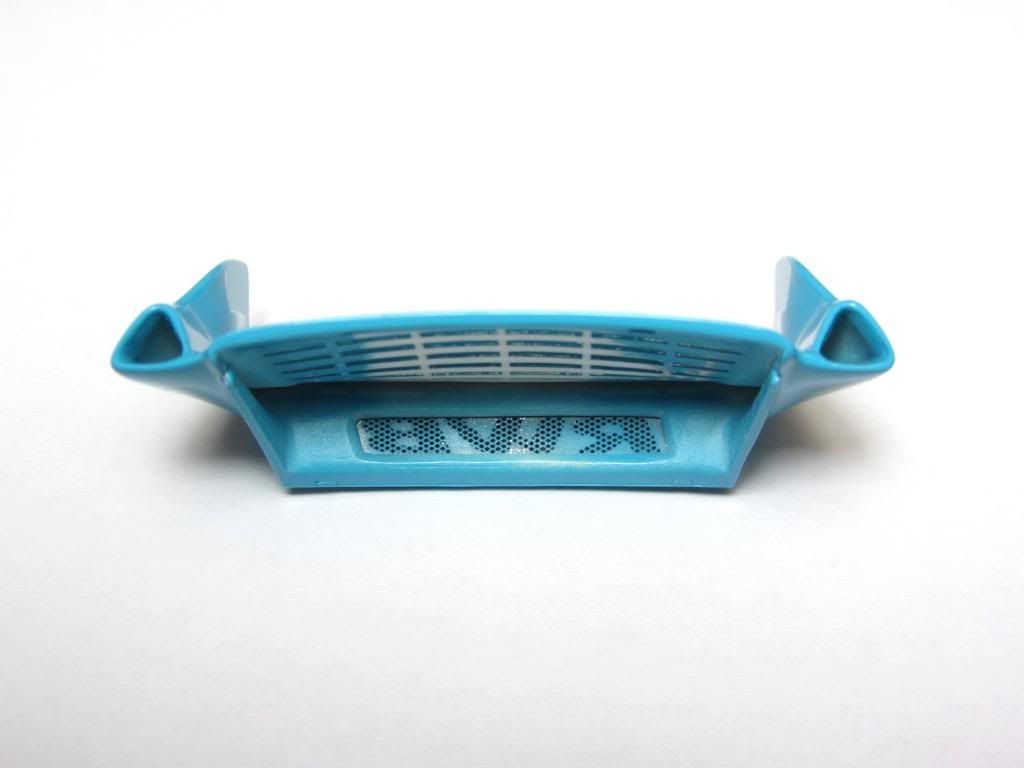

One thing I am having a problem understanding is how to mount the RWB mesh to the trunk lid, then how to paint it would getting the body color on the mesh portion. Do you have any ideas on this?

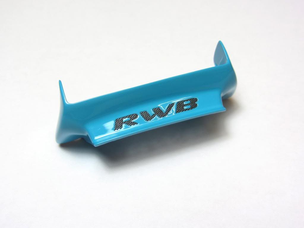

As for mounting the RWB mesh on the trunk lid I simply taped the piece of photo etch to the lid in the correct position then sprayed a light coat of black through it.
i then cut out where the letters were and permanently glued the etch to the trunk lid and blended it in with body putty.
Once priimed and painted I just got a fine paint brush and some Tamiya enamel and filled in the RWB lettering.

Wow! That looks trunk lid looks great. I started working with my trunk lid. I might have to take it apart and re-try after seeing how wonderful yours turned out.
