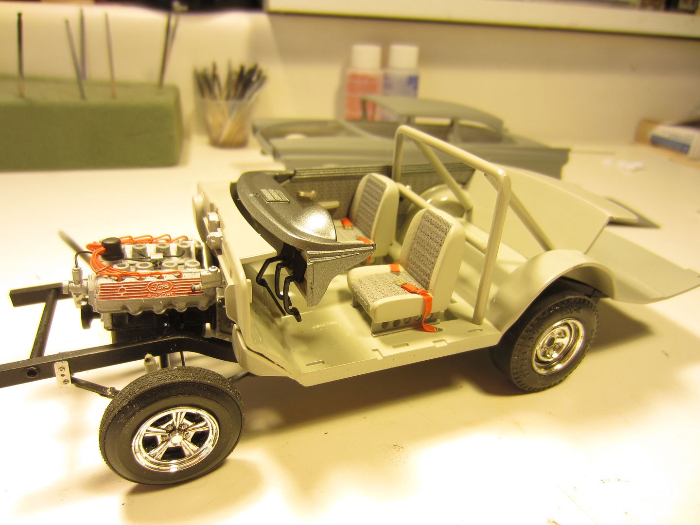

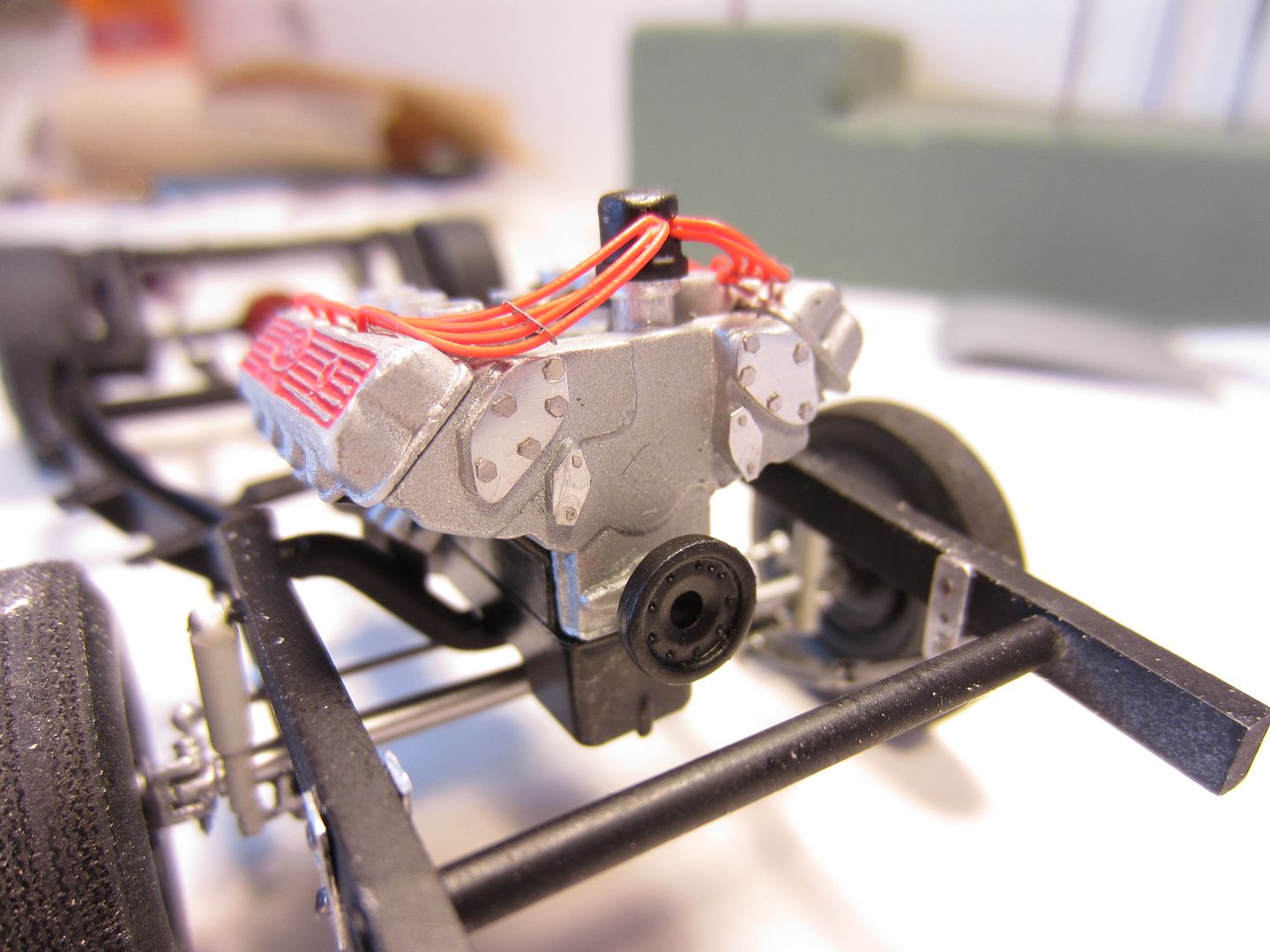

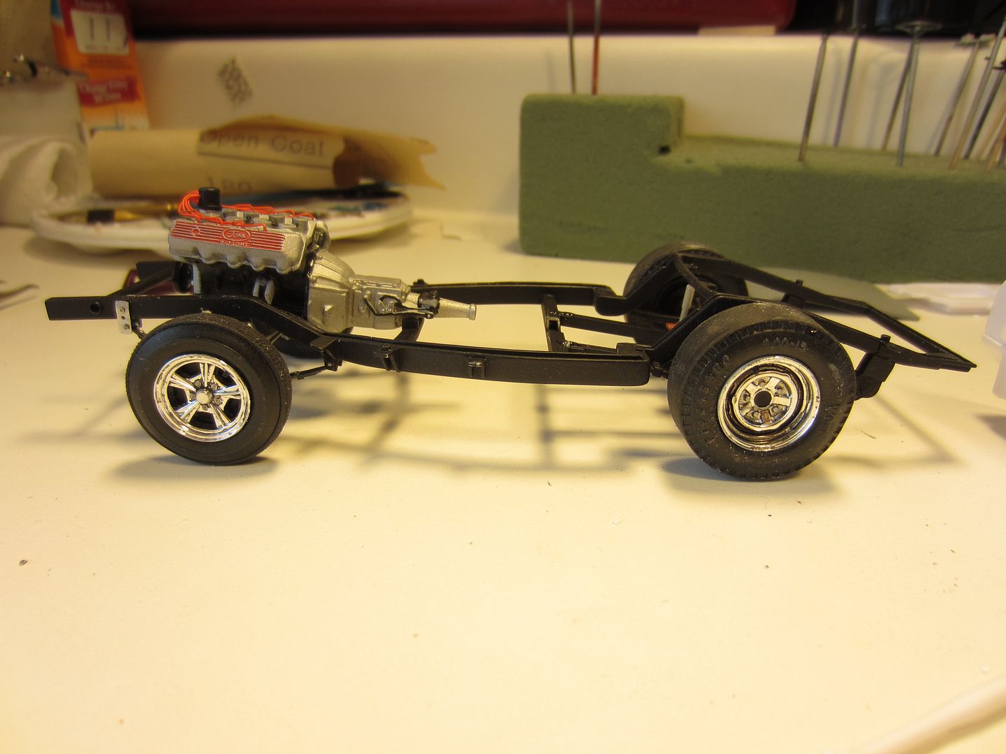

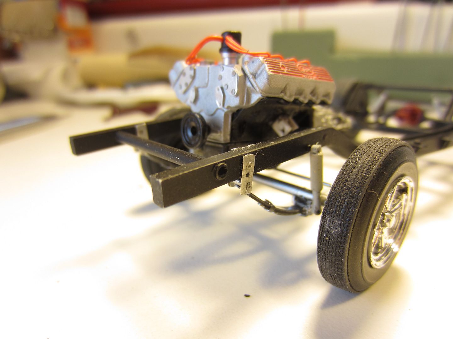

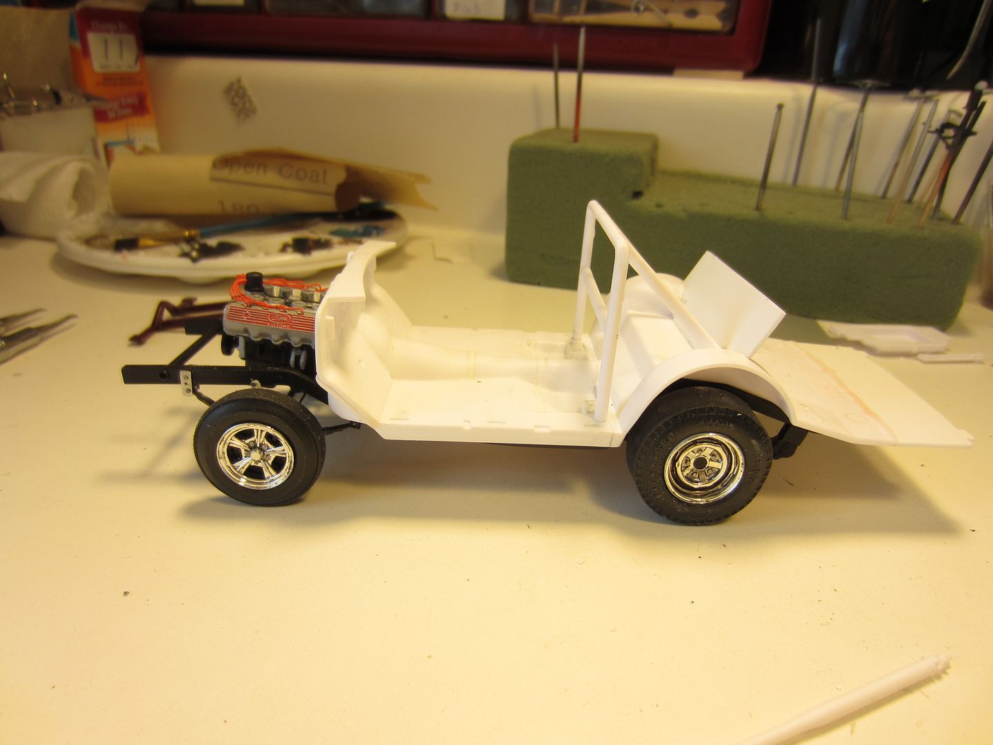

Ramcharger Posted March 2, 2014 Author Posted March 2, 2014 More progress, I Dullcoated the seats and interior side panels, so they are drying. I wired the magneto and joined the block and trans, built some motor mounts. I didn't like the gap between the motor and the stock mounts, so I made some, they still need painted. I scratch built a roll bar out of sprue, it needs a little sanding to look good. I've got a couple of more interior details to work out tonight and I have to shorten the drive shaft a little. The next big project will be building some headers, ugh, I hate building headers! Here's some photos of this morning's progress, I'm taking a break for a few hours!

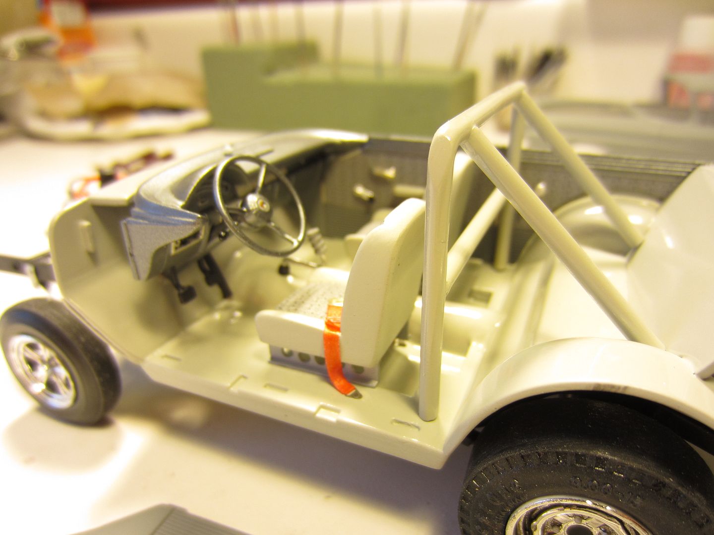

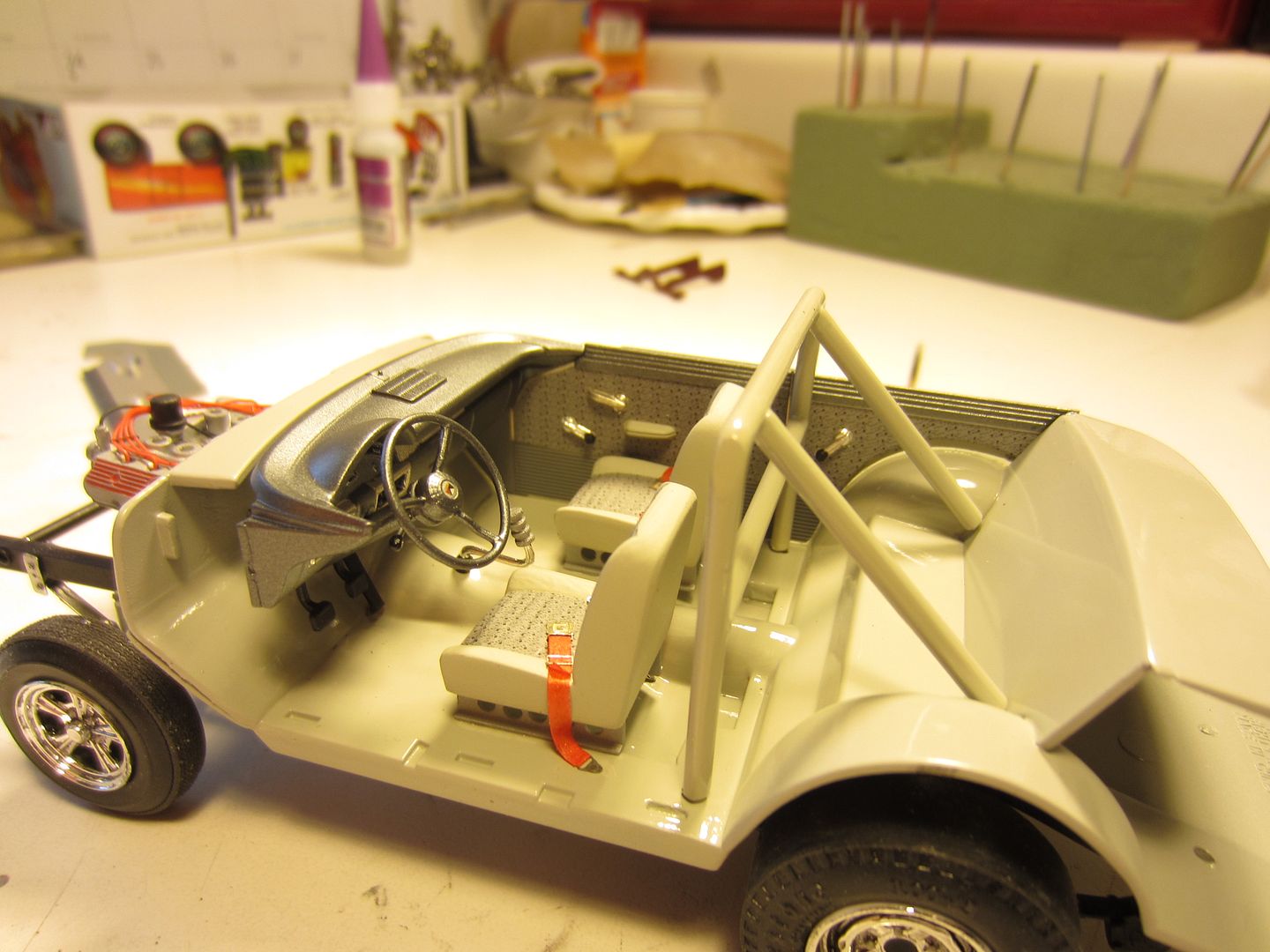

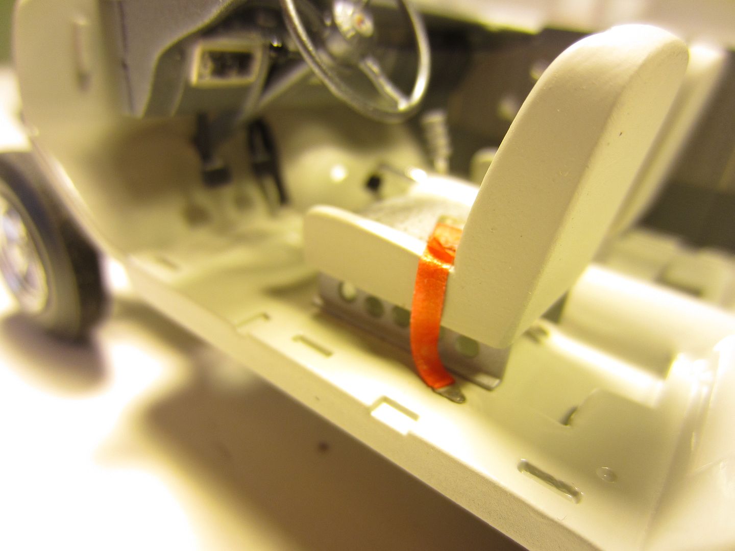

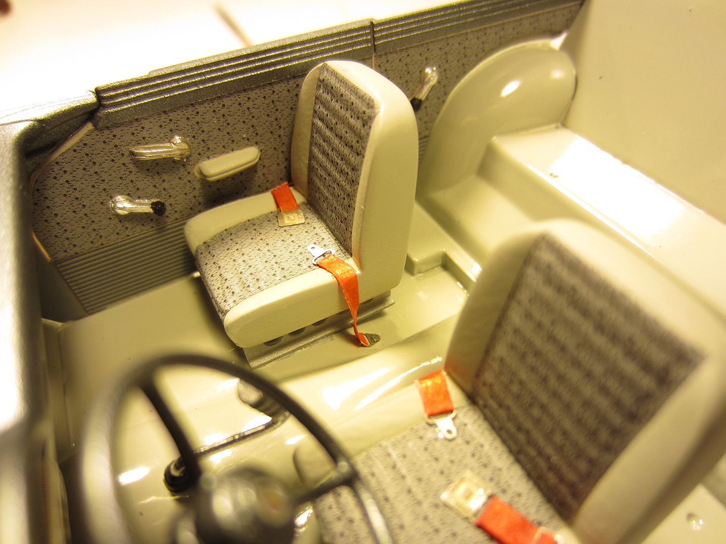

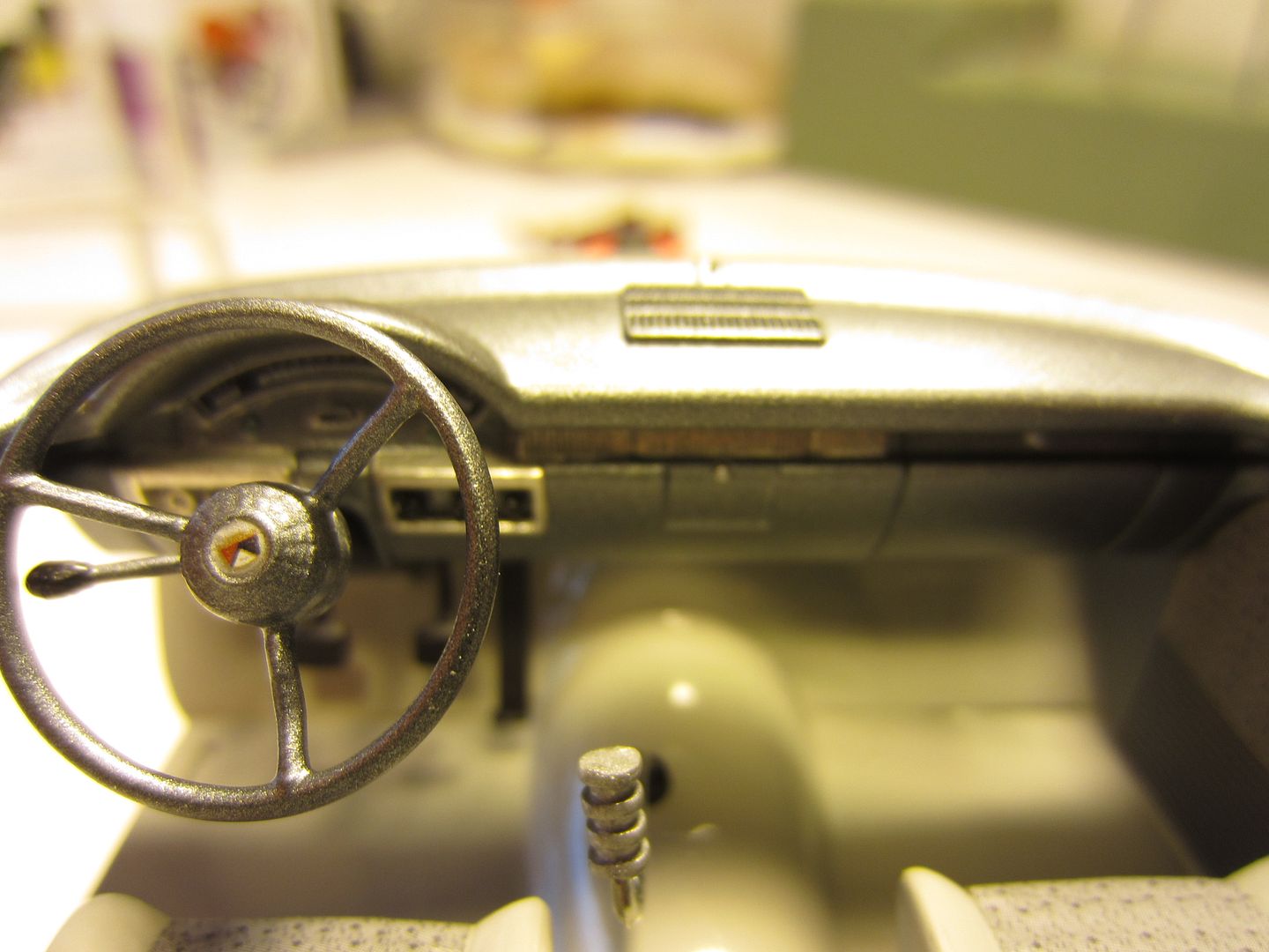

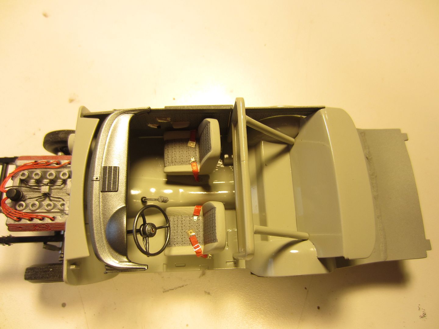

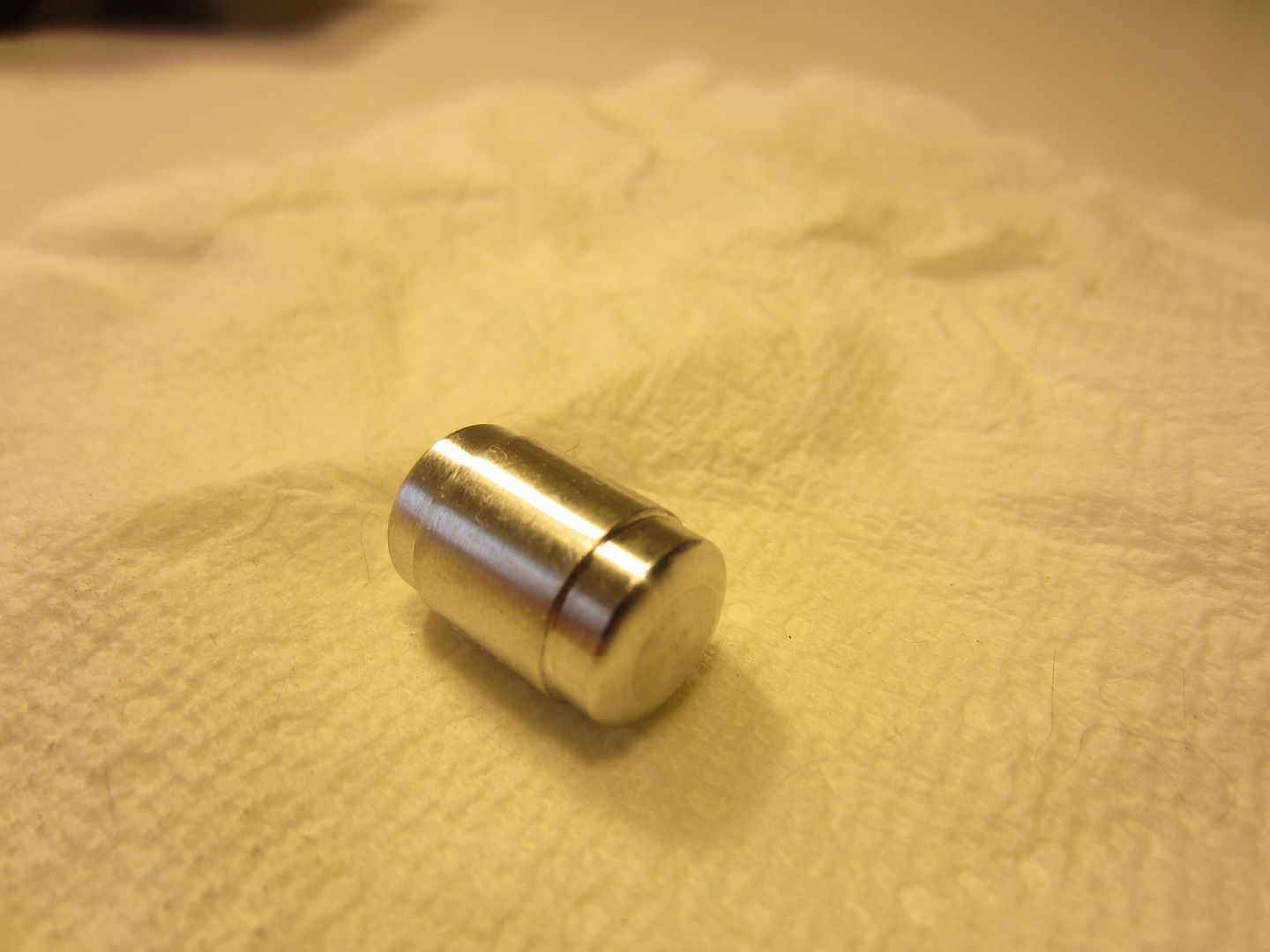

Ramcharger Posted March 8, 2014 Author Posted March 8, 2014 Thanks for the encouragement, guys! I hope to get her done for our contest in 2 weeks, I'm running out of time quick! Here's the interior, I added seat belts and a roll bar. I would have been smarter to start with the Fireball Roberts '57, it already has a roll bar in the kit. I also turned a "Moon" tank on my buddy's lathe the other night. Now to build some headers and then on to paint! I'll keep you guys posted.
Ramcharger Posted March 8, 2014 Author Posted March 8, 2014 More By the way, this was my first time using a lathe, guess what I'm saving up for.

rustybill1960 Posted March 10, 2014 Posted March 10, 2014 I really like your lathe work, very impressive!

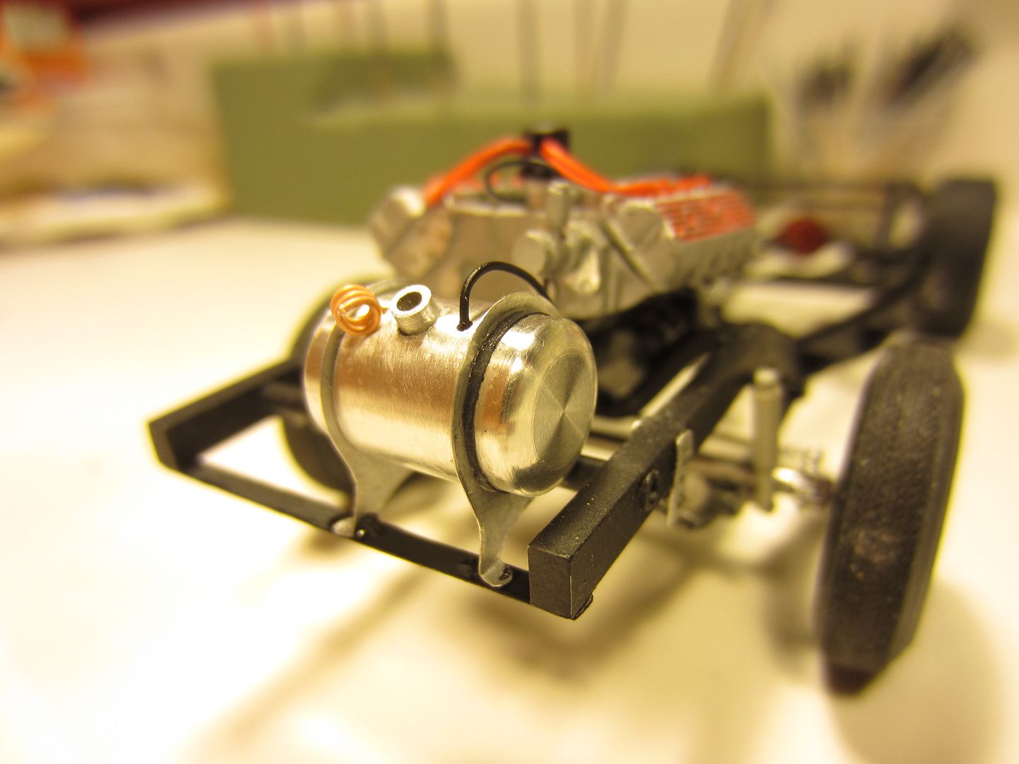

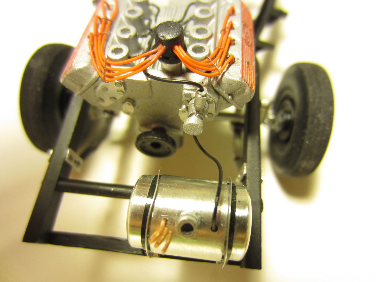

Ramcharger Posted March 12, 2014 Author Posted March 12, 2014 Thanks guys! Here's the fuel tank mounted up, I made the mounts out of a soda can and used electrical tape for the rubber gasket. I think the vent has too big of a coil now that I see it in a photo. I was going to use a wheel spinner for a gas cap but the body is too close so I'll just use a round cap. After I redo that vent tube, the headers are next, UGH!

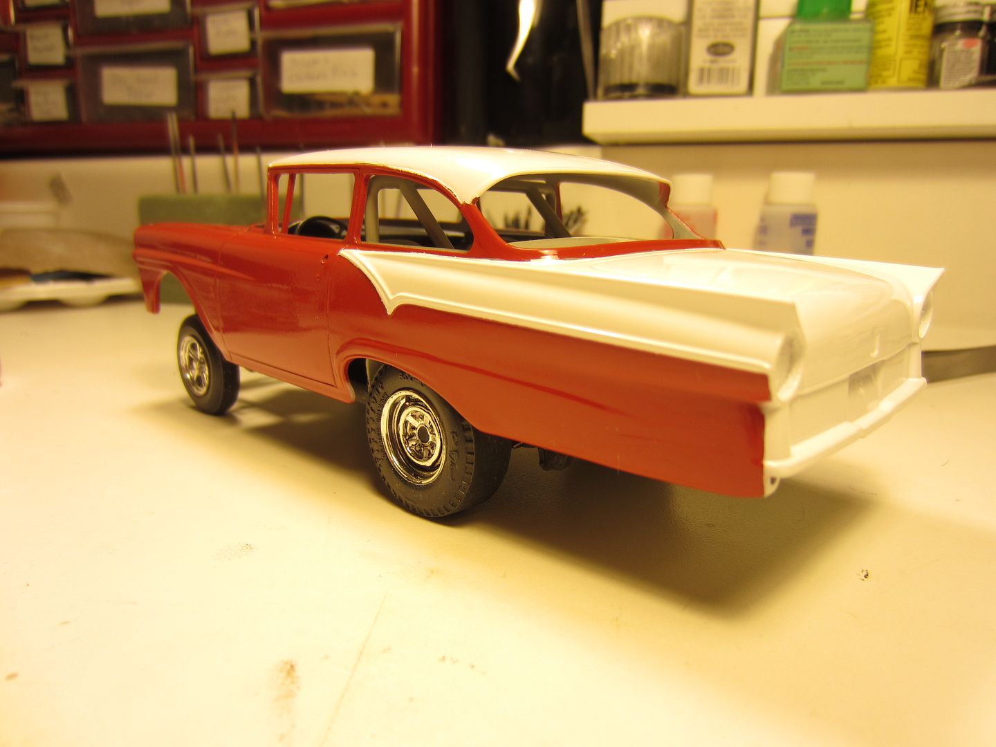

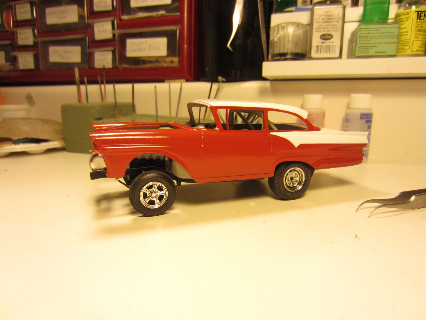

Ramcharger Posted March 18, 2014 Author Posted March 18, 2014 I finally got some paint on it, it need rubbed out. The red is Ford flame red and the top is Testor's white. It may actually make the contest!

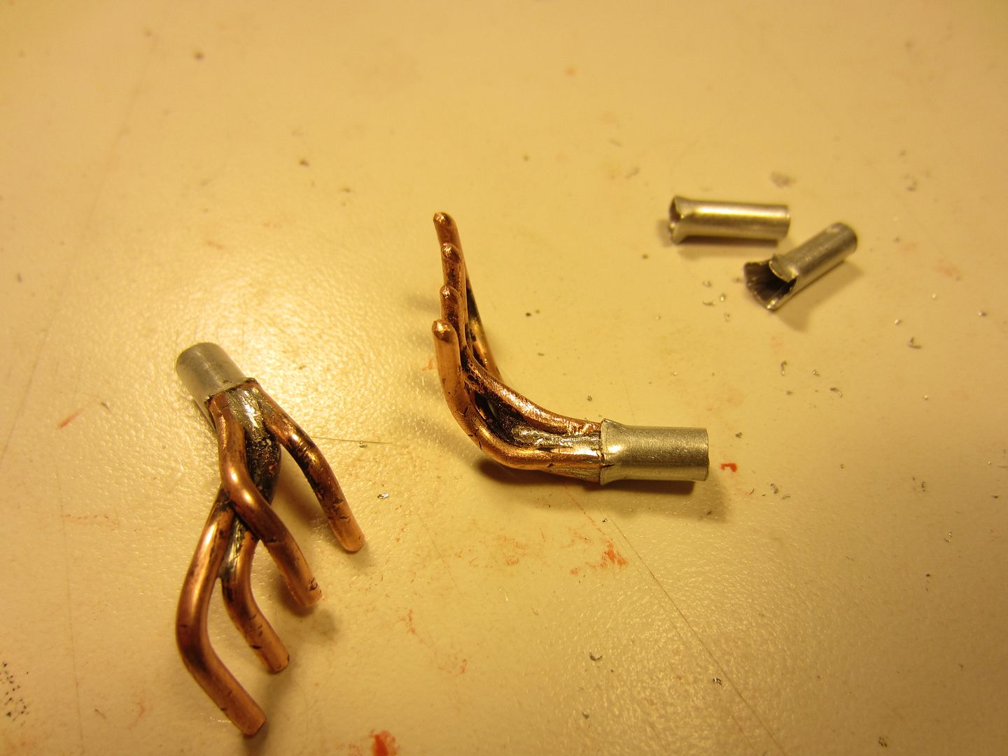

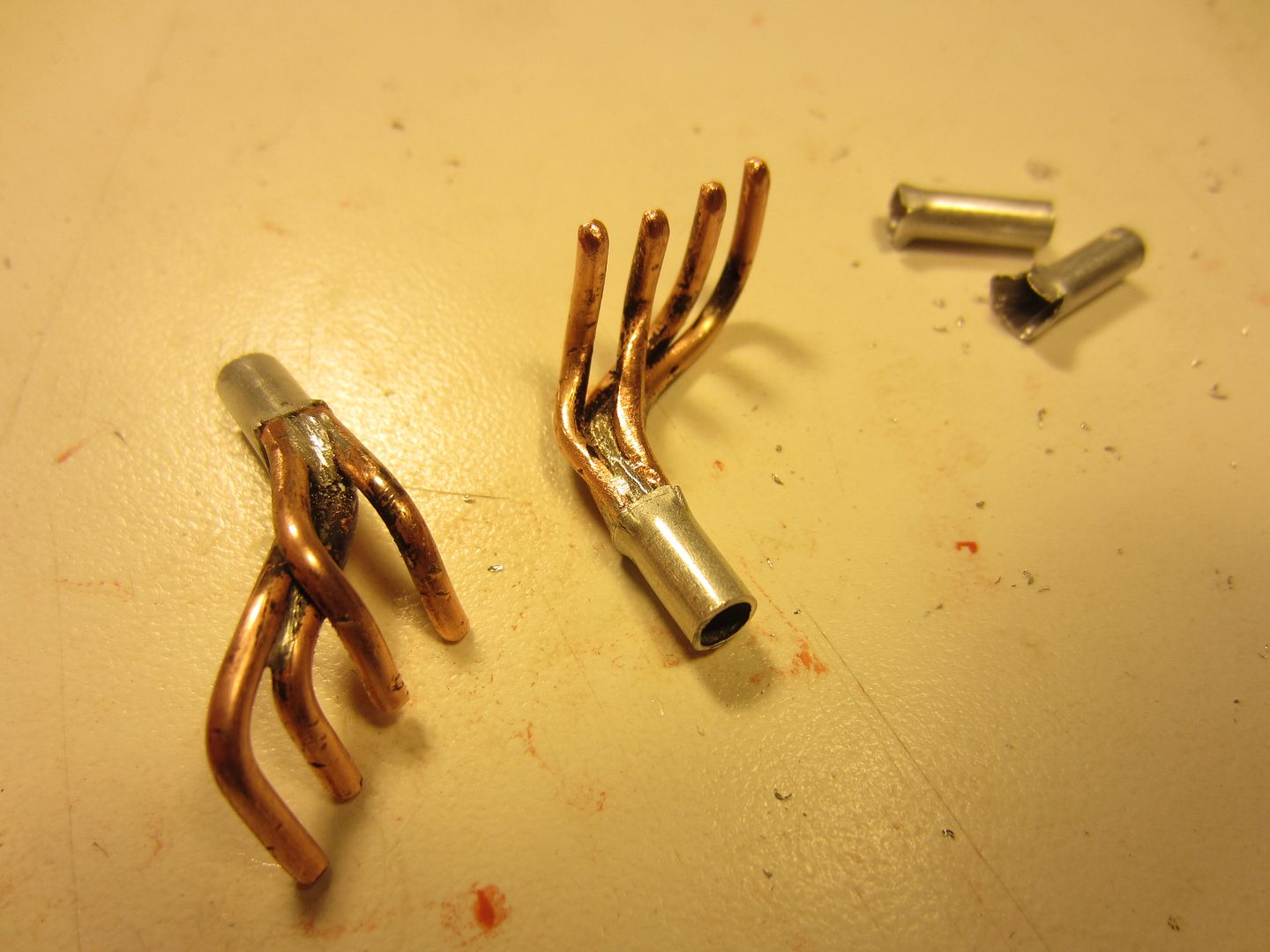

Ramcharger Posted March 20, 2014 Author Posted March 20, 2014 Thanks guys! I noticed some way cool avatar photos in this thread. I worked on the headers the last two nights, they are a, uh, problem that starts with a b to make! I couldn't find any appropriate sized solder, the only sizes I could find is .061 and .113 and I need .080 to work out to 2" tubes. 2" tubes seem to be the proper size to a full race "Cammer", 1 3/4" would probably pass, but that is about .070 in scale, can't find that either. I looked at wire and found I had some 12 ga copper electrical wire that specs out at .082, close enough, but really hard to bend and cut. So I just cowboyed up bent it to as close of a shape as I could. I still need to build collectors and flanges for the heads, then prime and paint. This guy is probably not going to make the Buckeye Classic, so I'll only have 1 57 Ford at the show. Oh well, close but no cigar. I'll finish her up next week, I should have more modeling time. I'll post photos of the headers before I paint them.

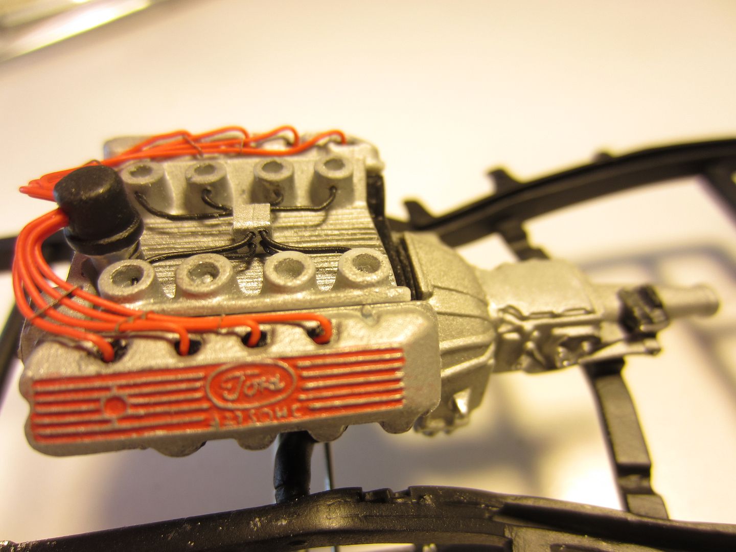

Ramcharger Posted March 25, 2014 Author Posted March 25, 2014 Unknown Hinson!! I thought about going, but life got in the way. Go ahead and cut one up, it's just plastic! They make more everyday. Here's a couple of in progress shots of the headers. I used 12 ga copper wire and silver soldered it for strength so I could bend and file it after they were together. BTW, it my first time soldering with a torch and my first time silver soldering, I think I was a little excessive. I then made collectors out of aluminum tubes that I flared out at the ends, the extras in the photos are casualties of experimentation. I'm smoothing the whole deal out right now while I'm drinking my coffee. I also wet sanded the body yesterday and went through the front fenders pretty bad so I reshot them yesterday. Since I missed the Buckeye Classic with this one, I'm shooting for the Detroit Show.
