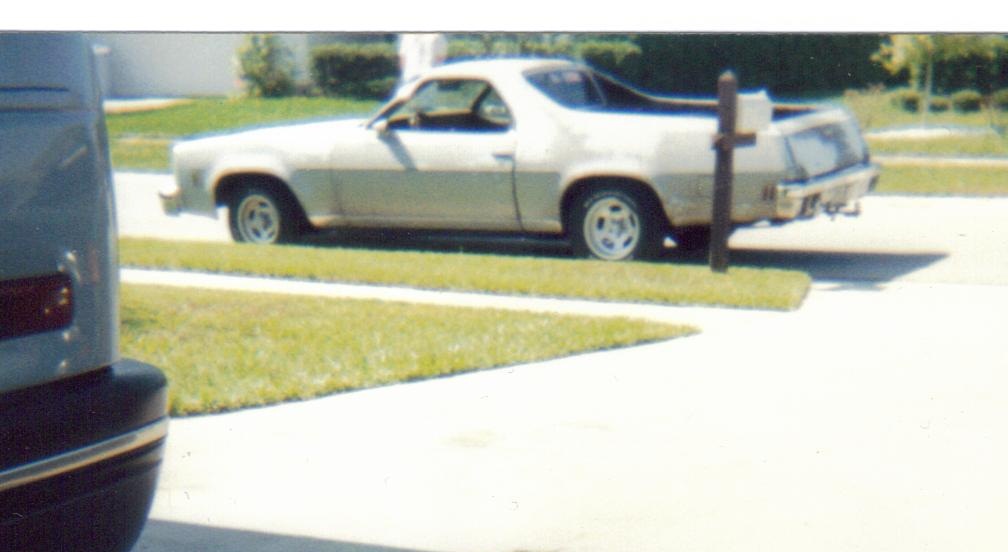

I've owned six El Caminos over the years and one of them was a '74 that I picked up as a wreck . After putting a '77 front clip on it and a fresh 350 it became my work truck for eight years . I always thought it was kind of ugly but it's size reminded me of my 1960 El Camino and it ended up being one of my favorites !
This is the best photo I have . It was still not painted when I sold it !
1974 El Camino

Impressive work, Bob. You really seem to have the dimensions nailed down on this one. Are you planning to do the original 74 front end, or duplicate the 77 nose that you installed? Really would love to see the 77 front end done. I own a 1:1 77 Malibu Classic, and one of my to-do's is to convert either the AMT or the MPC stocker into a duplicate of my 1:1.

Definitely going to be keeping an eye on this build. From your 60 El Camino build, I've seen what you're capable of. I'm assuming you will be starting out with an interior from the Revell 77 Monte, since that has the dash you will need? Can't tell from your pic of your Elco had swivel buckets or a bench seat, but the 77 Monte has the buckets if you need them, too.

Thanks Robert ! I don't no if this will compare to my '60 El Camino build but I'm going to give it a try .
I'm putting the '77 front on it using the headlights from the Monte Carlo kit . The grille on mine was a plain eggcrate with a Bowtie in the middle and I had painted it black , should be easy to fabricate one !
I plan on using that interior as a starting point , not really sure at this point . It did have the swivel buckets .
