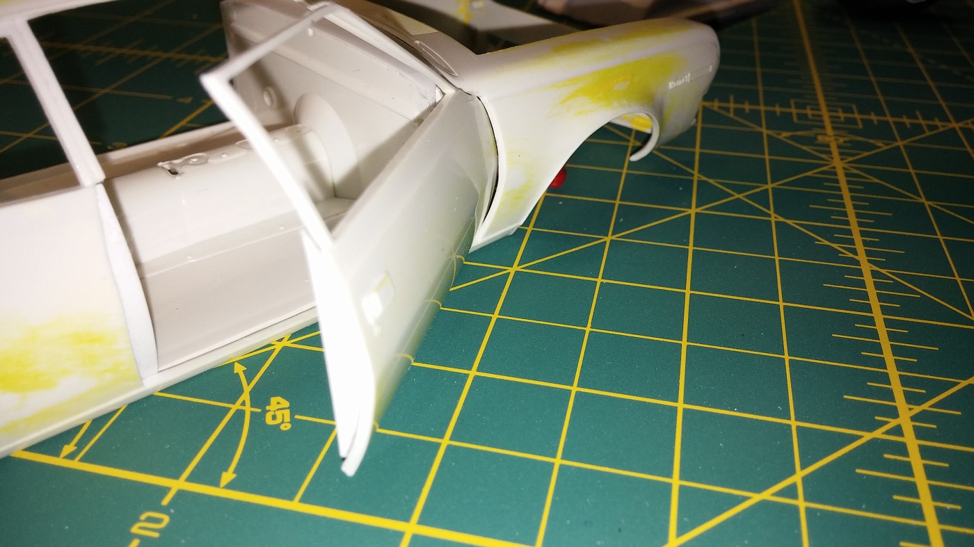

futurattraction Posted August 4, 2014 Posted August 4, 2014 What I was really wondering about is how far back from the leading edge of the door you usually place the hinges. I can see how that will affect the swing of the door when its opened in relation to the trailing edge of the fender, etc. Again, I know we're limited by what we're working with on any given build... Thanks. SP

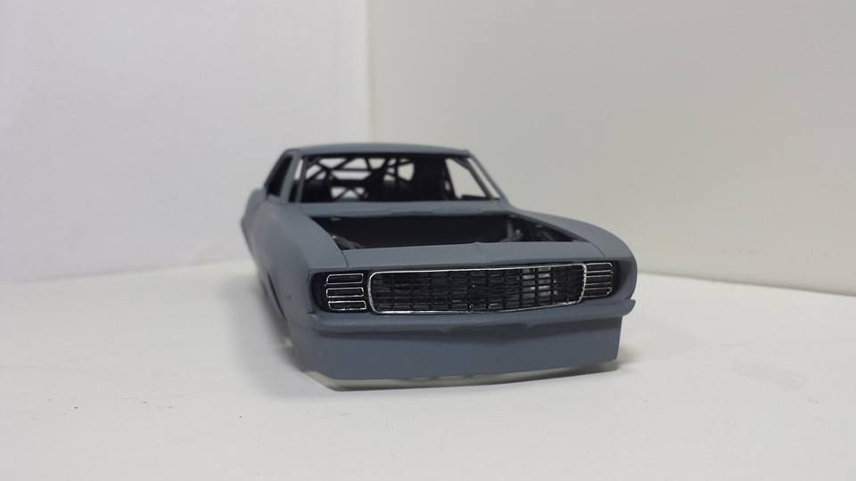

tyrone Posted August 4, 2014 Author Posted August 4, 2014 What I was really wondering about is how far back from the leading edge of the door you usually place the hinges. I can see how that will affect the swing of the door when its opened in relation to the trailing edge of the fender, etc. Again, I know we're limited by what we're working with on any given build... Thanks. SP Scott that usually depends on the build and the location of the bars, and firewall.. I usually try to get them pretty close.. but you are right about the swing of the door.. If they are too close to the where the door meets the fender there may be some issues with opening the doors.. here's a pic of the hinges on the Mustang I'm working on... and heres the camaro I'm doing now... you can see they are pretty much close to the same spot....

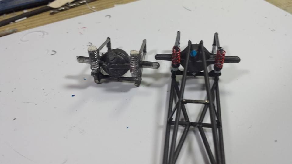

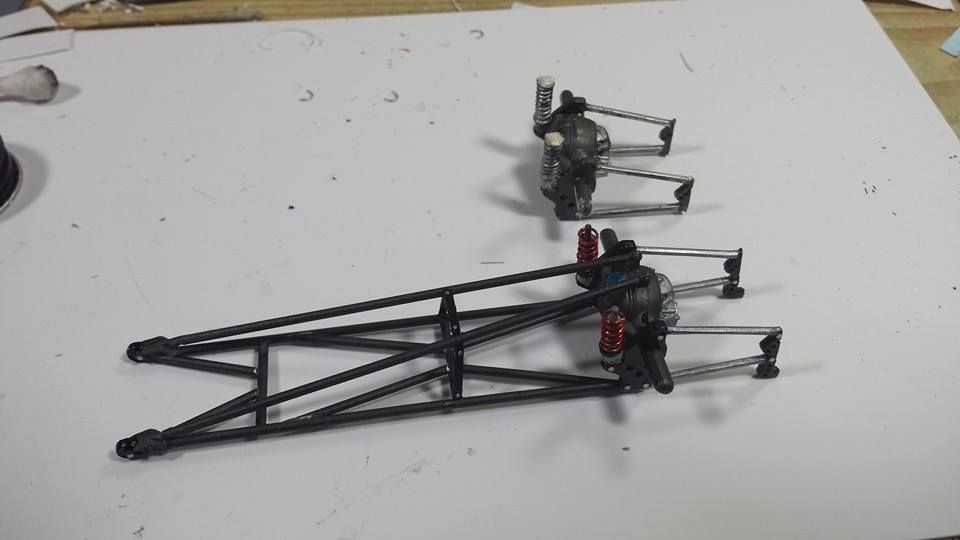

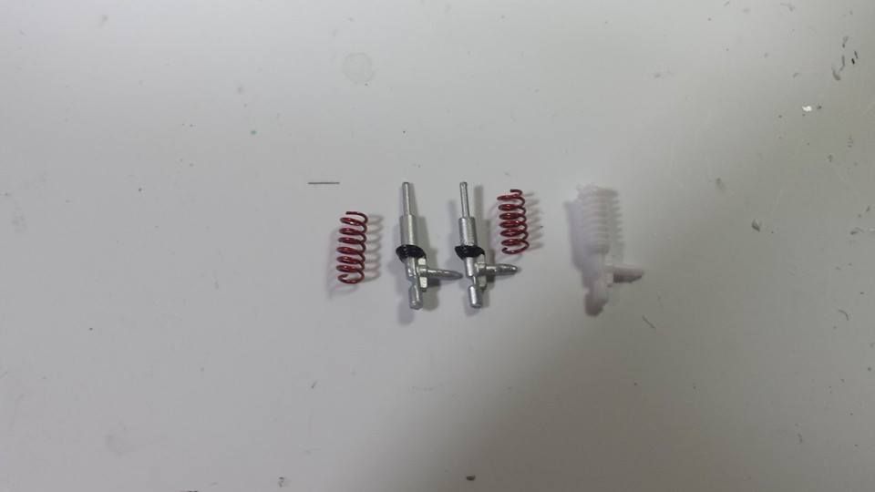

tyrone Posted August 12, 2014 Author Posted August 12, 2014 Thanks fellas for all the kind words... well I'm back from much needed vacation.. and I got a little time in at the bench today before going back to work tomorrow... I got the front and rear coil springs, done... and I also got the rear springs done added bolt head detail to the 4-link mounts, wheelie bars wheels, and braces for the wheelie bars..

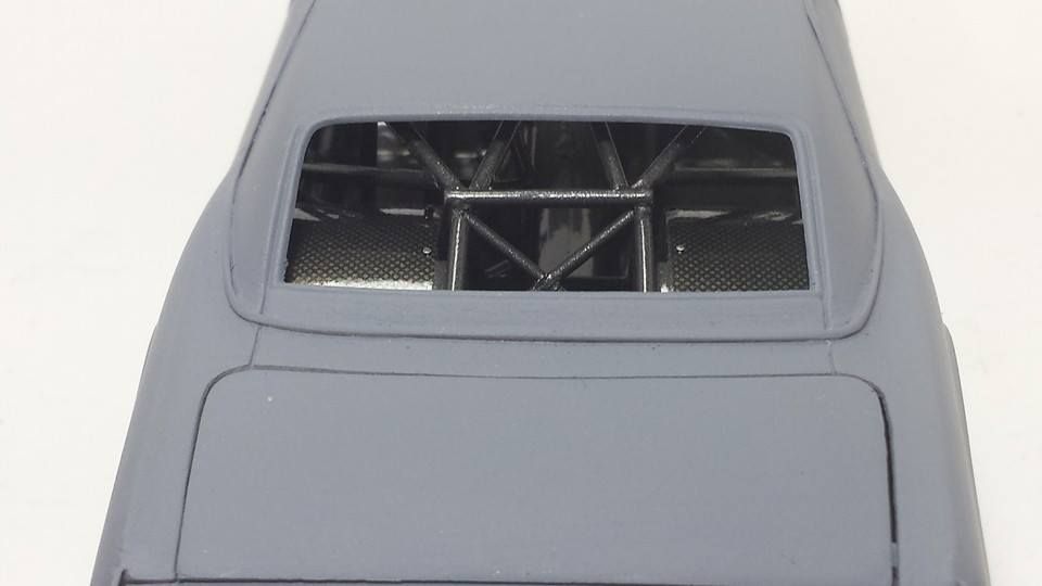

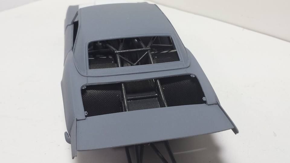

tyrone Posted August 12, 2014 Author Posted August 12, 2014 I've also added carbon fiber decals to the rear wheel tubbs, and added rivet head detail.. I got the chassis clear coated too... and I started making the cowl induction hood from sheet styrene... thanks for looking and comments welcome...

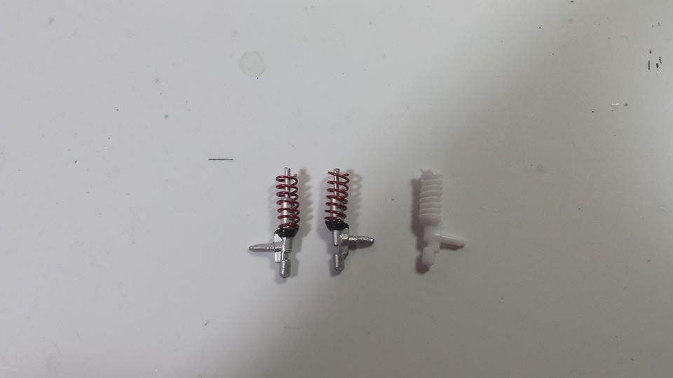

1 bad55 stan Posted August 12, 2014 Posted August 12, 2014 Looking awesome Tyrone,Are the struts and springs scratch built? they look great! as does the whole build..
tyrone Posted August 12, 2014 Author Posted August 12, 2014 Looking awesome Tyrone,Are the struts and springs scratch built? they look great! as does the whole build.. Thanks Stan.. the front struts are the ones from the pro sportman kit, I cut the cast spring part off and just use the lower part of the strut.. I then drill a hole down through the center of the lower strut piece and install a piece of styrene rod .035 and a dab of glue to hold it in place.. then I take a piece of styrene tube and slide it down over the styrene rod and trim it to look like the strut body... coil springs were made by using a small piece of wire wrapped around a piece of styrene tubing..

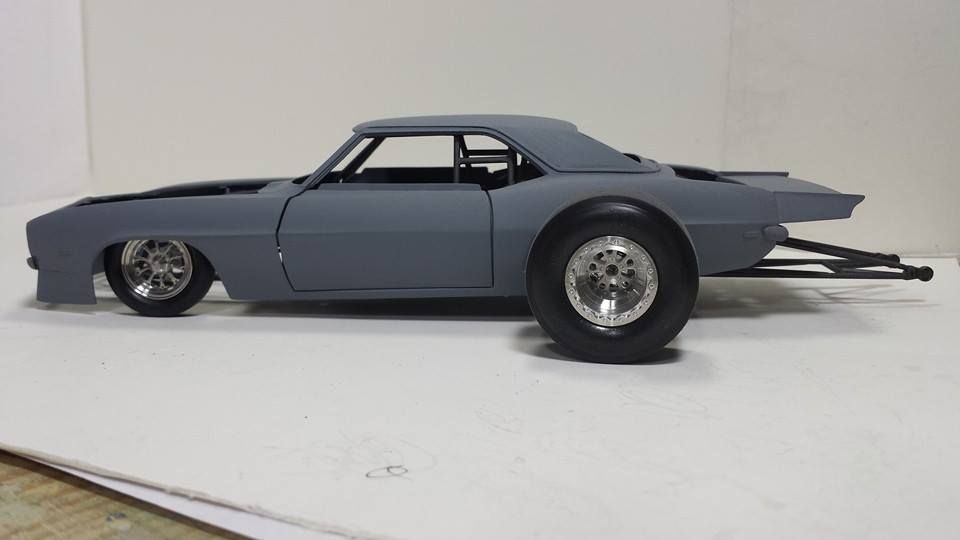

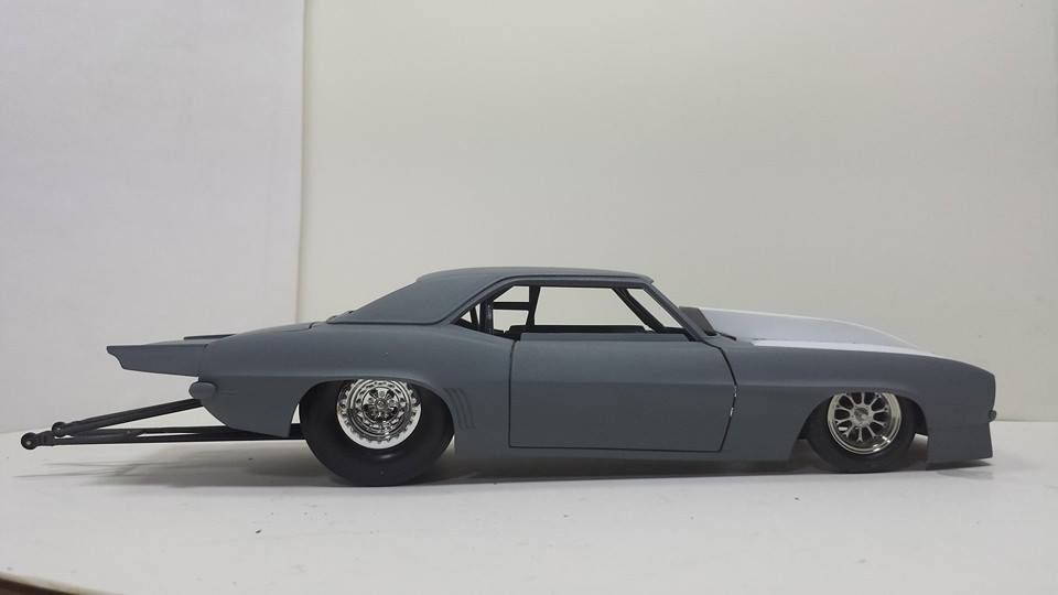

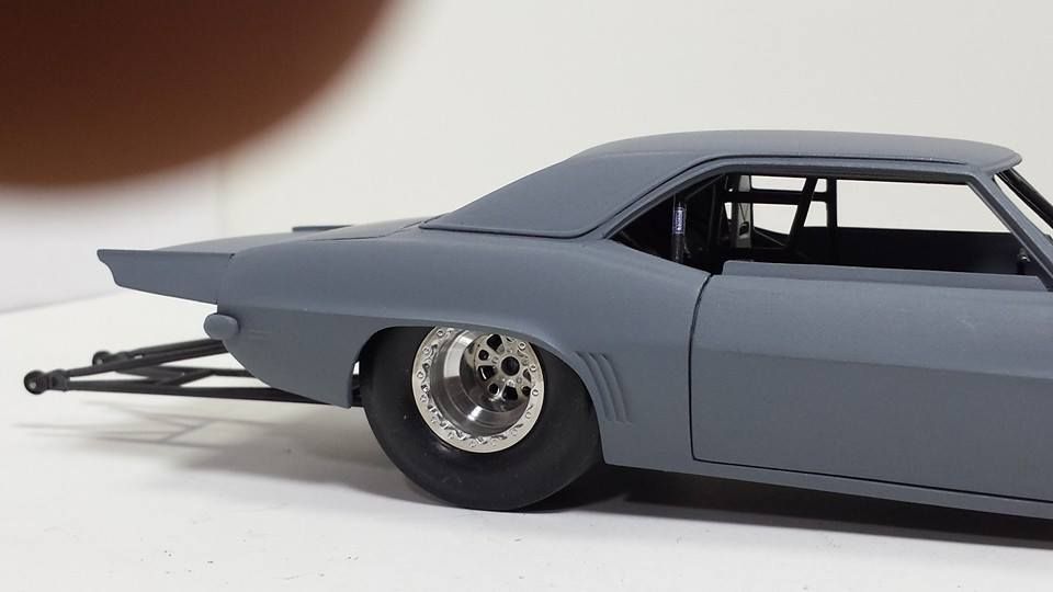

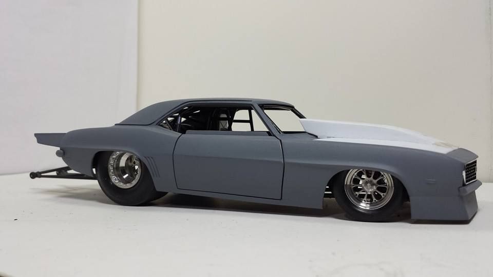

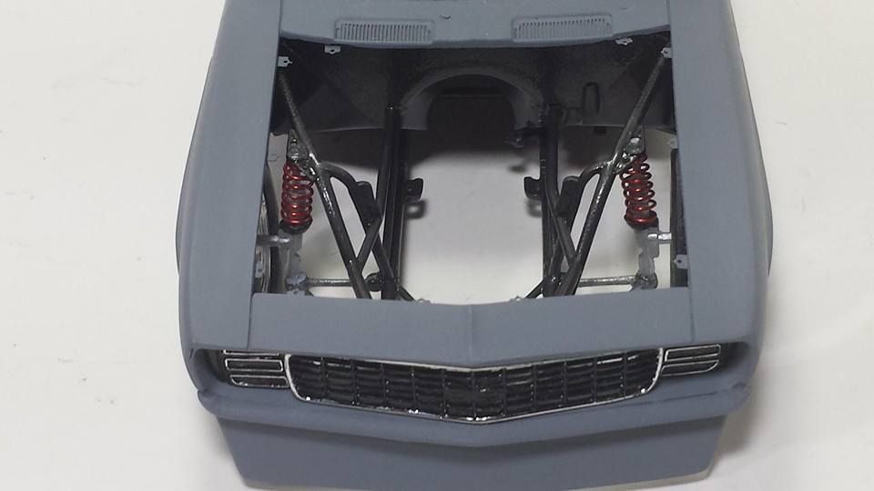

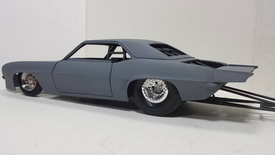

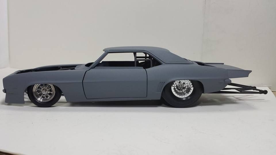

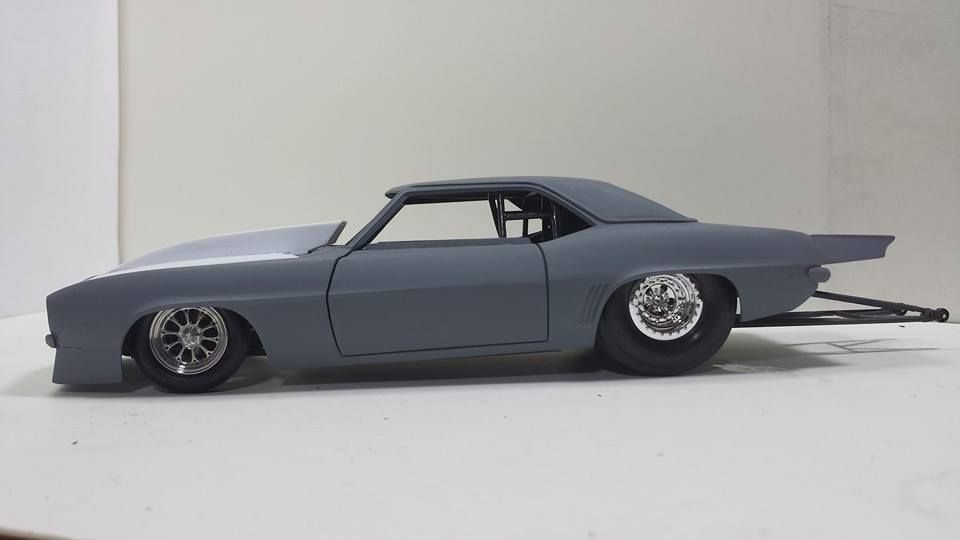

tyrone Posted August 13, 2014 Author Posted August 13, 2014 Thanks fellas... didnt get a whole lot done tonight.. I did manage to get the rack and pinion installed, and spent most of the night working on the cowl hood, it's about ready for primer.. I also stuck the rear wheels on there and took a few pics... Jim's wheels are wicked... I think they are just a tad bit to deep though... Jim is making me some new ones... thanks for looking and comments welcome... excuse my finger...lol..

futurattraction Posted August 13, 2014 Posted August 13, 2014 Those rear wheels are gorgeous, even if they may be a bit wider than you want them to be. Everything's looking great, Tyrone!
