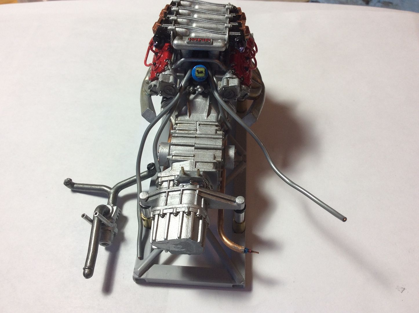

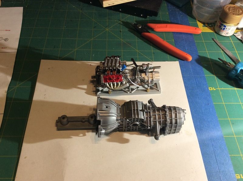

Twokidsnosleep Posted March 29, 2015 Share Posted March 29, 2015 (edited) Did you know a 1/8 engine is a lot bigger than a 1/16???? I am absolutely not building the Pocher F40 engine, I am just ensuring that the parts are there and they fit. Fun part is they go together like a jigsaw puzzle without cement, so I can pull it apart easily. Have kinda stalled on the Fujimi F 40.... Just dicking around with exhaust stains. I should have Alclad my exhaust pipes this afternoon, but I had a nap instead Edited March 29, 2015 by Twokidsnosleep Quote Link to comment Share on other sites More sharing options...
Toast Posted March 29, 2015 Share Posted March 29, 2015 That's like when I put the 1/12 engine next to my 1/24! I started another house project so progress on the Lamborghini has slowed. But running up to the hobby shop today to get some supplies, so hopefully when I do get time at the bench I can get lots done. Quote Link to comment Share on other sites More sharing options...

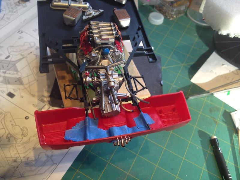

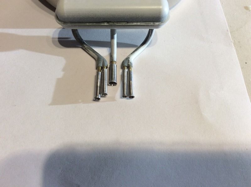

Twokidsnosleep Posted March 29, 2015 Share Posted March 29, 2015 Ok, waddya think of this I want to do metal (aluminium) exhaust tips as the plastic ones are cheesy even drilled out...the plastic chips as I try to flare out the ends So I thought of this arrangement in a bit of a delta pattern Any opinions?? Can you tell it is a gross rainy day here and I have a hundred things I am supposed to be doing Quote Link to comment Share on other sites More sharing options...

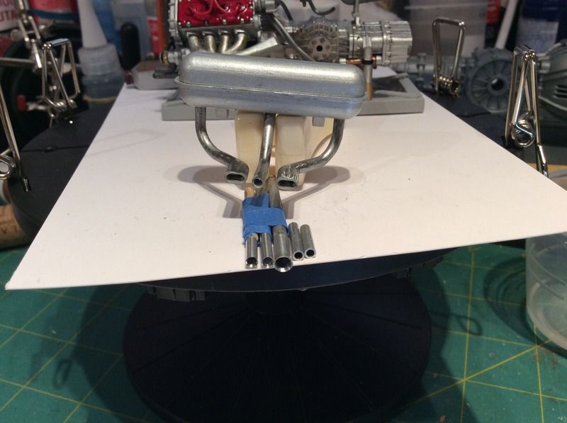

Twokidsnosleep Posted March 30, 2015 Share Posted March 30, 2015 (edited) Ok, Tonight I flared out some aluminum pipe for the middle and one side of the exhaust. Used trimmed shishkabob skewers as a mandrel that I chucked into the Dremel. Then a dental diamond and polishers to shape. Flared with more wood skewers tapped in. Here are three pipes on their mandrels and the assorted polishers There will be five pipes total...should look kinda cool. Might even torch them with heat to see if I can patina the aluminum.....or melt it and wreck everything. I know it is not Ferrari spec and deviates from gas monkey guys Let me know what you think, I am going to bed Edited March 30, 2015 by Twokidsnosleep Quote Link to comment Share on other sites More sharing options...
Toast Posted March 31, 2015 Share Posted March 31, 2015 If you're doing a custom F40, do a custom F40. I think it looks cool! Quote Link to comment Share on other sites More sharing options...

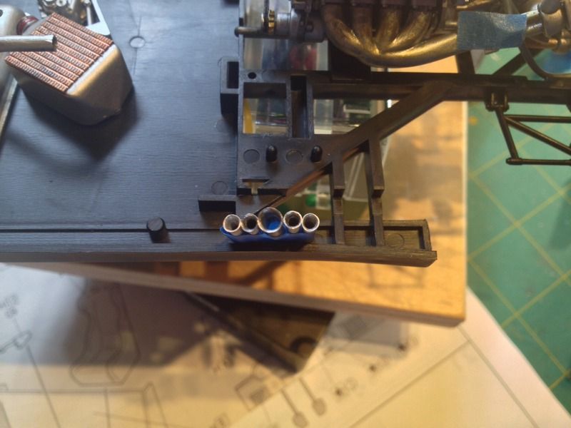

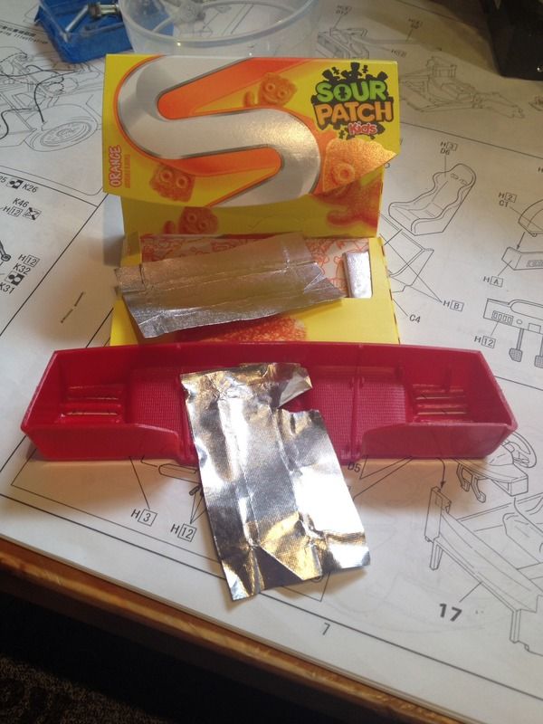

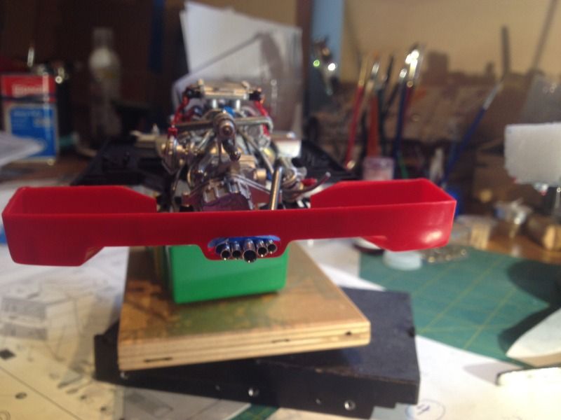

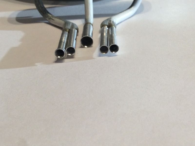

Twokidsnosleep Posted April 25, 2015 Share Posted April 25, 2015 (edited) Did a little F40 work, got the five pipe tips done Mock up into rear splitter to test fit I have been working my way through this horrible gum to get to its wrapper that will make a great heat shield for the inside of the splitter......one more stick to go Edited April 25, 2015 by Twokidsnosleep Quote Link to comment Share on other sites More sharing options...
Toast Posted April 26, 2015 Share Posted April 26, 2015 Looking sweet! Good to see some progress in this thread. :-) Quote Link to comment Share on other sites More sharing options...

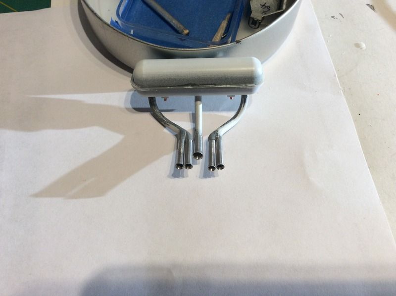

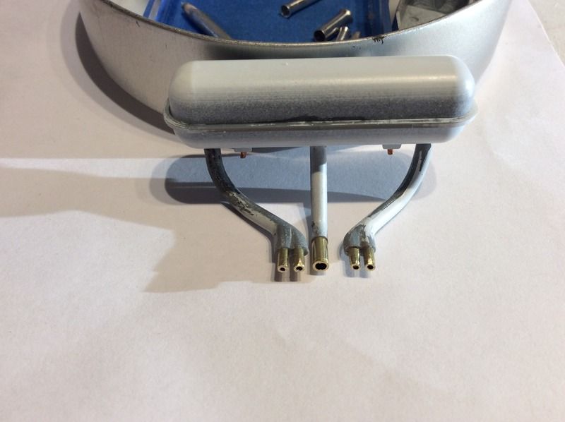

Twokidsnosleep Posted April 28, 2015 Share Posted April 28, 2015 (edited) More exhaust pipe work Brass pins and sleeves CA glued into holes drilled into the trimmed stock plastic pipes Trial fit of the aluminum tips that slide onto those sleeves.....still to be cut to length My next task is conquering the Alclad Chrome monster and get this painted Edited April 29, 2015 by Twokidsnosleep Quote Link to comment Share on other sites More sharing options...
Kennyboy Posted April 29, 2015 Share Posted April 29, 2015 Hey Scott.......no need to eat bad tasting gum to get the foil. Look online at Michael's or just Google Fancy Foil......comes in a roll that would last a modeler a lifetime! Costs like $10.00 U.S. Quote Link to comment Share on other sites More sharing options...
Twokidsnosleep Posted April 29, 2015 Share Posted April 29, 2015 Hey Scott.......no need to eat bad tasting gum to get the foil. Look online at Michael's or just Google Fancy Foil......comes in a roll that would last a modeler a lifetime! Costs like $10.00 U.S. I was just being silly, all a bit tongue in cheek.....but it is perfect for the application. I could have just tossed the gum out Will have to go see Michaels for that foil and for the braided cord in the beading section someone mentioned elsewhere Quote Link to comment Share on other sites More sharing options...
Toast Posted April 29, 2015 Share Posted April 29, 2015 Don't know if "fancy foil" is what i got but I picked up a roll of foil used as a base for cakes. Think of a roll of Christmas wrapping paper amout of foil! Quote Link to comment Share on other sites More sharing options...
Kennyboy Posted April 29, 2015 Share Posted April 29, 2015 Don't know if "fancy foil" is what i got but I picked up a roll of foil used as a base for cakes. Think of a roll of Christmas wrapping paper amout of foil! Yep Ryan that sounds like the stuff! I was just being silly, all a bit tongue in cheek.....but it is perfect for the application. I could have just tossed the gum out Will have to go see Michaels for that foil and for the braided cord in the beading section someone mentioned elsewhere This stuff is awesome Michael Quote Link to comment Share on other sites More sharing options...
Belugawrx Posted May 1, 2015 Share Posted May 1, 2015 Hey Scott.......no need to eat bad tasting gum to get the foil. Look online at Michael's or just Google Fancy Foil......comes in a roll that would last a modeler a lifetime! Costs like $10.00 U.S. or... Do you have a friend that smokes? ciggy packs have approx. 30 sq." in 'em Quote Link to comment Share on other sites More sharing options...

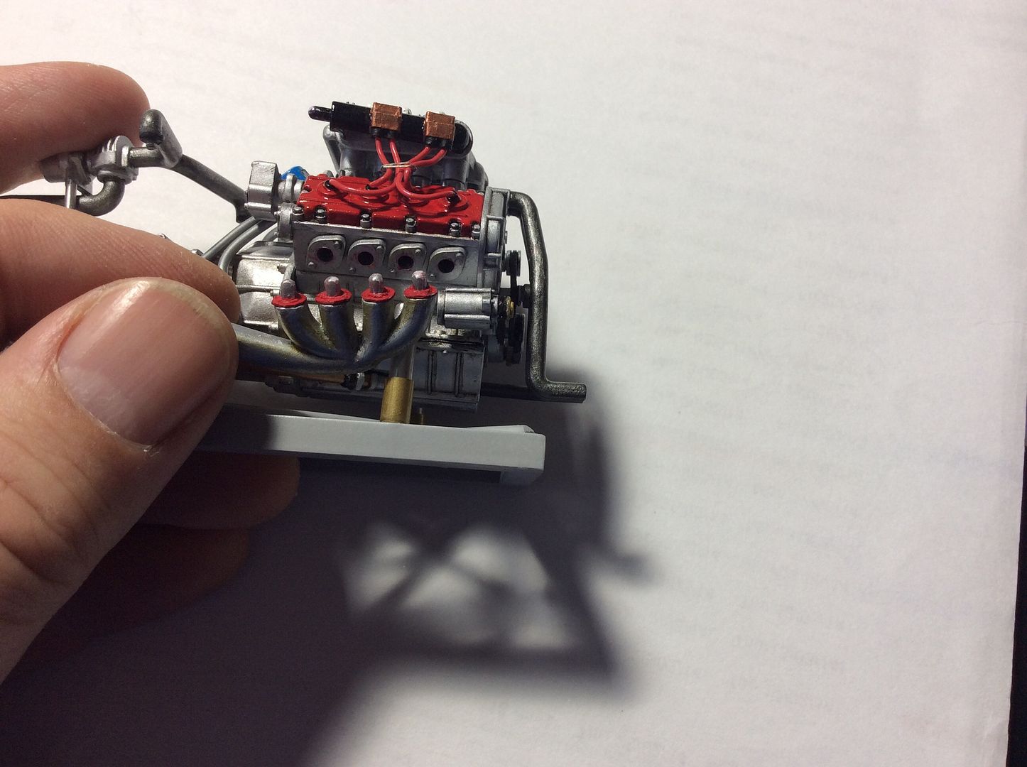

Twokidsnosleep Posted August 19, 2015 Share Posted August 19, 2015 (edited) Hi gents, just checking in on the Fujimi Crew We have settled into rental house and I have a shared spare bedroom for modelling and wife's office. The only model damage to the move was on the F40, the styrene supports for the turbo inlets. So I did some brass pins and used aluminum tubes to replace them I also made some red gaskets for the headers to close the gaps and look cool will try to get moving on this and stop showing the same photos of barely any progress Edited August 25, 2015 by Twokidsnosleep Quote Link to comment Share on other sites More sharing options...
