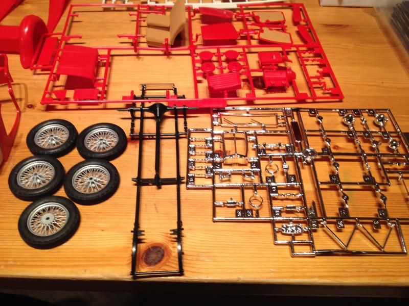

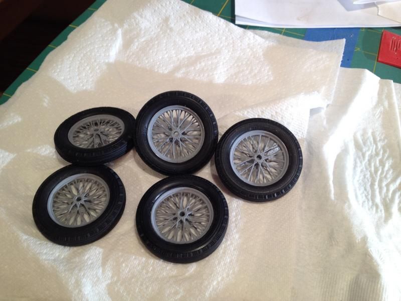

Twokidsnosleep Posted December 18, 2014 Posted December 18, 2014 (edited) Reposting a lost build thread of mine, I have waited a week to make sure the site settled into the new server. This is for the better as I can put it into the Big Boys where it belongs, but I am sorry to lose the comments and help that I had received from you guys, so please feel free to reply again! And here we go The kit as it came to me for $30 CAD ] Wheels and sprues...some items were started and painted but you expect that in an abandoned kit on sale The biggest surprise was the bonnet...a ton of CA glue and a bit of a mess My plan is to restore this car to how I would want one. I will disassemble everything I can that won't damage the kit. I have some plans for exhaust system, engine and interior leather work Leaving it here to get some office work done before I have to fire myself Cheers, Scott Edited December 18, 2014 by Twokidsnosleep Quote
sjordan2 Posted December 18, 2014 Posted December 18, 2014 (edited) Those kit wire wheels look unusually nice. What's the outside diameter of the rims? They may be a good substitute for the somewhat klunky wires on the 1/16 Jaguar SS 100. Edited December 18, 2014 by sjordan2 Quote
Twokidsnosleep Posted December 18, 2014 Author Posted December 18, 2014 (edited) Those kit wire wheels look unusually nice. What's the outside diameter of the rims? They may be a good substitute for the somewhat klunky wires on the 1/16 Jaguar SS 100. I will have to check....will get back to you later They are plastic moulded by the way We had a discussion on another thread about making metal spokes, I will try to find it ahh here it is, Harry P's gorgeous 1928 Mercedes build thread, wheel construction on pg 1 http://www.modelcarsmag.com/forums/index.php?showtopic=94816&page=1 Edited December 18, 2014 by Twokidsnosleep Quote

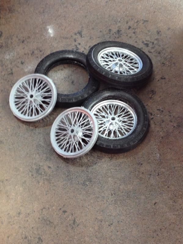

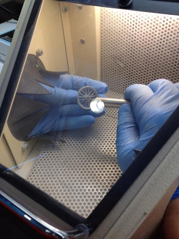

Twokidsnosleep Posted December 18, 2014 Author Posted December 18, 2014 (edited) Maybe I will skip forward a bit and show what I did to my wheels now I have a particle sand blaster at work I use to clean the internals of dental crowns etc. Decided to try and strip the hand painted wheels with it so as to not damage the spokes. Of all the work that was done before I got the kit, I think the spoke painting was actually fairly decent...but hopefully I can maker them even better Inside the blaster Halfway done Finished and mounted The sandblaster leaves a nice rough matt surface that I can now spray and I hope to get good clean spokes Edited December 18, 2014 by Twokidsnosleep Quote

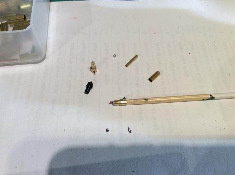

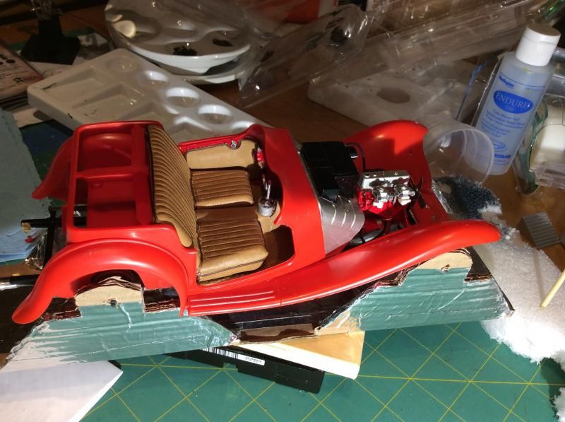

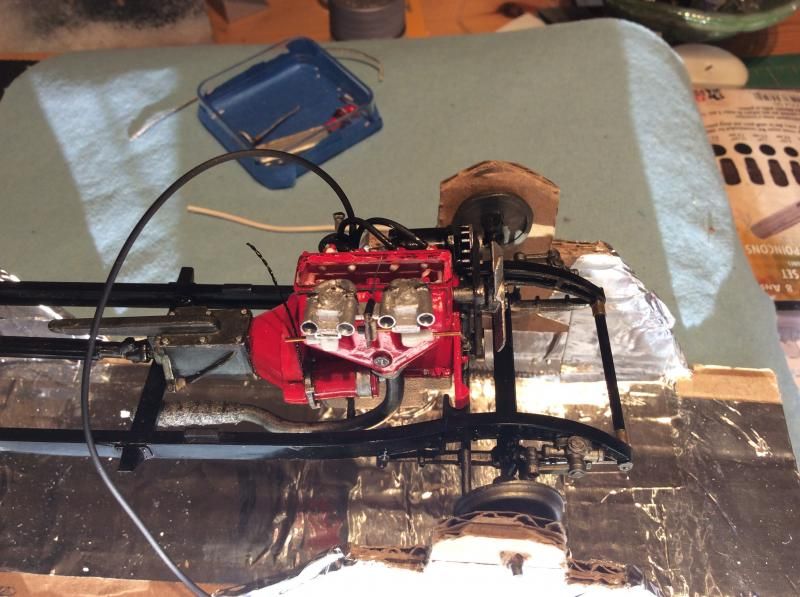

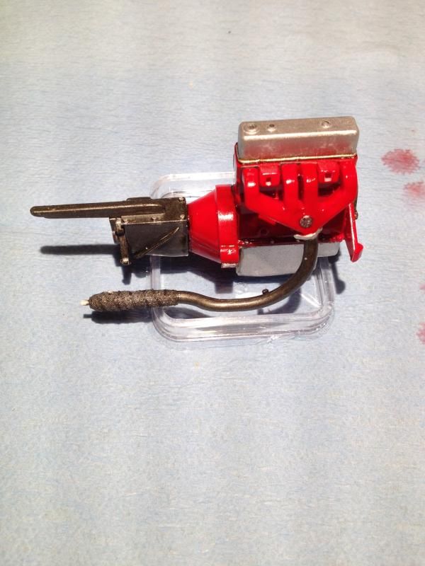

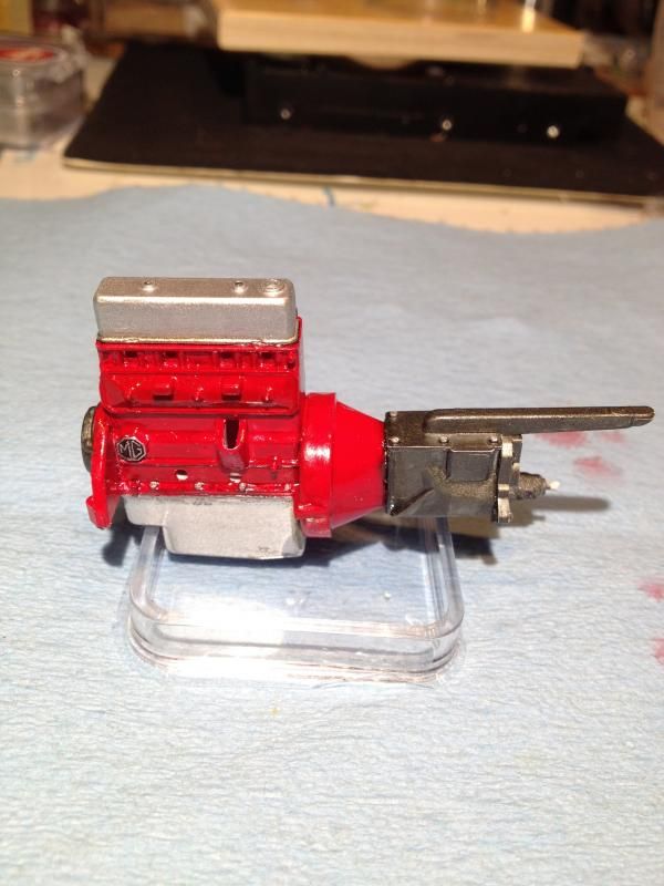

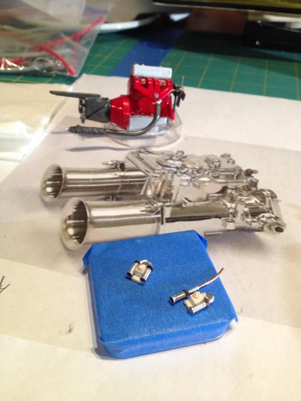

Twokidsnosleep Posted December 22, 2014 Author Posted December 22, 2014 (edited) Haven't posted much progress, so let's have a peek at the engine Block colour to match body paint all Tamiya Heat wrap on exhaust is painted hockey tape for a Canadian flavor Trying to make some Weber carbs....this is try #3 with brass and aluminum tubing and plastic One of the members here was a wealth of MG info in the lost thread I have an MGTC restoration book he suggested on route from Amazon for Christmas Thanks for looking Edited December 22, 2014 by Twokidsnosleep Quote

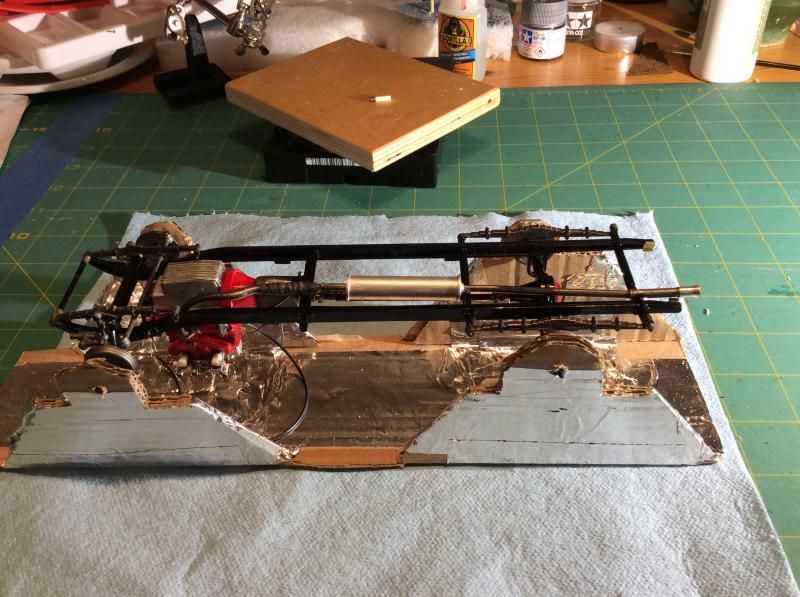

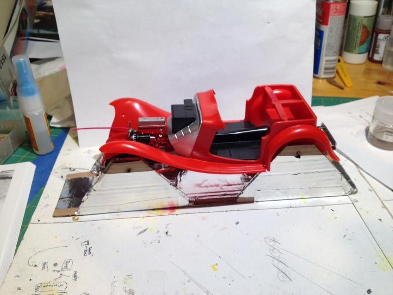

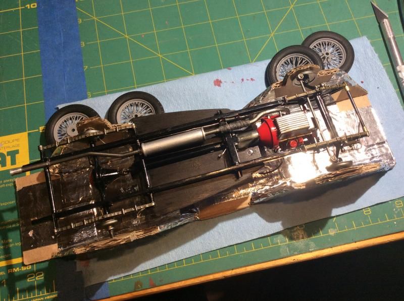

Twokidsnosleep Posted December 26, 2014 Author Posted December 26, 2014 (edited) Over a nice quiet Christmas afternoon, I added a dipstick and an oil line to the lhs Dipstick is brass and stretched styrene sprue...needs a little MG decal Made a little cardboard stand for easier handling of chassis and body Edited February 24, 2015 by Twokidsnosleep Quote
Cato Posted December 26, 2014 Posted December 26, 2014 Work stand is excellent idea. I make mine from foamcore board.. Show you when I have time. Quote
Twokidsnosleep Posted December 26, 2014 Author Posted December 26, 2014 I think I stole that idea from your Pocher build I used a metal duct tape and am surprised how sturdy it is Quote

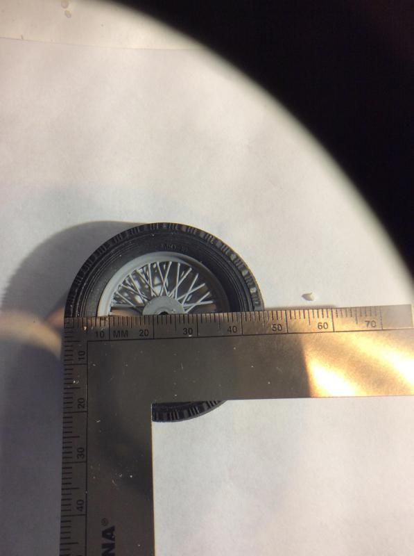

Twokidsnosleep Posted December 26, 2014 Author Posted December 26, 2014 (edited) Those kit wire wheels look unusually nice. What's the outside diameter of the rims? They may be a good substitute for the somewhat klunky wires on the 1/16 Jaguar SS 100.Sorry Jordan, I forgot to post the measurements The wheels+tires have a 45mm diameter The spoke wheels are 30 mm diameter rim to rim with a 1mm flange for the wheel to seat Edited December 26, 2014 by Twokidsnosleep Quote
Cato Posted December 26, 2014 Posted December 26, 2014 Scott, Here's some workstand ideas. Custom make them and you're actually saving time and effort. The Rolls stands came from the bright guys at Model Motorcars: A plastic magazine rack can work too if you're lucky for fit. I did much of the engine and rear suspension on this and it's much easier than flipping it top to bottom all the time: Works right side up or down: Quote

Twokidsnosleep Posted December 27, 2014 Author Posted December 27, 2014 (edited) I mounted the carbs and made a throttle linkage, some electrical bits also Don't like the chalky,sloppy look of the chrome paint on the carbs....Maybe the paint reacted to the aluminum? Thinking of going to the office and sandblasting them back to bare metal I need to get the paint on the body, but is so humid and wet out here Might have to spray in the basement So much babble, so little progress Edited December 27, 2014 by Twokidsnosleep Quote

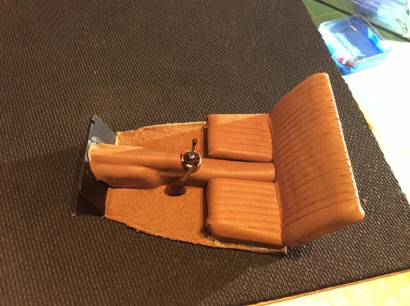

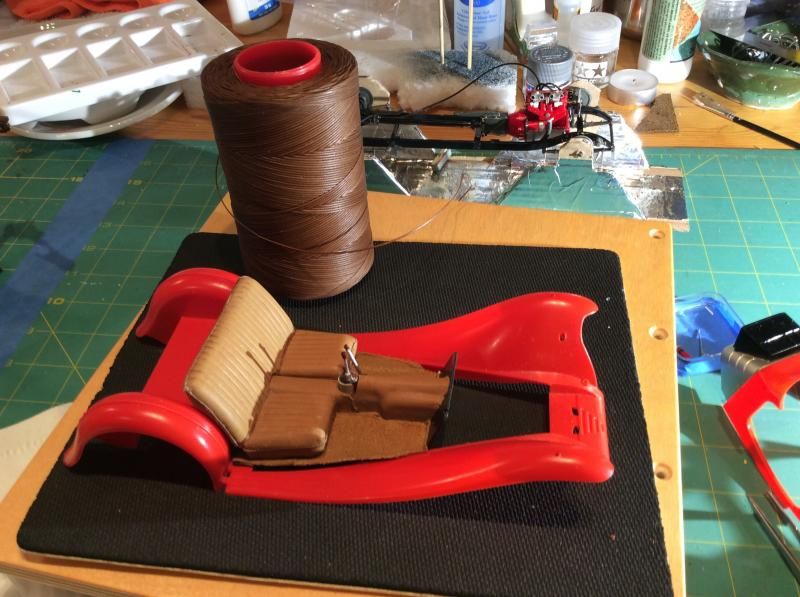

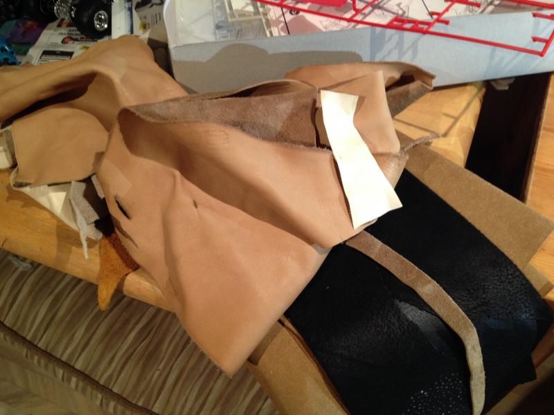

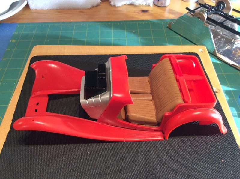

Twokidsnosleep Posted December 28, 2014 Author Posted December 28, 2014 (edited) And now for something completely different....The Interior I decided to try covering the seats with real leather and some fabric for carpet Pile of leather scraps from Tandy Leather I think All of it is way too thick so I have skived off the back with a razor tool The 'carpet' is an Ultrasuede material, wish it was a shade or two darker for some contrast Everything was cemented with contact cement Looks a little rough around the edges, but those edges will never be seen. The shifter and e brake have a leather boot added to their base I burnished the lines into the seats with a small wood dowel before the cement was set I will add thread as piping around the edges. The spool is Havana Brown Tiger thread, one of the best in the world for hand stitching leather I was going to make some darker floor mats, but in test fitting I couldn't see the floor so as a wise man says, why waste time on things you won't ever see Feel like I actually made a bit of progress today while stalling on the engine compartment and paint Edited December 28, 2014 by Twokidsnosleep Quote

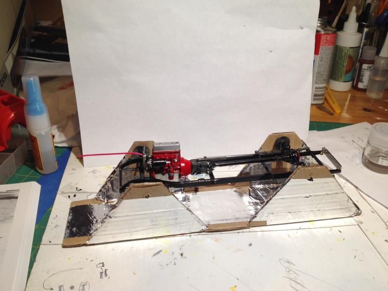

Twokidsnosleep Posted December 30, 2014 Author Posted December 30, 2014 Engine is cemented in as is the exhaust system Need to touch up paint a bit before body goes on. The rack comes in handy Away skiing so no more building for a week Quote

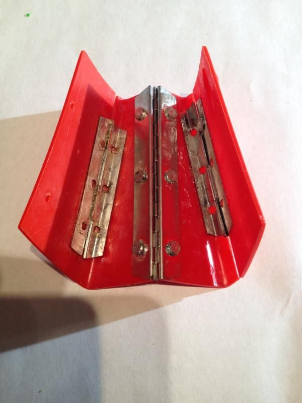

Twokidsnosleep Posted January 5, 2015 Author Posted January 5, 2015 (edited) Progress report...a slight bit The last weekend of Christmas Holidays and I got the leather on door panels, front panel opened up and the electrical box wired and glued oops, I opened up the front panel in front of the grill...it is stamped metal on the real car and not open....more work to close up again Arrrggg I also made twin fuel pumps for the Holly carbs, still have to seat and wire them. The black styrene is the original, mine are brass, aluminum and styrene Amazing variation in these cars from year to year and I am taking artistic license for sure with this build by moving the electrics to the left and pumps to the right side closer to the carbs Dry fit of body, interior and engine I think dashboard is next, then try and paint this beast Actually getting kind of sick of the build, not coming out as clean as I hoped for....my skill set issues and frustration So long for now Edited January 7, 2015 by Twokidsnosleep Quote
