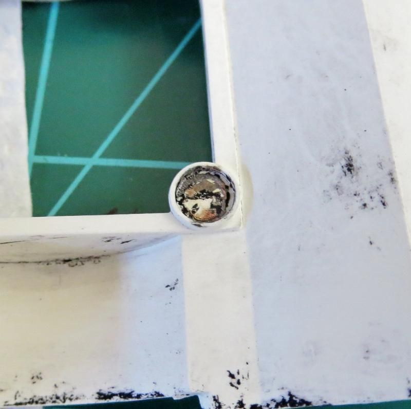

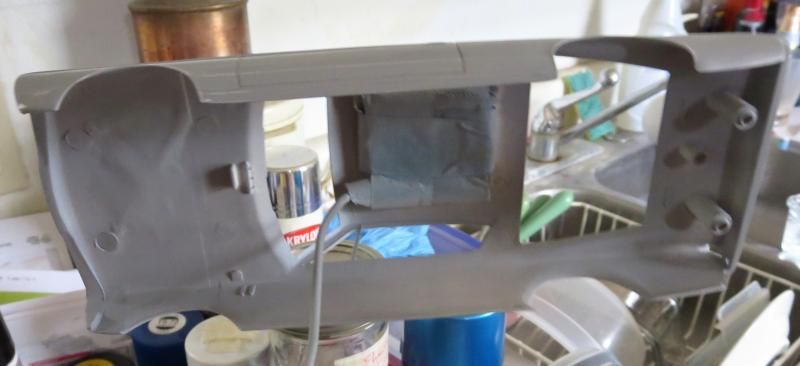

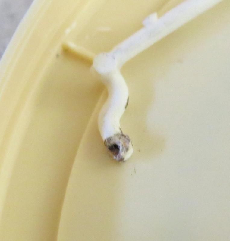

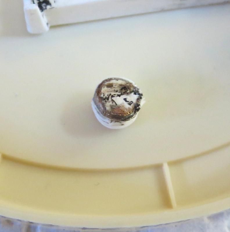

Speedfreak Posted January 12, 2015 Author Posted January 12, 2015 (edited) All right, Let's see what's happening with this restore; The body is cleaned and ready for prep work. Continuing with the disassembly, now working on the chassis. Same story, seems this kit was glued together while the paint was still wet, and , in some cases it almost looks as though the original builder used paint as glue? hmmmmmmmmm. It looks like I might be able to get the body, and , chassis painted Thursday/Friday if all goes well, AND , I get all the body prep done. The temperatures are suppossed to be in the low 50's, yes! Here's a shot of the basic colors for the body, if I can pull off a two-tone paint job, it will be my first real attempt. I've done a couple of dabbles at it before, so , my experience is minimal. I'm thinking black & white with metals for the inside, maybe one other primary color (?) Tell me what you think: Rustoleum 'Maui Blue/Krylon Short Cuts 'Chrome: the chrome as a lot of yellow/gold tones in it, which I think is cool. And now for the not so pretty: Rear Spring Mount: Rear Spring: (The other spring is still stuck on the sub-frame ) And the tie rod end: How exciting is this? I mean really! And so the journey continues in the restoration of the 'Super Boss' Hemi Hustler. Thanks for looking. Edited January 13, 2015 by Speedfreak

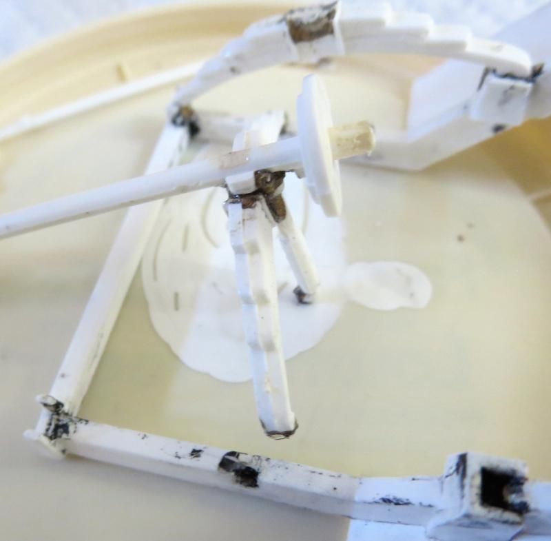

Speedfreak Posted January 14, 2015 Author Posted January 14, 2015 Thanks Joe, glad you like the color choices because I'm sticking with the silver and blue, the silver on the sides of the car. I probably could scratch make some spings, but , I don't know , my goal at this point anyway, is to use ' all ' of the original kit parts, call me obsessive. I'm cleaning up the front suspension now, well, trying to get it apart, by going back and forth between hot sink water and the freezer, to minimize carving and prying. I've almost got the tie rod completely prepped and ready for primer. I need to start prepping the body as I've only got two days before the weather will be right for painting. A short window of two days.
Marc @ MPC Motorsports Posted January 15, 2015 Posted January 15, 2015 I would raid the HUG reissue for a many parts as possible. Model glues are really solvents, and the solvents 50 years ago were much stronger. Also, many young builders in the day had no concept of the word "sparingly". They would use at least a half of a tube or more on each model. Lucky for me, I had a 2nd Grade teacher that taught us when it comes to glue, "a little dab'll do ya". Great work so far and at least replacement parts are not made of unobtanium.
Speedfreak Posted January 16, 2015 Author Posted January 16, 2015 (edited) Marc, thanks. The Chezooom kit has the same parts, I have one of those. Ya, I think whoever built this did it 'fast' like a weekend perhaps and they got paint almost everywhere and then glued it together before the paint was dry, as you can see in the pics. I'm tempted at this point to use the new parts, but, I haven't broken down yet. Edited January 17, 2015 by Speedfreak

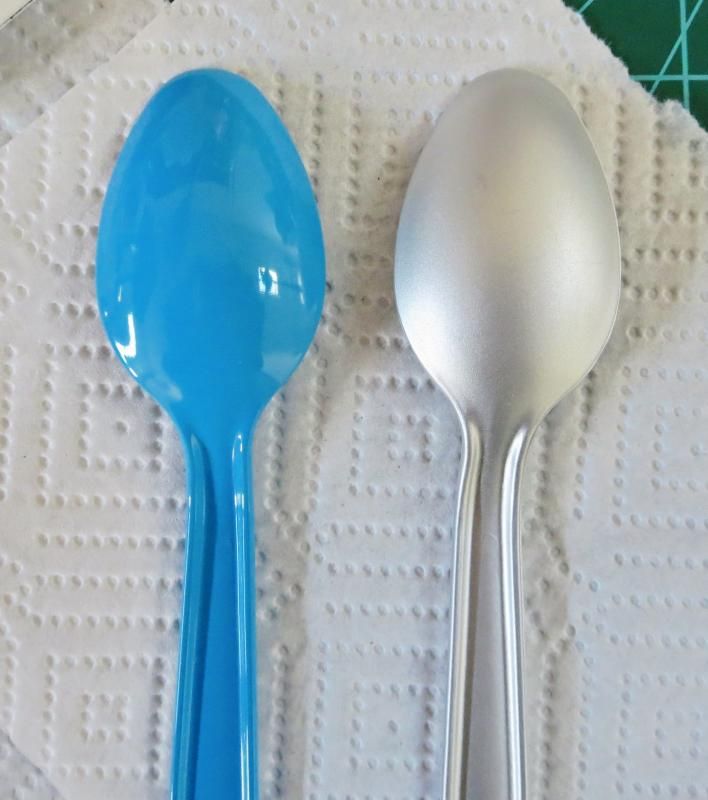

Speedfreak Posted January 20, 2015 Author Posted January 20, 2015 Carl, I'm sticking with the silver, but , I've changed my mind on the blue. I've decided to go with Tamiya ' Racing Blue ' because of all the shades you can get with it depending on which base coat you use, and , since I'm using that silver I can just shoot the whole car with it and then mask off the sides and spray the blue over the rest. I really like the Racing Blue, it's closer to what I had in mind for the car, AND , it looks great with the decals. I've got a coat of Tamiya gray surface primier on the body now. My only concern is with putting the Krylon Short-Cuts over the Tamiya primer and then under the Tamiya Racing blue. I'm hoping that if I let things sit for a day, or , so between paints that all will be ok.
slusher Posted January 20, 2015 Posted January 20, 2015 Tamiya primer will work with Krylon and most paint. You could go with Tamiya silver leaf and all paint would be the same brand on the body. No worries then...
Speedfreak Posted January 21, 2015 Author Posted January 21, 2015 (edited) I have thought of that, and , I have some Silver Leaf. We'll see, I need to do some more experimenting with spoons. Thanks. Update: Carl, I think you're right about the Silver Leaf, I don't wanna have to strip this thing again, no way. Edited January 21, 2015 by Speedfreak

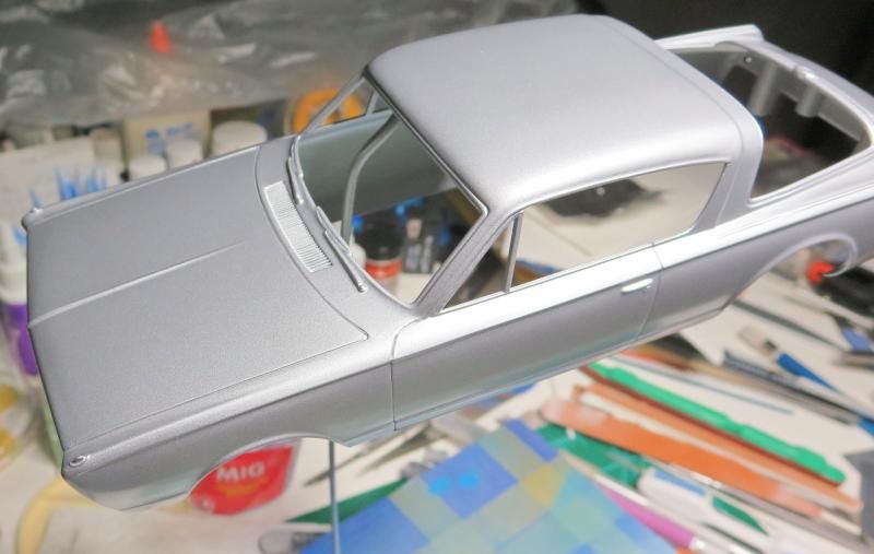

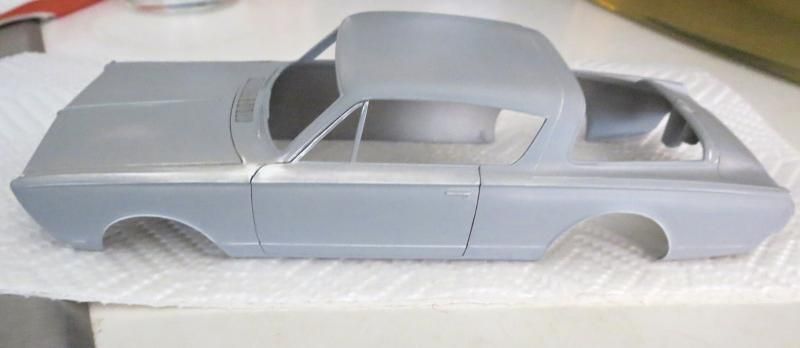

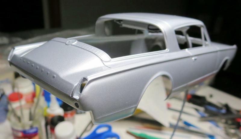

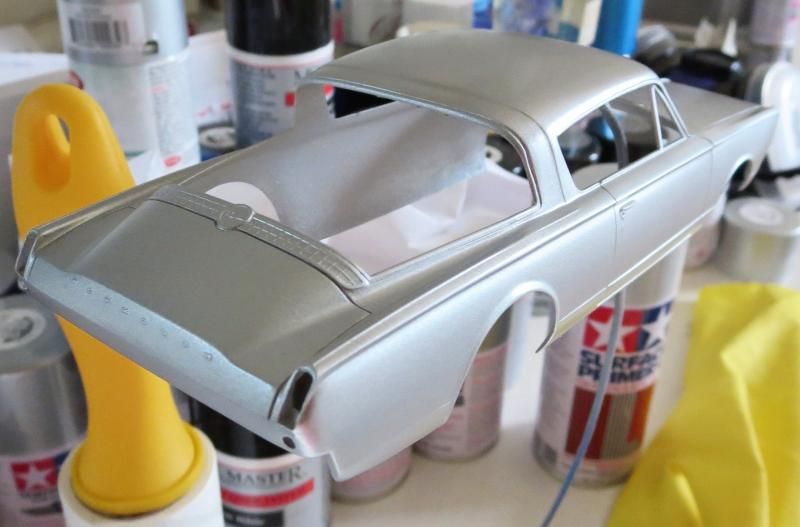

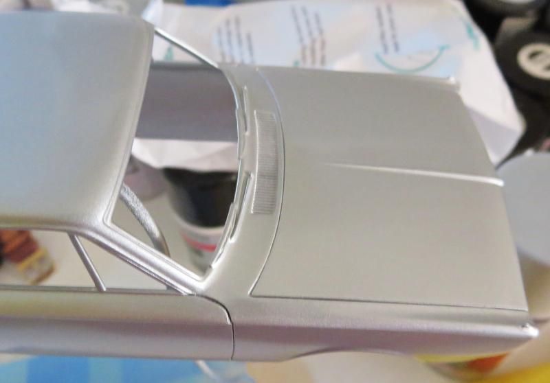

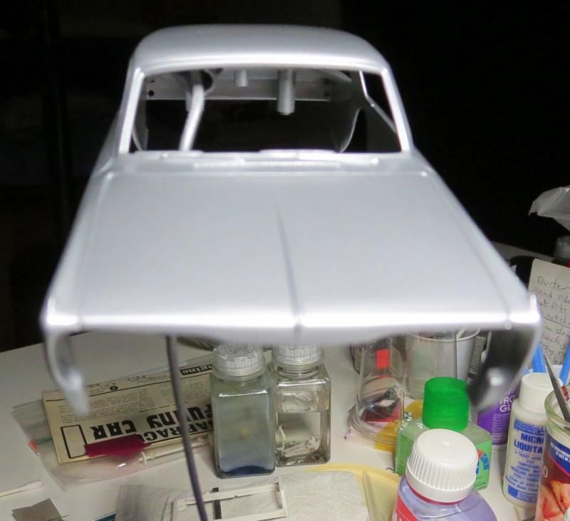

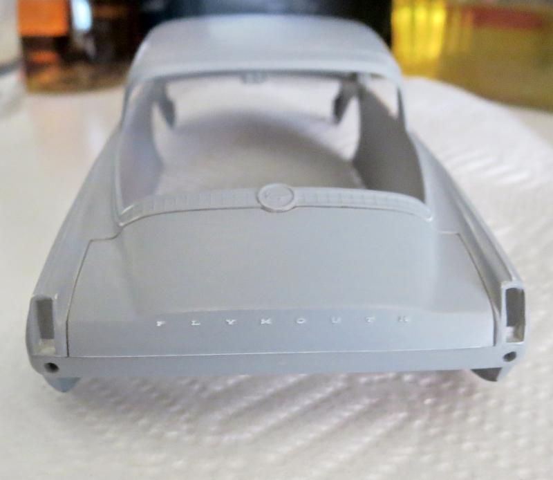

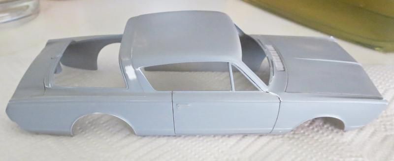

Speedfreak Posted January 24, 2015 Author Posted January 24, 2015 Well, mother nature has permitted me to put the base coat on the Hustler. All went well until I was walking back into the house from the front porch and I literally saw this speck of dust fly up and land on the hood of the car! It's not big and I could leave it but I won't. So now it's wet sand and another wet coat, if the weather holds for the next couple of hours, if not I'll have to wait. I show what the car looked like with just primer and then the coats of paint. Primer: Primer rear: Primer Drivers side: Inside the body, (I took out a lot of plastic inside the wheel wells) : First light coat of paint: Wet coat after two light coats of paint: The front (Like I said, you can't really see the dust specks, but , they are there): A bad picture of the wet coat: Well, It's on to the wet sanding now!

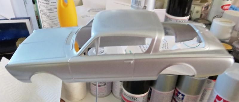

Speedfreak Posted January 25, 2015 Author Posted January 25, 2015 (edited) I think I may have pulled it off, 55 degrees and 42% humidity, but , it's Tamiya paint, very forgiving and easy to work with stuff. I'll have a couple of pics of the body shortly. Thanks for looking! And here they are: Success! And now onto the hard part, (at least for me ) painting a two-tone paint job. The sides of the car will remain silver and the main, or , center part of the body will be top coated with Tamiya Racing Blue, which is a metallic paint. And, what do you do with the inside of the wheel well lip, let it be two-tone as well? I've got both thin and wide Tamiya masking tape, so that's what I'll be using to mask things off. I'm not quite sure where I should make the division line coming over the side; right at the apex before it goes into the concave cove, or , where the flat part of the cove starts. Seems it should be at the apex, which means the line will have to be incredibly sharp and 'any' bleed through will most definately show. I'm stressing, but , man this is fun! Any help, or , suggestions for how to go about this will be 'greatly' appreciated. Edited January 25, 2015 by Speedfreak
