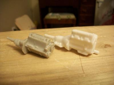

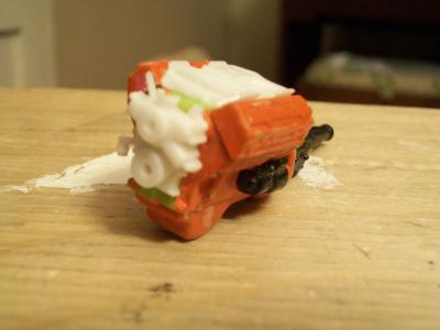

restoman Posted February 26, 2015 Posted February 26, 2015 One of my "If-I-win-the-lottery-I'm-going-to-build-one-of-these" cars. Black, red interior, single four barrel 440, four speed, Tor-Q-Thrust wheels... The car is set up for an auto so that's gotta go. The supplied 383 is an auto and has the starter on the wrong side, so modifying it is out. I've got a 426 Max Wedge out of a '49 Merc kit, but it too has the starter on the wrong side, and I don't plan on using the dual four set-up on that the Max Wedge has. Found a 440 Six Pak engine in my parts box, with a four speed. The single four intake from the 383 fits, as does the much better timing cover/water pump set-up. The 440 is a drop in, same length and height as the 383. The 426 is shorter. The 440 looks to actually be a big block Chev engine with Mopar heads and intake but it should work just fine. The Max Wedge exhaust manifolds will look right at home on the 440. , The kit comes with a quad headlamp Polara grill, the 330 model has single lamps, but what the hey... it should look fine. Sorry for the crappy pics. My camera didn't seem to want to cooperate tonight.

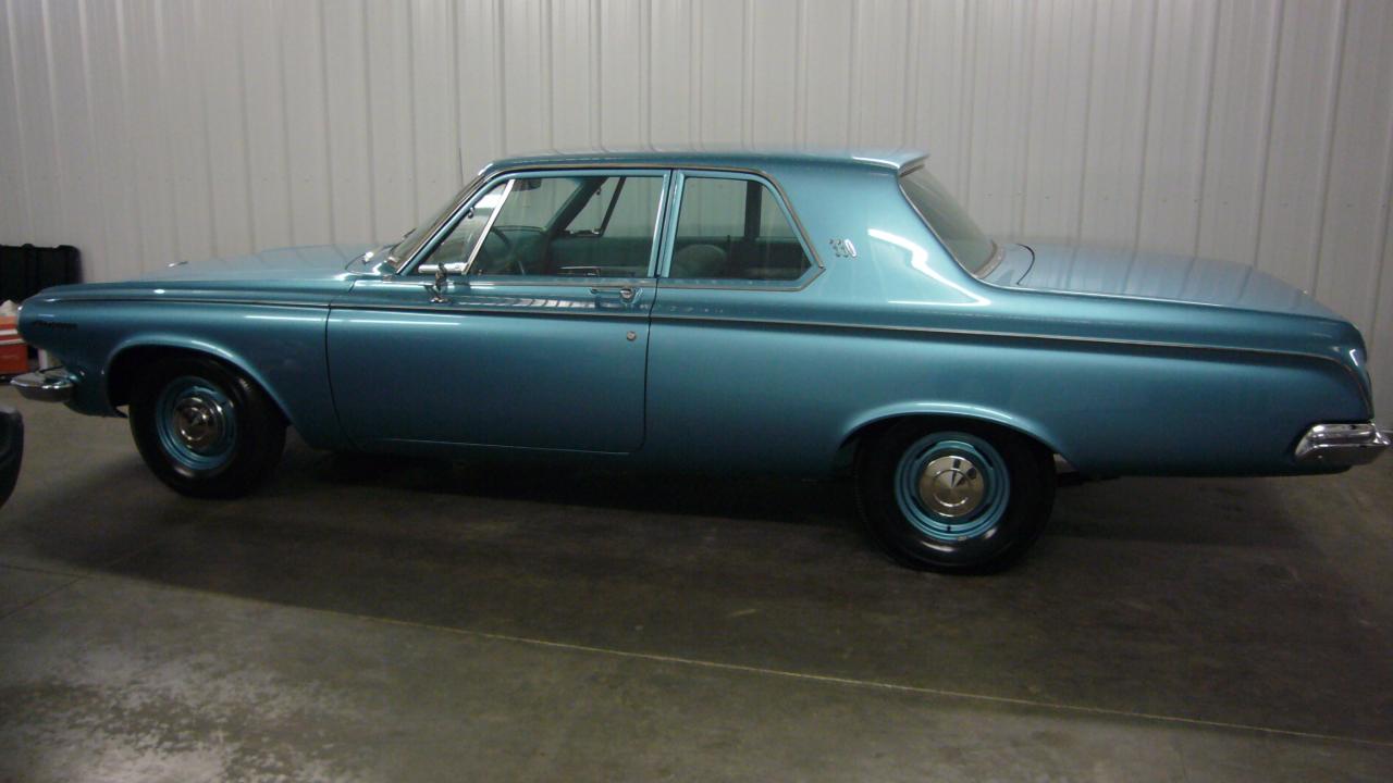

ChrisBcritter Posted February 26, 2015 Posted February 26, 2015 (edited) Don't worry about the grille - 330s had four headlamps from the factory like the Polara and 440. The two-light grille was a racing modification. Edited February 26, 2015 by ChrisBcritter

High octane Posted February 26, 2015 Posted February 26, 2015 The two headlamp grille was for cars with the HEMI.
restoman Posted February 26, 2015 Author Posted February 26, 2015 The two headlamp grille was for cars with the HEMI. Right on. This one isn't going to have a Hemi, so quad lamps it is! Thanks!

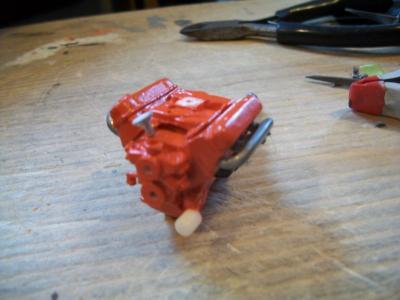

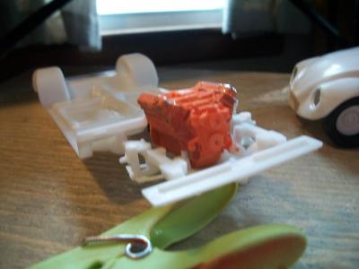

restoman Posted March 10, 2015 Author Posted March 10, 2015 Modified the 440 engine mounts to get the oil pan off of the K member.

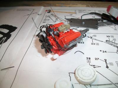

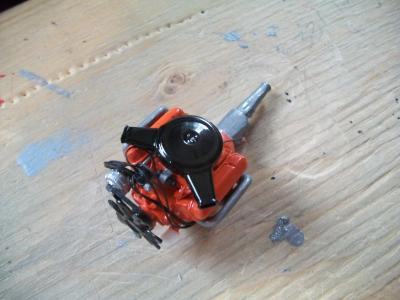

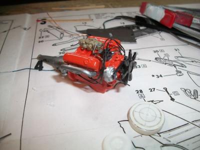

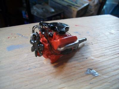

restoman Posted April 10, 2015 Author Posted April 10, 2015 Slowly working my way through... Modified the intake to look more Mopar-ish, built a coil, fuel line, return spring, alternator brackets and accelerator cable. Drilled for heater hoses, added the distributor and wired it up. Goofed on the firing order slightly, so it may run with a bit of a miss. Drilled out the homemade vacuum advance unit for a hose but my eyes gave up early today. I couldn't find an air breather that looked right so I'm modifying the one in the foreground. I think it's from a '56 Ford? Most of the chassis is done, but I didn't think to take any pics.

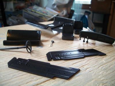

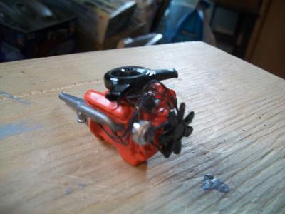

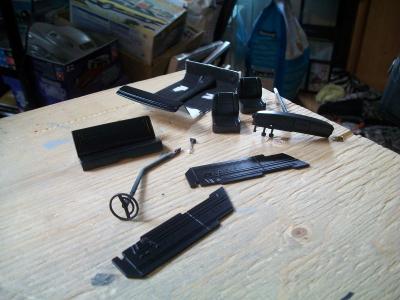

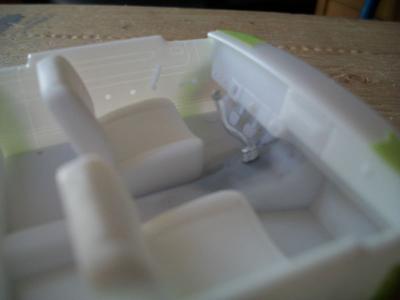

restoman Posted May 4, 2015 Author Posted May 4, 2015 Got the interior blacked out in base coat, waiting for some foil to finish it out. Black embossing powder looks almost real. Modded a dual snorkel air breather - think it's from a Pontiac? - that looks like it might belong there. Opened up the snorkels a bit too... Mocked everything up and found the engine can't go in before the body is assembled to the chassis - the Super Stock manifolds make it too wide. The rad support panel needs to go on after the engine is in place too. Not a big deal, but fitting it all together is a bit tricky.

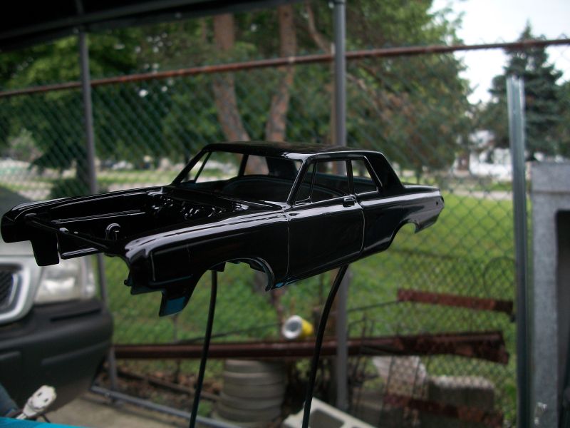

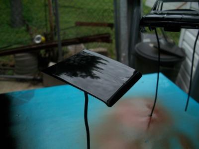

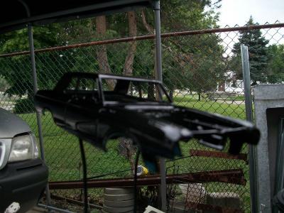

restoman Posted June 25, 2015 Author Posted June 25, 2015 Got some colour on yesterday. Single layer Sikkens U-Tech black. Couple little dust nibs to polish out but it looks good.

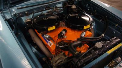

gtx6970 Posted June 27, 2015 Posted June 27, 2015 Looking good so far. And I agree , Black with red interior is killer looking on these old Dodge If you dont mind,,heres a little insperation for you.

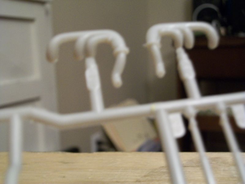

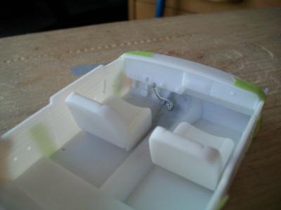

restoman Posted June 27, 2015 Author Posted June 27, 2015 Very nice, Bill! I changed direction a little - now has a black interior. Making up some seat belts for it today, then the interior can go together. Waiting a week or so before polishing it out... U-Tech cures fairly slow.
