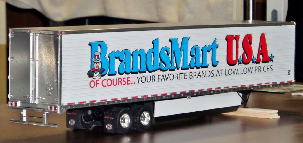

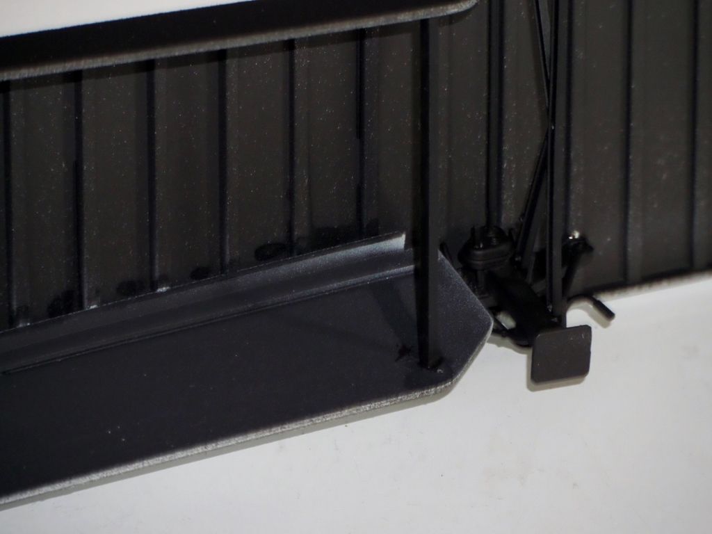

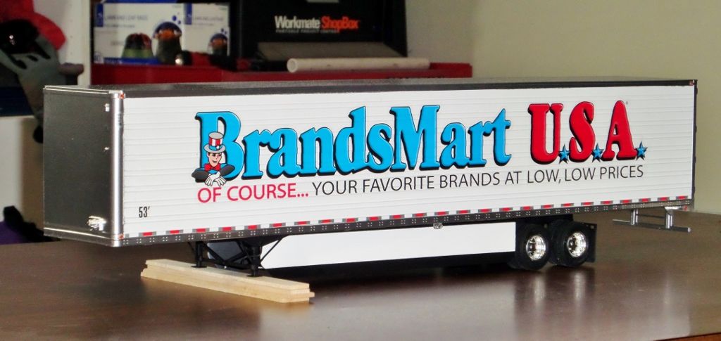

kilrathy10 Posted January 26, 2015 Share Posted January 26, 2015 (edited) Don't know why it took so long for them to be required, really....Almost every truck in Europe seems to have some type of trailer skirting....Whether it be some tool boxes or just skirting it's there..... They're not hard to make, Man....It's simpler than you might think.....Just take some flat plastic and cut two about an inch and a quarter high, and to however long it is from the tandem to the landing gear.....Take some quarter inch plastic angle and affix it to the top of each piece.....Then glue them in place on the trailer..... Most of the 1:1's are installed with the simplest of square tubing here and there....And I've seen them installed on the inside of the landing gear as well as the outside.....Cheap is the name of the game in this world, I'm sure..... Here's what I've done.... Seriously....Don't over think it, Man.....It's just that easy..... Now the trailer tail is another story all together, though.....I think it looks a little goofy, in my opinion, so I doubt I'll ever attempt one..... Edited January 26, 2015 by kilrathy10 Quote Link to comment Share on other sites More sharing options...

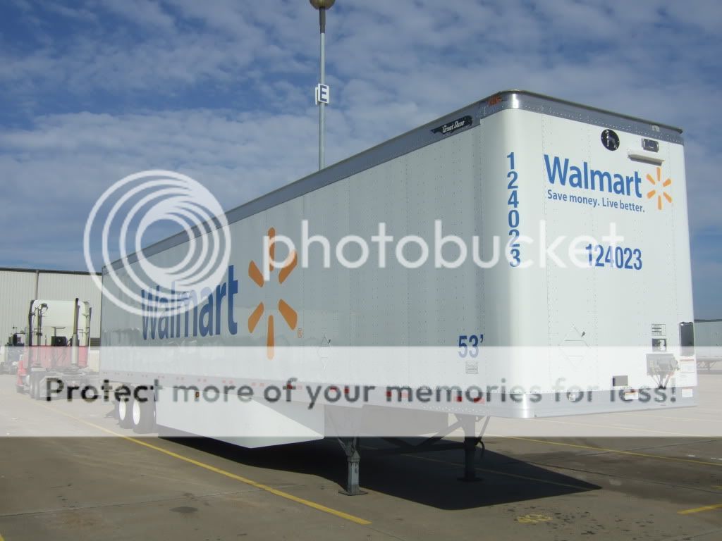

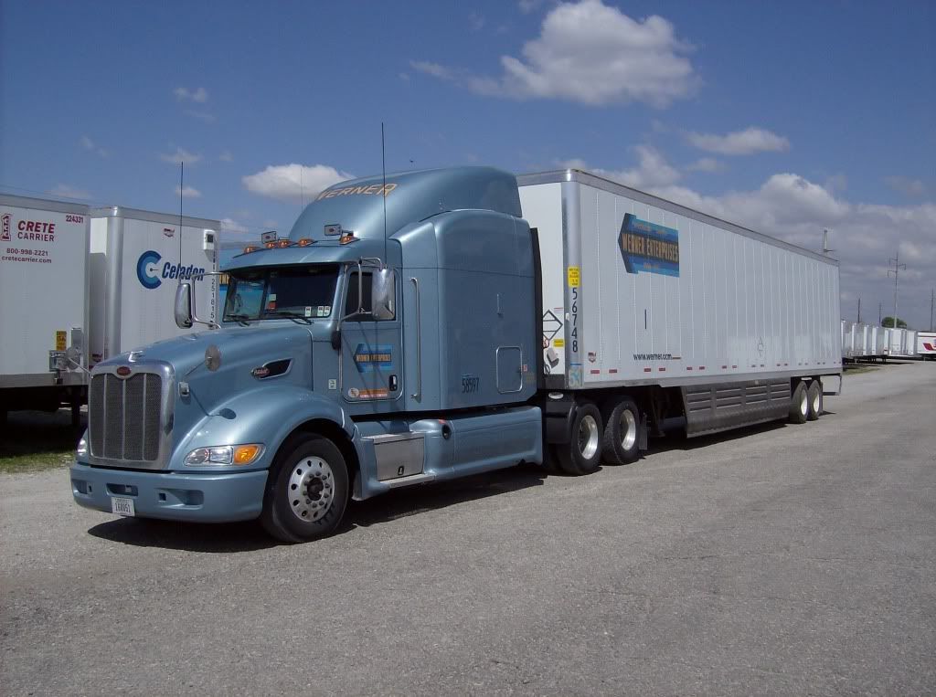

highway Posted January 26, 2015 Share Posted January 26, 2015 There are the angled ones under the trailers. When did these start coming into use? Most of the ones I see are some kind of flexible material, but in pics I swear I've seen rigid ones. Some of you on here have made them, what did you make them from, and how did you attach them? It seems to me, it might be kind of an important thing to put on the Moebius 53 foot Reefer. Most modern trailers I see have them. Actually Mike, all of the skirts themselves are rigid, the only thing that is flexible is a rubber strip at the bottom of the skirt, which is the black area JT replicated seen best in his first pic above (and below in this reply) that is to prevent damage going into angled docks where the skirt may drag the pavement. The ones in JT's pics are the most common setup, and when installed on a reefer, they also have two holes cut in them for the filler neck of the tank and the fuel gauge in the center of the driver's side tank face. These two pics have another style of skirt, and these were both pics of brand new Wabash trailers on the factory lot in Lafayette, IN. By the way, for those of you that may be wondering why the second trailer is white, it was a dedicated use trailer (Best Buy if I do remember correctly) that also had a roll up door instead of barn doors. There is also a brand that I seen once that slides with the tandems and also there is one trailer similar to this one I found in a Google search that I pulled at work that the skirts meet in the middle of the trailer. Walmart and others also use these style skirts. Don't know why it took so long for them to be required, really....Almost every truck in Europe seems to have some type of trailer skirting....Whether it be some tool boxes or just skirting it's there..... They're not hard to make, Man....It's simpler than you might think.....Just take some flat plastic and cut two about an inch and a quarter high, and to however long it is from the tandem to the landing gear.....Take some quarter inch plastic angle and affix it to the top of each piece.....Then glue them in place on the trailer..... Most of the 1:1's are installed with the simplest of square tubing here and there....And I've seen them installed on the inside of the landing gear as well as the outside.....Cheap is the name of the game in this world, I'm sure..... Here's what I've done.... Seriously....Don't over think it, Man.....It's just that easy..... Now the trailer tail is another story all together, though.....I think it looks a little goofy, in my opinion, so I doubt I'll ever attempt one..... Nice job on the skirts JT, but here is a little help for you next set. Quote Link to comment Share on other sites More sharing options...

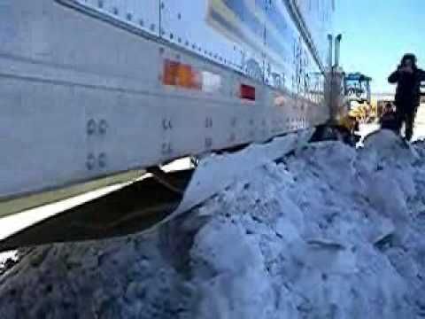

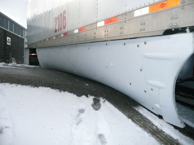

highway Posted January 26, 2015 Share Posted January 26, 2015 Also, this is what I was talking about the rubber strip on some, it still extends the skirt but prevents this: And an example of another thing for rookies to tear off: Quote Link to comment Share on other sites More sharing options...
highway Posted January 26, 2015 Share Posted January 26, 2015 Boy Matt got a pic of every 1 I mentioned above. Prime has them on their newer spread axle flatbeds, not exactly sure how they help on those. I've also seen them on some end dumps out here. Yep, between 17 years on the road and Google, it helps! The newer trucks are also wearing skirts, they may be hard to see here, but there is rubber skirting on the fairings of my Cascadia. Schneider also uses those wheel covers on all there tractors. I'll try to get better pics when I go back to work, and also if I see any other odd styles of skirts at work, I'll get some good pics. Quote Link to comment Share on other sites More sharing options...

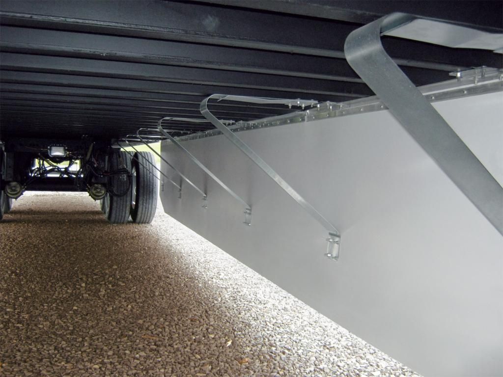

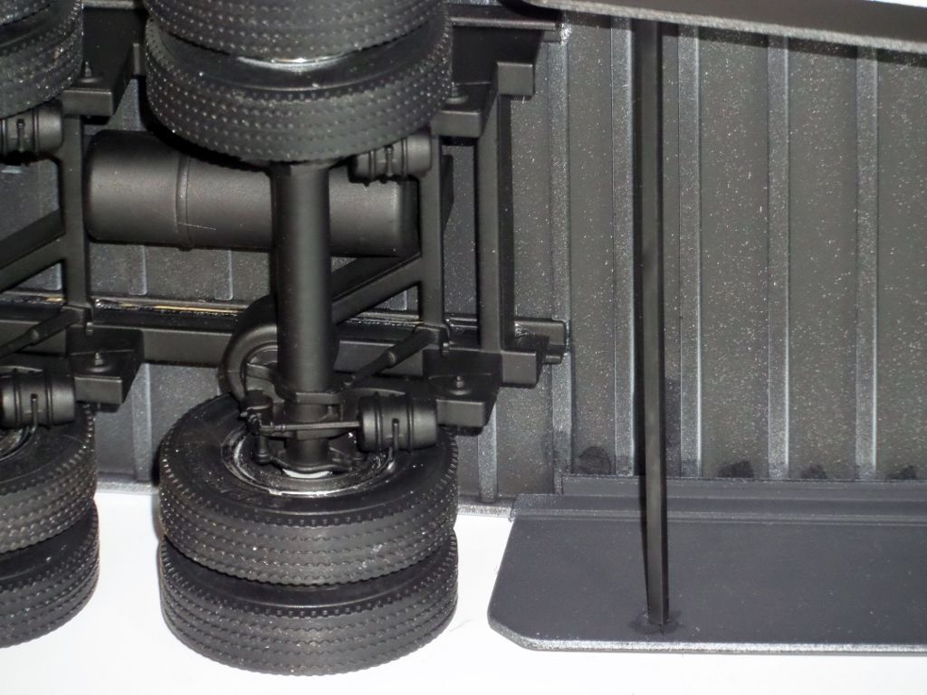

kilrathy10 Posted January 26, 2015 Share Posted January 26, 2015 (edited) Nice job on the skirts JT, but here is a little help for you next set. Edited January 26, 2015 by kilrathy10 Quote Link to comment Share on other sites More sharing options...
highway Posted January 26, 2015 Share Posted January 26, 2015 Nice job on the skirts JT, but here is a little help for you next set. Hey, Man...Thanks for that pic.....It does help....I haven't had a chance to crawl underneath a new one.....I was just guessing for the most part....The one I did glance at used some square tubing here and there.....As everyone's pics demonstrate; there's more than one way to skin a cat.....But it does confirm what I was thinking about cost effective materials used....This setup has to be about as light as it can get..... Quote Link to comment Share on other sites More sharing options...
kilrathy10 Posted January 26, 2015 Share Posted January 26, 2015 Now there's something I hadn't thought about.....Added instability in crosswinds.....Could explain how I see a few guys get a little squirrely every once in a while.....Thanks for that tidbit of info....Things that make you go, Hmmmm..... Quote Link to comment Share on other sites More sharing options...

highway Posted January 28, 2015 Share Posted January 28, 2015 All the skirts themselves are fiberglass, aluminum, or plastic depending on the manufacturer of the skirt, but the ones like JT replicated on his are only flexible at the bottom where they are black. That area is most likely rubber, because sometimes driving down the road they will "wave" at you with the air currents. I'm around these every day, and a few different manufactures styles, I can get some pics if you like and post them when I get home after that. Quote Link to comment Share on other sites More sharing options...
