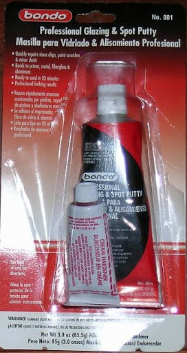

00801-bondo-professional-glazing-spot-pu
Bondo 801 Professional Glazing and Spot Putty. This is a 2 part putty, fast to work with and will not shrink like one part putties. It's available at the FLAPS for around $6 or so.
That's what I use .

Not so fast. The Bondo one part glazing putty will crack and/or shrink. Any one part putty that requires evaporation to dry will lose substance and crack or shrink. The putties shown above are more to use as a heavy primer-filler which is fine for skim coats.
Below is a two part putty. It's catalyzed and won't shrink. It's easy to use, not that fussy and has slightly longer work time. It's sandable in 15-20 minutes.

If it says Bondo Professional Glazing and Spot Putty, I believe that's the 2-part stuff. And it's great stuff, it's what I use all the time. Mike is right, make sure you are getting the 2-part (hardener + resin) type. One-part putty is nothing but very thick primer and will shrink and crack on you.

The one I posted is part #801, which is the 2 part version. Here's the link to Bondo http://bondo.com/pro...-putty-801.html. The second tube for the catylist is packaged behind the larger tube in the newer packaging.
