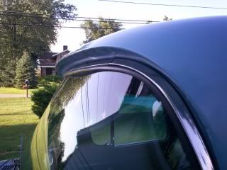

Longbox55 Posted August 24, 2015 Share Posted August 24, 2015 Common problem on that kit, especially the later issues. The windshield on that kit is not correct to the 1:1 on any of the issues of it, though. The top of the glass should actually sit 3 scale inches back from the edge of the cab roof, like this You could make a filler strip to correct it out of styrene. Quote Link to comment Share on other sites More sharing options...
