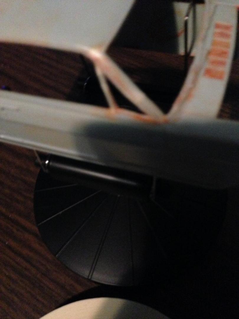

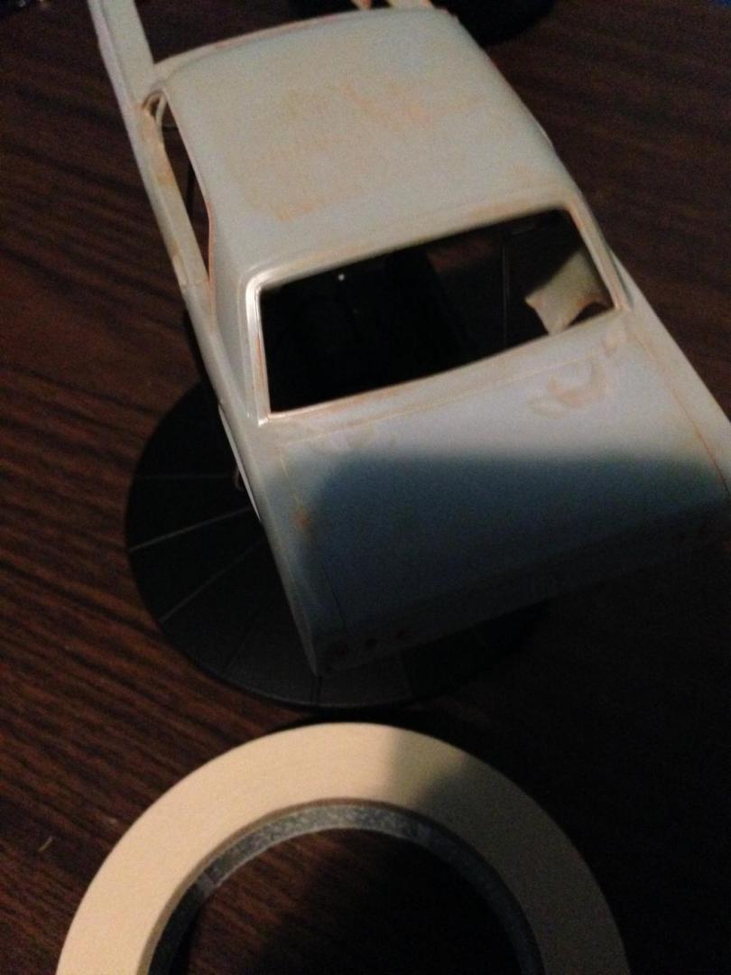

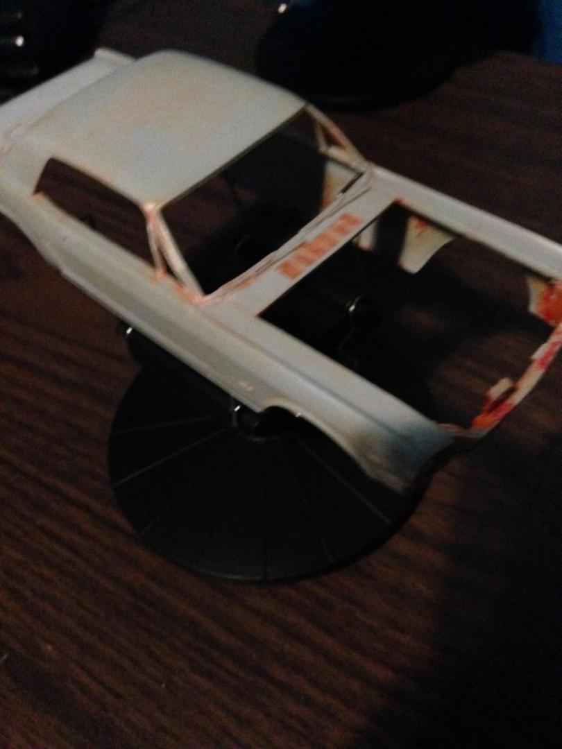

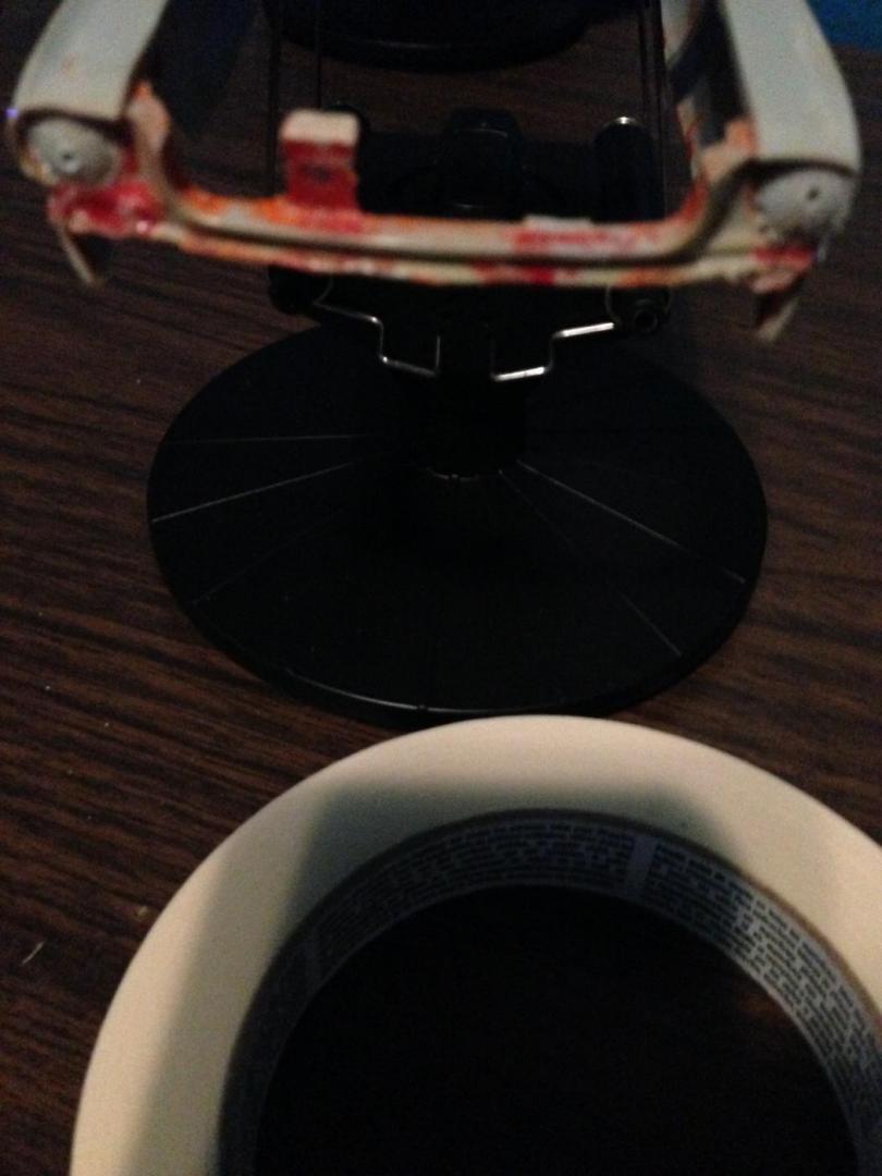

Dusted1972 Posted December 29, 2016 Author Share Posted December 29, 2016 (edited) Sorry for the lack of updates.Holidays and stuff ,lol. The following are pics of the body after the purple bath and a bit of sanding.You can see the warps and dent from the over gluing.Most of the warps are in spots where glue was applied very heavily.After some more sanding ,a light coat of primer ,I flat sanded it with a emery board and a small sanding block I made that has 180 on one side and 320 on the other to block the larger areas like he trunk and roof to reveal any more warp spots.I filled the spots with putty ,blocked them down and sanded as much glue as I could from the body and gave it another coat of primer and a mist of black for guide coat..It's not going to be perfect since there are small spots I couldnt get to very good.One spot being on right near the 289 emblem on the fender.The headlights were glued in so much I had to carefully drill them out which is fine because I may use lenses instead of the chrome headlights that come with the kit. Sorry about the some of the blurry pics. Edited December 29, 2016 by Dusted1972 Quote Link to comment Share on other sites More sharing options...
