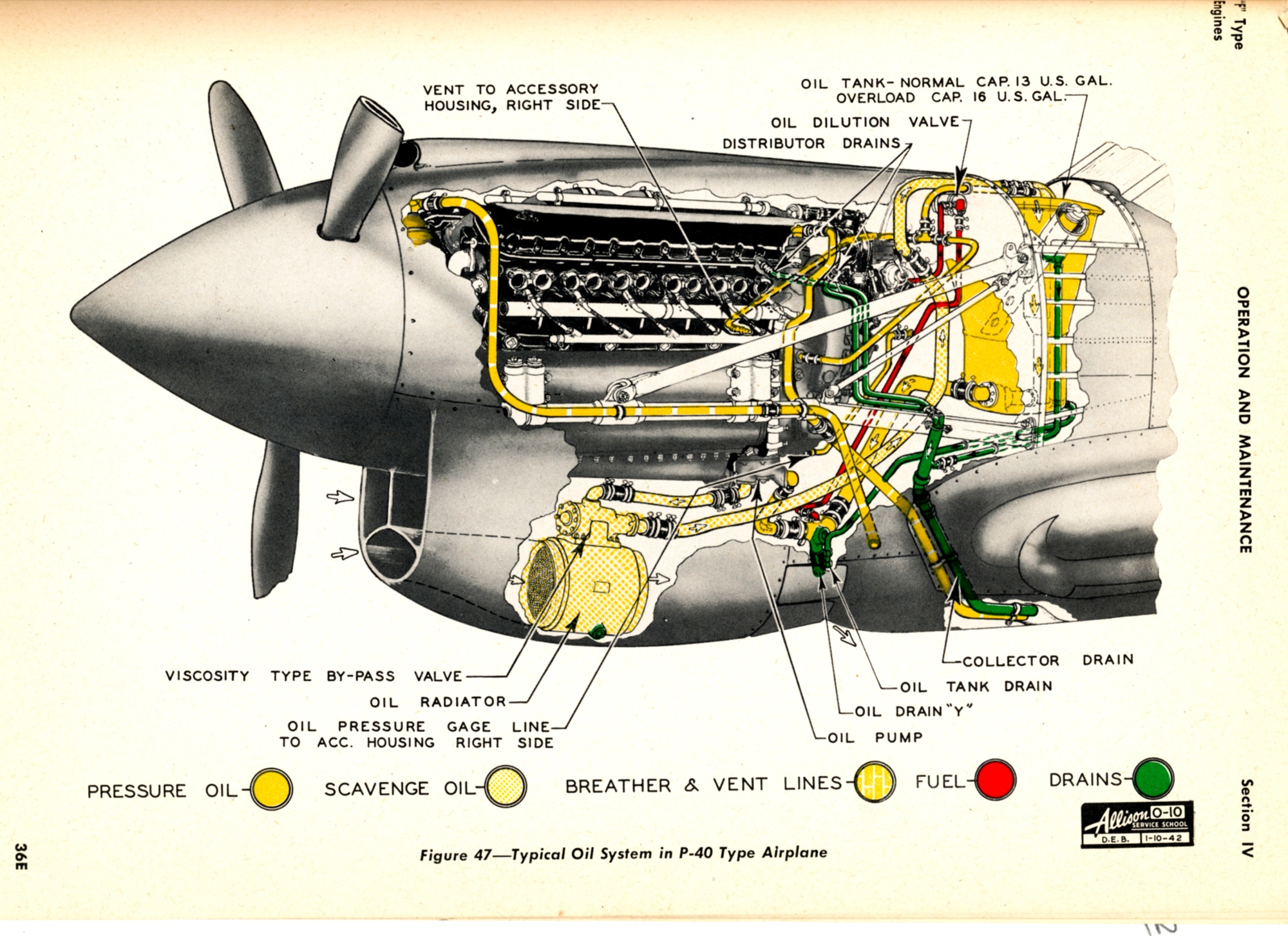

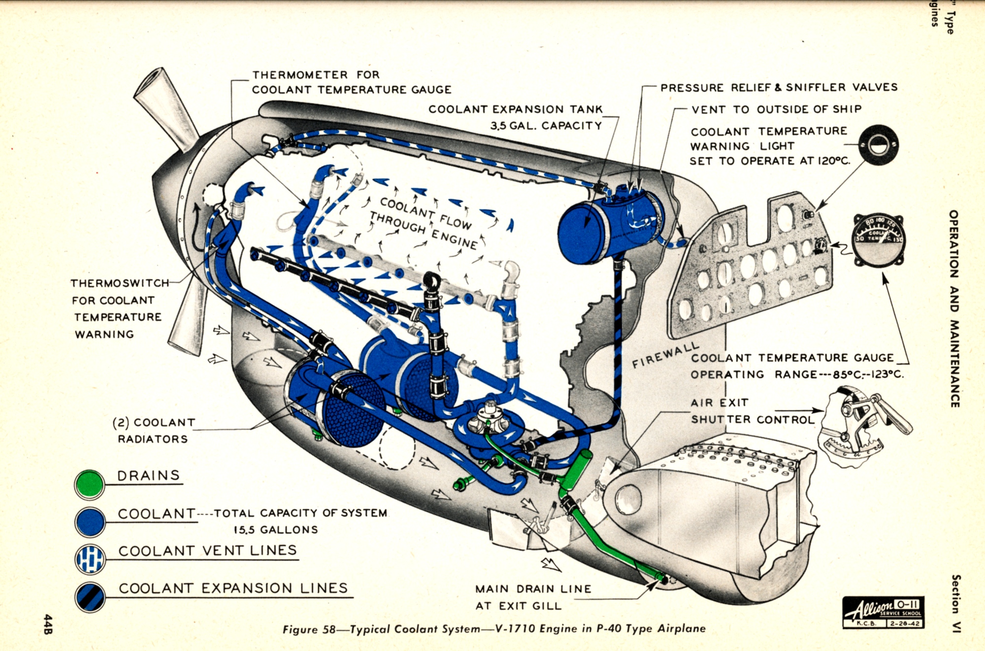

That's some great info guys thanks. I need to find out how to pipe it up with water fuel and electrickery . But im assuming that when the Allison engine was in an aircraft it would of been air cooled?
It was always water-cooled, even in aircraft. An engine is designed to be water-cooled from the start, and stays that way.
Here's how it's plumbed in a P-40 Warhawk.

Do a google image search for "Allison 1710" or "Allison 1710 plumbing", etc. for whatever else you need to know.
There are many slightly different versions of this engine, and you might like to do image searches for it installed in pulling tractors to get more ideas on plumbing as well.

Is that tube down the side of the block the water pipe?
Yes. It's shown in black on the blue-highlighted cooling system drawing above. In the ad photo, it looks like the T-connector to the water pump and the head is missing. The Allison service manual calls it out as the "spark plug cooling manifold" and it's clearly shown here. I haven't seen one of these engines in the flesh for quite a few years, and I've forgotten exactly how it's plumbed into the water pump. There are variations, but in general, the colored drawings (also from the factory manual) should get everything going in the right directions.

Bill / Terry thank you very much for your help in finding those drawings of the plumbing . Im not to sure if I will add all those lines but I will add some to make it look busy ^_^.
