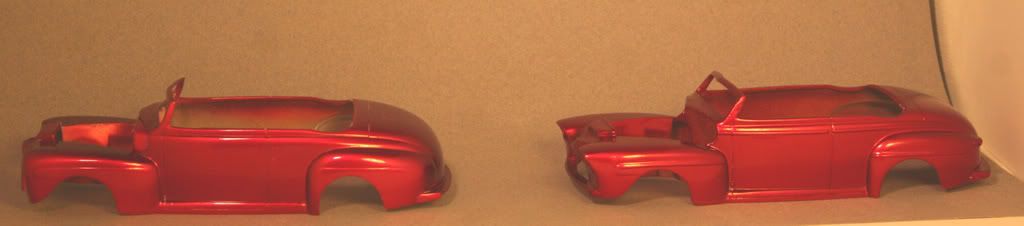

Here are two different versions of a '47 Ford convertible. The one on the left was built and painted before I got a picture of the car I was trying to emulate. It was painted using House of Color paint from Black Gold. The other was recently painted using Kustom Kolor paint. The latter one is slightly more orange. There are minor differences in the bodywork of the two.
Look at the picture in my avatar to see what I am aiming for.

Nice work Helipilot. Did you use a gold or brass base for the Kustom Kolors candy. I did a spoon test with testor's brass metalizer as a base under Kustom Kolors candy apple red and the result was similar to yours. I experimented with Kultom Kolors primarily on you recommendation on another website and I'm very pleased with it. I bought as much as I could find. As you know, the reducer is a little difficult to find. I ordered a gallon of House of Colors slow reducer from a local paint jobber that should last me quite a while. Keep up the good work.
So far I haven't needed reducer beyond a couple of small bottles. I used it with the HE108 Gold I used for a base. I sprayed the color coat straight out of the bottle! It covered quickly and smoothly.
I always use ColorPlace Equipment Grey Primer under all my paint.
The Kustom Kolors candies required very little reducing. But, the silver base required at least 100% reduction.

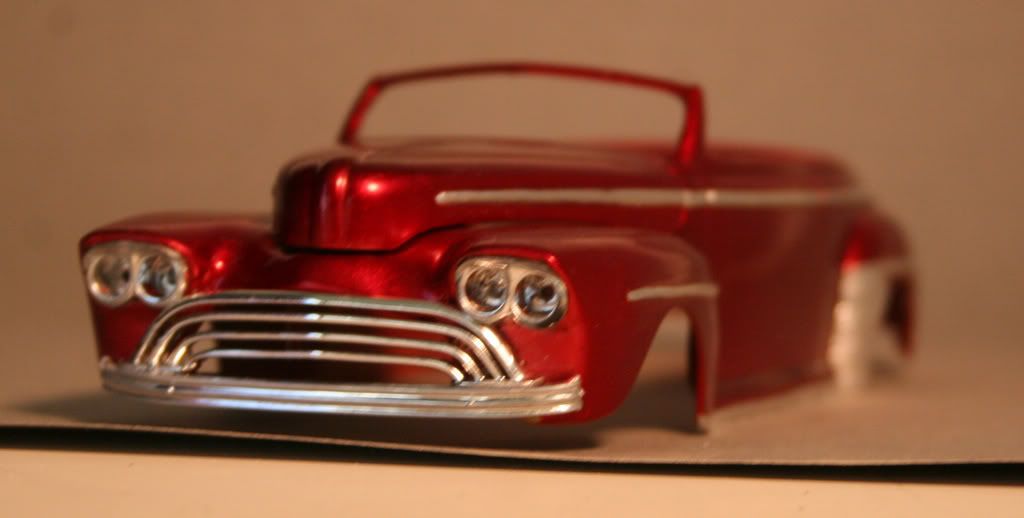

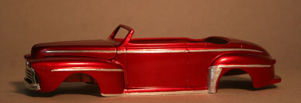

I have now added the grill and front bumper.
I have edited my avatar to more closely approximate the color of the original. The other was too dark

It's a 50 year old photograph, so it's impossible to tell by the picture. The original color was true candy apple red. I have gotten as close to that original color as possible.
